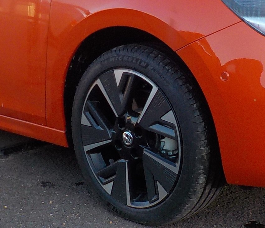

57 minutes ago, Roottootemblowinootsoot said:
Michelin Primacy as another example.
We've done this one, Root.  You'll just have to come out with me in my Mk5 Golf with 210 bhp and 330 lbs-ft in the wet to be convinced you're wrong about them.  😆
@Schtum  210bhp is lovely. But not unusual in the Fabia section for members to drive similar or more.
It is just a car forum, and people have cars and driving experiences and tyre fitting stories to tell.
Tyres are something i have a fetish for and i have tried plenty over the years, often take offs from Skoda approving new tyres because the Dealerships can not sort the alignment and the pulling to the left that is so common with right hand drive cars they build.
Pirelli Zero Nero the favored tyre with hard sidewalls to hide the issue rather than resolve it.
We did in another section and the Michelin Primacy on my new car are still poo.
Since you do not have just Primacy from 2019/20 and Primacy 4 or what ever maybe best you try them on something like a 1.0TSI DSG or a Hybrid or an EV.
ECO crap to give MPG or Range and sod the grip / traction / friction.
Is it Primacy 4 you have on?
A set off inexpensive tyres from TIGAR in Serbia, a Michelin owned company are a far better purchase then some of the OEM tyres fitted by the VW Group.
