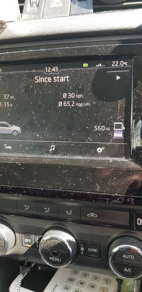

Should be around 38 40 mpg for town work , that's what i get in my manual, and have had 65 on a long run , set the driving to normal
Edited by skippy41
Wow that's incredible,  I notice it says average speed 30mph so what type of journey did you get this mpg?
79 mile run A roads average 50 mph, It has never gone over 35mph average for some reason, even on a 480 mile trip from Scotland to Plymouth, still had 200 miles left in the tank
Edited by skippy41

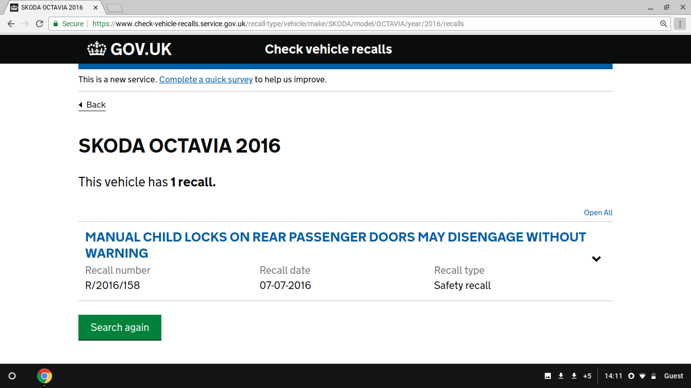

@varaderoguy
What 'Firmware' recall is there on a 2016 1.4 TSI with DQ200 DSG in the UK or Europe?
http://skoda-auto.com/services/recall-actions
There is a RECALL in Australia on up to 2016 DQ200's but not on ones fitted by Skoda to Skoda's. Started late 2019.

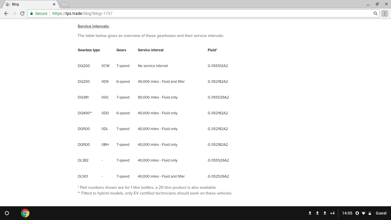

@varaderoguy
Maybe look at DQ200's and DQ250's.  There really is no common issues.
The DQ200 can have Oil changes of both oils, but there is no Service Schedule or Guidelines.
A DQ250 does require Oil Changes and there is just one oil needed. & a filter.
Edited by e-Roottoot
