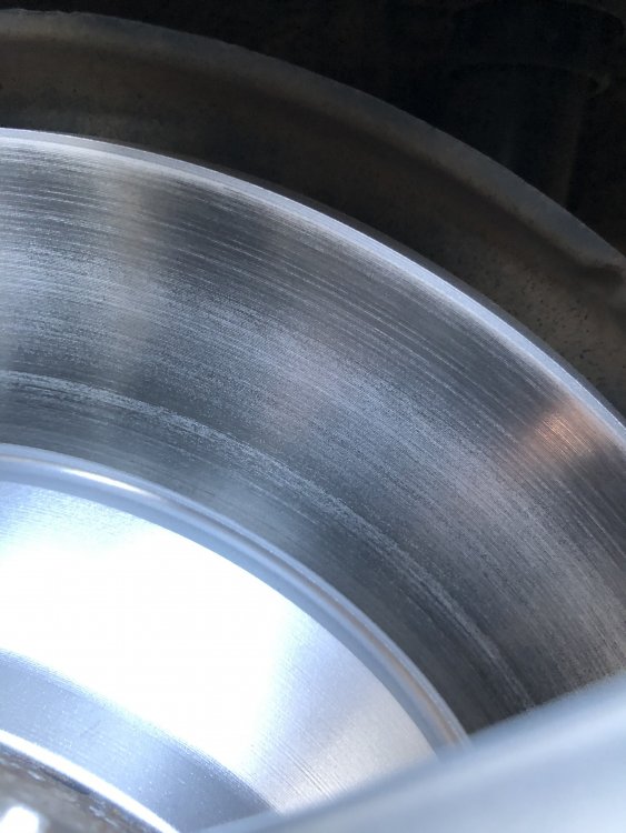

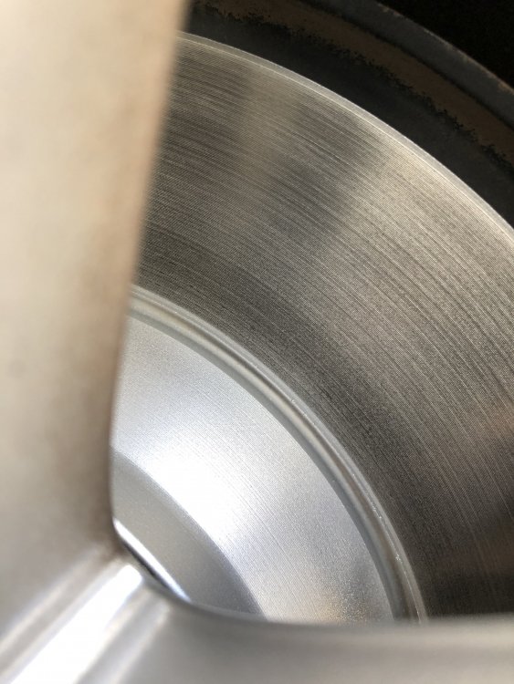

Does anyone notice a difference here? NSR disc vs. OSR disc - both replaces yesterday. Only had a few miles of driving but wear pattern looks different on either side
Nah.
They look fine. Normal wear and tear.
Give them an occasional hammering to keep them clean.
Tests the ABS at the same time.
Something to consider and can affect some cars / wheels / brakes and be noticeable, and affected by where you park.   If you park at the side of roads, maybe busy roads. The offside wheels and brakes and paint get more 'wash or debris' hitting than the nearside / kerbside does.   Same parking at seaside regularly.   Offside discs can corrode more or need the cleaning off of rust more often and wheels can suffer more from wear and tear.  Sometimes you need to have a keeper and it takes years to notice if a phrnomimim or an internet myth started by me.    It does apply though to driving single carraigeways where all the crap comes to the drivers side from cars going in the opposite direction.

Yes but side streets at 20-30 mph is different from main roads with HGV,s etc passing through all the crap that gathers on roads, snow ploughs / gritters etc.  A country road with horse and cow poo is not the shame as some clean surfaced roads if you pay attention.
I suppose it evens things out for the way the near side gets more punishment on the suspension and tyres, through rougher surfaces and stuff left lying around, after it has been flung clear from the centre of the road!
I regularly attend microcar rallies, where the cars are towed there on trailers.  All the owners know that if they get a puncture, or suspension sagging, on the trailer ... it'll be on the nearside.
The best maintenance a driver can do for their brakes is to brake really hard every so often. A quiet road and a couple of 60mph to 30mph hard decelerations keeps them rust free and removes the glaze from the pads.
