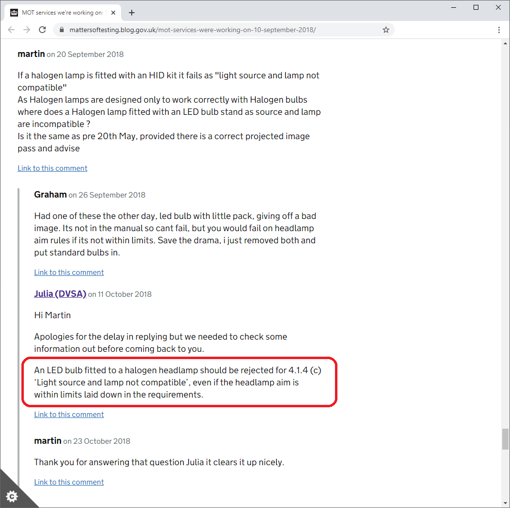

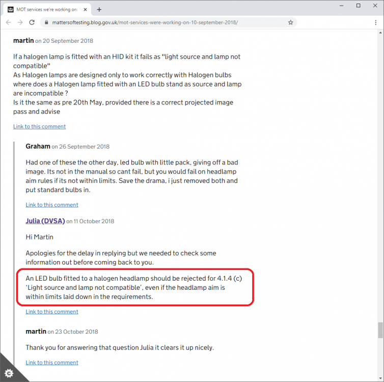

I had to put my mind at rest, LED bulbs are ok as long as they are aligned ok, and have a similar beam pattern, I ask my 3 local MOT testers   , only HID swill fail the MOT

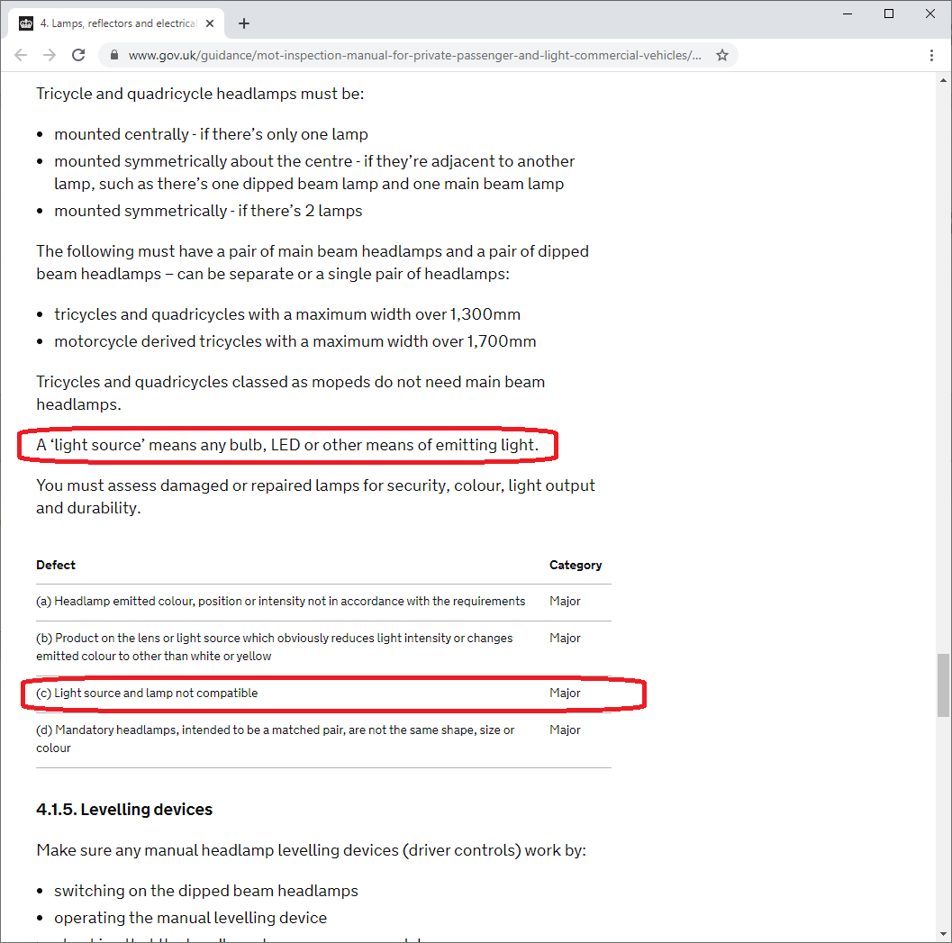

@skippy41 - despite what the three MOT testers are telling you, LED kits in headlights designed for halogen bulbs are a fail.
It's in the current MOT inspection manual: 4.1.4 (c) 'Light source and lamp not compatible'
It's was also confirmed by a DVSA worker back in 2018 shortly after the new regulations came out:
If you really want to put your mind at rest, put halogen bulbs back in and stop messing around with LED conversion kits...
