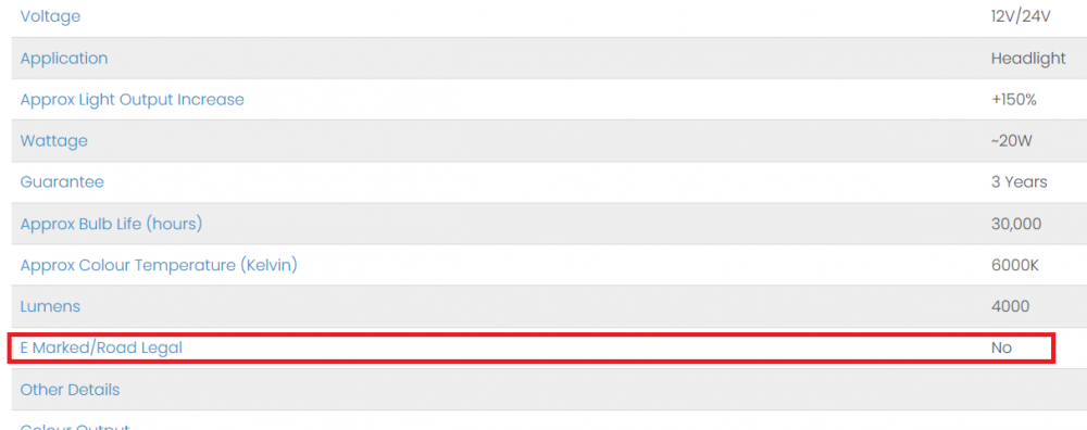

Look what they hid away behind the "Techy Stuff" tab:

I think I might complain to the ASA about that website not being a whole lot more up front about the whole
"E-marked/ road legal - No" aspect of these bulbs.
