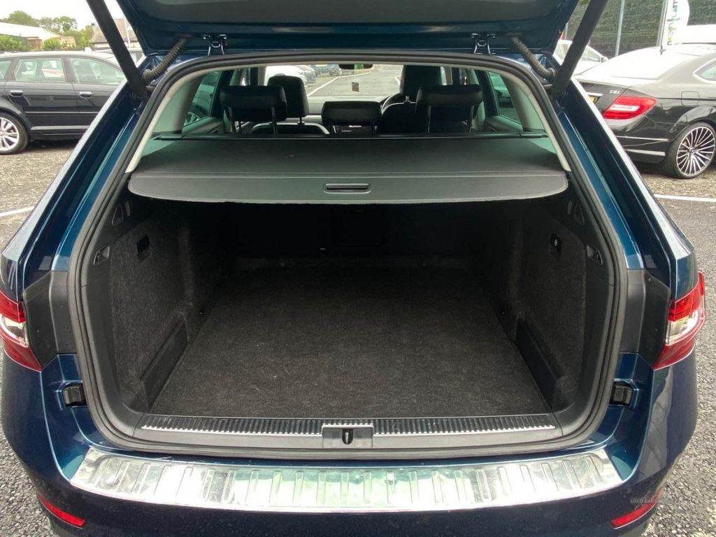

Also, the rear bumper has an unusual chrome/silver panel across the length of the top of the bumper where the boot door closes - I've never seen this detail on another superb.
Usually the bumpers have the same body colour
Thats just a stick on bumper foil to protect the bumper paintwork
Who would stick something like that onto a bumper?

As to the rear bumper protector.
Anyone might fit them, and that will include whoever bought or leased an estate car that might well do high miles carrying stuff that gets lifted in an out the back.
Those that carry bikes in the back might well as they do a good job of protecting the paint work, or covering any damage already done.

Cause it's an aftermarket, after thought stuck on protector.
Hi, I’ve got a clear one bought from the Skoda shop and fitted from new 2 1/2 years ago it gives me much peace of mind and I forget it’s on there.

2) The bumper sticker - is not a 'sticker', it is a rear boot scuff protector.  They are held on by sticky tabs (the same type as used to adhesive for your numberplate), so they will come off quite easily.  It looks like this: http://www.superskoda.com/Skoda/SUPERB-III/Superb-III-Combi-massive-stainless-steel-rear-bumper-protective-panel-original-Skoda-Autoas quite an expensive option at 69 Euros.

I did. I like this touch of chrome, that suits with the original chrome lids of the L&K version.
Sticking this kind of accessory is not initially meant to hide something, just to protect and improving the appearance (depending on one’s tastes).
