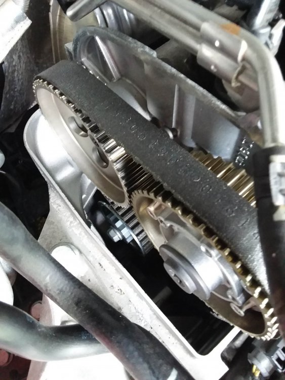

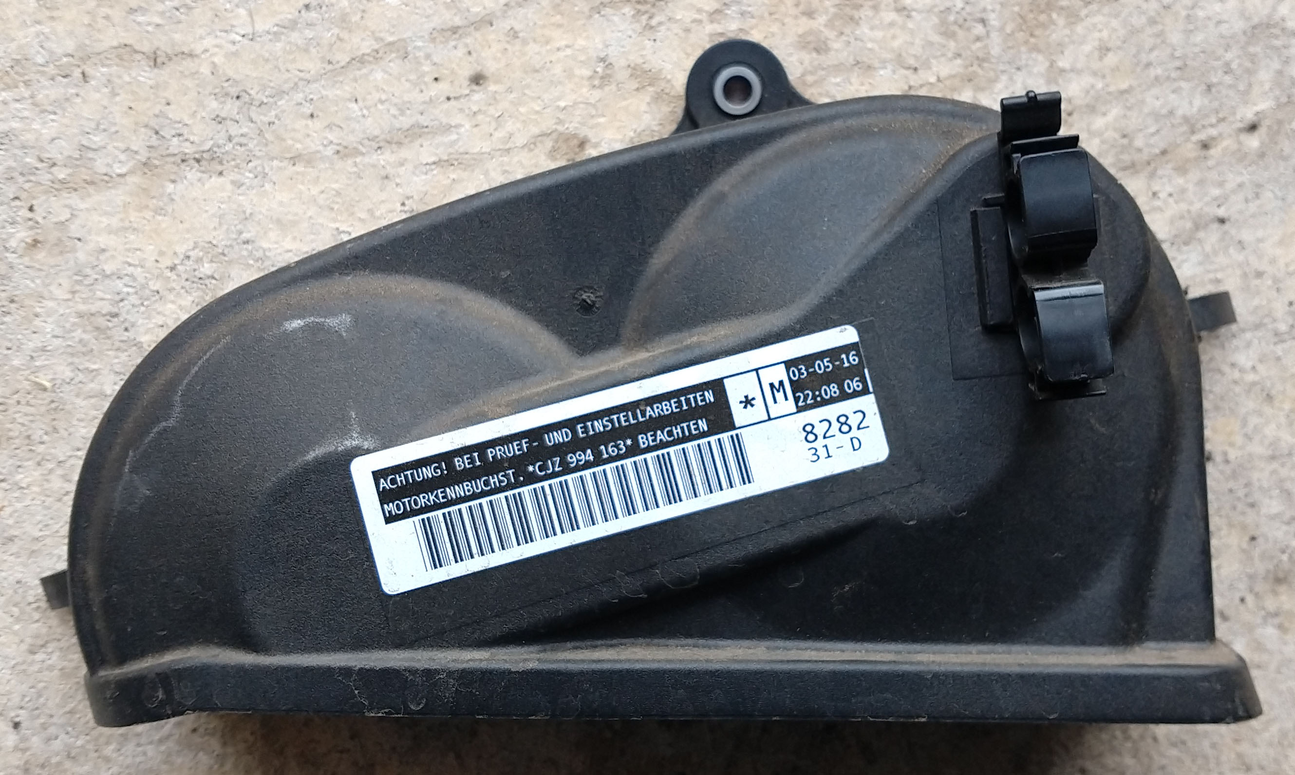

You / Your Mechanic can look at the belt by just removing one bolt and four clips.
It takes less than ten minutes to do.
The bolt hole is at the top of the black cover in the photo and is a Torx 30.
Two clips are either side of the cover and want a flat head screwdriver.
The other two clips hold two pipes in place on the face of the cover to the right of the label.

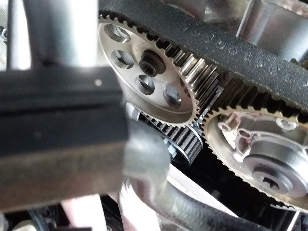

AGFalco  - I took the cover off and looked at the belt / teeth
A bit difficult to make a judgement as I don't have a new belt to compare with, but on the face of it, both the belt and the teeth look ok
Thanks
Geoff
You could get a light and magnify glass, or take hi-res photos to view on a larger monitor, you'd be looking for crack/crazing, evidence of  abrasion, and to be sure fully you'd need to check the whole belt.
Everything looks clean so no bits of belt where they shouldn't be, like you I'd need another belt at the side of yours to compare with but others might know better.

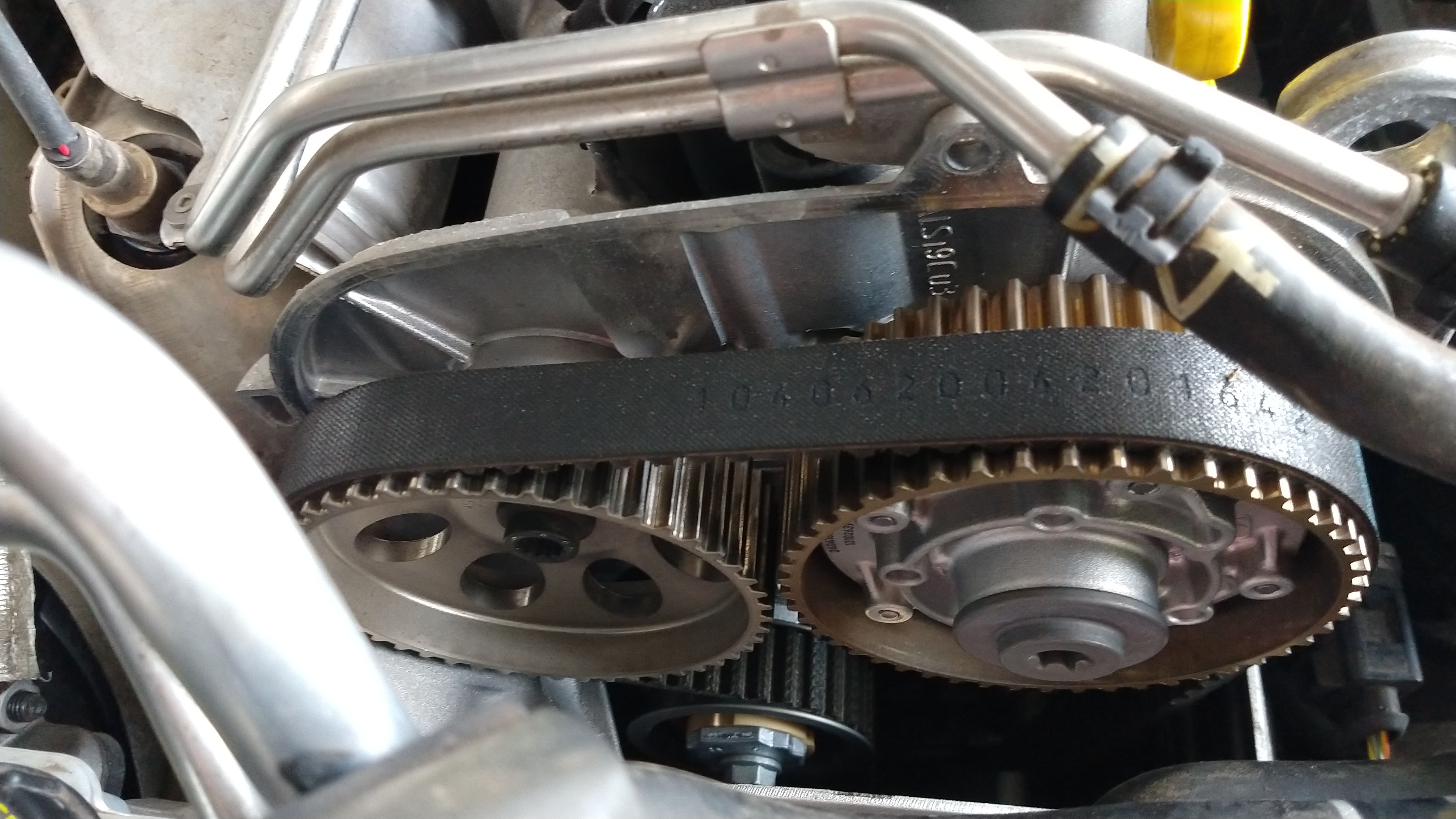

The photo of my belt was taken yesterday.
My car is 5 years and 55 k miles.
My belt shows no signs of age / wear.
Before I bought the car in 2016 I looked up details of the belt.
The Belt manufacture ( Continental ) recommends checking the belt at 160 000 miles and then every 20 000 miles.
Thanks, AG Falco
