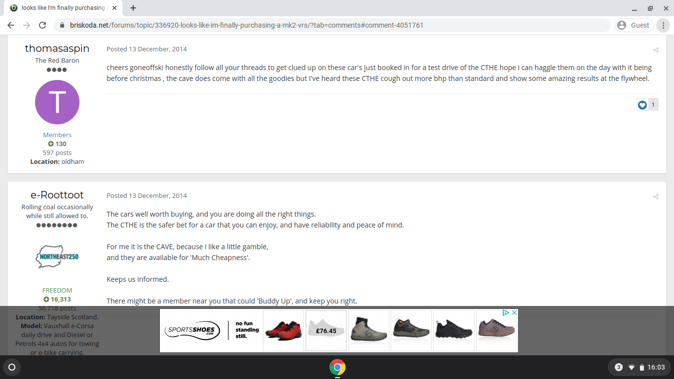

You love to go off tangent don’t you , the op just wants to know wether he has a cave or cthe engine in his car 😂🤣😂🤣😂🤣
@thomasaspin
Give the answer then wise boy.
It is hard to know. You can look at the build date, you can look where manufactured or you can ask Skoda / VW UK what parts the engine was built using.
You can investigate the ECU, look at the code on the label.
You can look a long time mister. All night long.

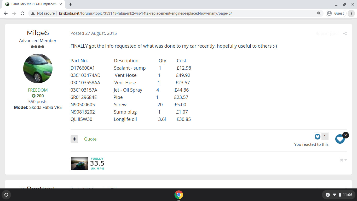

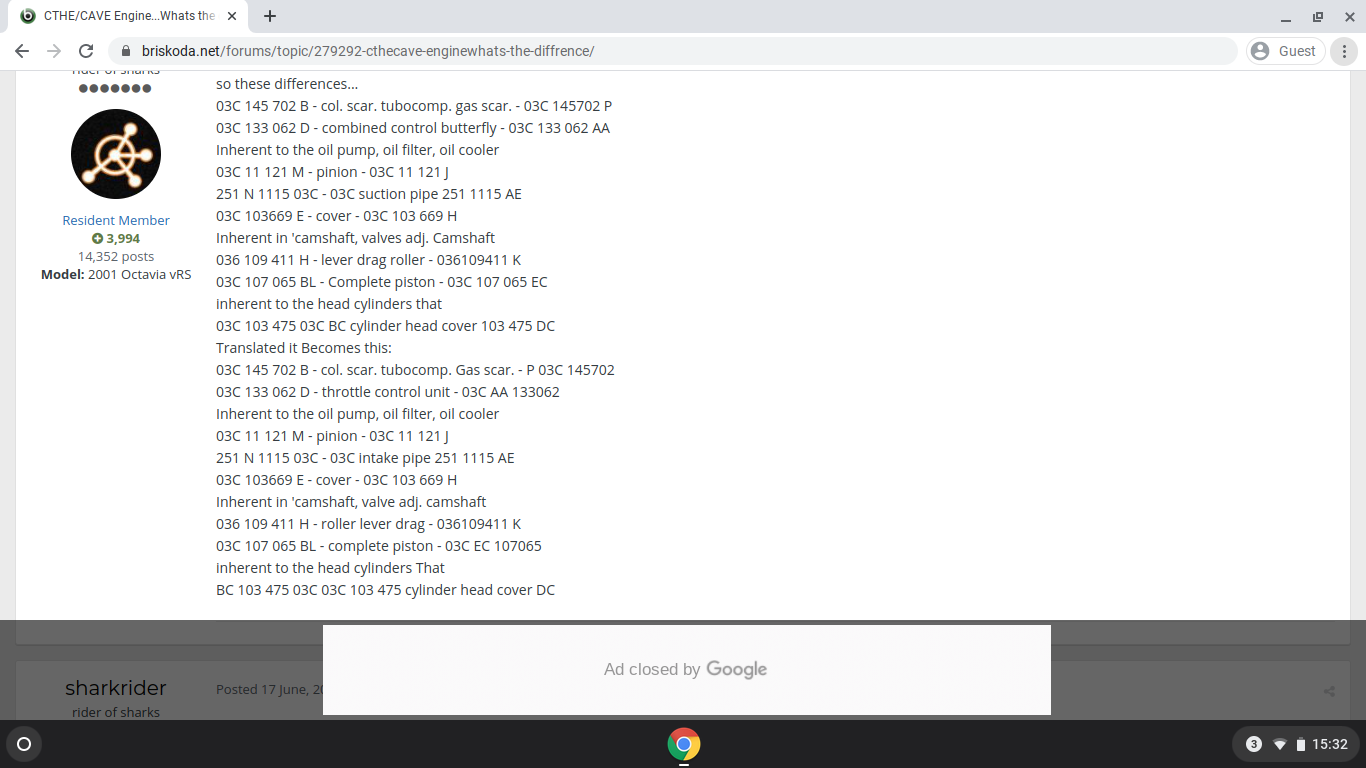

Pointless and irrelevant.
Imagine if a BLT engine core was used to replace an ASZ, how would you tell and why would you care?
