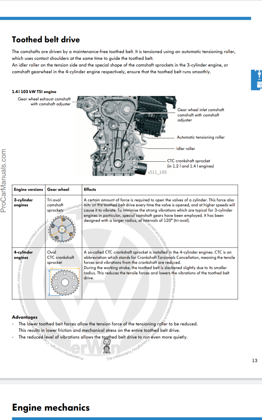

What we do know however is that:
- No Skoda UK vehicles fitted with cambelts have life-long intervals. Bristol Street Motors in Middlesbrough are unfortunately wrong on this occasion.
- The cambelts fitted to the engines mentioned in this thread are not bathed in oil. Hopefully the local trusted independent mechanic was having a bad day.

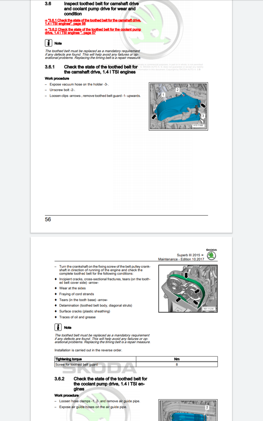

- The Skoda UK cambelt interval on cars registered prior to September 2010 is a blanket 4 years (mileage limitations also apply).
- The Skoda UK cambelt interval on cars registered in September 2010 and ever since has been a blanket 5 years (again mileage limitations still apply).
As already mentioned though, beyond it's fifth birthday the car is out of manufacturers warranty, so as owners you're free to make your own decisions based on the various information around the varying stipulations on the same cars sold outside the UK, and of course the belt manufacturers themselves.
However, if you choose to follow Skoda UK's regime and replace the belt at 5 years, and it fails at some point later, then even if out of warranty Skoda have been known to make gestures of goodwill towards the repair costs, which is far from a cast iron guarantee and again for which their are pros and cons.
For me, any decent mechanic can replace a cambelt on these engines in a few hours, the kits themselves, even genuine parts from Skoda are not expensive. A cambelt can be fitted for £300 at an independent, with another £50 to replace the weak waterpump whilst he or she has the belt off.
A UK car has an average lifespan of 15 years? So that's roughly two cambelts across it's entire lifetime. If however owners choose a different path then that's their choice and one to be respected. I like my cars to be dependable and am a big supporter of preventative maintenance so I'll stick to changing it every so often, simply for peace of mind.

The service schedule on the skoda website states cambelt at 5 years. https://az749841.vo.msecnd.net/sitesengb/alv1/d300a459-5ef6-433f-a49f-65f3638efaa1/national-price-servicing-min.63862747c3e6286ede19bc446a023030.pdf
