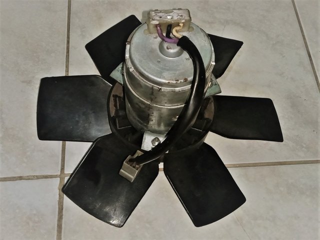

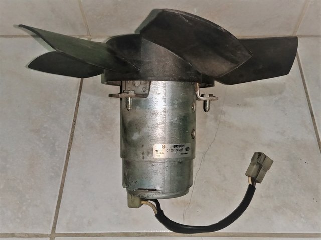

This is my previous radiator fan, Bosch 0130 109 237 made in Brasil
By mistake was working mainly in 2nd speed (strong) and with the a/c on was in 1nd speed (low) rarely.
Last about 4 years only, the 2nd speed was ''burned" and the car overheated, thankfully his relay was intact but since no one took the responsibility to ''rebuild' it i had to buy a new one Bosch but made in Germany this time.

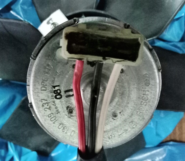

This is the made in Germany model, same code.
As you can see this too has the plug on when i bought it and again the seller told me: ''is from the company that has the distribution,they put it on".
Now in the traffic i have the 1st (low) scale, till now no overheating problems, the whole system works perfect.
