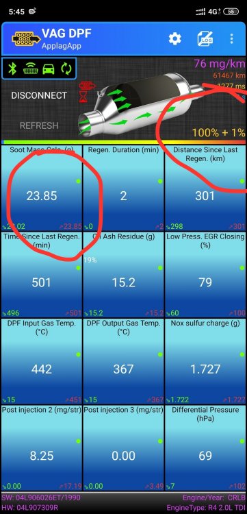

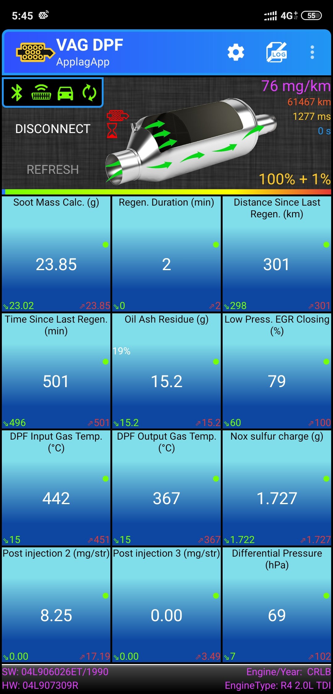

if it is as you say then why does it show 100% soot at 24grams?  regeneration is always done when the filter has over 98% soot.  and when it finishes 22-25% it always stays.  the filter never regenerates to 0 gram. if it is as you say then why does it show 100% soot at 24grams?  regeneration is always done when the filter has over 98% soot.  and when it finishes 22-25% it always stays.  the filter never regenerates to 0 gram.  the photo shows the condition of my DPF at approximately 42k miles
that's 45 grams you are talking about for the ash in the filter.  when it will be about 70 grams, the filter should be replaced.  because it's full of ash, not soot.
That's the developer of the VAG DPF app showing how close to an active regeneration you are, not overall soot load.
If you check the measuring blocks of the ECU, you will only find the soot load in g, the percentage figure shown does not exist :)
It is actually showing 100% + 1%. That should tell you that it isn't really full.

when I turn  off the engine at night, the DPF already had 98% soot.  in the morning when the engine was started, it was cold and hence it showed 100 + 1% because the regeneration started after the engine was started, it took a while for the DPF to reach the required 640 degrees
The vag dpf app reporting 100% or 24g is not a problem... The dpf is not full of soot at this point and no immediate action is needed.
