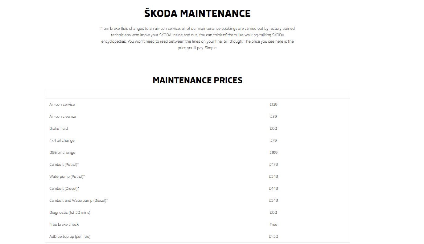

Wife's Focus is 16 years old, and only just coming up to second cam belt, on the assumption that we replace the Superb Cam belt every 4 years that's 4 Cambelt and Water pump changes in 16 years if you keep the car that long which I did with my last car.
As many know Skoda Cam Belt & Water Pump replacement is not cheap, for the 2.0 TDI it is £549, on a modern car I don't think this requirement every 4 years is acceptable, and that makes you ask questions about the durability and quality of the VAG based engines.
A full service every 2 years, cost £289, so every 4th service will cost you a minimum of £838, that's without brake fluid change of £60, then there is the DSG oil change as well at some point, £199, really makes you think hard about your next choice of car, something I never really took into consideration  when I purchased the Superb.

For £549 is it a cam belt and water pump belt, or cam belt and replacement water pump?
When booking in for next week, I said don't bother with the water pump bit for an extra £100 (thinking that's a lot for a water pump belt), but if the pumps are known to be a weakness, and the extra £100 covers pump replacement it might be worth it...

£549 is for the Cambelt & Water Pump, including a new cam belt tensioner, the water pump is a know long term issue, get both done at the same time, if the water pump fails your being doing the Cam belt again, never change just the Cam Belt, get them both done now.
The Cambelt drives the Water Pump, the Water Pump has an electro magnetic clutch which energises to drives the pump once the engine is up to temperature., hence to cost of £100.
