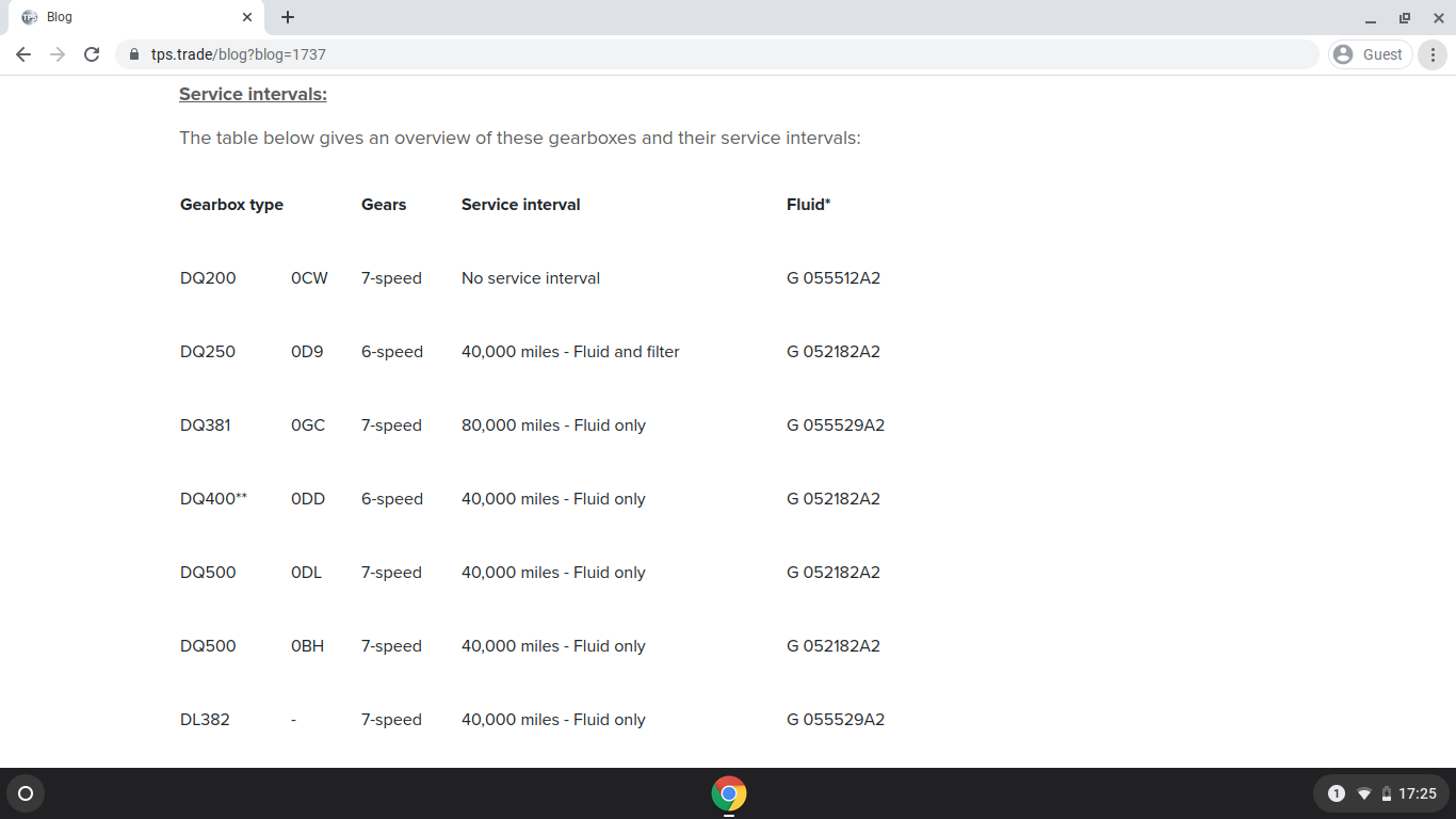

Oil for the Box and oil for the MCU.   There are description how it is done in the Mk3 section and the General Maintenance section.
