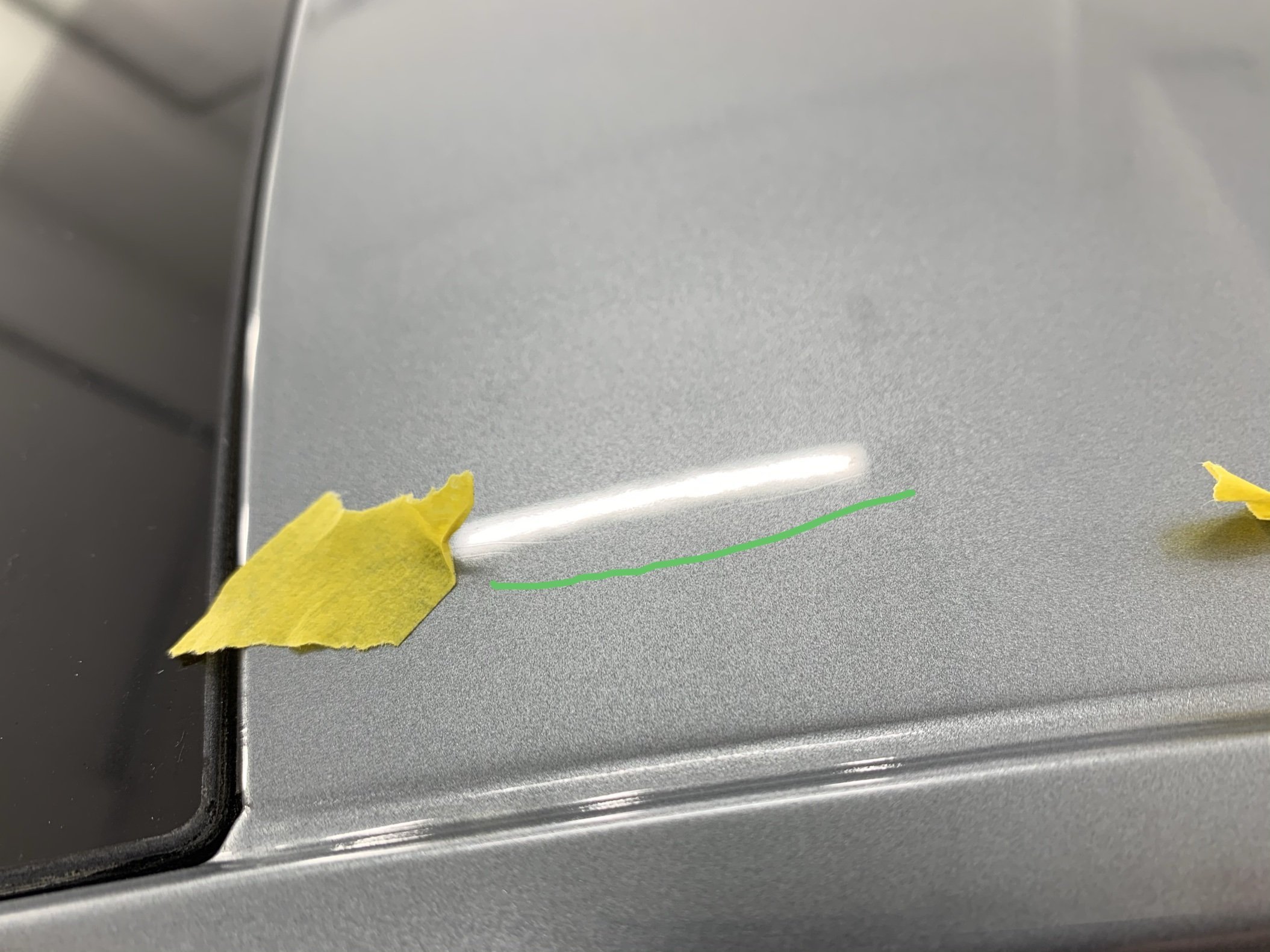

So, after 7 months waiting for my Skoda Superb to arrive, I'm greeted with a phone call from the detailer saying they've picked up numerous defects in the paint. Sigh, here we go.

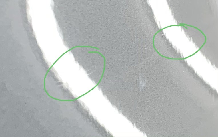

There appears to be streaking, or lines of some sort, in between the clearcoat and paint from what I can gather. You can only catch them in certain light and they're hard to photograph:
63DC305A-3D53-4861-B8EA-FD15D14A9D03.jpeg.1f06ac8e31ddbecffa7e218884785734.thumb.jpeg.dcba4374767418c231d7e723d219fc1e.jpeg4F58F6CD-DCE0-45E3-9B98-F36B5F59DE5E.jpeg.9f0cc9856b7ce55c993e68a611a712d7.thumb.jpeg.af9af66961d1bc57e35db781e7b32436.jpeg

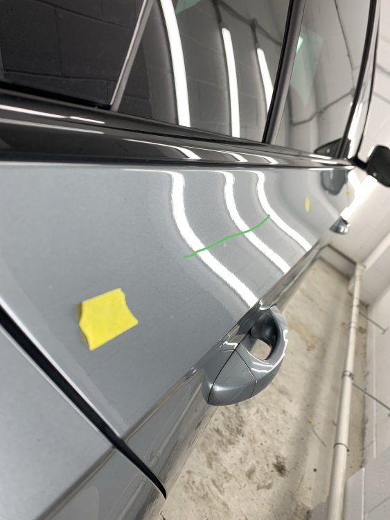

There's numerous ones on the roof by the attena, but I couldn't see them. The worst offenders are the drivers side passenger door and the front passenger side roof. If you zoom in you'll see the defect above the green lines, it runs from sticker to sticker. They're smooth if you run your finger over them, and they haven't polished out.
So now the car has to go back to the dealer, they will take photos and send them to Skoda New Zealand who will then send it to the factory for comment. I'm guessing the whole roof will need to be resprayed and the passenger and drivers door too..
Thoughts on what these are? Just poor application by the factory robots?

That roof fault looks like an early defect, so a scratch on roof, or in the primer or the colourcoat that's filled in from the clearcoat. That's rubbish, I'd want a respray, AND a discount AND a real proper (no if's/buts) rust guarantee or I'd walk away - I realise your supply chain length makes rejection harder.
I have to ask how the hell did this get through quality control, totally unacceptable in my opinion.

After inspection by the approved repairer they think its very faint scratches, which can all be resolved with a full cut and polish of the car, no paint required. So it's going to them today to start that process.

I couldn’t see the marks on the photos except for the one on the roof. It looks exactly like a wash mark, which I’m hoping it is, as a DA with 1500 or lighter should shift it.
Then you can get your car coated and enjoy it without any further hassle or waiting.

You can see similar lines running either side of where the fluorescent light hits the car, it’s hard to photograph and hard to see unless you’re standing on at the right angle or the light catches it right
But basically the mark runs from sticker to sticker on that particular photo of the rear passenger door
I’m hoping so too, to me it looks like the mark is underneath the clear coat but I’m just a layman with no experience in car paint
I’ve cropped the photo and circled the area

Yes. I see them now. I’d be very surprised if that was anything to do with the paint process. I find the paint on my superb is very easily marked. My front bumper would probably mark if you sneezed on it to heavily.
when they sand those marks out and correct the entire car, if you apply a good ceramic coating properly, the coating will take the wash marks and protect the top coat underneath.
You can still cut some of the marks from the coating with a very light DA. I would use something like my Rupes white finishing pad and either Uno Protect or Keramik gloss (fine) at a low speed.
Then depending on how long you keep the car, after a few years you can cut it back completely and replace the ceramic coating all together.
