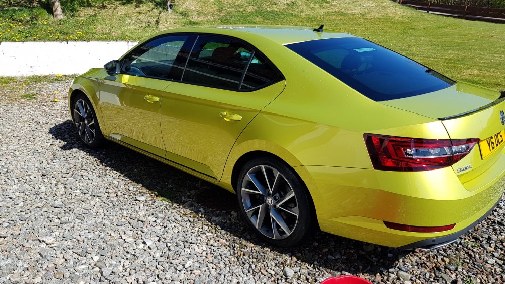

  • After just 2 days and just over 100 miles driven already prefer the standard ride height with 18" alloys and in my case Continental 235/45R18 tyres. Much more comfortable and less thumping than the 23
1 hour ago, newbie69 said:
Brave colour! Stands out for sure in that ocean of grey and silver (mine is grey lol). The best thing about this car apart from the great underpinnings is it's on a platform where everything is possible and off-the-shelf no matter if you plan on turning it into a drag weapon or a track car.
PS. Re-reading my post above now and I realized "average" driver might have a negative meaning in English, In my native language the same term is used to refer to the statistical mean of some distribution and I was referring to exactly that, in terms of priorities and requirements, not about driving skills or anything like that!
😁 no offence taken..I read it as you meant.
