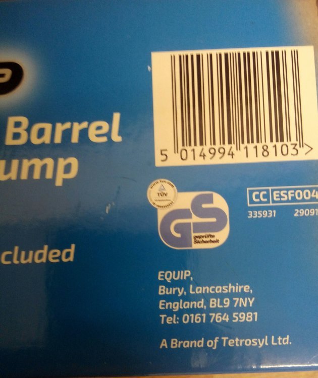

My £5 footpump from ASDA has TUV certification, and its pressure gauge is completely useless and grossly inaccurate and after a few uses, it fell to bits. I see TUV certification stuck on all sorts of chinese tat, so it means absolutely nothing to me.
Does it have TUV certification or does it just have a  TÜV sticker on it?  In reality a sticker means nothing....
In the same way I see CE markings on many items. Then I go on Amazon and find someone selling CE mark stickers for pennies and realise that maybe not all (or even some) cheap ****e stuff is actually CE marked, and is simply "chinese tat" with a 2p sticker on it. Add to that the fact that the Chinese have enterprisingly produced their own China Export logo (and sticker) which is strikingly similar and can be stuck on anything exported from China it seems, and there's nothing reliable in a sticker or marking.
Not a sticker but part of the original printed artwork on the box. A tetrosyl product I've just noticed.
