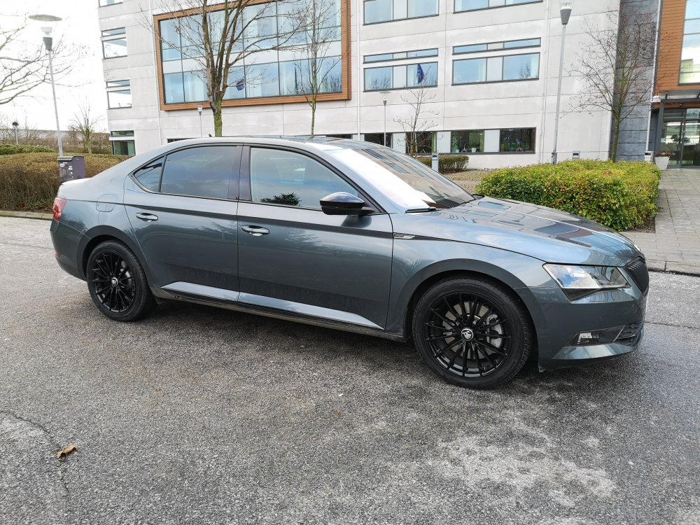

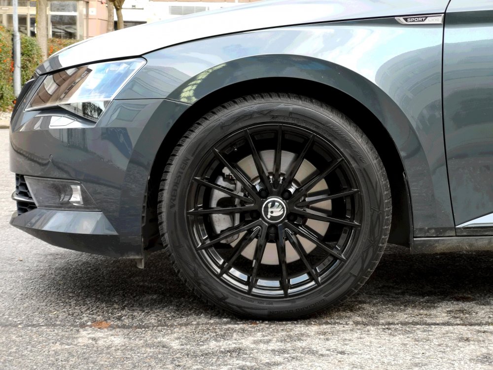

A selection of OE here
https://www.skoda-parts.com/catalog/superb-3/spare-parts/accessories/wheels-steel-aluminium/aluminium-wheel-578.html
2 years ago, the Pegasus 18” 8J alloy was listed in the UK accessories brochure with a slightly different part no. to the spare part equivalent and available from dealers at half the price of the spare part.
Some briskodians bought them and there is a thread on here.
