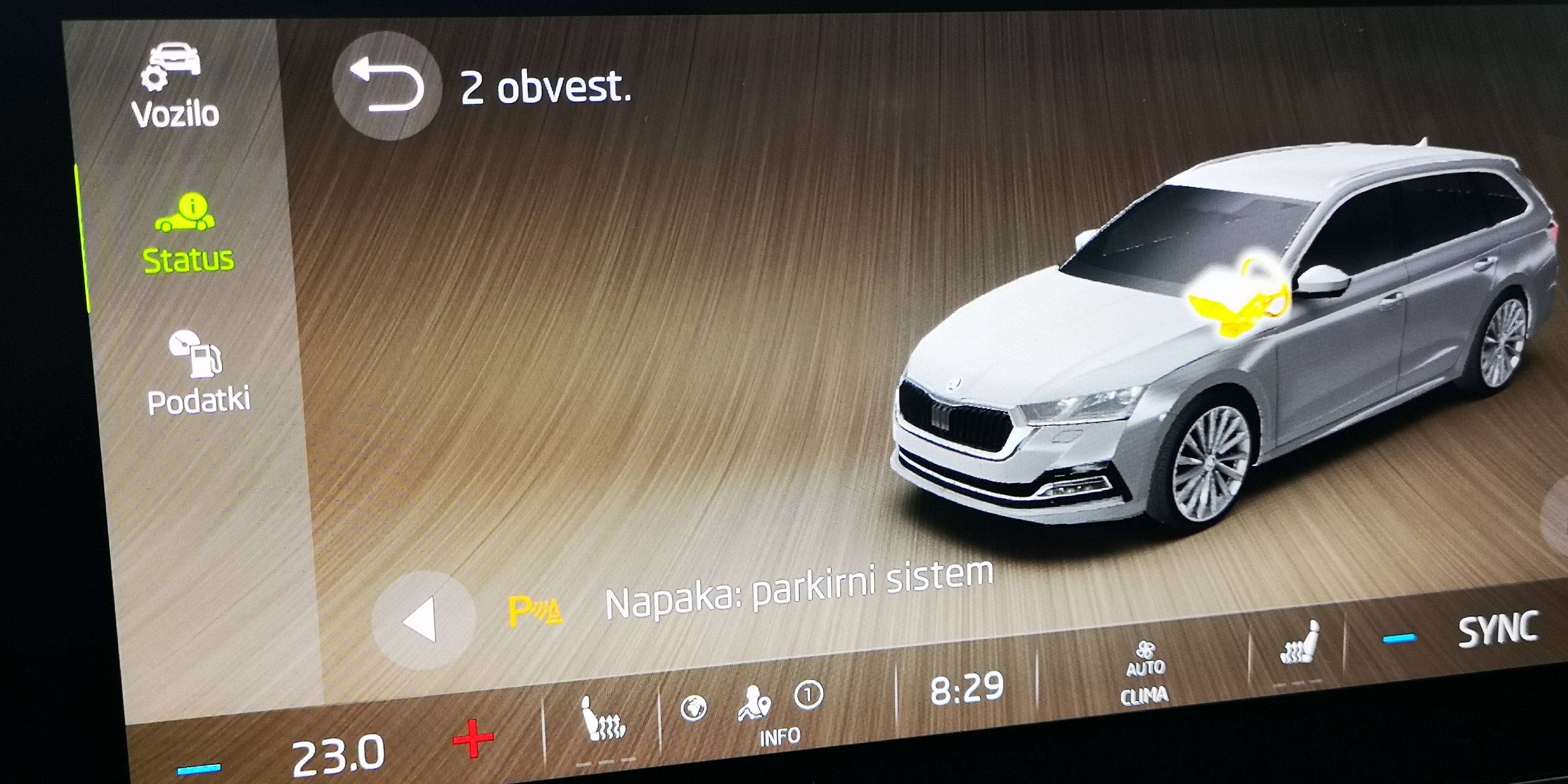

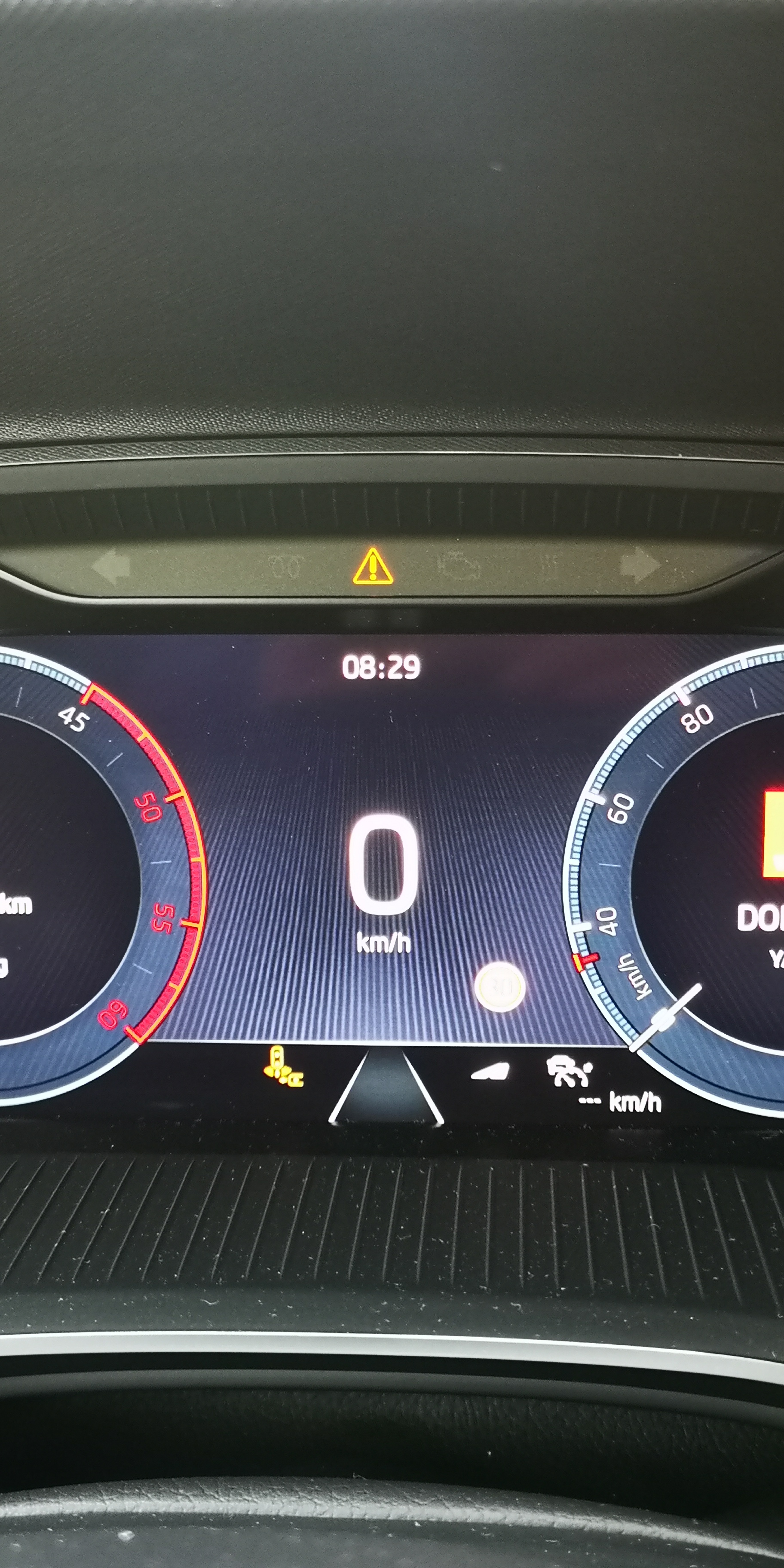

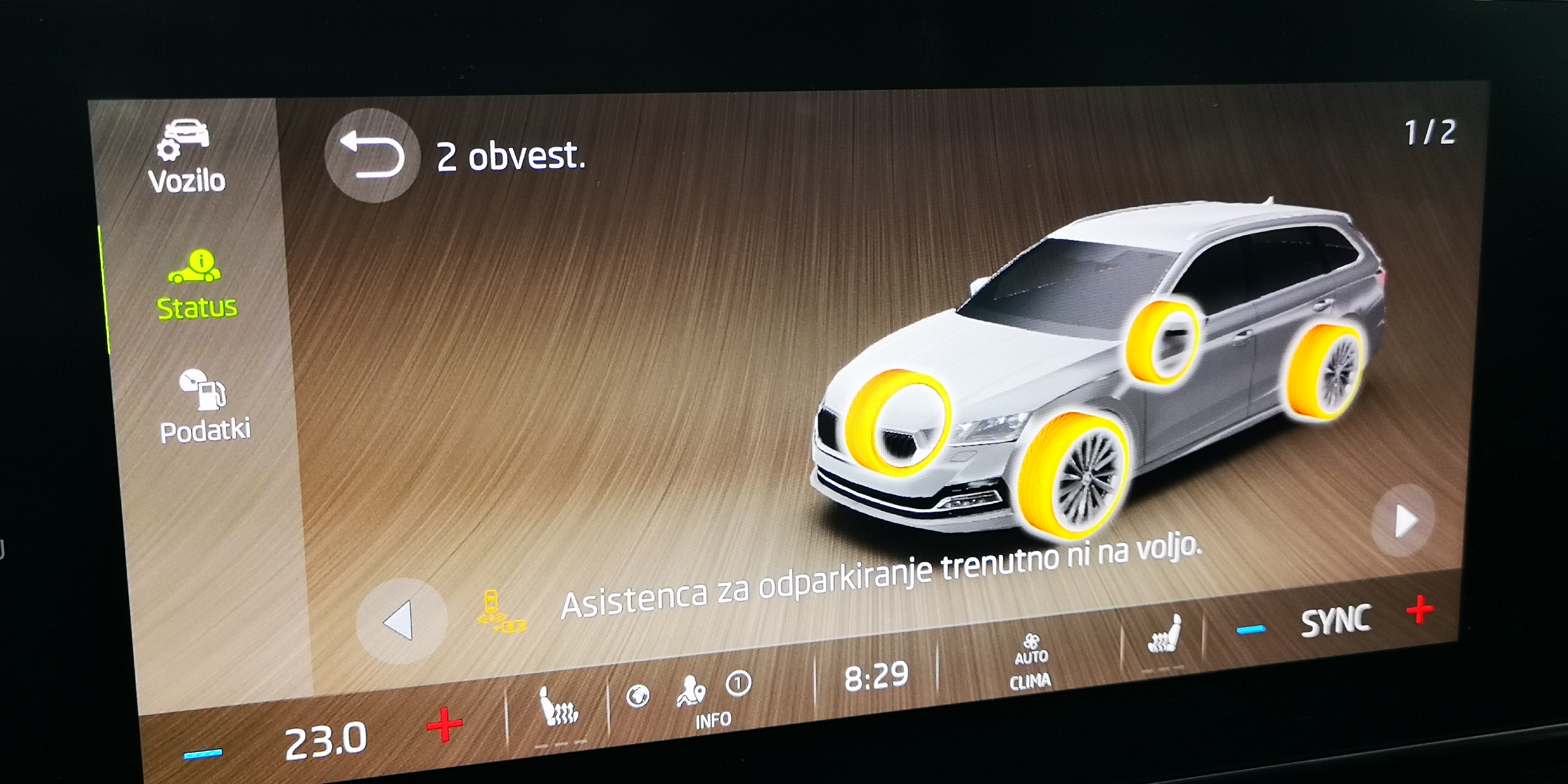

Has anyone came across and resolved the issue with assistance systems error messages such as:
- side assist not availabe at the moment
- parking sensors not available at the moment
- emergency brake not available
link to YT video with error messages: https://www.youtube.com/watch?v=DiijDlGCjOI
Language is set to Slovenian, but i hope you'll get the point.
Those messages appear and disappear, sometimes just the error for parking sensors keeps lit and disappears only after car has been turned off for certain period of time.
This issue started almost immediatelly after i got the car in end of August and problem for me is still not resolved. I reported the problem to my dealer who uploaded couple of new protocols into the car, but issue keeps poping out. Finally when they ran out of options, they reported the error to the factory and now i am waiting for the fix from Škoda itself.
So, has anyone came across with such issue? I hear there are same problems on Golf 8. The issue is quite bothering since error messages pop out almost on daily basis now.
oh and the car specs are 2.0 TDI DSG Stlye

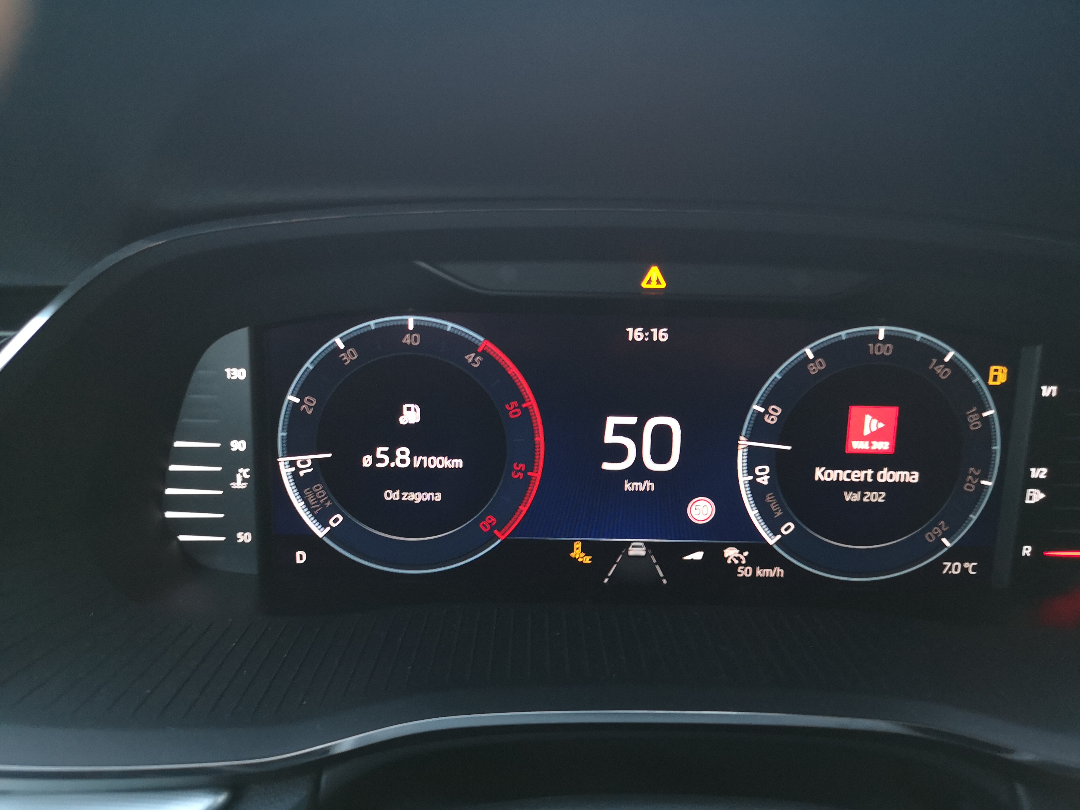

On 08/11/2020 at 00:23, Soko1982 said:
Hey there, sorry for going off topic, but couldn't have noticed the font on your speedo/tachometer. Mine looks different and yours just looks better. Could you give me some instructions how to do that? Here's a pic of mine:
to be honest i don't see the difference but the background collor which depends on your ambient lightning settings.
aaa ok i see the difference now... dont know, i had mine like this since i got it...there might be some option to change the "skin" on the graphichs...dont know sorry.
if you change your screen by using steering wheel dial where it says your fuel in the dash, scroll through to background and you have 3 options, black, coloured or something else i cant remember top of my head,
ive just noticed how did you get the speed limit to show on dash? Mine only shows on infotainment when on nav
maybe because i have Travel assist with active sign recognition specked... u have it also?
ahhhh i dont think i have that, you would think if the sat nav knows the speed limit it could use that to display the limit
well i'm not sure that for showing that speed limit is essential to have travel assist...try checking your car settings, i know you can switch these infos on your active display in the settings, but as said i don't know if having travel assist has got anything to do with that.
yeah my guess is you need travel assist
Yeah, I found this setting, but it only changes the background, not the font... Sat for nearly half an hour fiddling with the settings and still couldn't find it. Another question for Škoda I guess :D
you cant change the font
