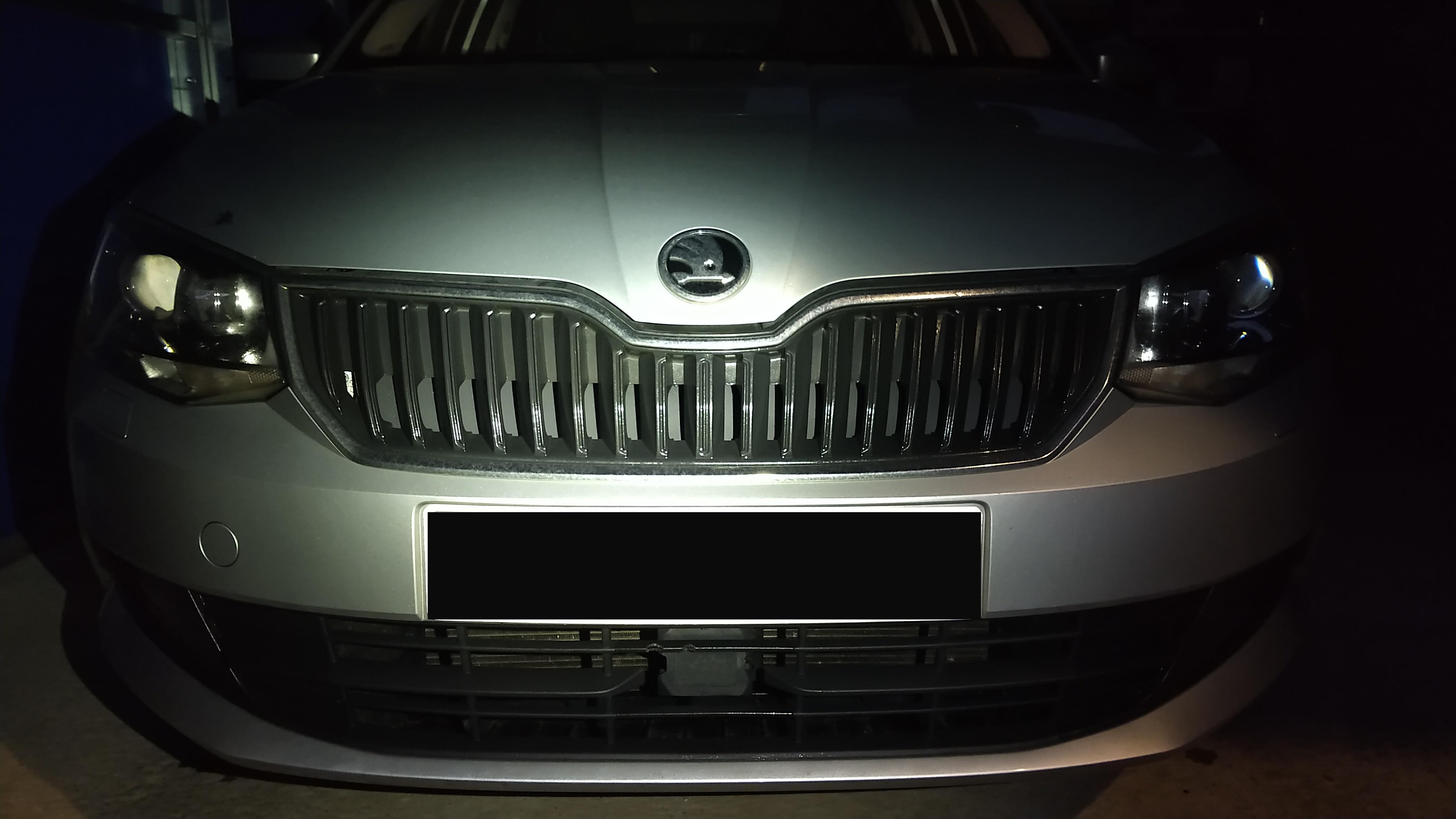

Hot car ! Front grill cover. Photo's
Ok, On another car of mine to help in the winter I cover the lower front grill up.
Done this for several years and it helps the Diesel engine warm up both quicker and get hotter.
Noticed on the Fabia that the oil temperature only goes up to mid 80's C in the winter.
During the summer the oil will be at mid 90's C and when being used will go above 100 C.
So I thought I would do the same to the Fabia.

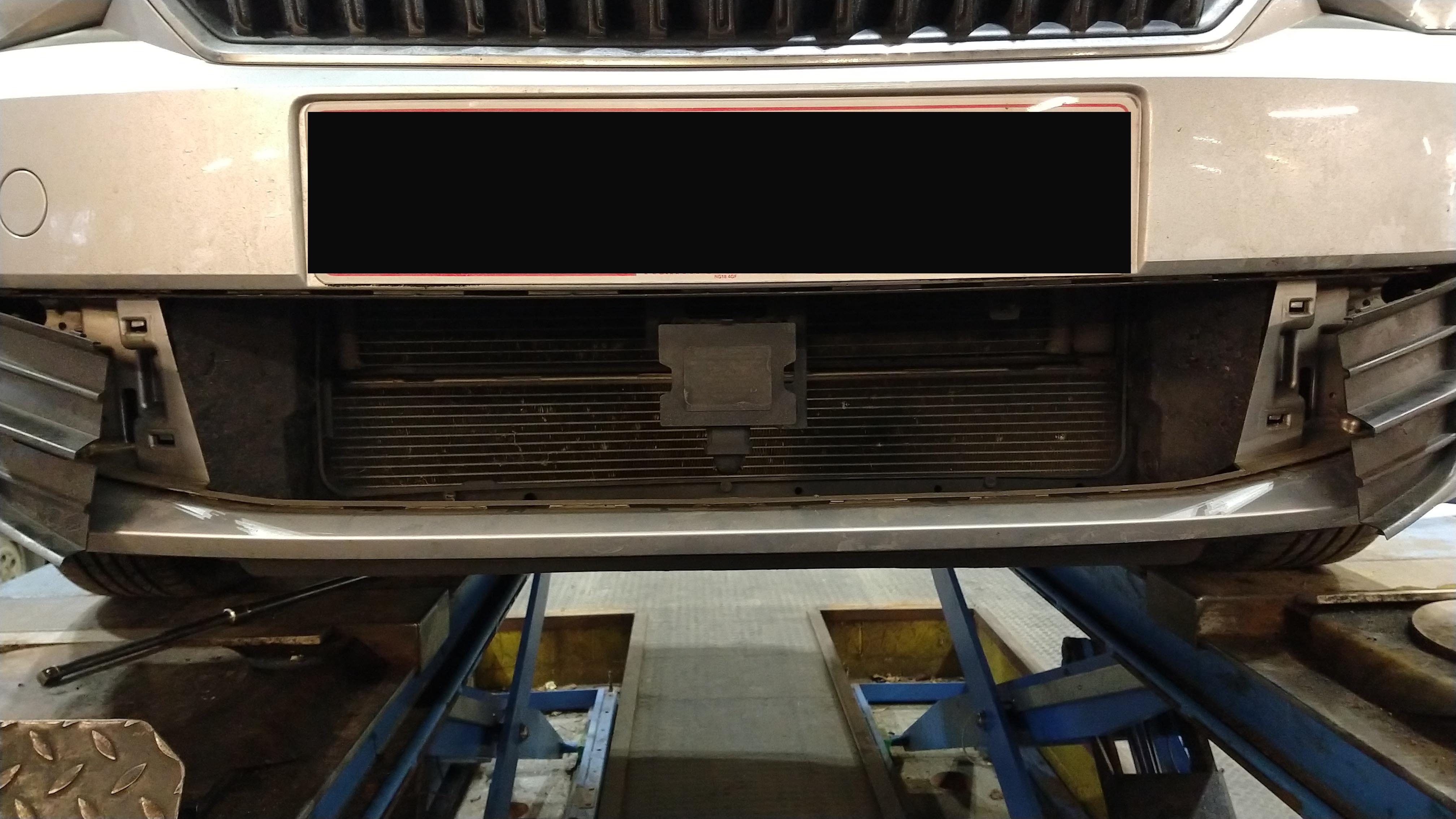

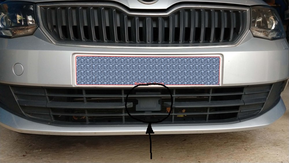

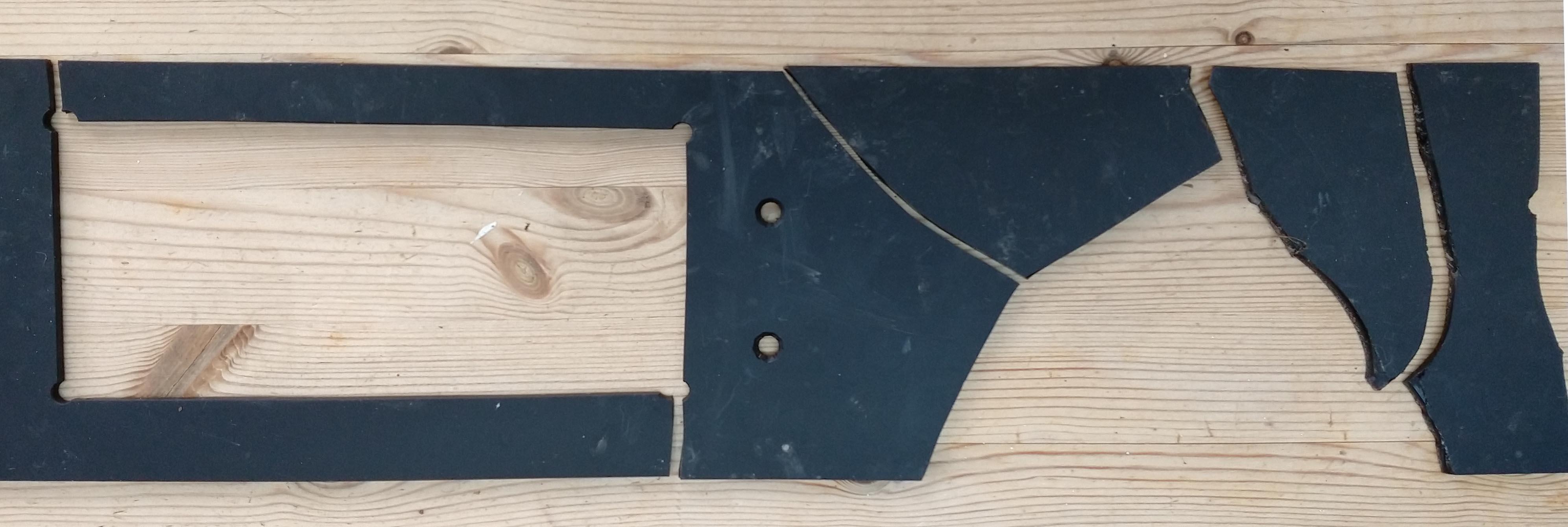

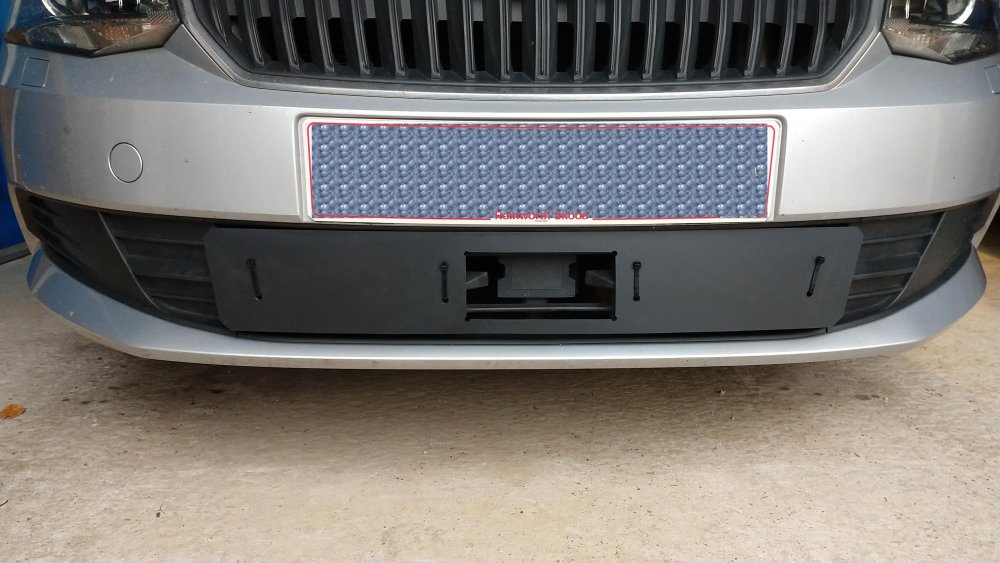

Only problem is that my Fabia has a collision avoidance sensor in the middle of the grill.

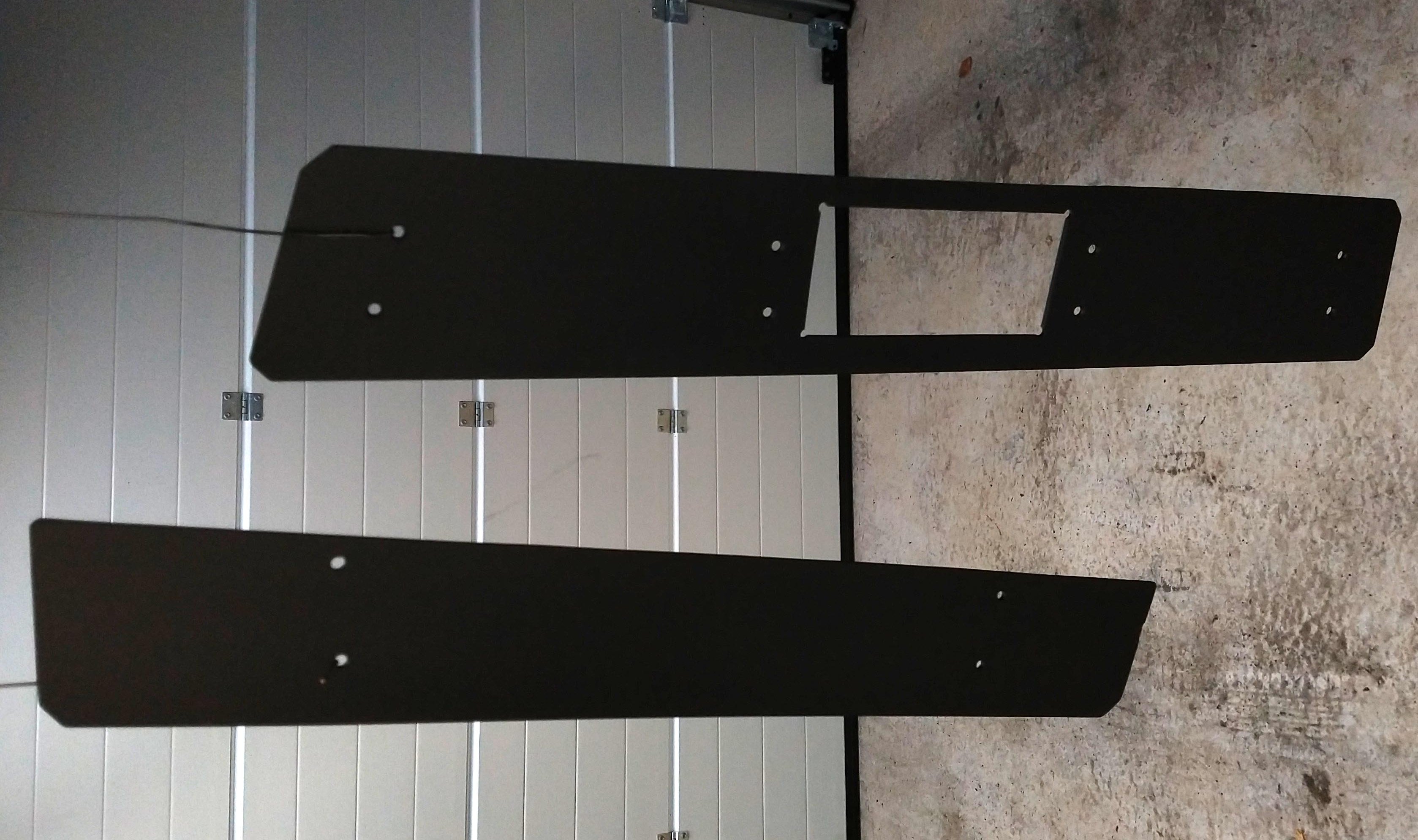

But with a piece of Perspex cut to shape, with a hole cut for the sensor, and then painted matt black:-
and held in place with some cable ties. ( what did I do before there were cable ties ) the results look good:-
The engine oil now gets to mid 90's C, the engine warms up quicker and the heater works even better / quicker. Result. :)
Thanks, AG Falco

The only issue with these covers, is there is no cutout for the front radar so you would most likely get an error showing up on the tft display saying that front assist is unavailable.  This could be solved by cutting out a section of the cover much like @AGFalco has done with his  custom ones.

Yes I has noticed them. I thought I would try this first to see if it works.
To make it fit better it needs bending ( with a heat gun? ) both left to right and top to bottom.
Their cover will fit neater but as said I would need to cut a hole in the middle for it to work.
I didn't want to buy one and then scratch / break it before even fitting it at £44.44 inc. delivery.
I am going to try this for this winter and see how it works.
Thanks, AG Falco

Neither of the two I have made are a perfect fit, both have gaps around the edges that will still let some air in .
I made a cardboard template first to help with the shape / size.

The other car's AC condenser has suffered during it's life but the intercooler is to one side.
Don't think the Fabia III TSI engine has an intercooler though.
''The charge air is cooled by a charge air cooler, through which coolant flows, located in the intake manifold.''
''Intake manifold with integrated charge air cooler''

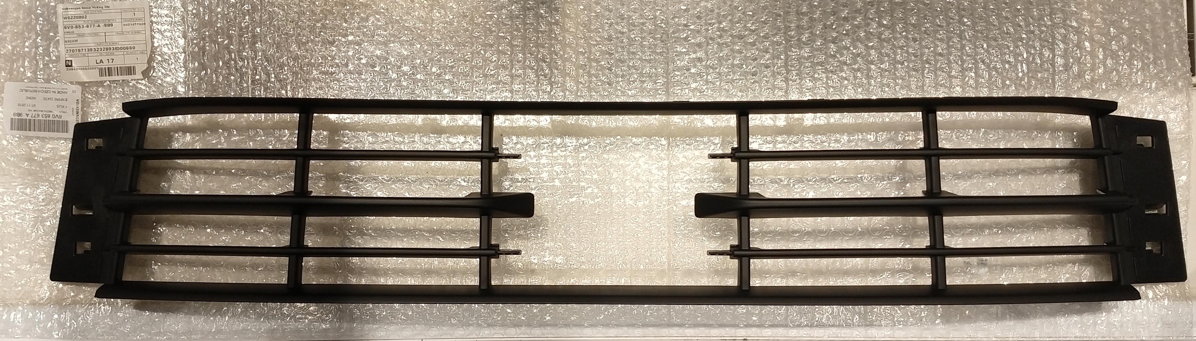

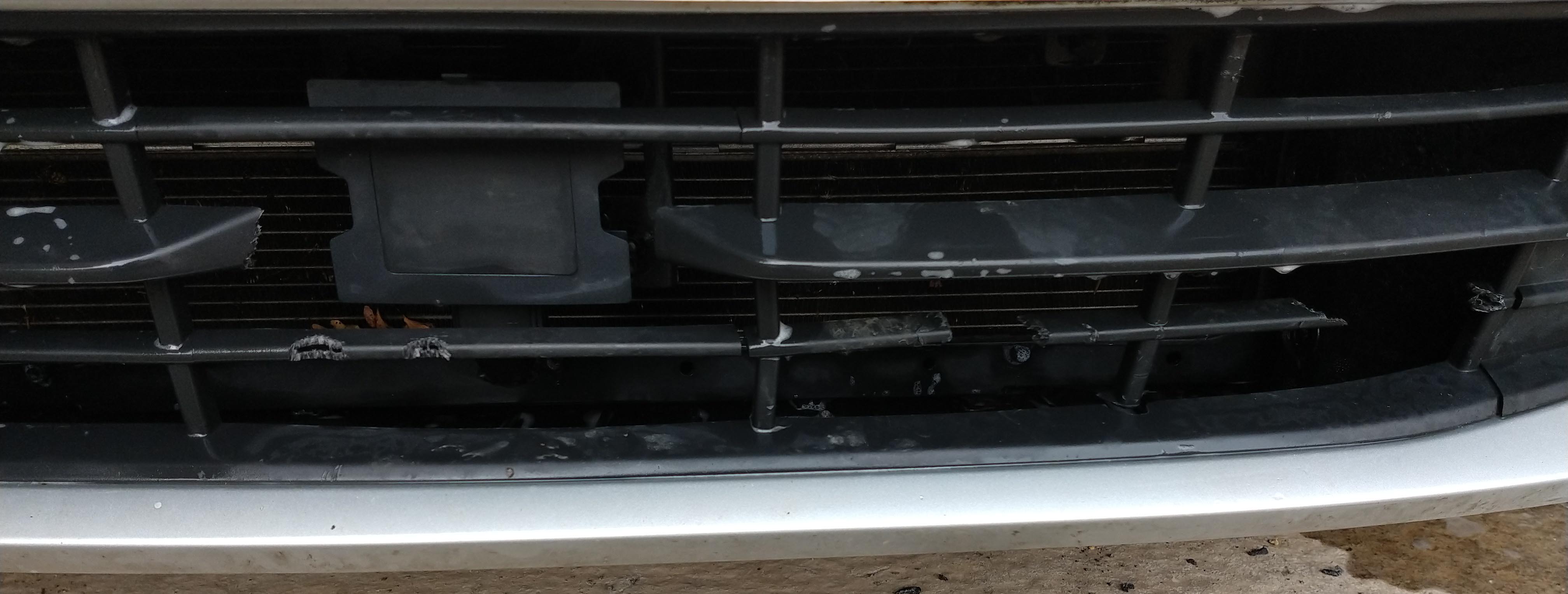

MK I lower grill cover did not survive a moving animal attack. This also broke the lower grill behind it.
So I have replaced the lower grill. Note you don't get the two spars above and below the Lidar Sensor in the middle of the grill when you buy one.
On a good note the Lidar sensor is all good / no damage / still working. Don't know if the Mk I cover offered any extra crash protection to it.
The new lower grill is now in place.
I have also made the MK II upper grill cover that fits behind the grill. Can you see it? ;)
