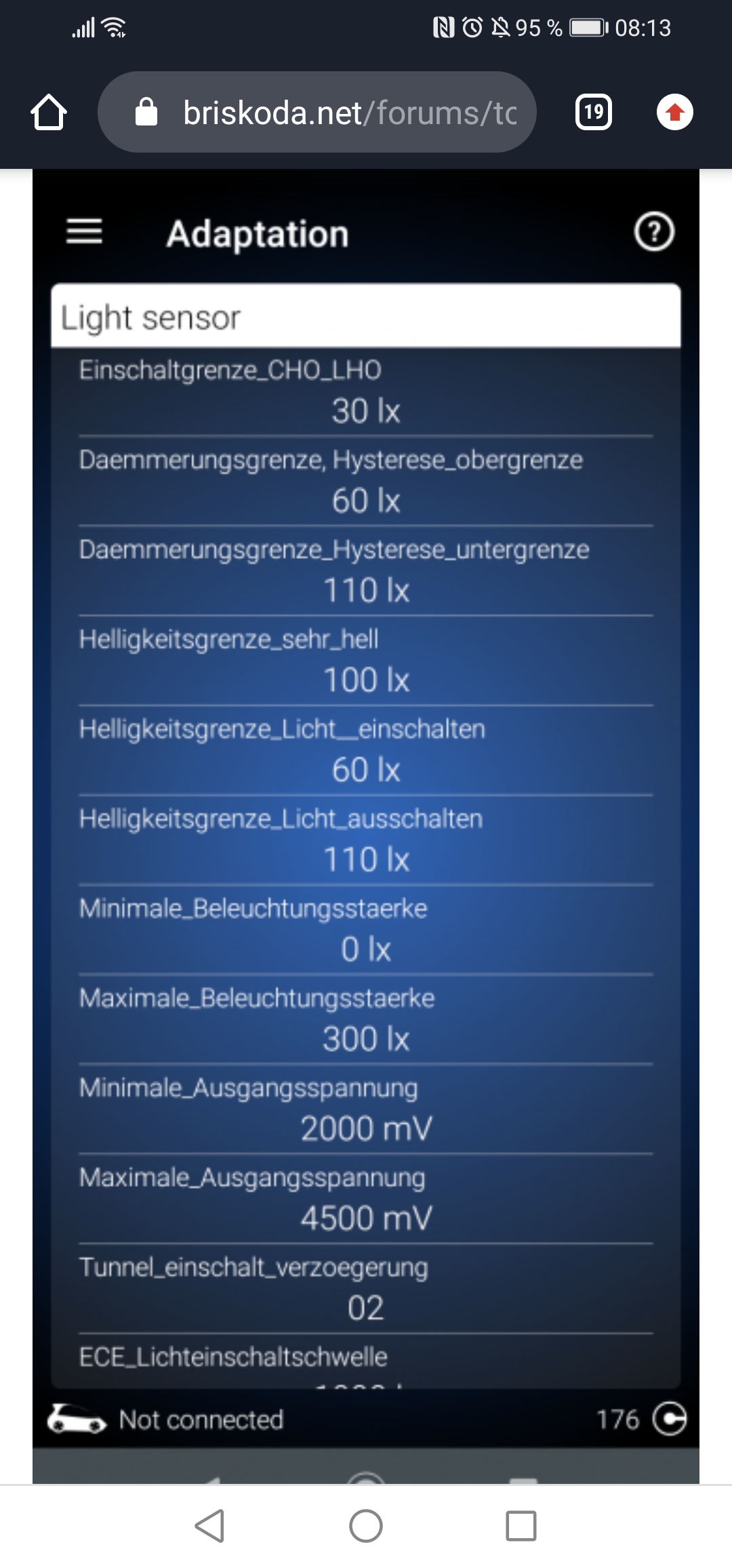

With vcds or other obd tool it is possible to adjust lumen level of switching point, plenty people did it, I drive very rare with high beams so for me it is working but sometimes fails.

I'm searching and I can't find it back, i found only this image which shows settings of light sensor.
With the way the auto/override works, it would be better to have a more sensitive setting, so the full beam is turned off more readily.
Now how to find this on VCDS
Just to point out, the coding and adaption channels can vary wildly between different versions of the cameras so just because one version can be tweaked, it doesn't mean they all can.
Looking at the screenshot from Frank, that looks like the RLS/RLHS sensor adaptions so can only tweak the auto headlights (on/off) rather than the high beam assist...
Certainly on the A5 camera as fitted to my MY18 Octavia, there are no obvious adjustments that can be made :sadsmile:
