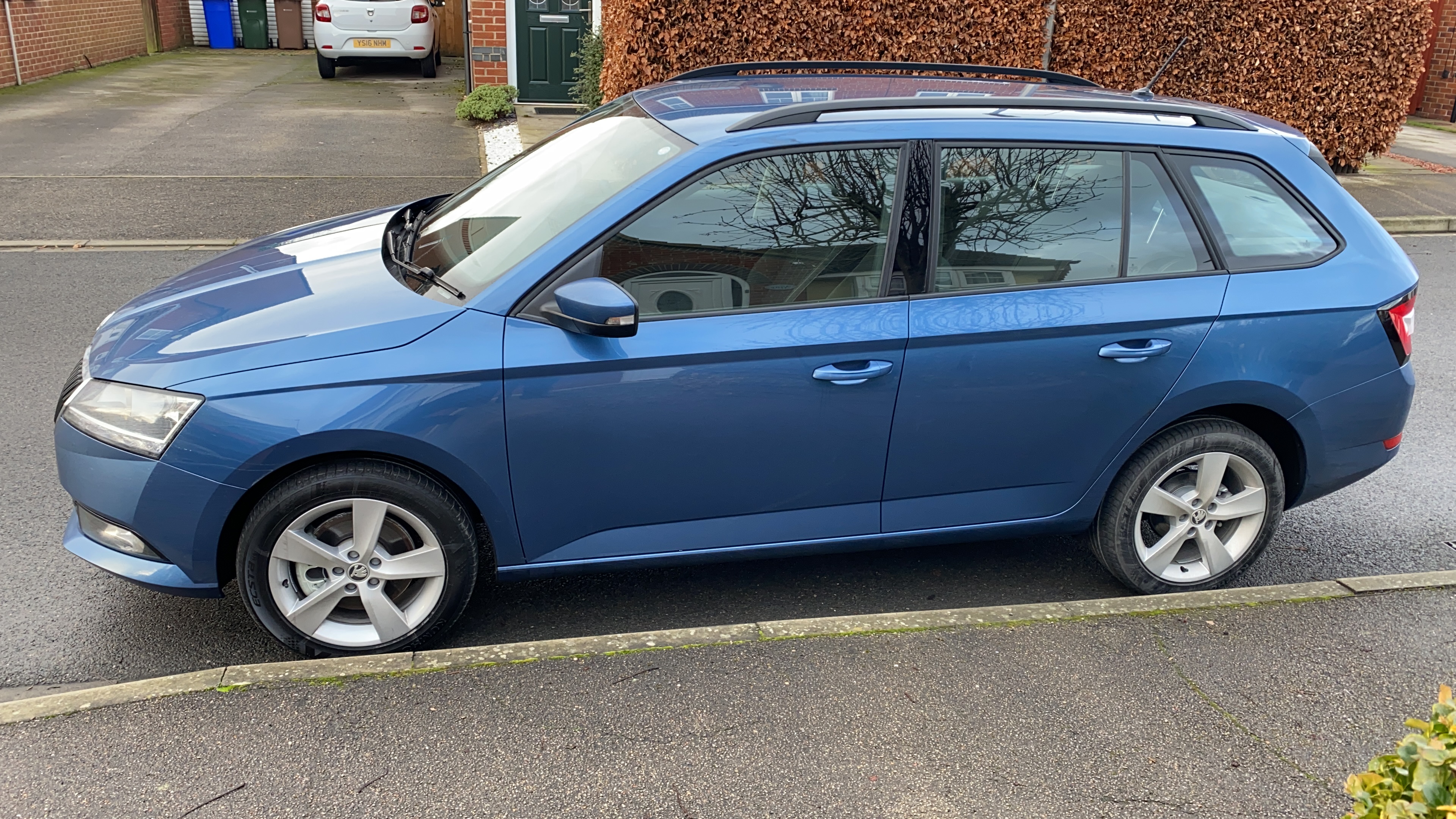

New car delivered yesterday and absolutely delighted. Looking forward to stretching it’s legs when the lockdown eventually eases 😀

Looks great.
