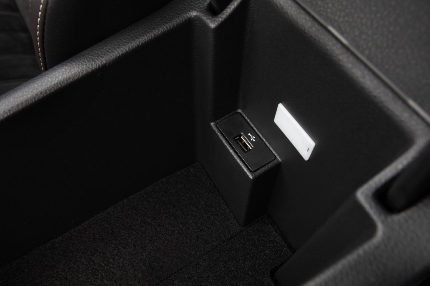

@ItalianJob- unfortunately a majority of Superbs do not have the additional USB port in the armrest console
I converted the rear 12V socket to dual USB ports so I can keep my Pixel 5 on wired charge when driving for 2+ hrs, with the Wireless Android Auto running.
When did the USB get added to the centre console?
it was an option in certain markets, on the pre-facelift Superb.
hence u would have the usual USB port under the climate control, and an additional one inside the centre arm console storage.
