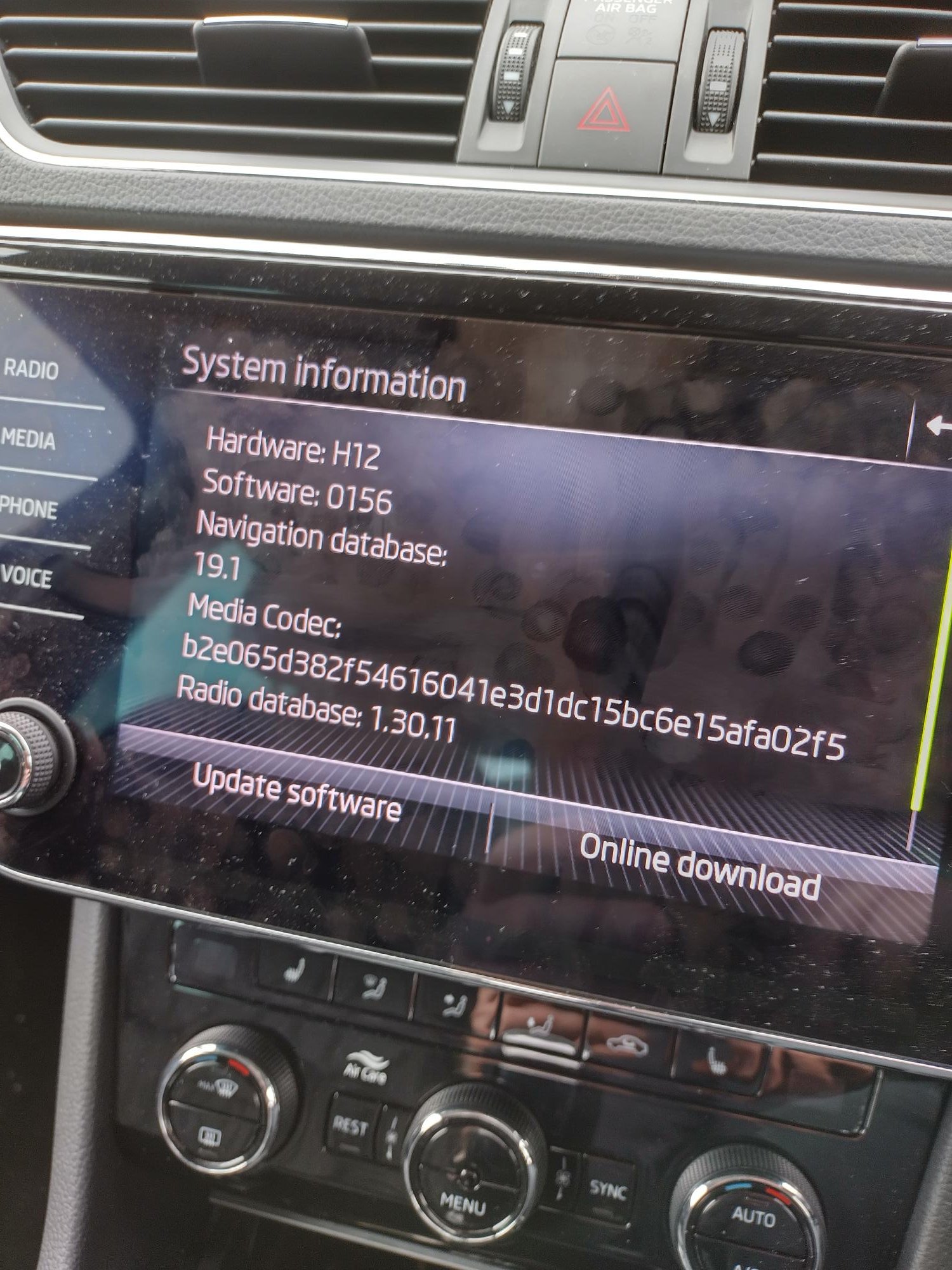

Guys, on my suburb iv, previously aawireless worked good, but had a problem with navigation, so dealer swapped out something, now nav works, but aawireless not working.
Could they have put a mib2.5 instead of mib3.0? How can i tell? What is the latest software, mine says 0156.
Any clues?
I imagine mib2.5 software wouldn't even load onto an mib3 unit.
Hang on, can you first clarify whether you are using an actual AAwireless device (that you plug into the usb port), or are you talking about an MIB3 unit with native android auto wireless?

Thanks for replying, to clarify, i am referring to native Android Auto wireless on the headunit,  (not the separate device)
Previously worked flawlessly, but since unit replacement by dealer, not working. (but it fixed nav issue)
teachsearchuk seems to have hit the nail, seems that the sw on the "new" unit is "old", and needs updating. I did not note the sw version when it was working.  Can i do this myself, or is it back to the dealer?
MIB 2.5 and MIB3 units r vastly different hardware & software wise.
An MIB2.5 will not work a mk3.5 (facelift) Superb, or on anything that came with an MIB3 unit originally.
I haven't heard of anyone retrofitting an MIB3 unit into a previous gen car, but it would involve changing a whole bunch of other control modules, including the gateway.
With regards to ur wireless Android Auto not working - the initial MIB3 units did not have wireless AA - they only did wireless CarPlay, and wired AA. It was only later that they added the hardware for it, with the newer units.
So if they swapped ur MIB3 unit with one of those older versions, then it would explain why u don't have wireless AA anymore.
Does Android Auto still work when u connect via the cable?
Edited by JR RS
Yes AA works with a cable.
You say that older units did not have the hardware to run AA. (rather than being a software issue).
So the physical unit is now not combatable.
This is concerning as a sw update may not restore the AA functionality,
here is a photo of the new unit details, maybe the numbers make sense to someone.....
If they updated something and it's broken, take it back.
Sorry, unfortunately I don't know which hardware revisions didn't have wireless AA, and which revisions onwards started having it.
Correct, the SW version alone may not fix it for u.
It's the HW version that u need to look for.
As @Patent said - take it back to them saying wireless AA no longer works for u.
Ask them for the part number of the unit they removed, including it's HW and SW version - so u can compare.
