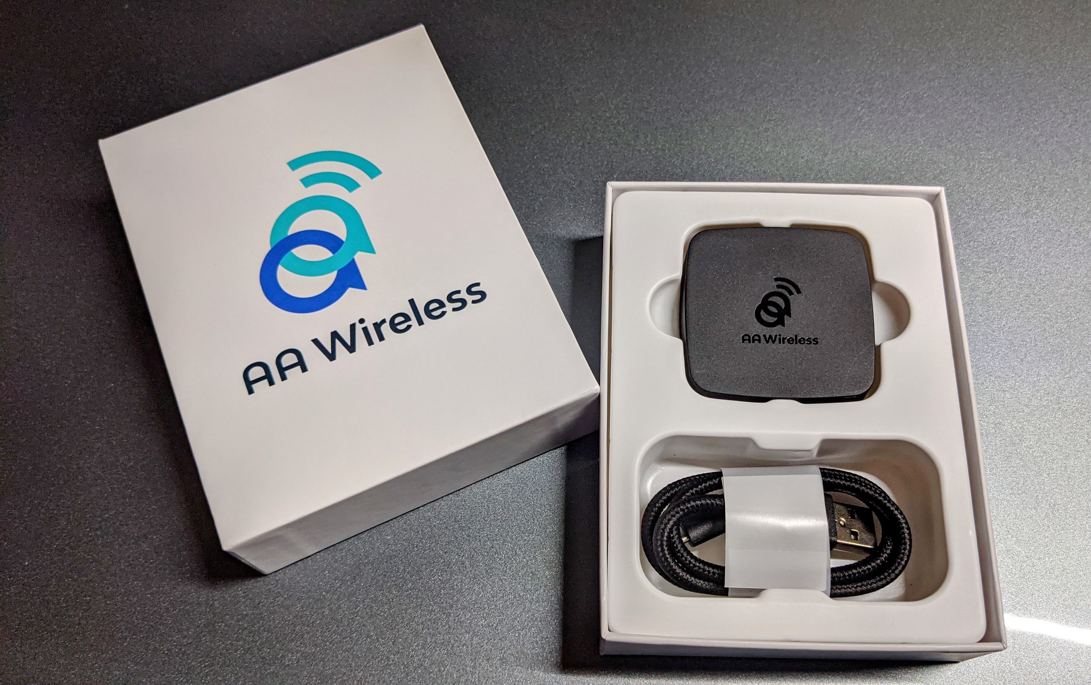

  • Sorry to dredge up this topic, but I just wanted to say that I got my AAwireless unit this week, and all is working well (with an MIB2 Columbus). There wasn't any customs duties or VAT to pay - the va

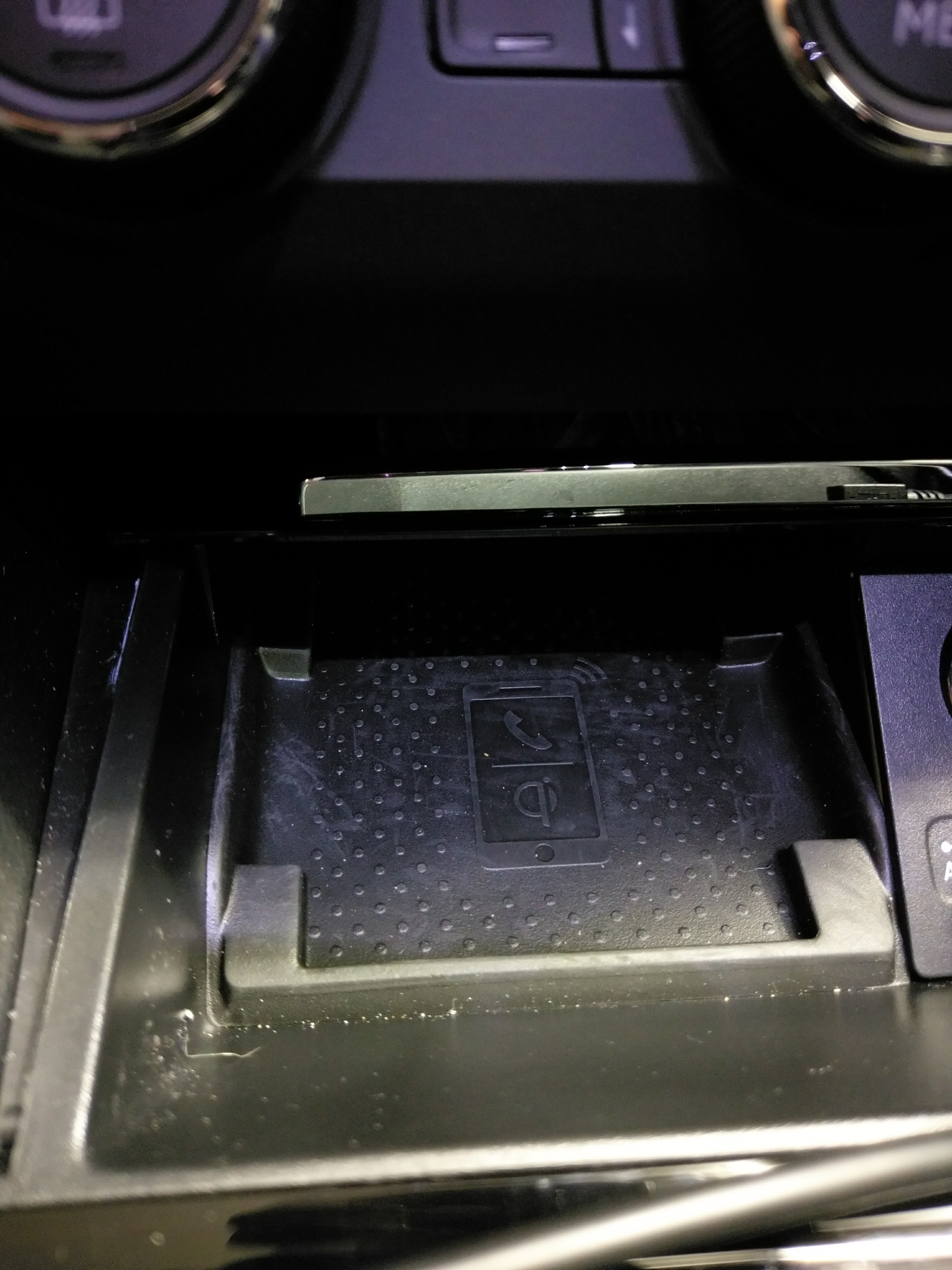

The Superb already comes with a Qi Wireless Charger in the phonebox.
Actually, no it doesn’t. Wireless Charging is now an optional extra at £270
I wonder if it varies by region, in any case mine also hasn't got one. A hunt around on ebay looks to be in order.

Sorry to dredge up this topic, but I just wanted to say that I got my AAwireless unit this week, and all is working well (with an MIB2 Columbus). There wasn't any customs duties or VAT to pay - the value was declared as £21. I got a shipping notification and It arrived 2 days later via Royal Mail tracked 48, even though the tracking never updated...

And i've still not found a wireless charging pad that will fit..
I’ll run you through the OEM fit next weekend when you come for the camera :) I still need to get one for mine as I sold the charge pad with the Octy.
my Google Pixel 5 fits in the factory Phone box wireless charger :thumbup:

Snap. If anyone else it thinking of getting one I can now add my voice to tier's - it was easy to set up and works well (with my S10) at least.

+1, I received mine today.
Was very easy to setup and it's working very well.
I've got an MY17 with an MIB2 unit, paired with a Google Pixel 5.
Well worth the wait.

I've had mine for 2 or 3 weeks. Aside from the fact it doesn't turn off and my phone keeps trying to connect when I'm in the house it's great. I think there is a fix in the app but I have found it hard to get the settings to save thus far. An app update the other day may have helped. Not had a chance to check yet.
I wonder why vw and skoda are different - my usb turns off.
As you say, there is a setting that should help (if it saves)
