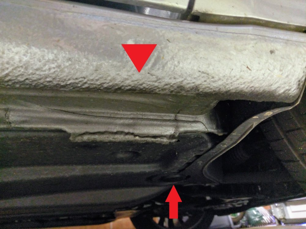

Since you have stands I would recommend using them. I put mine in the location suggested by @JR RS that will not get in the way of your jack:
