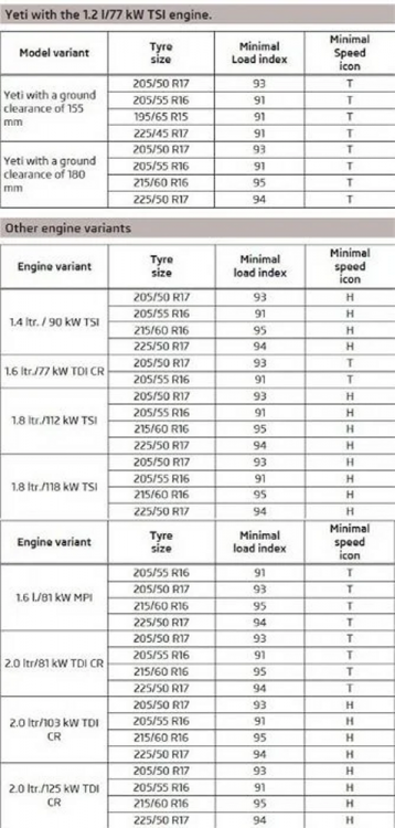

From the below chart that is in the November 2014 Yeti owner's manual:
The smaller outside diameter 205/55R16 and 205/50R17 tyres are the normal sizes for the 1.6 diesel, but for the 1.6 petrol, the bigger outside diameter 215/60R16 and 225/50R17 are the normal tyre sizes.
205/55R16 and 205/50R17 are winter tyre sizes that can be used with snow chains, and all Yeti's can use those. However, on the 1.6 diesel 205/55R16 and 205/50R17 are also used on normal summer tyre sizes.
What may be surprising, is that the 1.6 diesel can't use 195/65R15 and 225/45R17 tyres like the 1.2 petrol with low ground clearance (155mm).
I suggest you give the seller these three OEM part numbers, as they should have all of the 205/55R16, 205/50R17, 215/60R16, and 225/50R17 tyre sizes printed on them along with their tyre pressures. I expect they cost less than 1 Euro each from Skoda parts departments, as they are only white labels that are stuck inside the fuel filler flap.
White labels for inside of fuel filler flap, with 205/55R16 91T, 205/50R17 93T, 215/60R16 95T, and 225/50/R17 94T tyre sizes listed on them showing tyre pressures

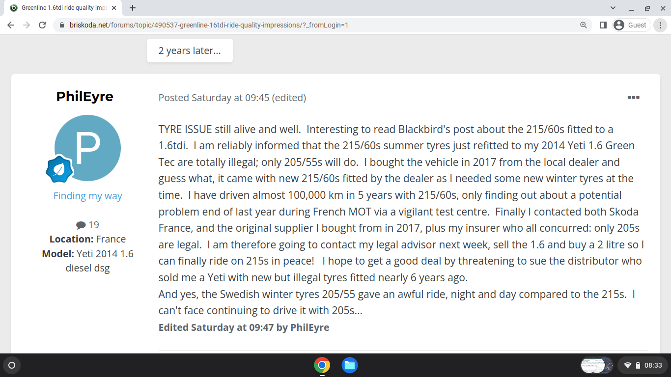

On 06/05/2023 at 09:45, PhilEyre said:
TYRE ISSUE still alive and well.  Interesting to read Blackbird's post about the 215/60s fitted to a 1.6tdi.  I am reliably informed that the 215/60s summer tyres just refitted to my 2014 Yeti 1.6 Green Tec are totally illegal; only 205/55s will do.  I bought the vehicle in 2017 from the local dealer and guess what, it came with new 215/60s fitted by the dealer as I needed some new winter tyres at the time.  I have driven almost 100,000 km in 5 years with 215/60s, only finding out about a potential problem end of last year during French MOT via a vigilant test centre.  Finally I contacted both Skoda France, and the original supplier I bought from in 2017, plus my insurer who all concurred: only 205s are legal.  I am therefore going to contact my legal advisor next week, sell the 1.6 and buy a 2 litre so I can finally ride on 215s in peace!   I hope to get a good deal by threatening to sue the distributor who sold me a Yeti with new but illegal tyres fitted nearly 6 years ago.
And yes, the Swedish winter tyres 205/55 gave an awful ride, night and day compared to the 215s.  I can't face continuing to drive it with 205s...
The 215/60 16" are NOT an illegal size for a Yeti just something the Greenline 1.6 TDI does not normally come with but are homologated size for a Skoda Yeti!

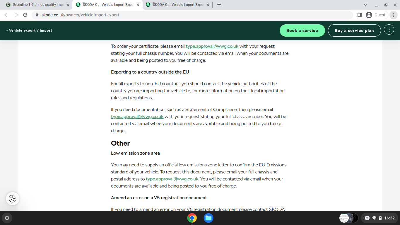

In the UK you can get the certificate of conformity for your actual vehicle free from Skoda.  This includes the tyre sizes that are homolgated for use on the vehicle (well, it does on mine, anyway).  See this Skoda UK web page:
Quote
If you are exporting or importing a vehicle produced since 1997 from another EU country, you’ll need a European Certificate of Conformity (COC) for the DVLA. The COC is an official document issued to all vehicles built to be sold and registered within the EU. The certificate confirms the vehicle has been tested and meets EU Type Approval standards.This official document is recognised by all relevant authorities.
The certificate is not available for passenger vehicles pre 1997. In this instance contact the vehicle authorities of the country of import for more information on their local importation rules and regulations.
To order your certificate, please email *****@*****.tld with your request stating your full chassis number. You will be contacted via email when your documents are available and being posted to you free of charge.
Does Skoda France (or whatever they're called) not have similar information on their web site?
I suppose you could even try sending your Yeti's chassis number to that e-mail address, telling them that you're moving to the UK and need the COC for the DVLA, and see what they say.
