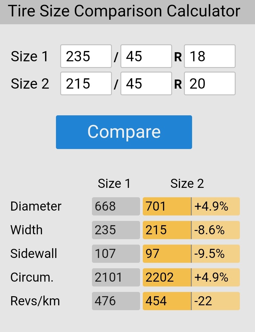

Increasing wheel Overall Diameter by 4.9%
Don't think it should affect haldex much as same overall diameter on all 4, but what about ABS, ESC, and wheel well clearance? I accept the effect on speedo reading (which would probably make it more  accurate..)

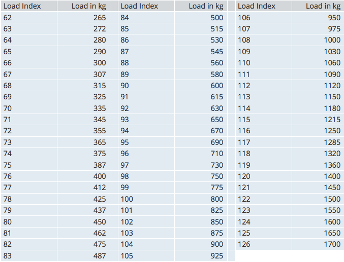

The load index of 225/35R20 XL (eXtra Load) tyres is only 90 (600kg) and that's not enough for the Superb MK3.

Outside diameter of 215/45R20 is 701.5mm
Outside diameter of 235/40R20 is 696mm
So when the front has 2.75mm of tread wear, it will equal the outside diameter of the rear tyre.
Or in percentage terms, the front tyre has an outside diameter 0.8% more than the rear.

@AIVal - have u considered the minimum load rating required for the Superb?
i c ur talking about circumference/diameter, rim sizes etc etc. but i don't see anything on the load rating, which is a critical factor.
58 minutes ago, JR RS said:
+1.
Without breaking it down into individual axial load, 2800kg based on Carlstons latest suggestion above (2x96 rated, 2x95 rated) , 2720kg if I run with the 4x 215/45/20 Potenzas currently on the rims (4x 95 rated), and if I stick with my original plan of 4x 225/35/20s, 2400kg (90 rated). With a full tank, driver and luggage, my car is hitting about 1800kg, so I think load rating is well within reason, even if in some alternative universe I allowed 3x fat chicks in the car.

Massively good insights, thanks so much for taking the time. I'd never heard of 245 being considered on a 7.5j, I thought the notion of 235 was already extreme, but then I guess a lot of it comes down to how much sidewall you have to play with.
The 0.8% difference in front /back Overall Diameter in your suggestion is pretty well within limits of haldex tolerance which I hear quoted as OK up to 3 or 4%.
Another beauty about your suggestion is that I can keep the 4x 215/45/20 Potenzas on the rims, taking the 2x off the back and keeping them as spares for the front, uprating the back to 235/40/20, which the Potenzas are available in.
But.. I _think_ Your staggered 235 and 215 suggestion doesn't give me much benefit over 225/35 all round (basing just on average tyre widths, its going to get hella technical v quickly if we start getting into contact patches, although happy to listen if you know that stuff well, I don't)
and if I go 225 all round, I can stay really close to the original manufacturer specced overall diameter, 0% difference front to back for haldex, and by not staggering I also feel like I'm staying closer to what's known, tried and tested.
Sorry, ur not making any sense.
As long as u got it covered :thumbup:
According to the fuel flap, the minimum load ratings r as follows:-
215/60R16 = min 95
215/55R17 = min 94
235/45R18 = min 94
235/40R19 = min 96
I don't know what the minimum load rating for a Superb is with 20" rims, let alone 215/45R20.
On the Arteon, a similar sized car to the Superb, from the VWAG family, states min 95 with 245/35R20.

Each tyre rated to take that much weight at its max rated speed. Of course should also consider that more of the car's weight may be over the front axle as opposed to back etc, hence my point about axial load. It's well within spec IMHO

https://en.wikipedia.org/wiki/BMW_i8
PROXES SPORT
Answering the need for superior handling, new Proxes Sport was designed as a focused, sports performance tyre.
  Tire Size Tread Depth (mm) Overall Diameter (mm) Overall Width (mm) Approved Rim Width Range (inch)
zoom-icon.png 225/35 ZR20 90Y XL 7.3 666 230 7.5-8.0-9.0
PROXES SPORT
zoom-icon.png 245/45 ZR20 103Y XL 7.7 728 243 7.5-8.0-9.0
As you can see above, both 225/35 and 245/45 have an approved rim width range of 7.5" to 9".

To keep the car legal, you need tyres that can support the maximum rated load of each axle. I would stick to at least 94 (670kg), as this is lowest load index mentioned on the fuel filler flap. It would be very easy for an insurance assessor to refuse a claim if he sees 90 (600kg) load rated tyres on a Superb MK3...and 225/35R20 really stand out as not being able to support the necessary weight.
