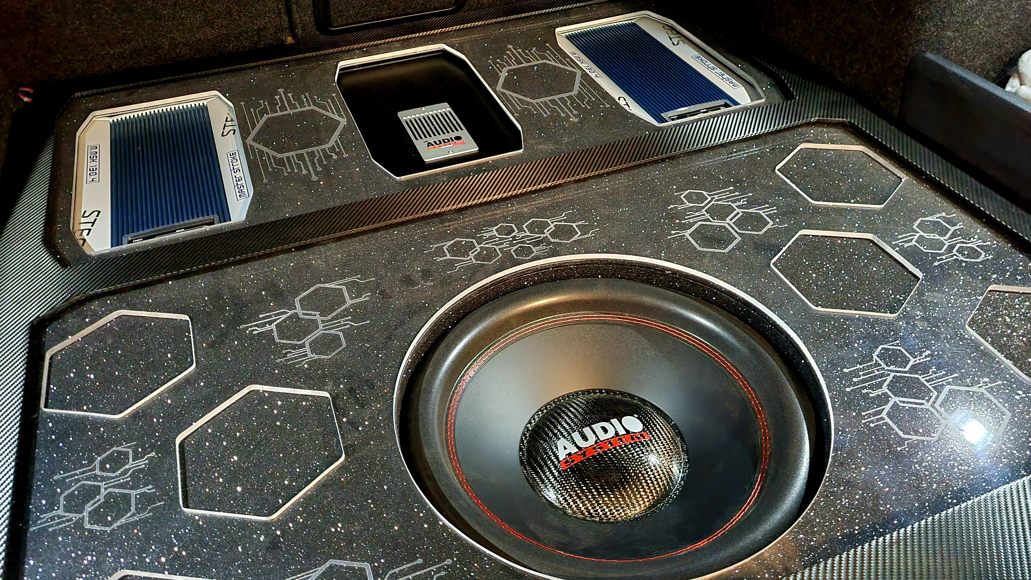

  • And here's my final setup. 1000w JBL in custom enclosed box with the right amp. Kept the canton sub connected also, why not. No other changes to the oem speakers. Not a huge change in "

Sound system upgrade by changing the sub and amplifier. Lowbidget devices but with a lot of improvement comparing to oem canton mini sub. I wanted more bass

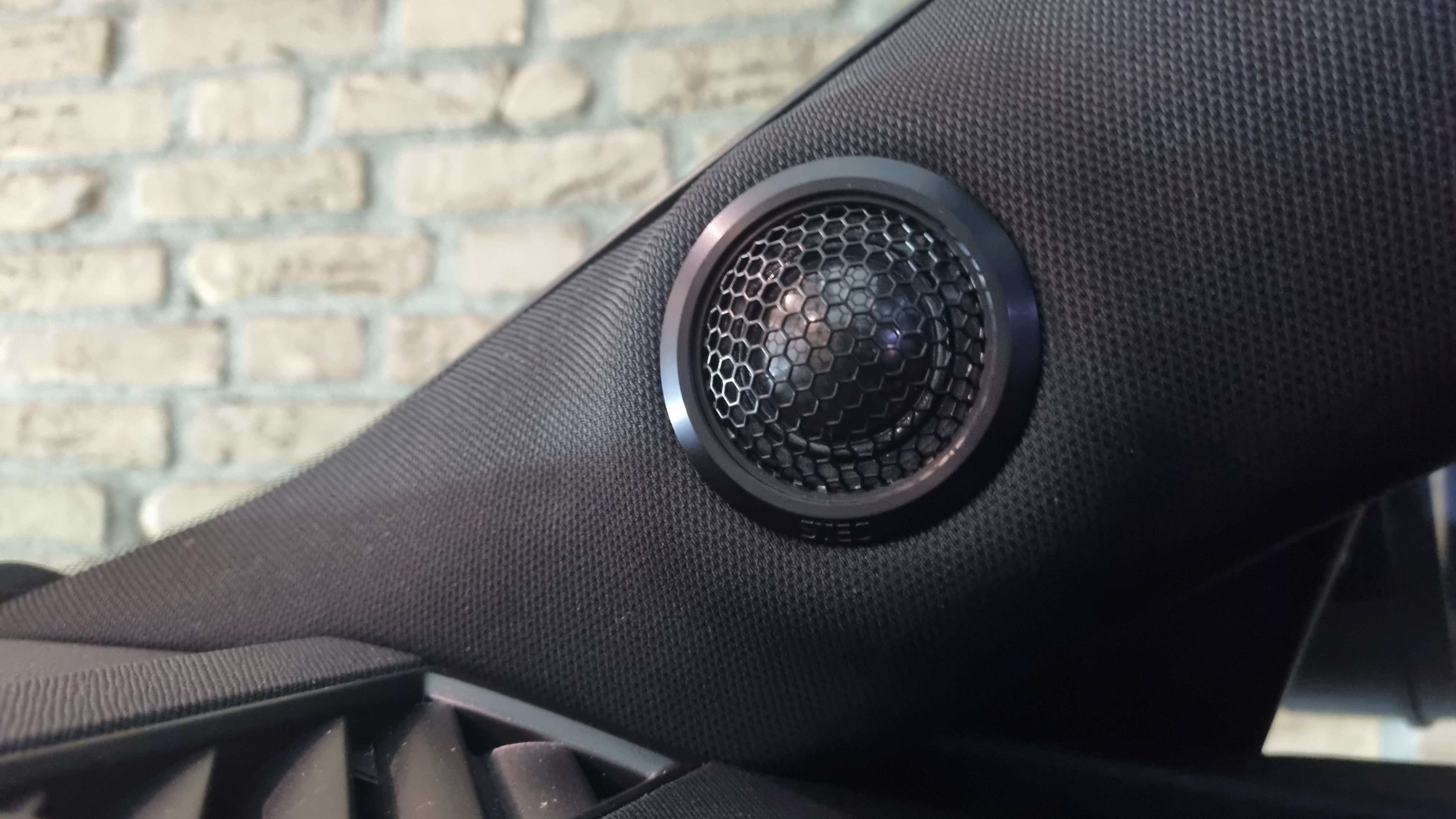

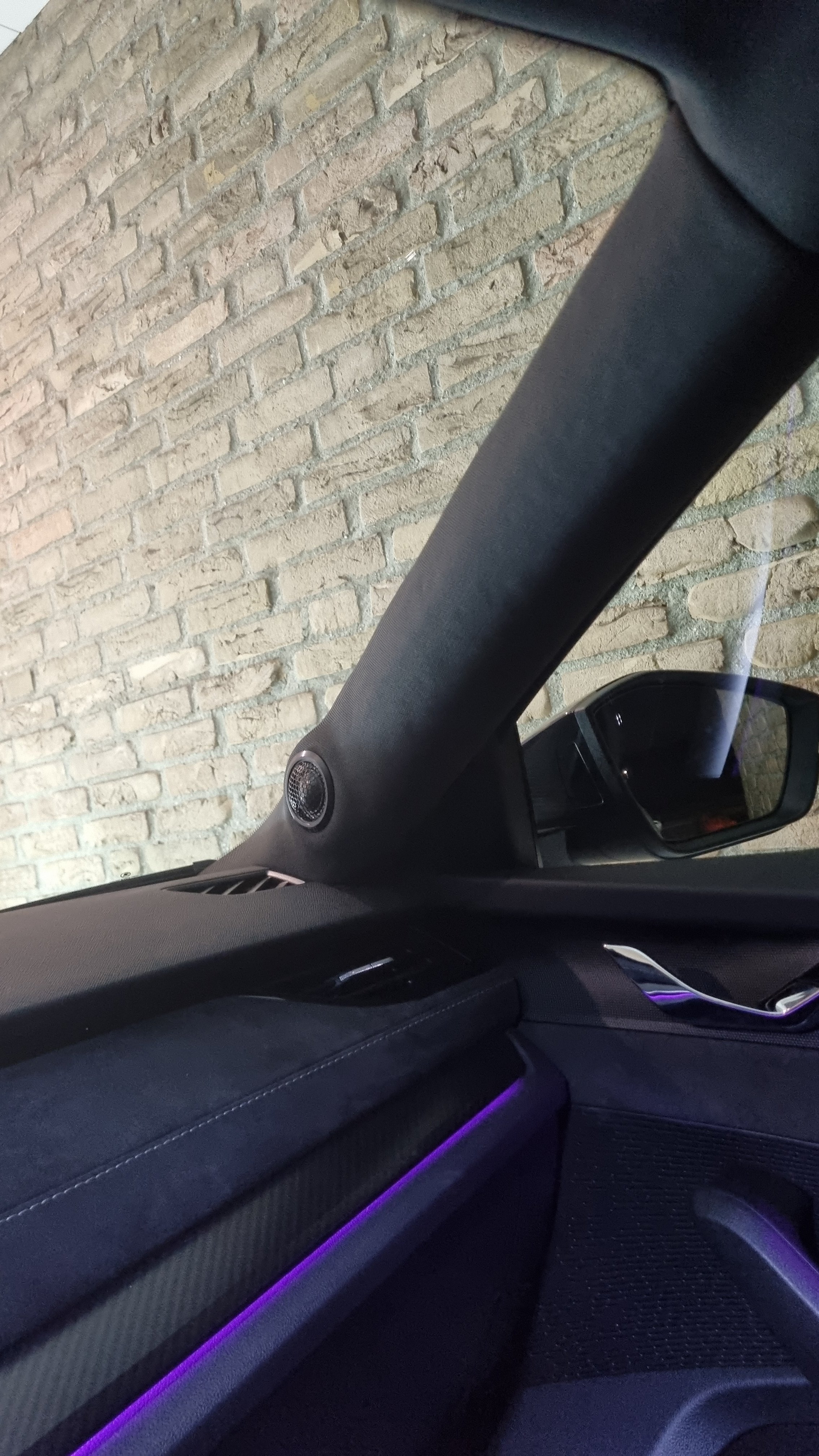

Put midrange on pillars and tweeters on the triangle of the rearviews mirrors. Mine will be like this 😃
