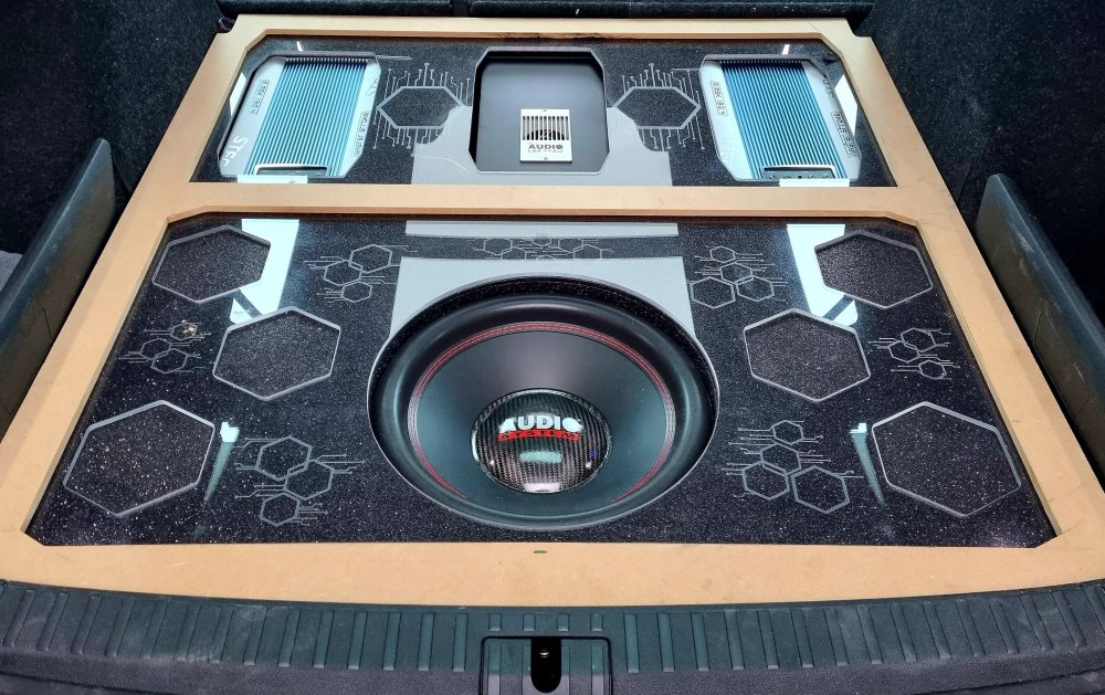

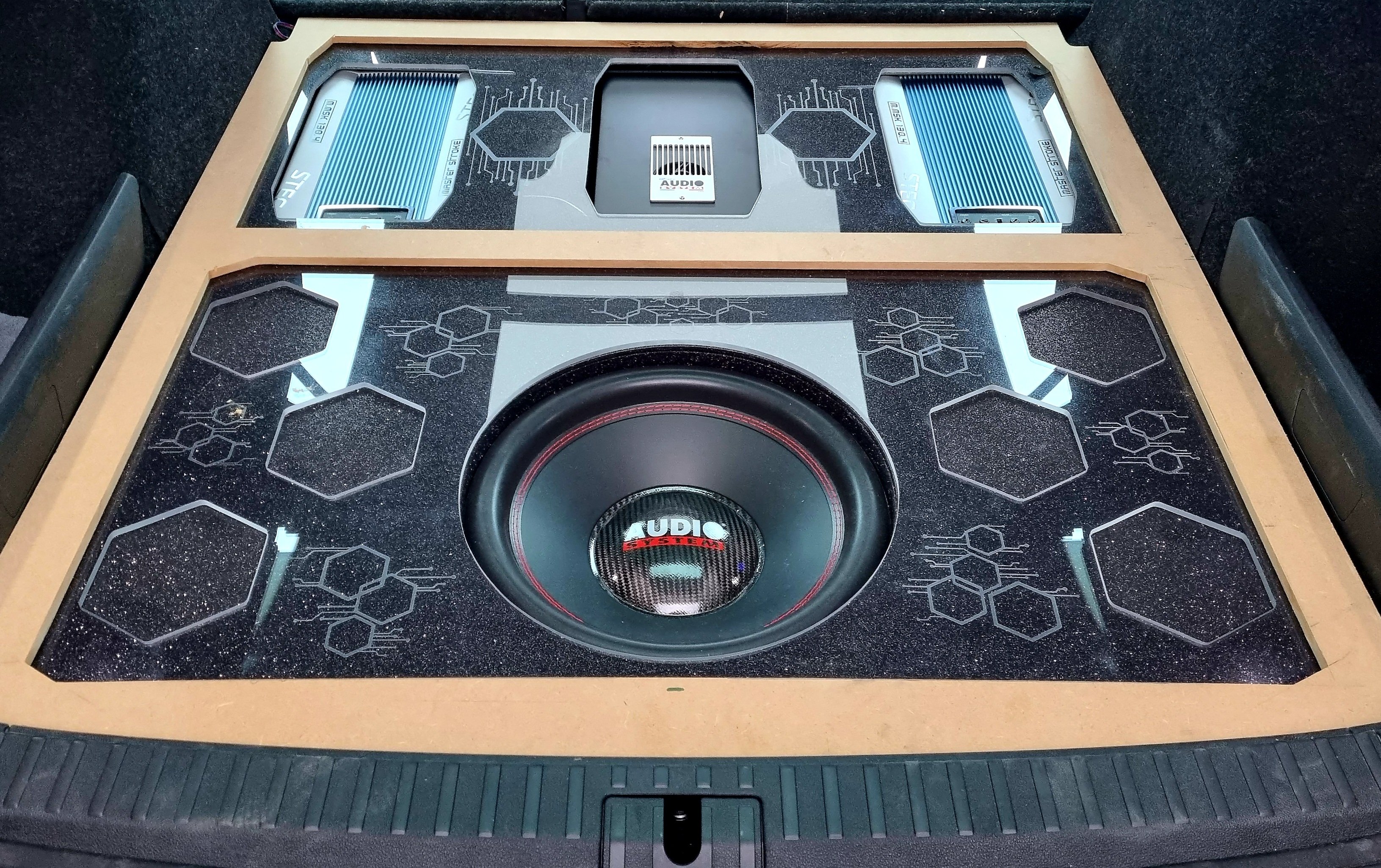

  • And here's my final setup. 1000w JBL in custom enclosed box with the right amp. Kept the canton sub connected also, why not. No other changes to the oem speakers. Not a huge change in "

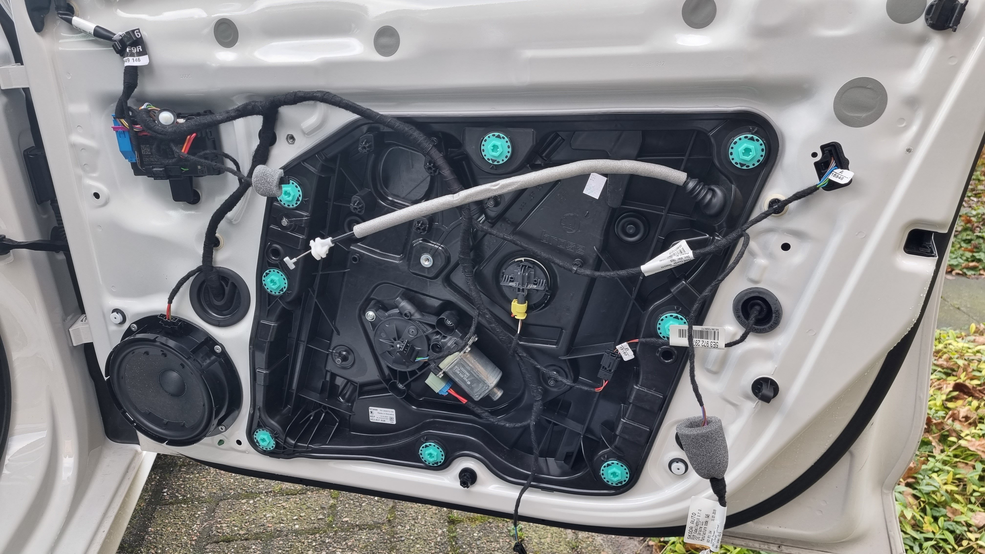

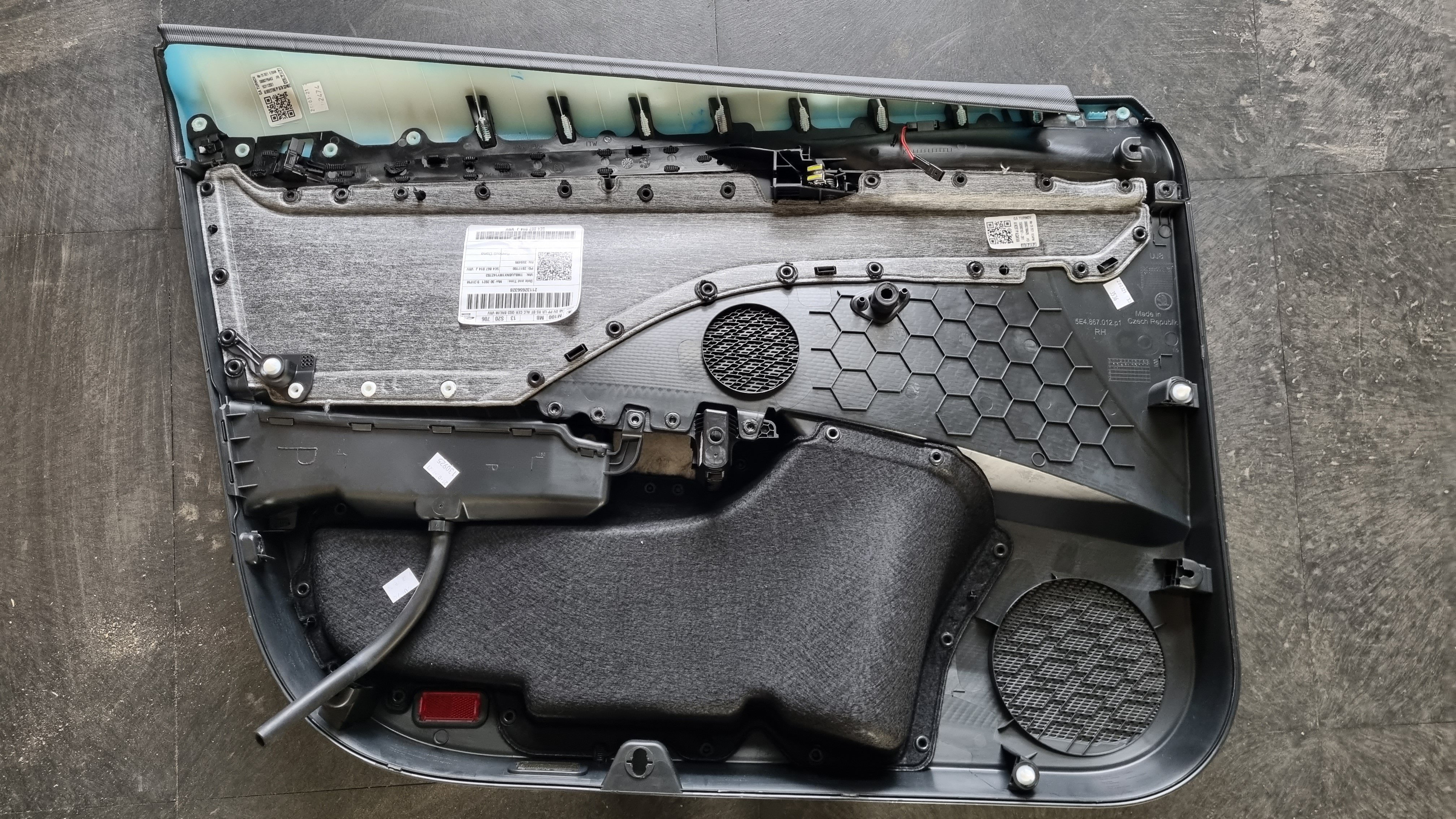

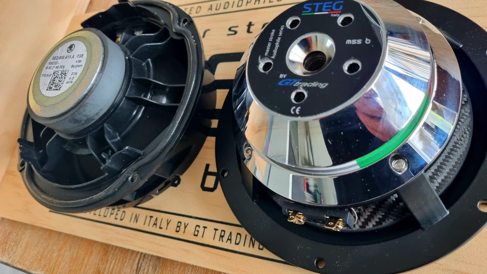

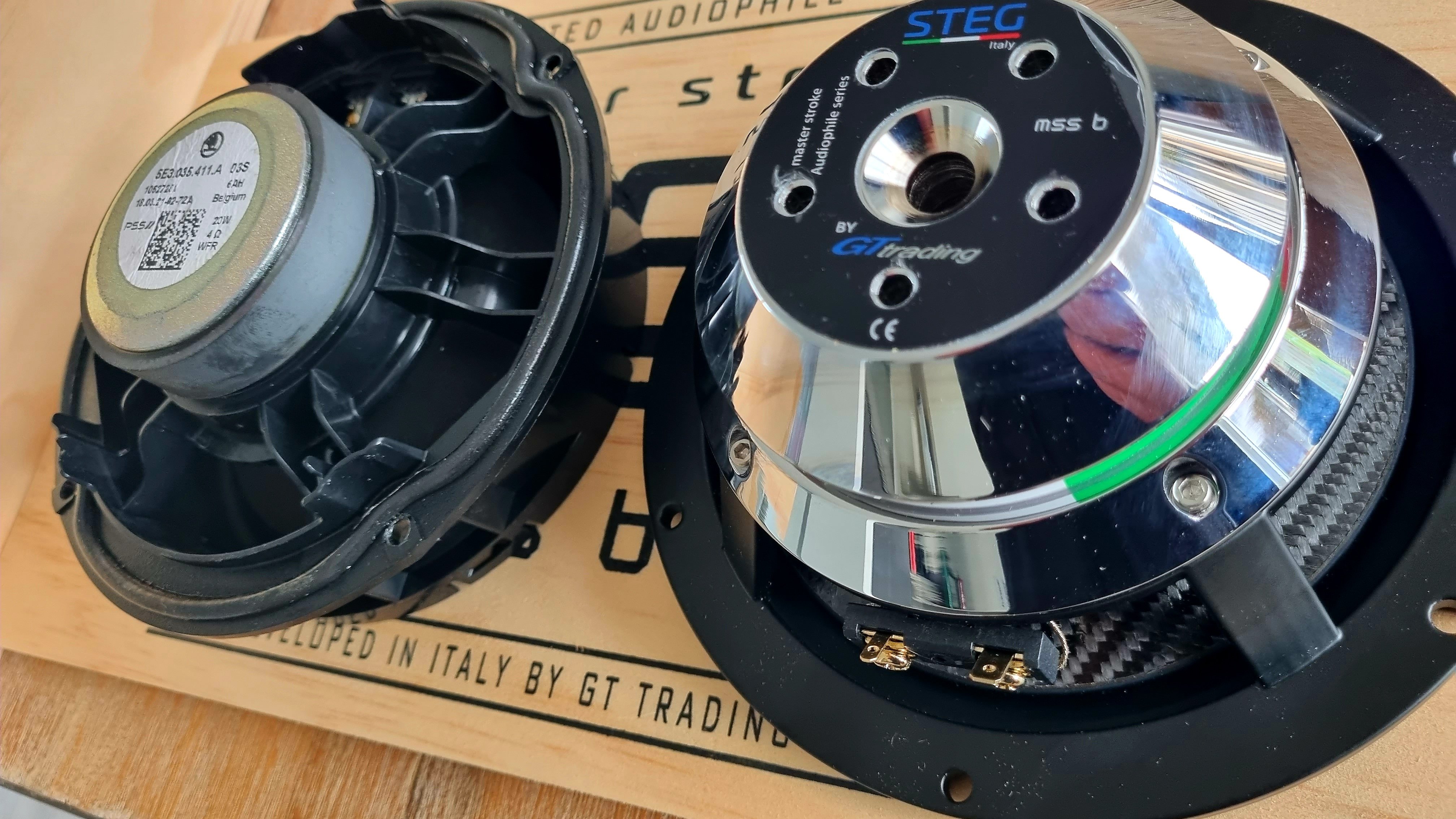

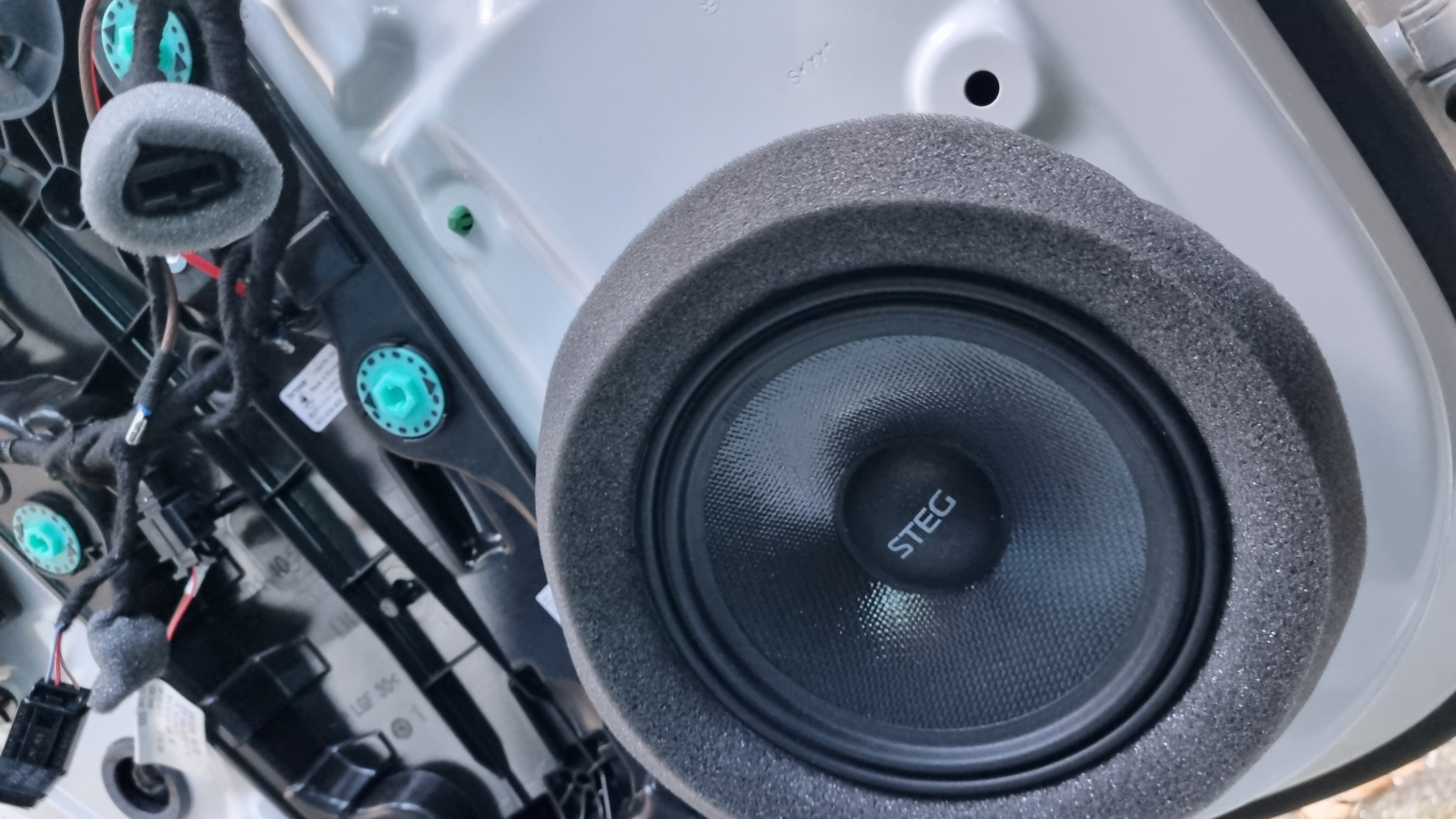

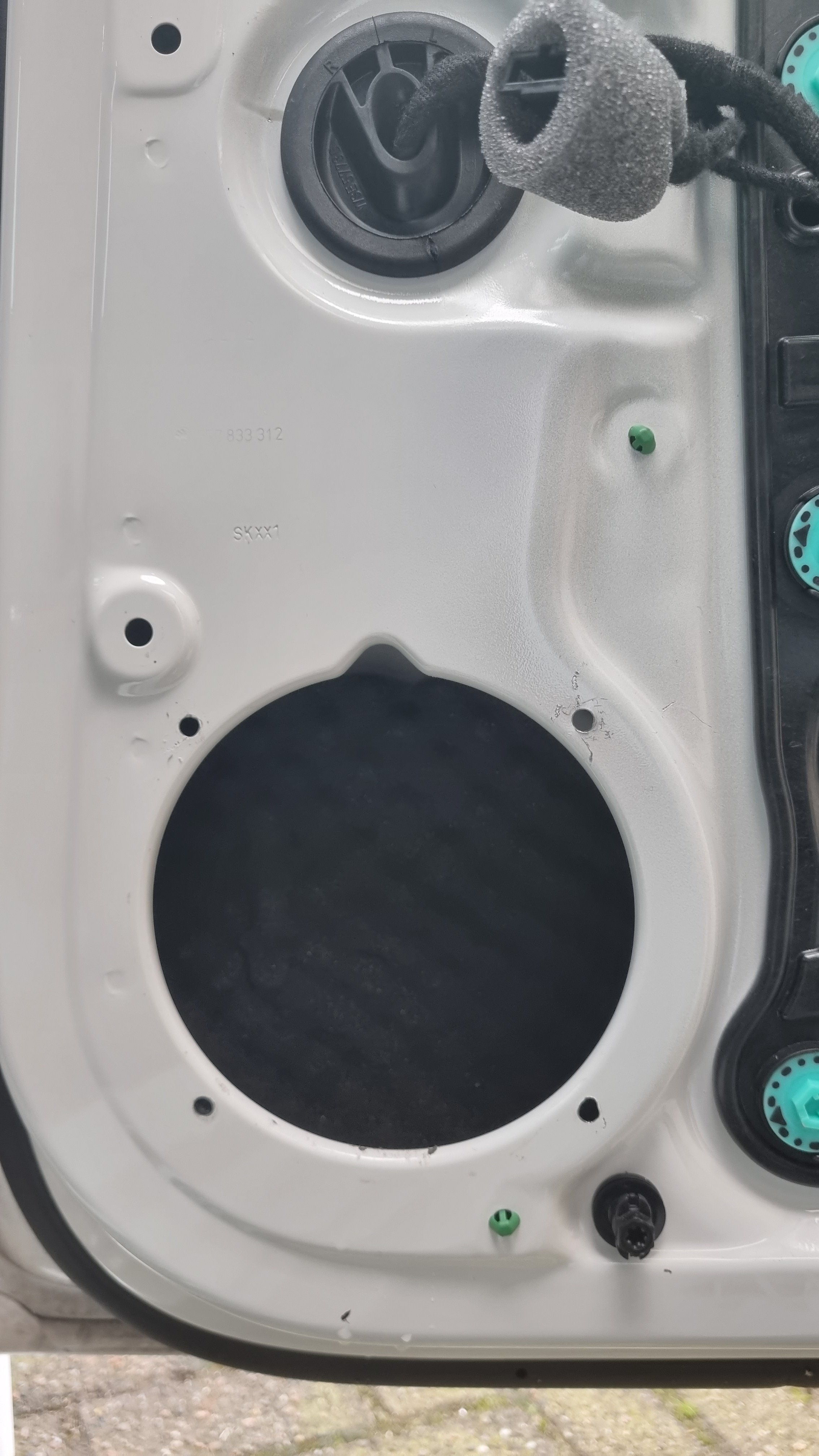

Quick update: Started with the front door midbass replacement.
I guess when having Canton, the middriver is just hooked up in same wiring as the midbass driver (but with a high pass /low pass filter on it).
1. remove handle gentile starting at bottom with a wig, work upwards, dont be too afraid using force
2. turn at the bottom of the panel the hexagon head
3. remove screw behind small plastic clip at side of panel
4. remove the 2 bolts behind door handle
5. work with a wig unclipping the white clips (some will stay on the door, you have to remove the later and put back on panel before mounting again).
6. when all clips are loose, use gentile force to move panel upwards
7. undo all cable connectors, can be some work
8. dismantle the doorhandle cable
Finish :)

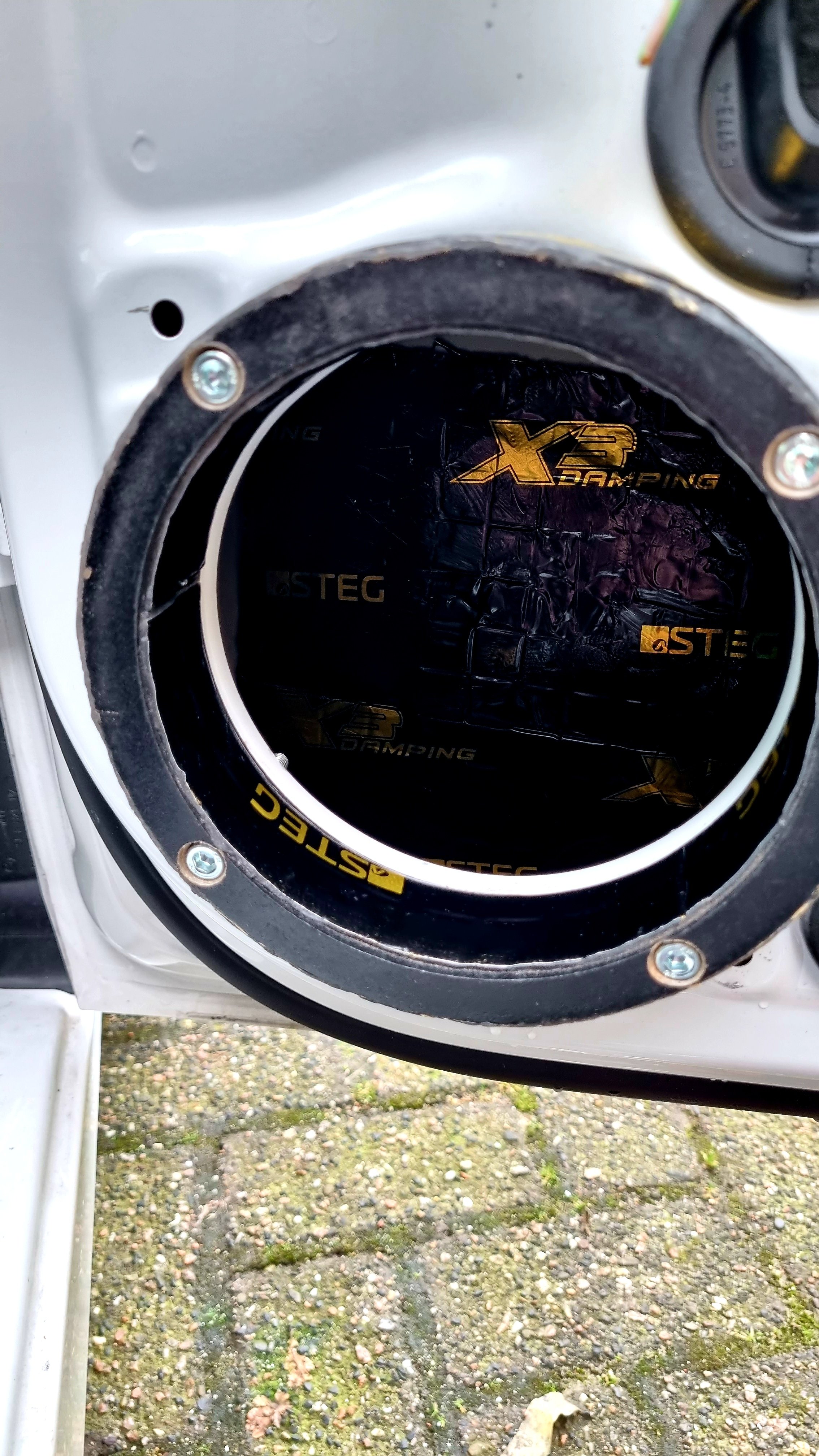

  • before applying sound deadening, degrease the panel work VERY well, at bottom they use Vaseline against corrosion protection, avoid rubbing it out

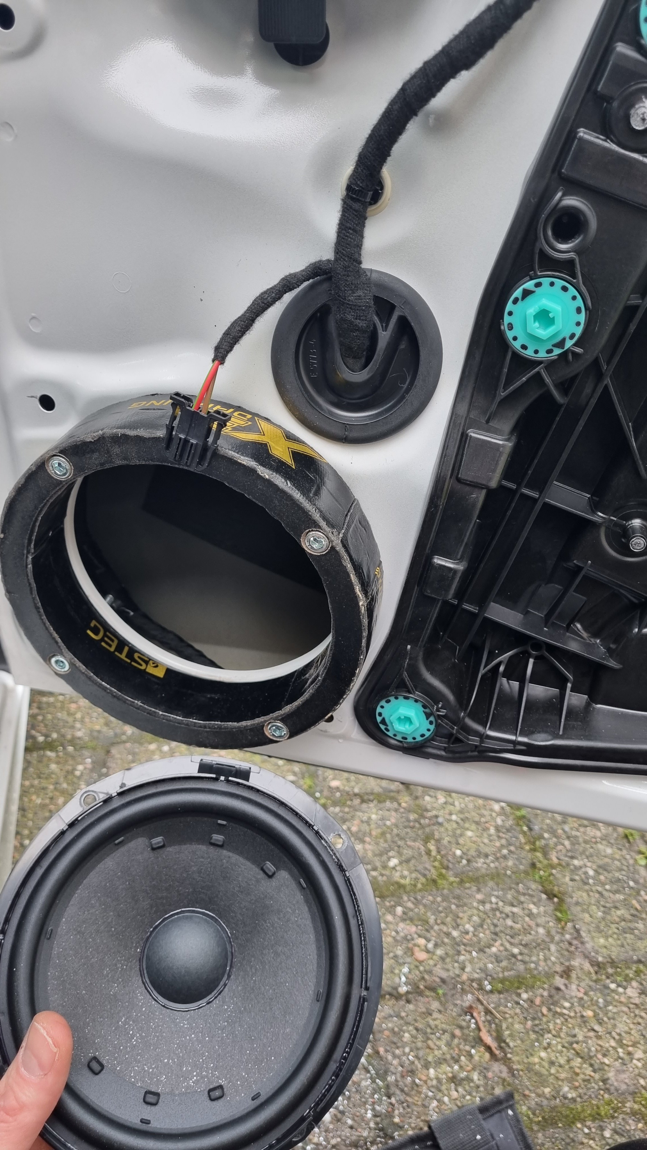

  • Apply sound deadening (for now I did not take out the complete plastic panel with the window mechanism, the doors already are having great structure).
  • Apply foam deadening behind speaker

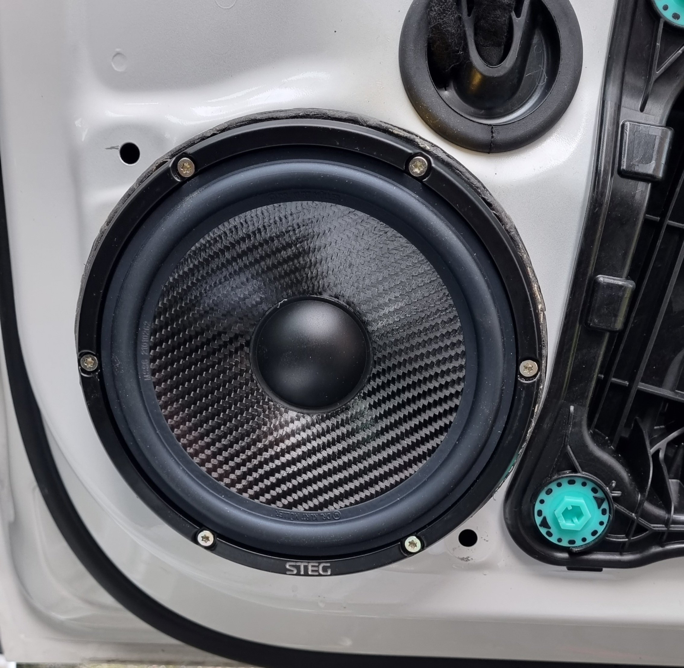

  • mounted the speaker adapters for 16.5cm midbass drivers
  • mounted the speakers and added foam arround the speaker
  • Apply sound deadening at the panel (all kinds can be used, but I prefer to first listen to rattles and hear what I should add and where.
  • I blocked off the original midrange places with sound deadener to avoid it having it work as a leakage
  • Put back the panel

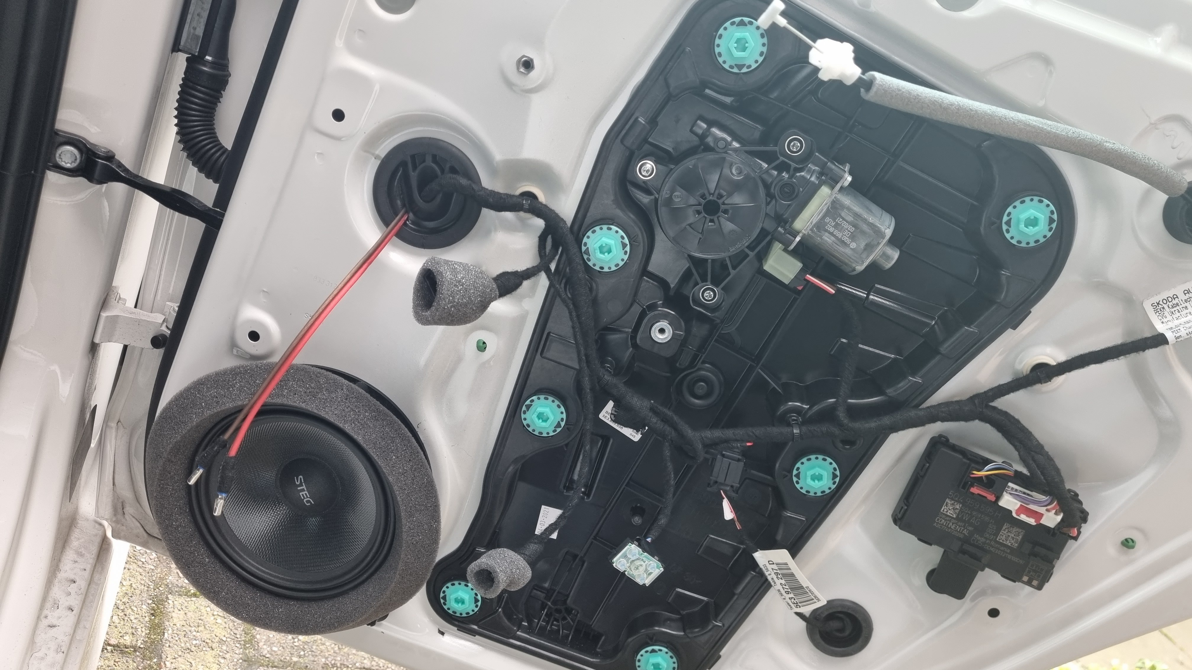

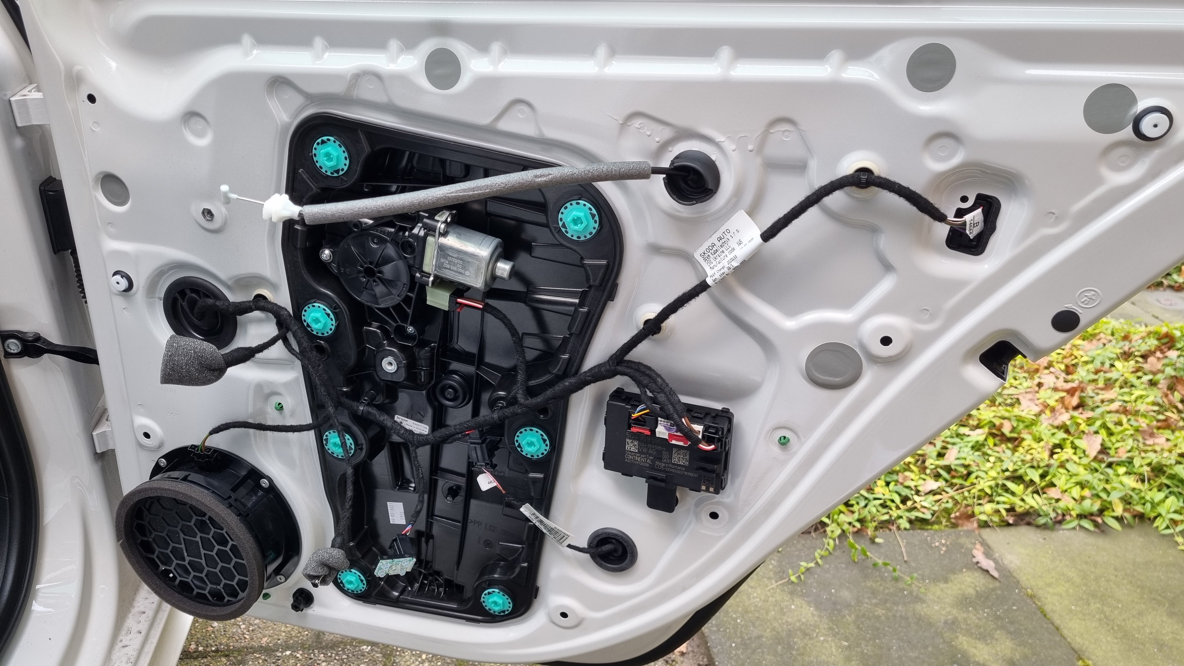

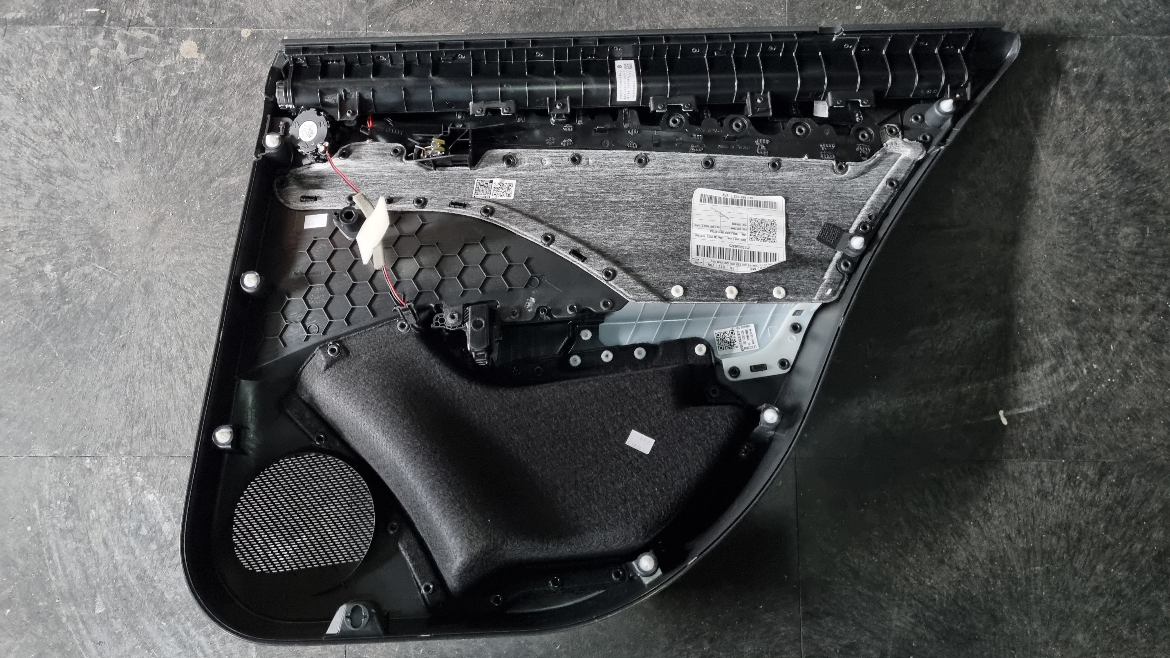

Rear panels:
3. remove the 2 bolts behind door handle
4. If possible (can be done later), remove the electrical window panel, remove the switch from it
8. dismantle the door handle cable
9. take of panel

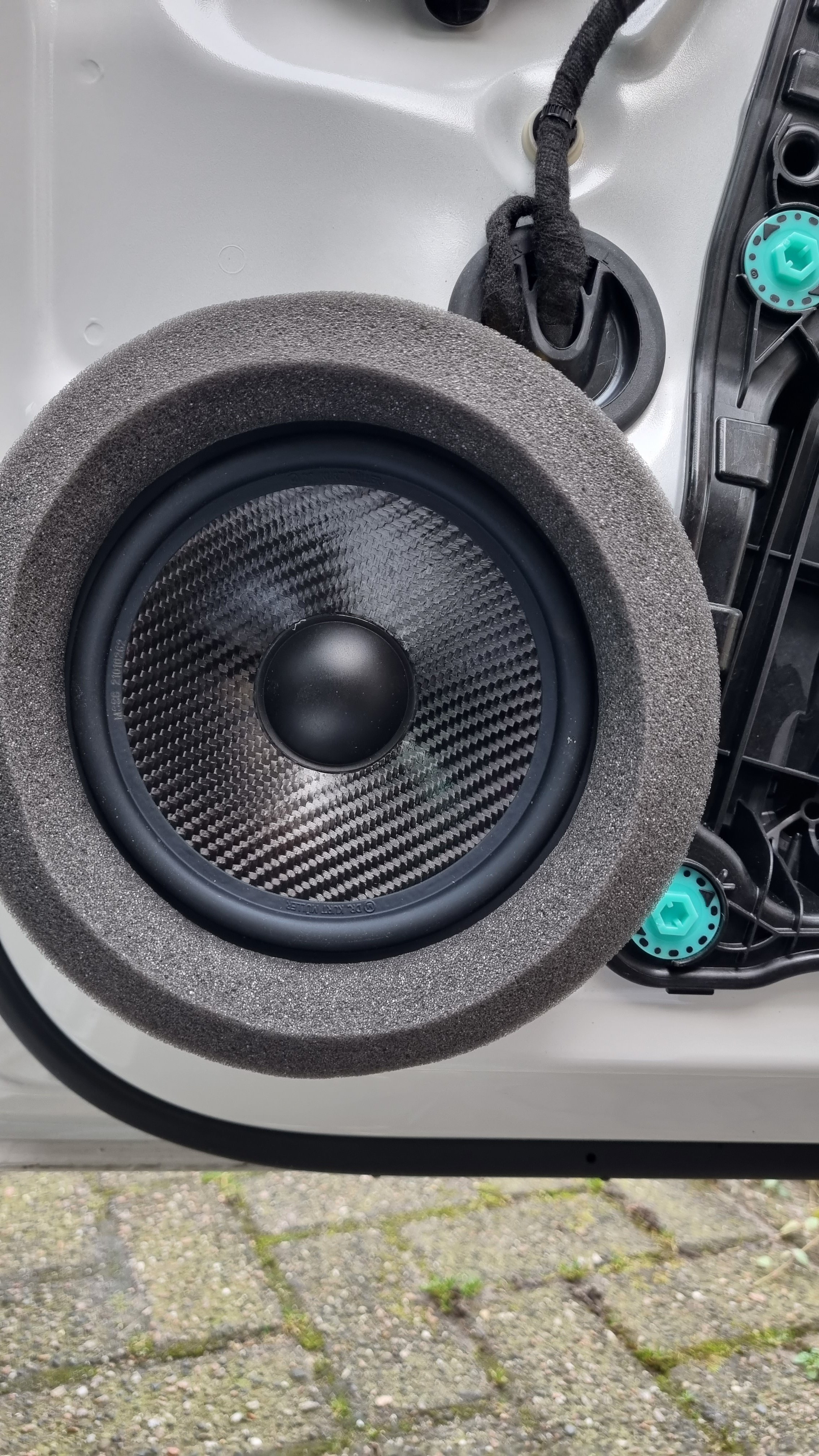

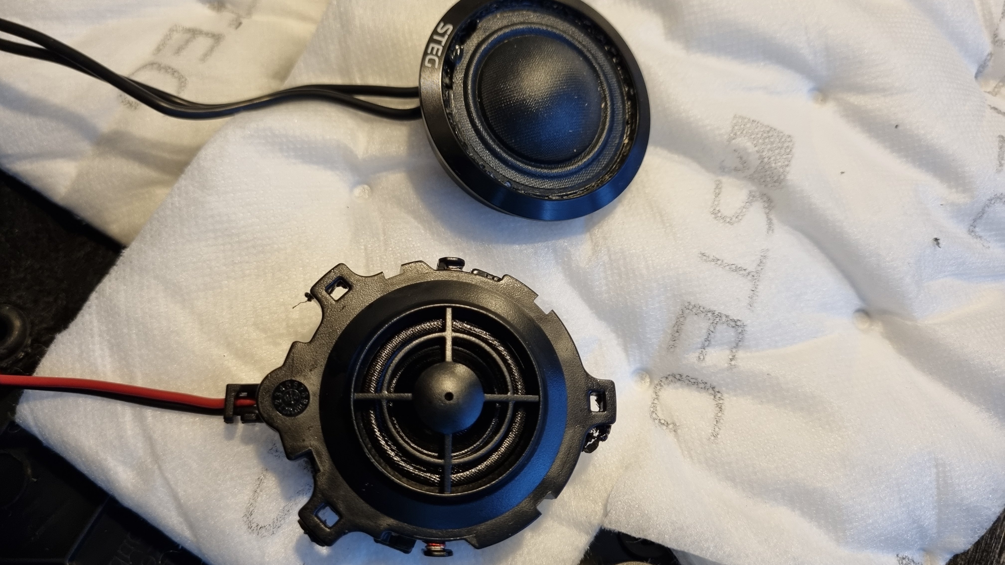

  • Remove the original tweeters by drilling the 3 glued joints
  • Glue in the new tweeter

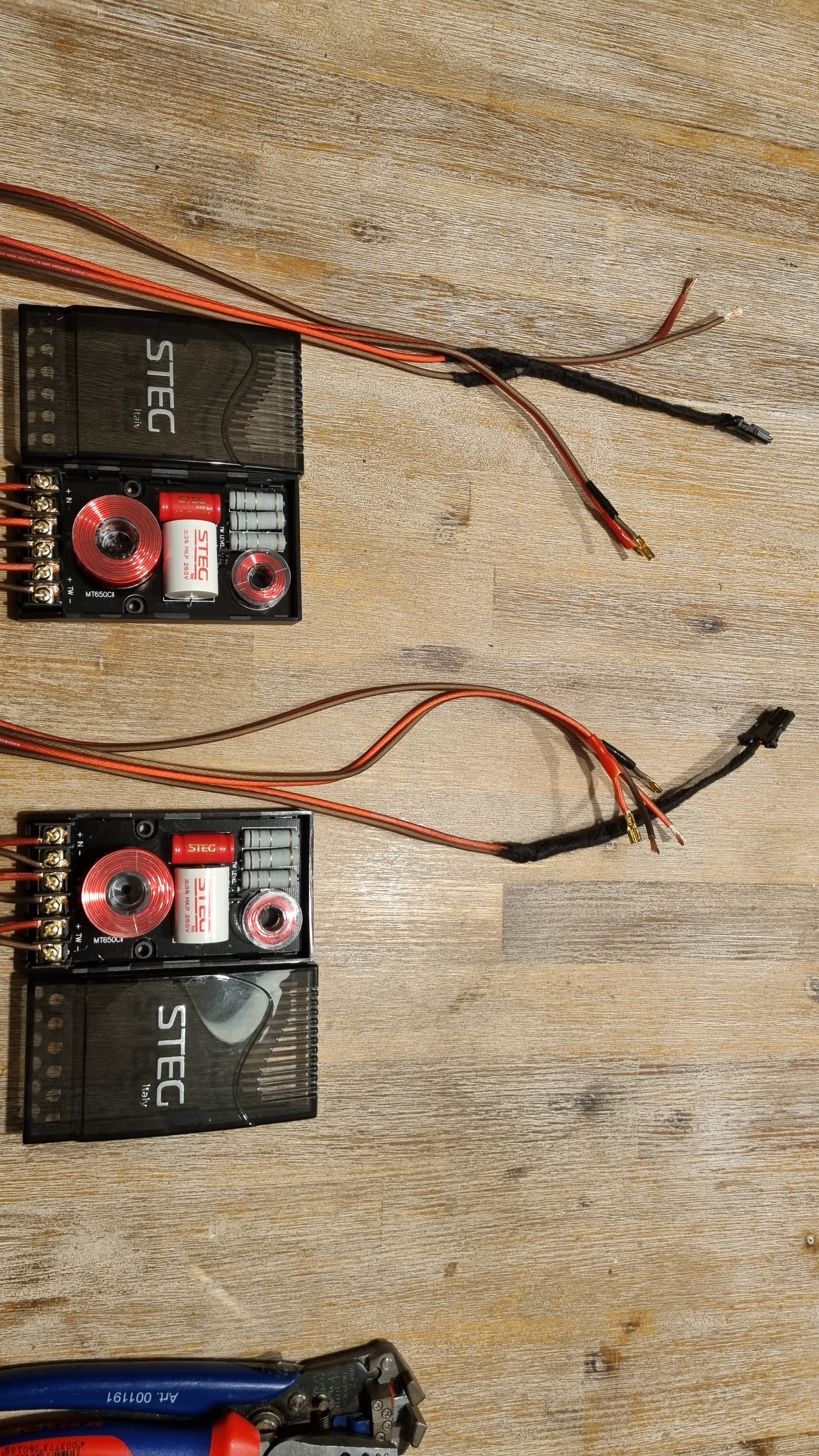

  • Place and wire the passive filter

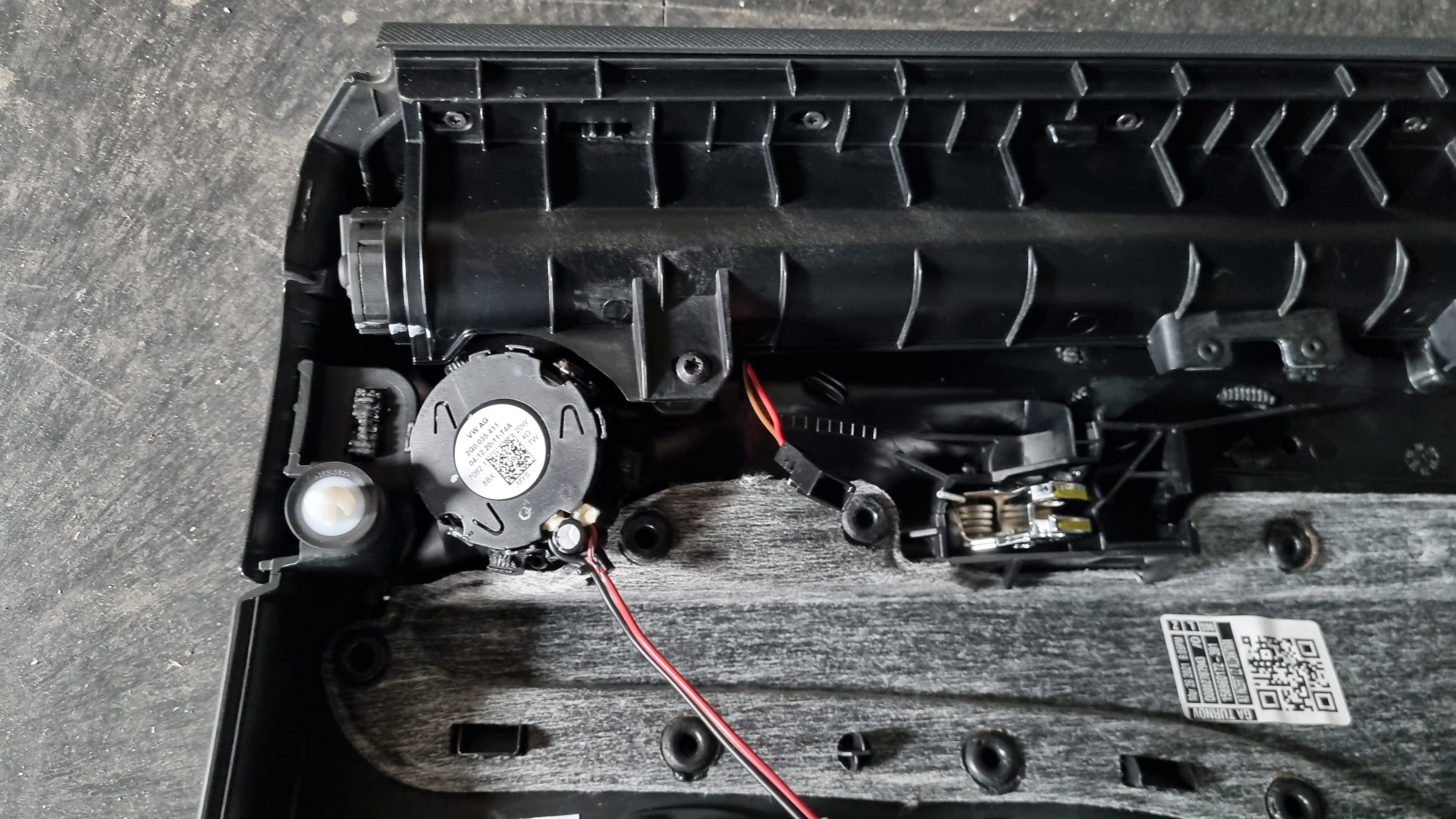

I want to add that in the standard sound system there is 1 dashspeaker.
I took it out yesterday as it messes up the sound imaging.
However, it immidiately gives SOS errror as this speaker is linked to that functionalilty.
I have now sound deadened the panel, so you can not year that speaker so much anymore, but will try to replace the speaker with a resistor and lets see if it tricks the system.

Luckily you can catch the tweeter cabling at the amplifier location. So that can be used👌🏻
For the center, i will try a 22ohm 10W resistor. Lets see if it works😄
