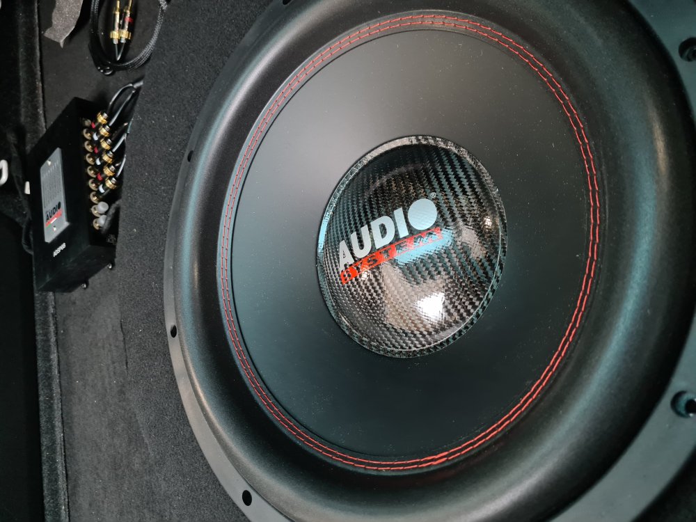

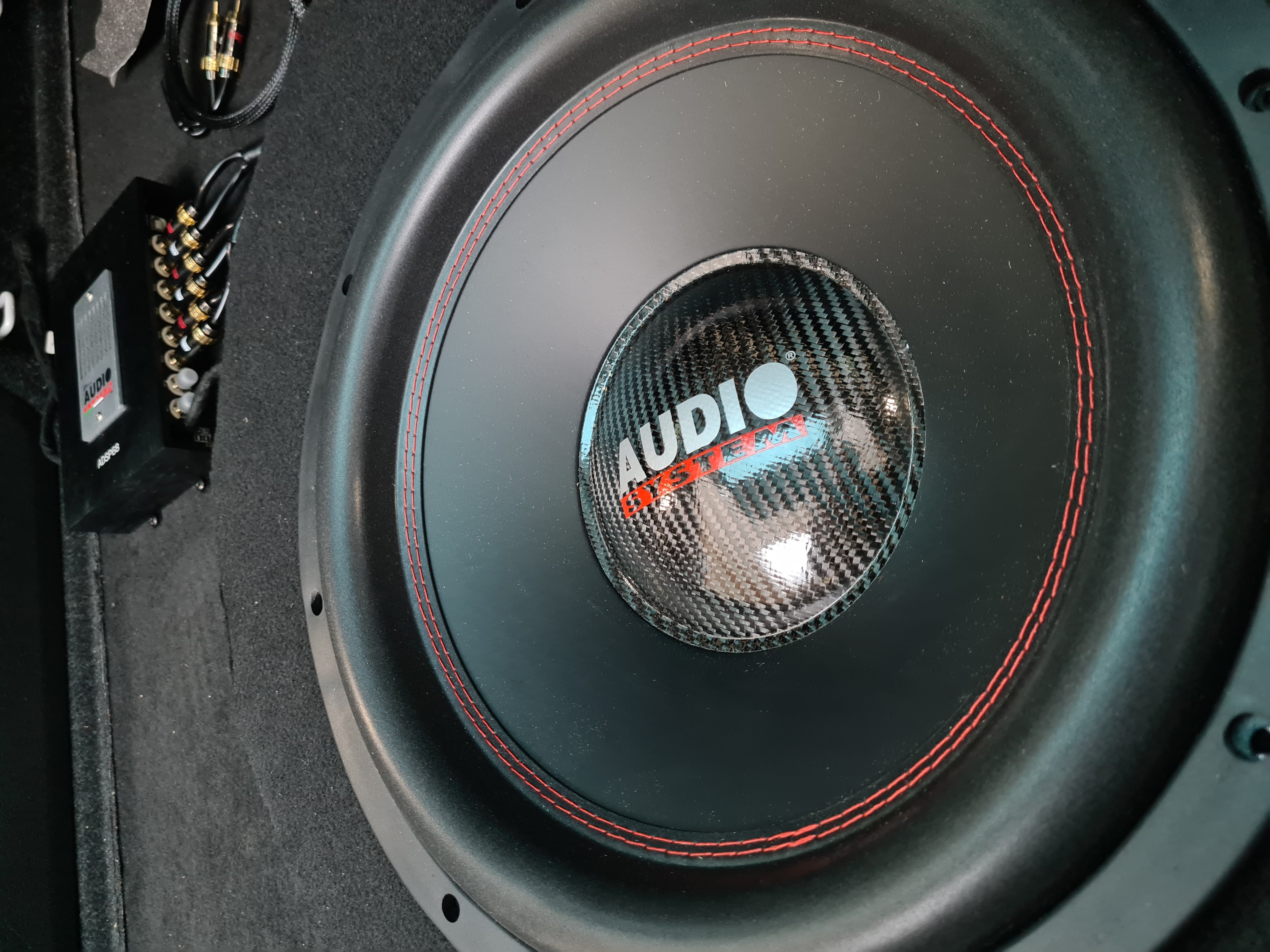

  • Quick update. Need to do some minor adjustments and allignment but almost ready with the top panel for carbon 👌🏻
These will be the components :)
STEG MSS1 tweeters in A-pillars
STEG MSS6 midbass drivers in front doors
STEG SQ32 tweeters in rear doors
STEG SG650C midbass drivers in rear doors
STEG 2x MSSK130.4 amplifiers for the speakers
Audio System Italy 15inch subwoofer, ASS-15 in sealed setup enclosure 62Liter
Audio System F2D1000 subwoofer amplifier
STEG SDSP68 digital sound processor

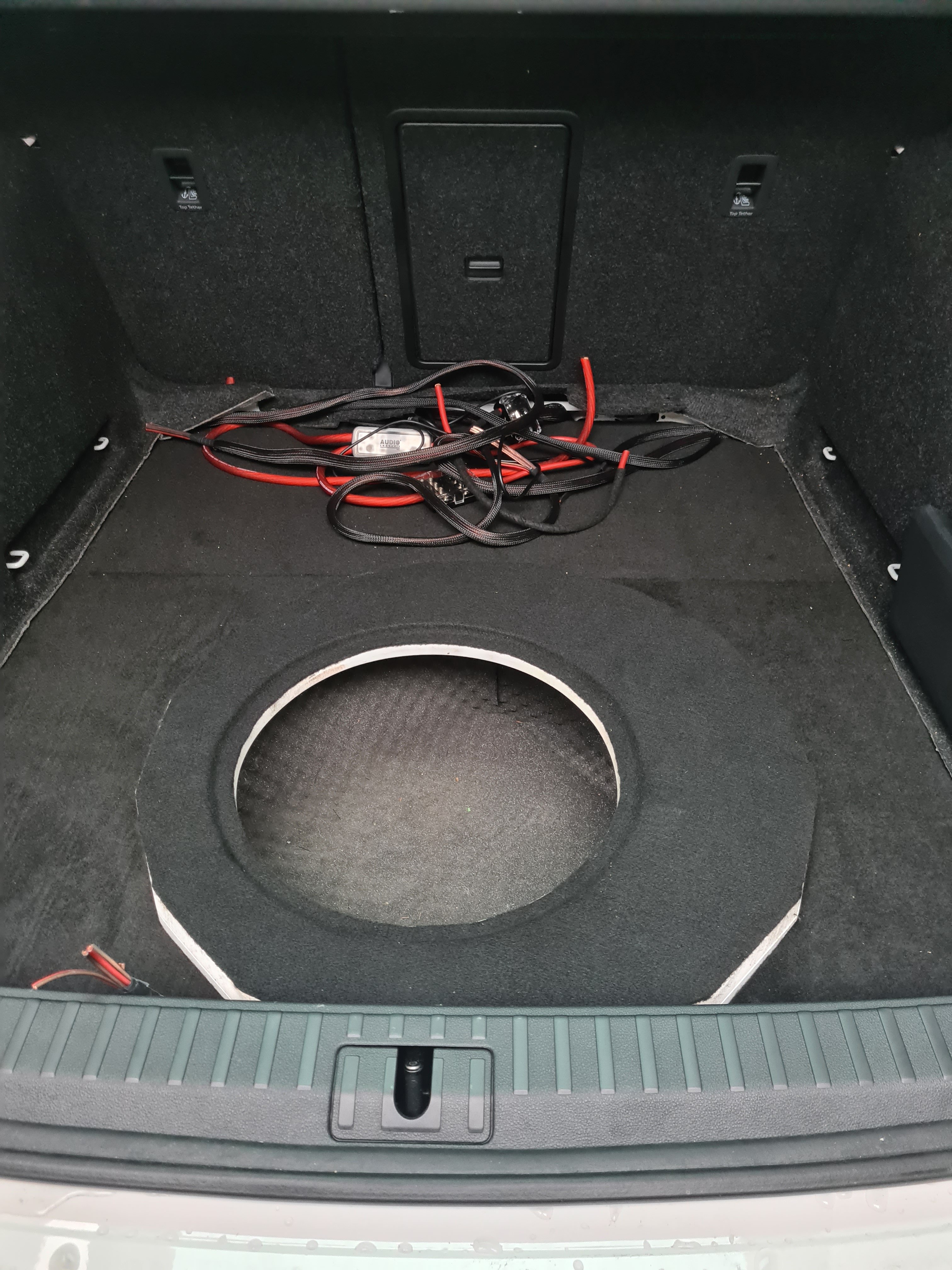

I just left mine for the enclosure, on the left side of the trunk

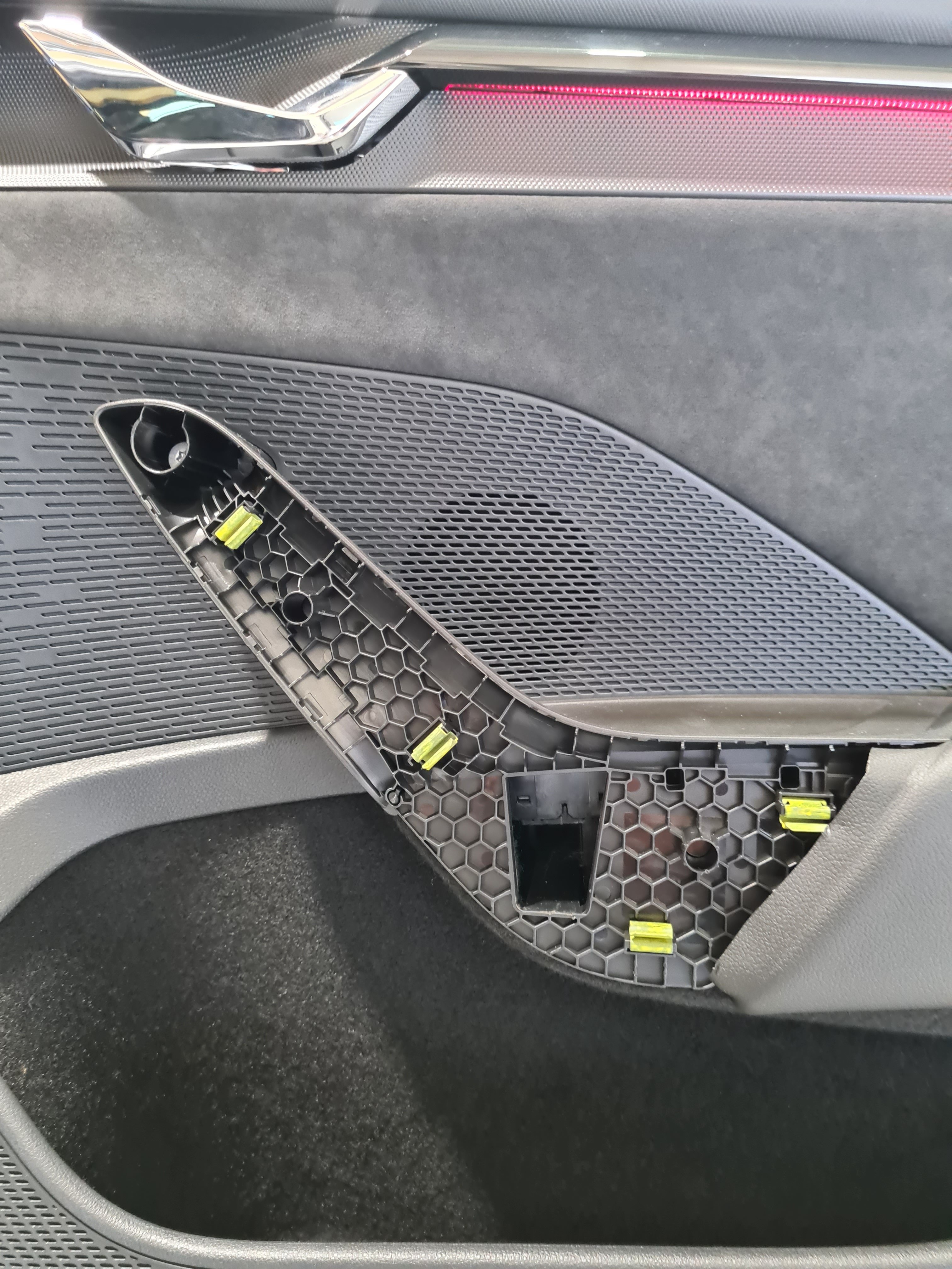

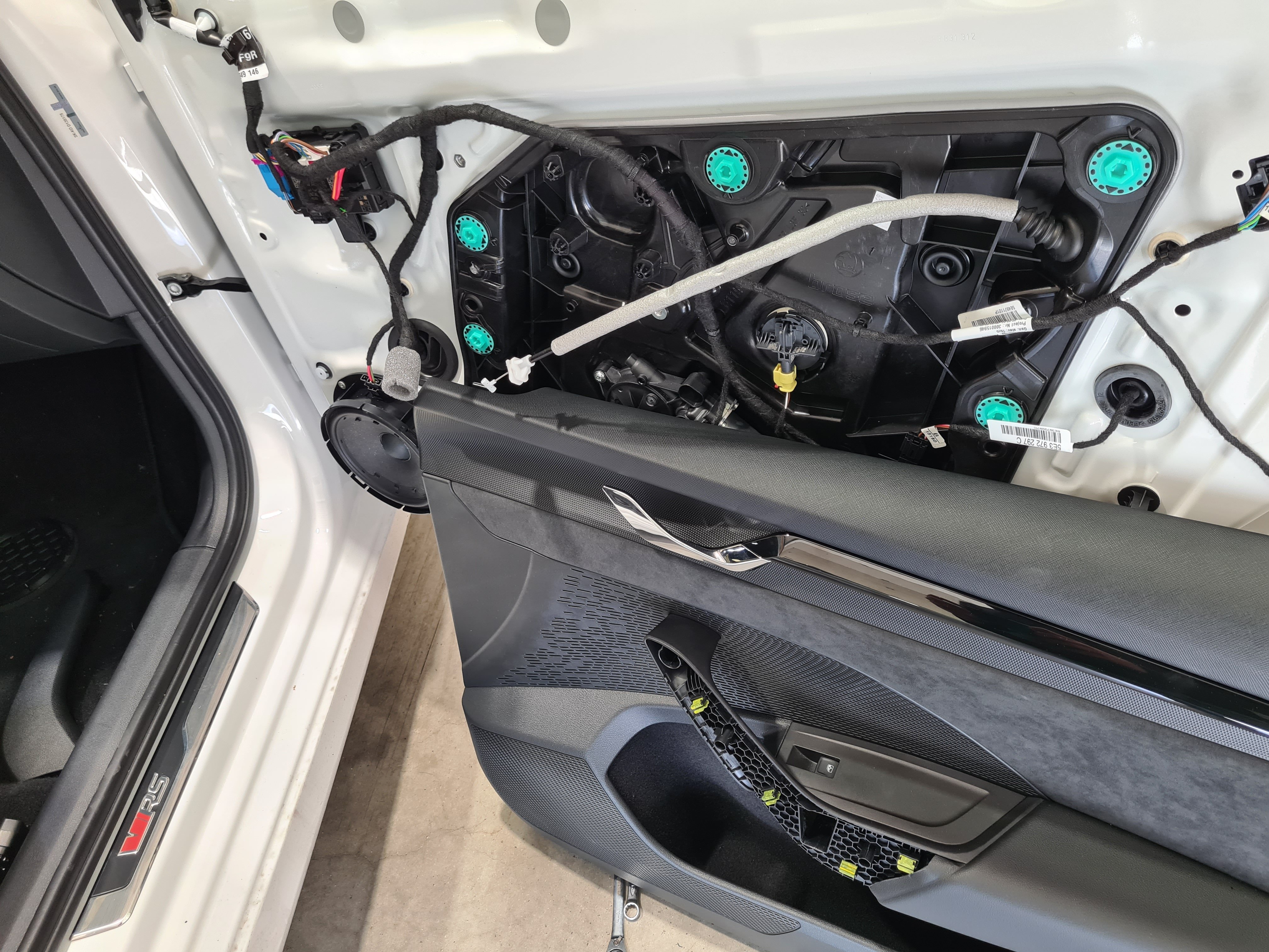

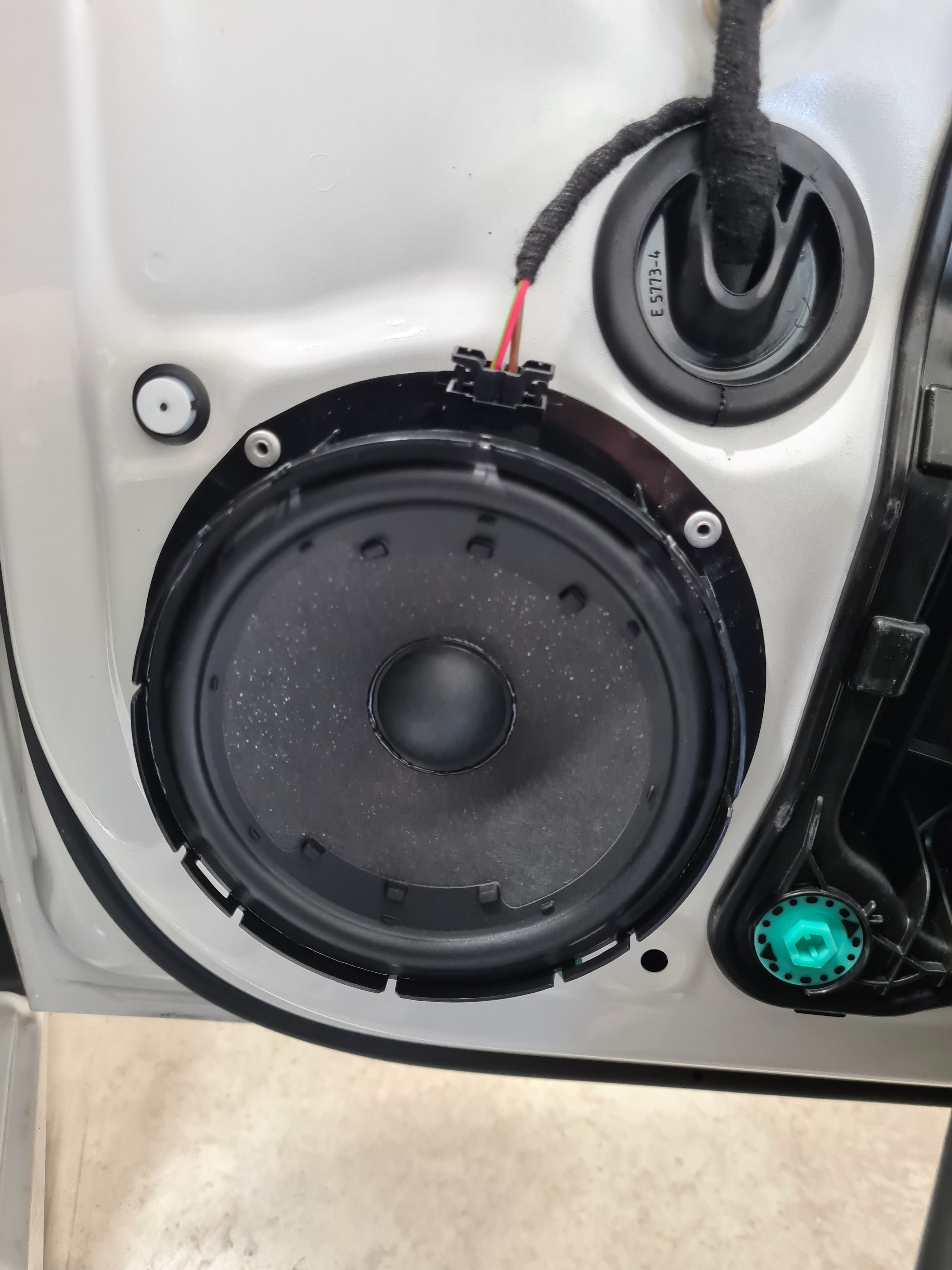

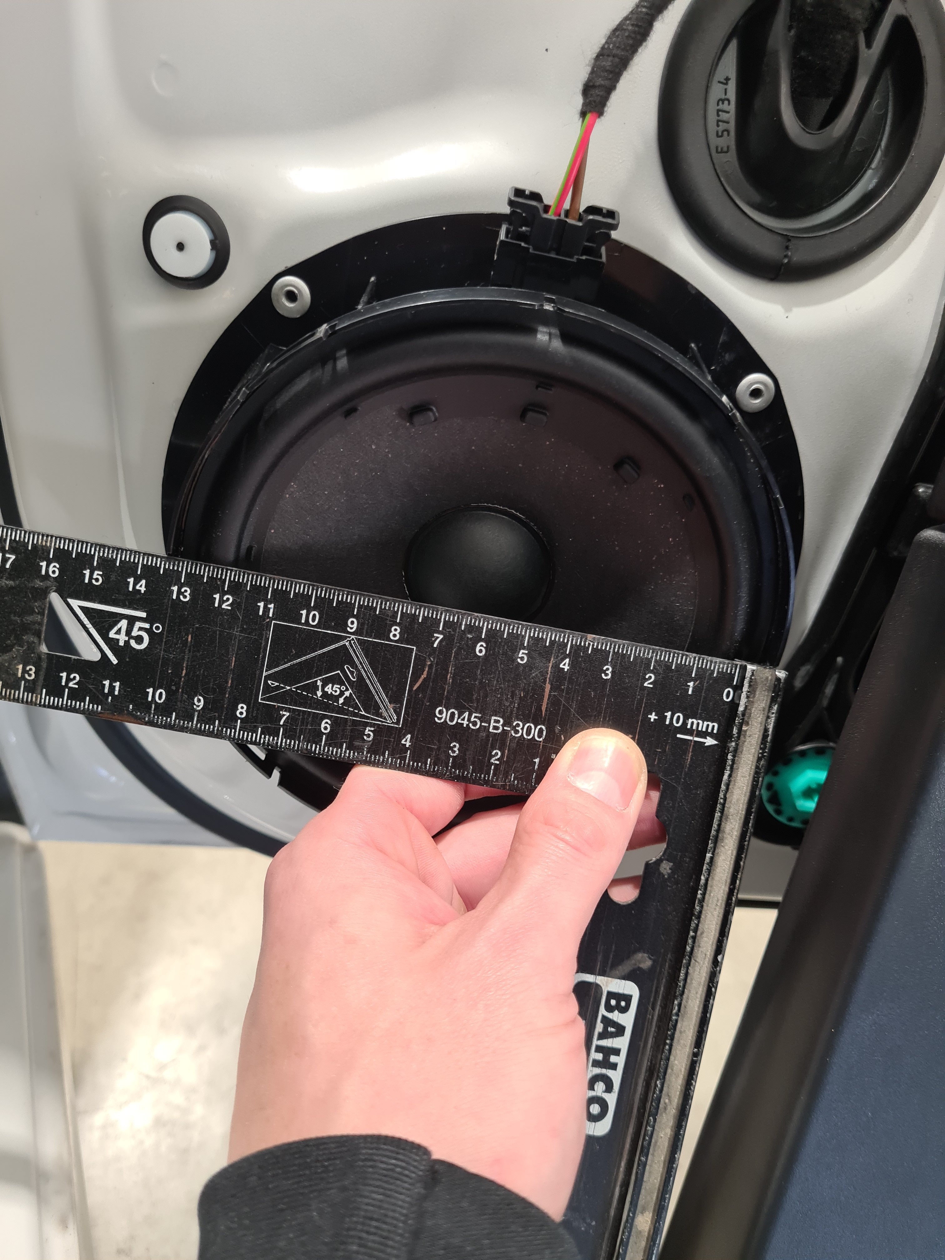

Quick update, not having a lot of time these days. But now ready for placing the amps, wiring job, mounting sub. And make a plan for the cover panel which will become something special.

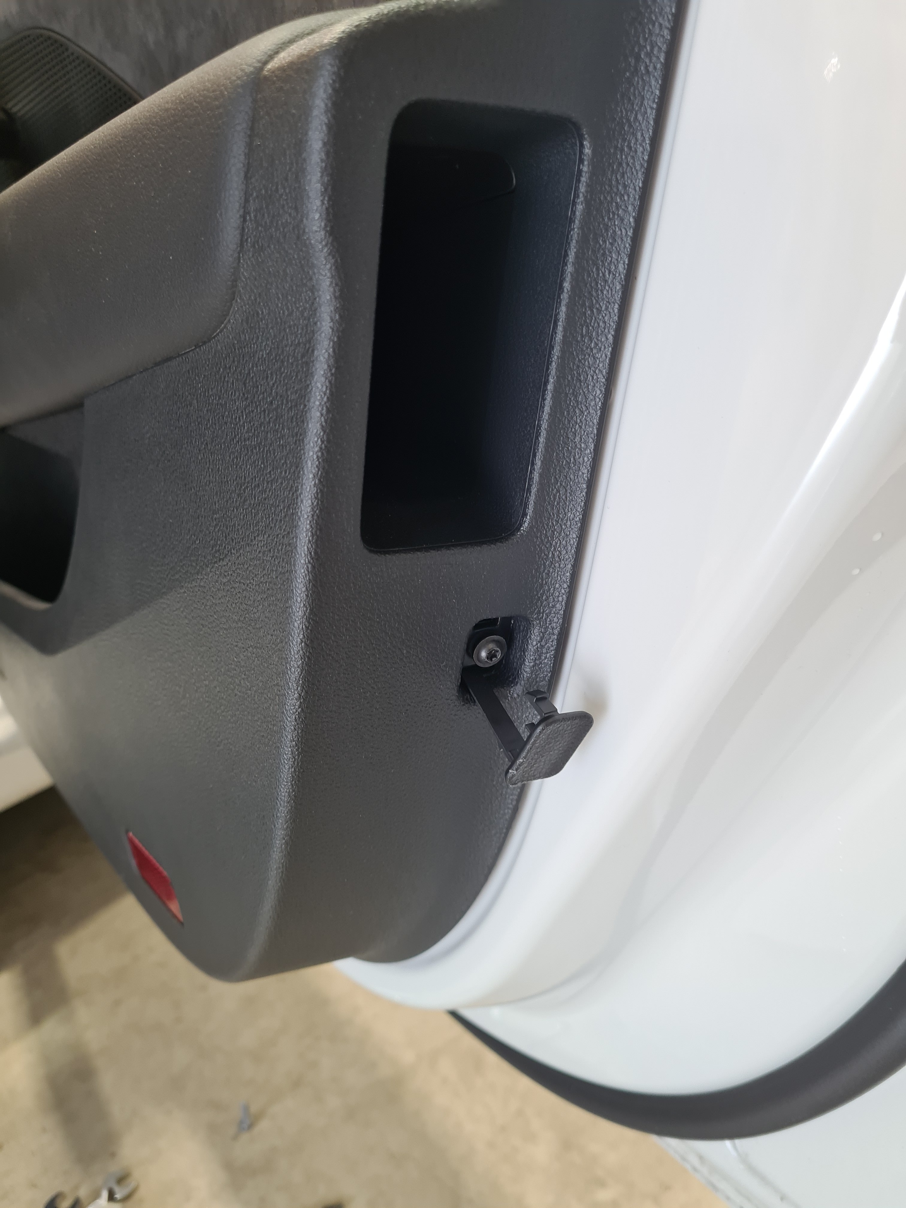

Front door panel to be removed with screw on side behind small cap, 2 torx bolts behind handle and turn a bolt 90degrees at bottom of panel near the projector light.
Disconnect some connectors and water hose for umbrella and panel can come off with some lifting and force.clips will not break when temperature is above 15 degrees C.

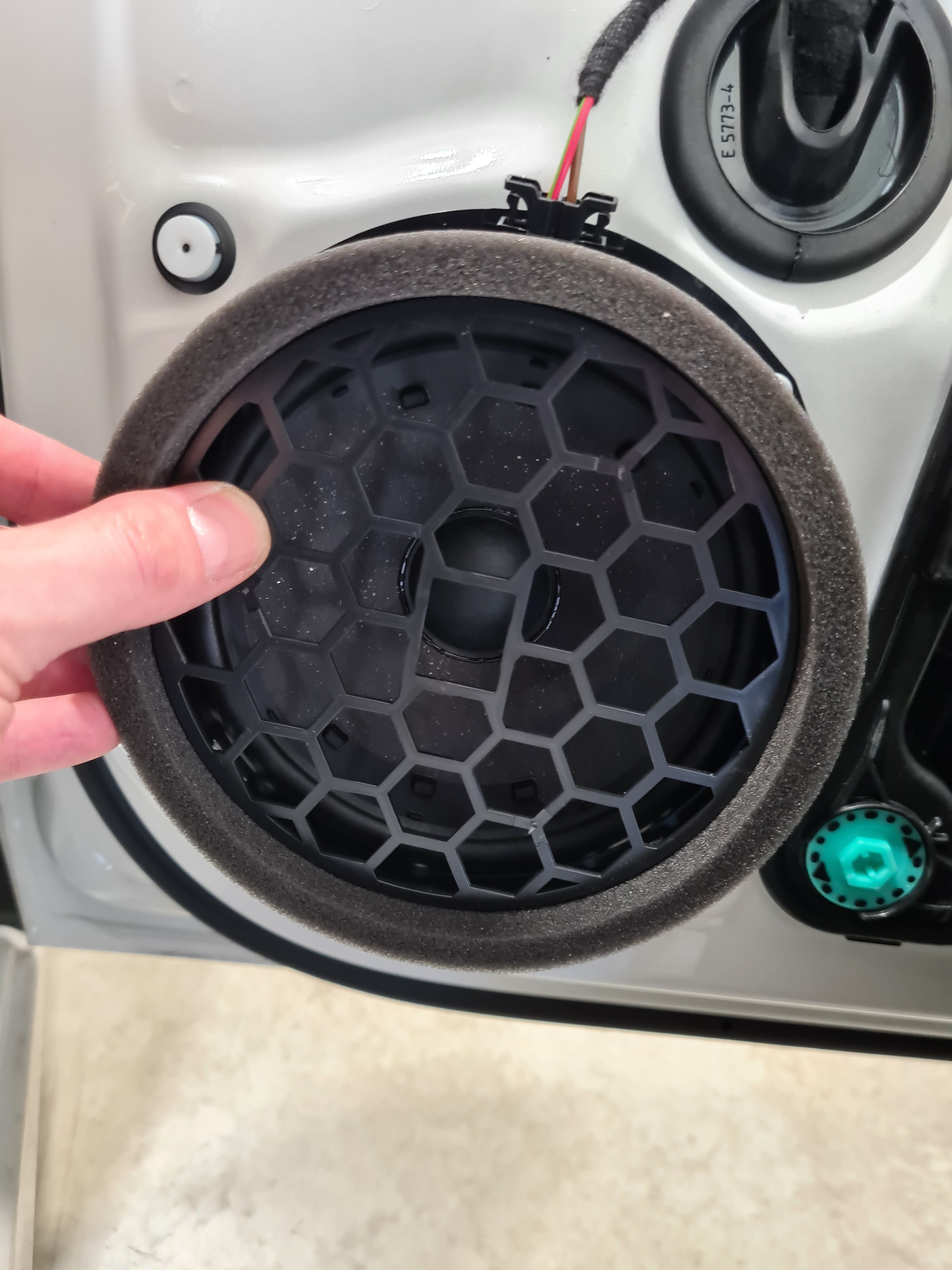

Most likely golf 6 speaker adapters can be used for the midbass speaks, but thats what i have to confirm.
Interesting. I thought Octavia had 160mm speakers like it used to, but I guess they downsized for this generation. Also it took me two minutes of looking to figure out why your doors have no midrange speaker and only then I saw that there is no Canton logo. 🤣

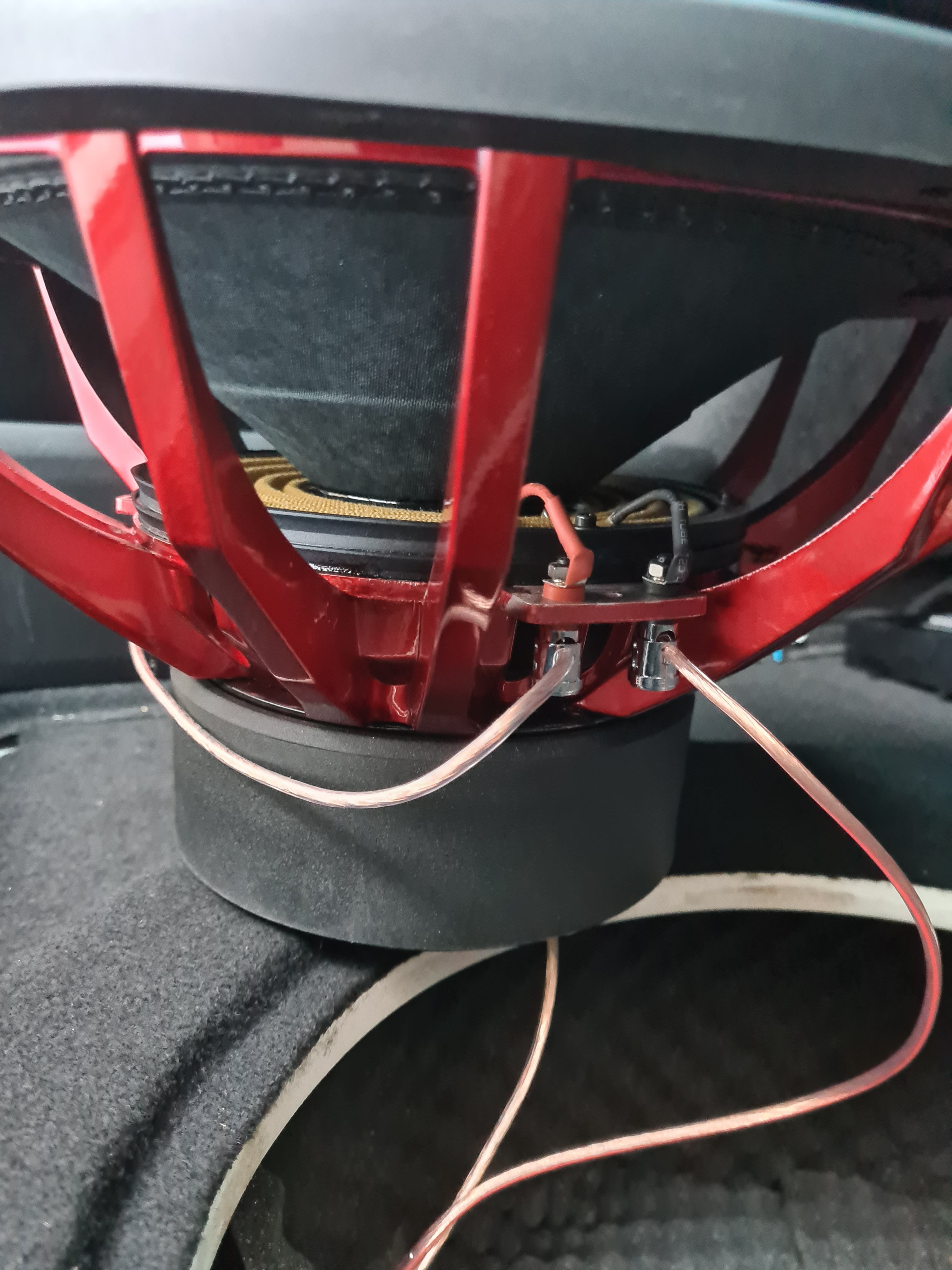

Quick update; put in the 15" AudioSystem ASS15 sub and placed the 8channel DSP. Wiring to be done and amplifiers placement👌🏻
