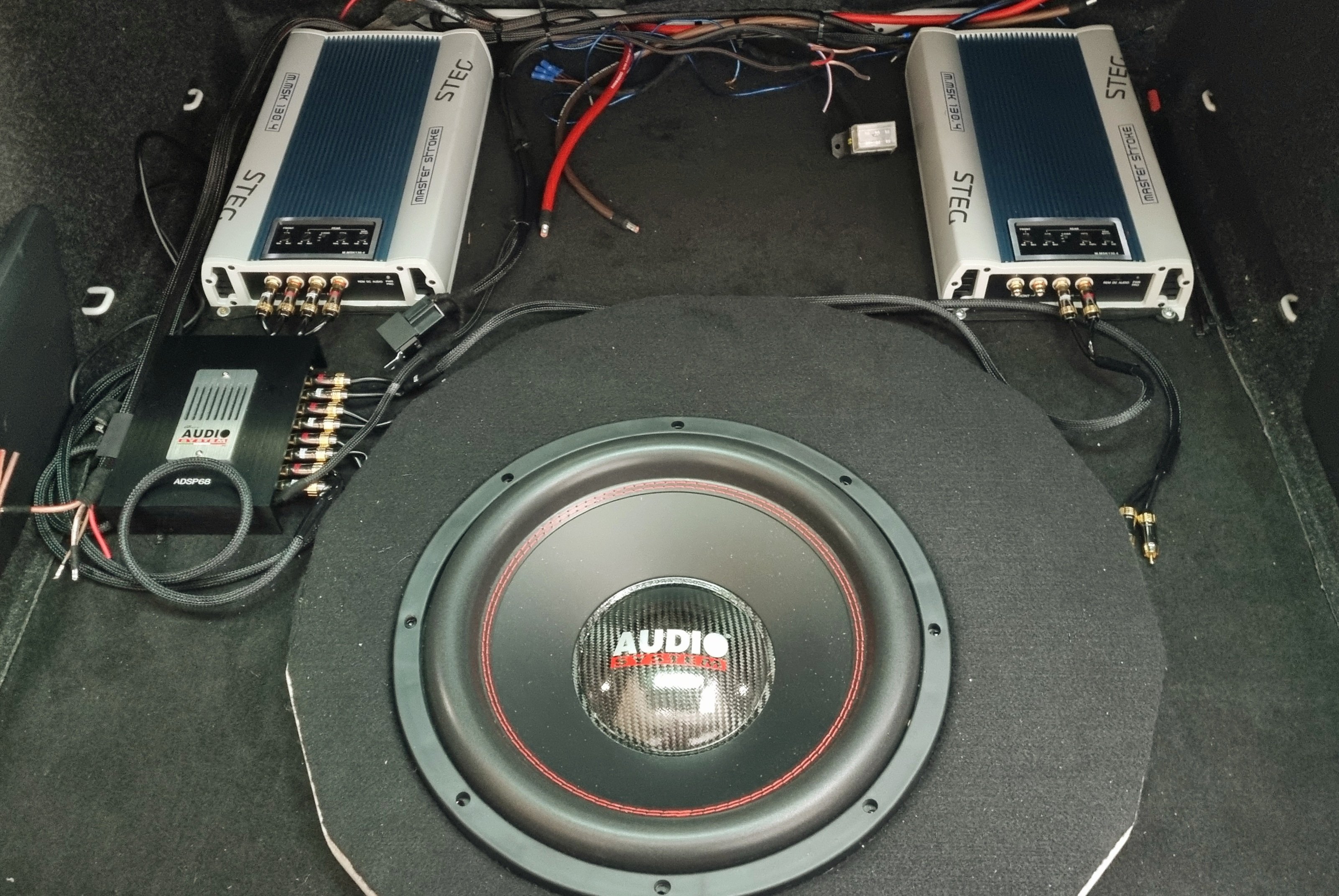

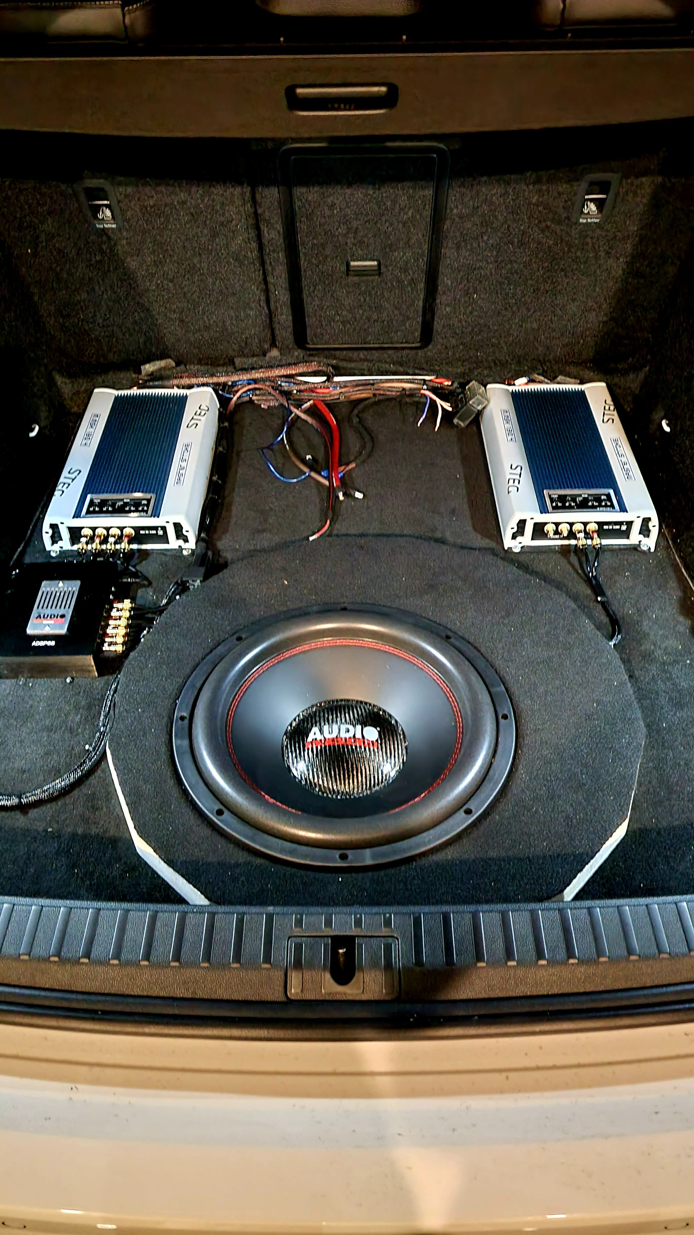

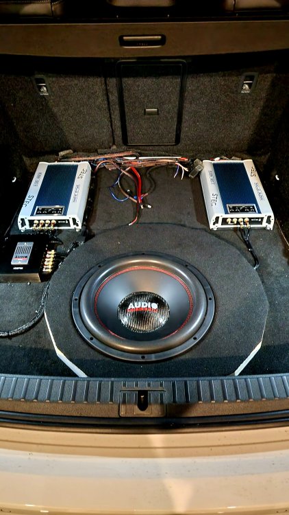

  • And here's my final setup. 1000w JBL in custom enclosed box with the right amp. Kept the canton sub connected also, why not. No other changes to the oem speakers. Not a huge change in "

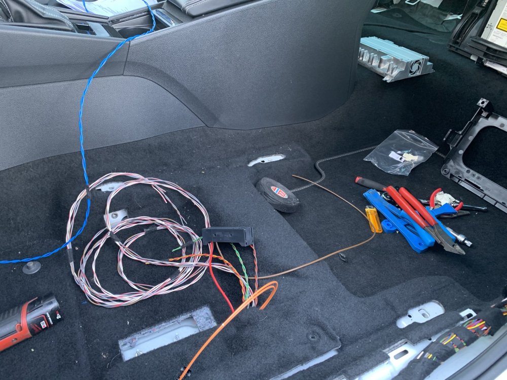

  • Quick update. Need to do some minor adjustments and allignment but almost ready with the top panel for carbon 👌🏻

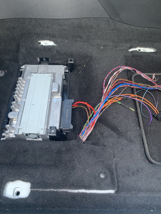

Quick update👌🏻
1 amplifier to go.
Than starting all plexiglass work.
And speakers replacement.

@DutchVRS .... Very nice job, impressive. May I ask you ... for the rear doors ... woofers have the same diameter than woofers from front doors? I would say yes ... but just to confirm.
Cheers!
Cheers!
Thanks!
I can not confirm yet about rear door speaker size.
I will take off doorpanels next week👌🏻

Quick update.
Waiting now for the subwoofer amplifier
