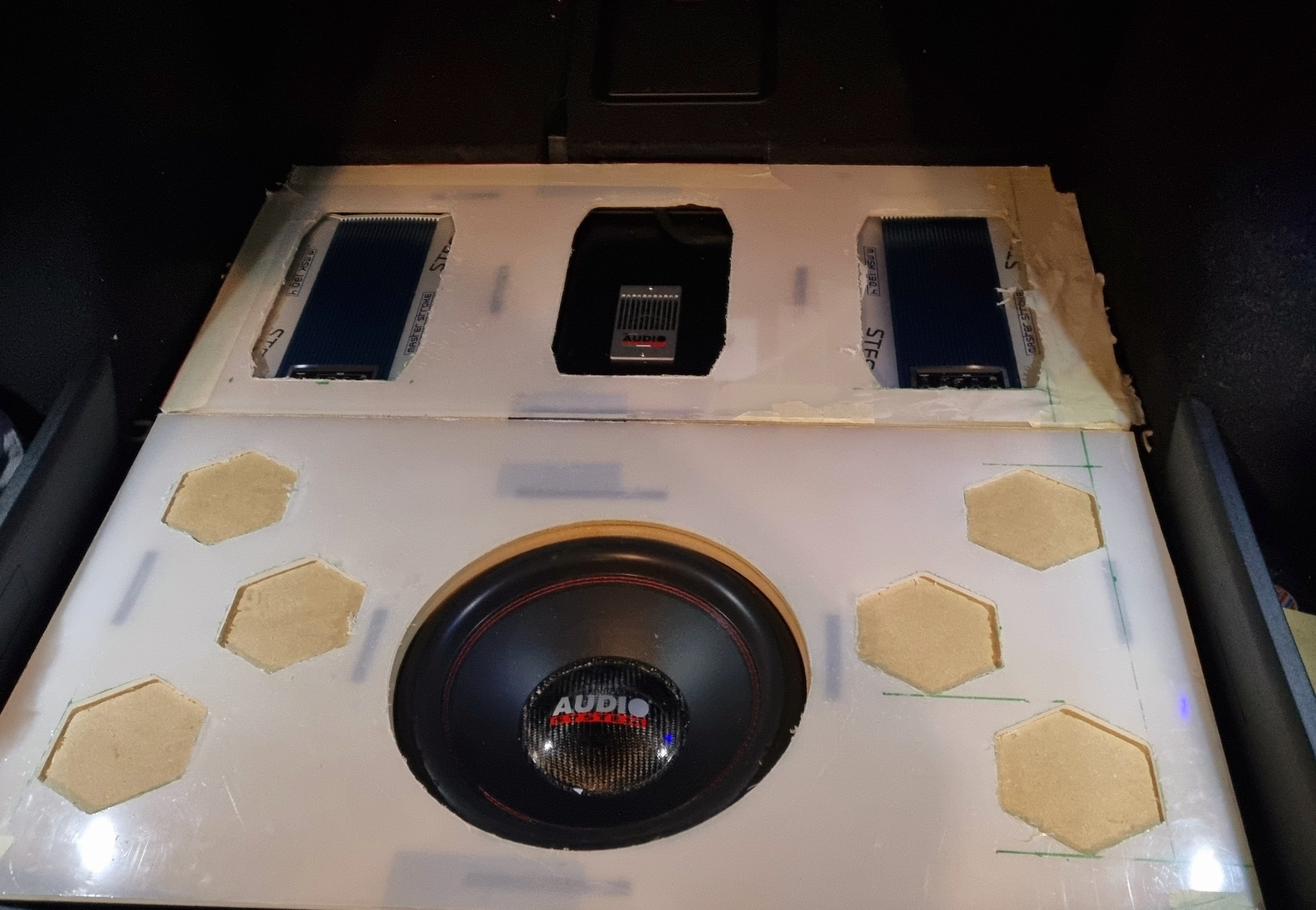

  • Quick update. Need to do some minor adjustments and allignment but almost ready with the top panel for carbon 👌🏻

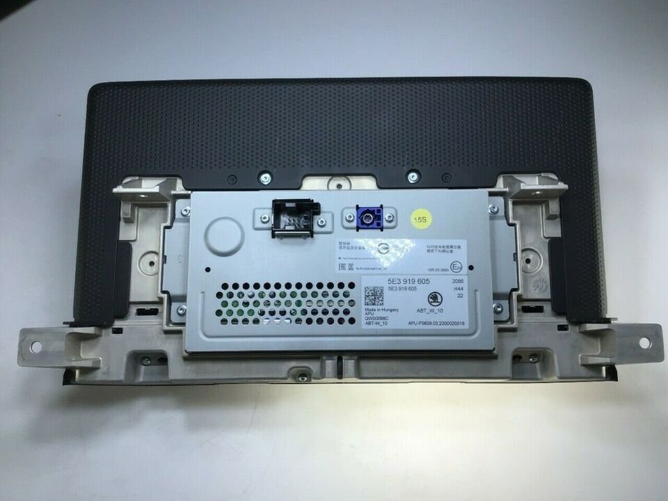

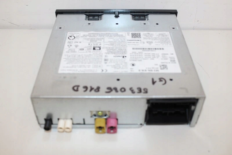

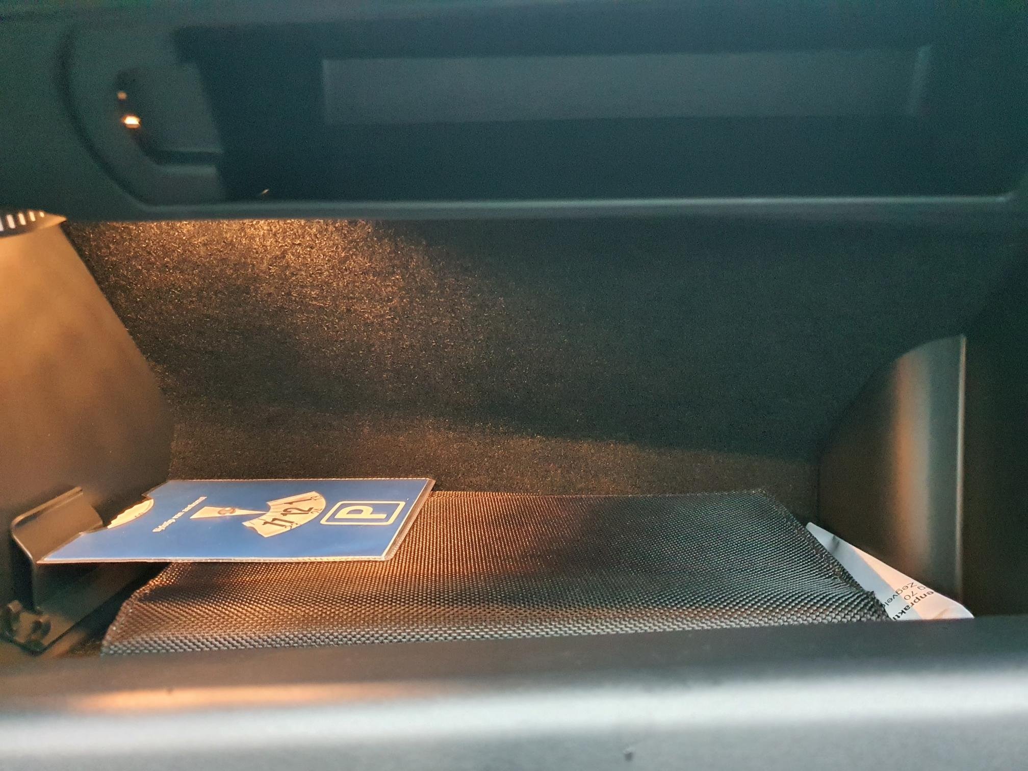

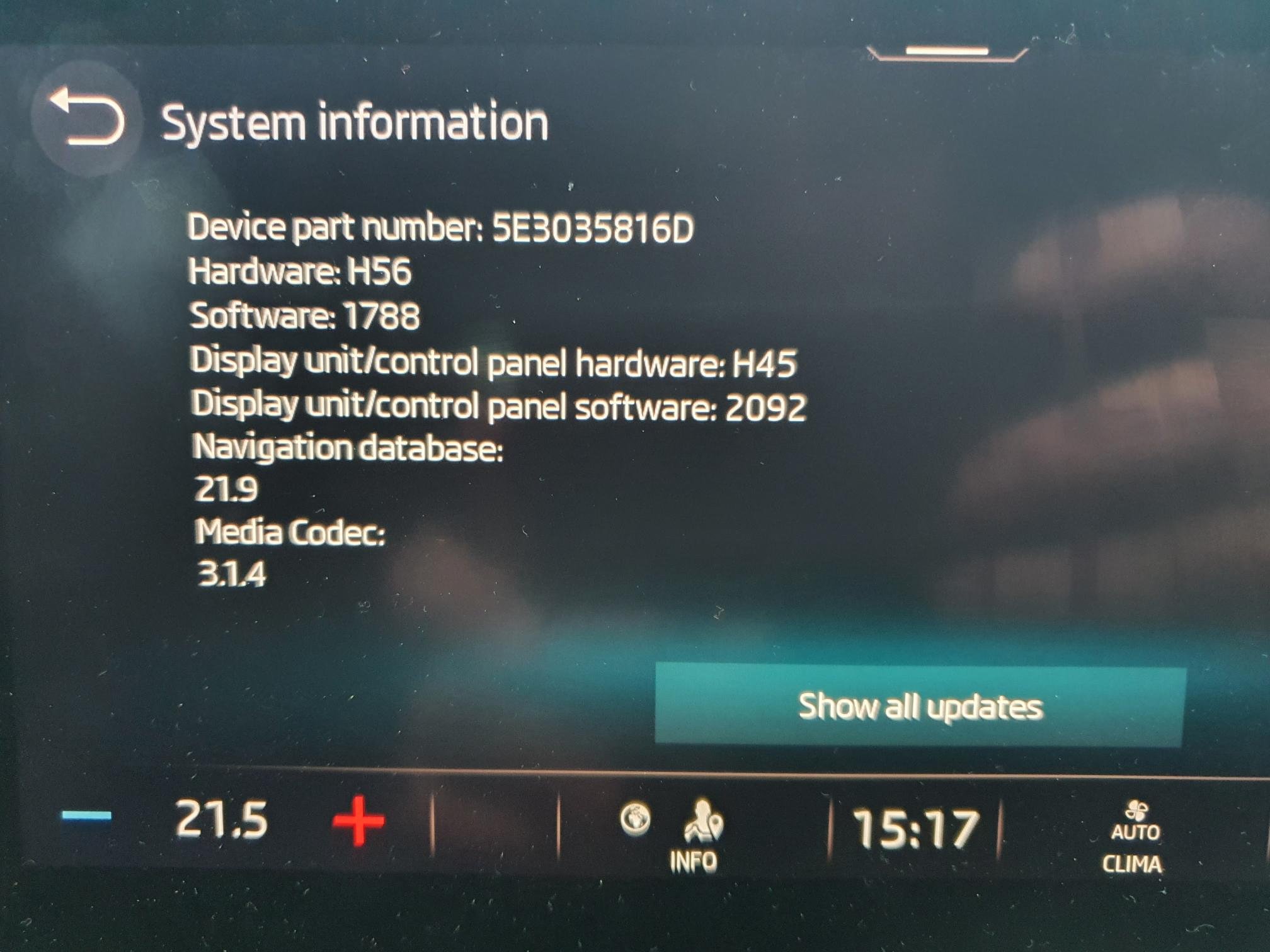

Looking at the back of the display, I do not see any connectivity possibilities, the additional Canton box does seem to have some. Does someone know where they are located for non-canton units?
where is located this Canton box ?
If you have the optional Canton box, it is located in the glove box.

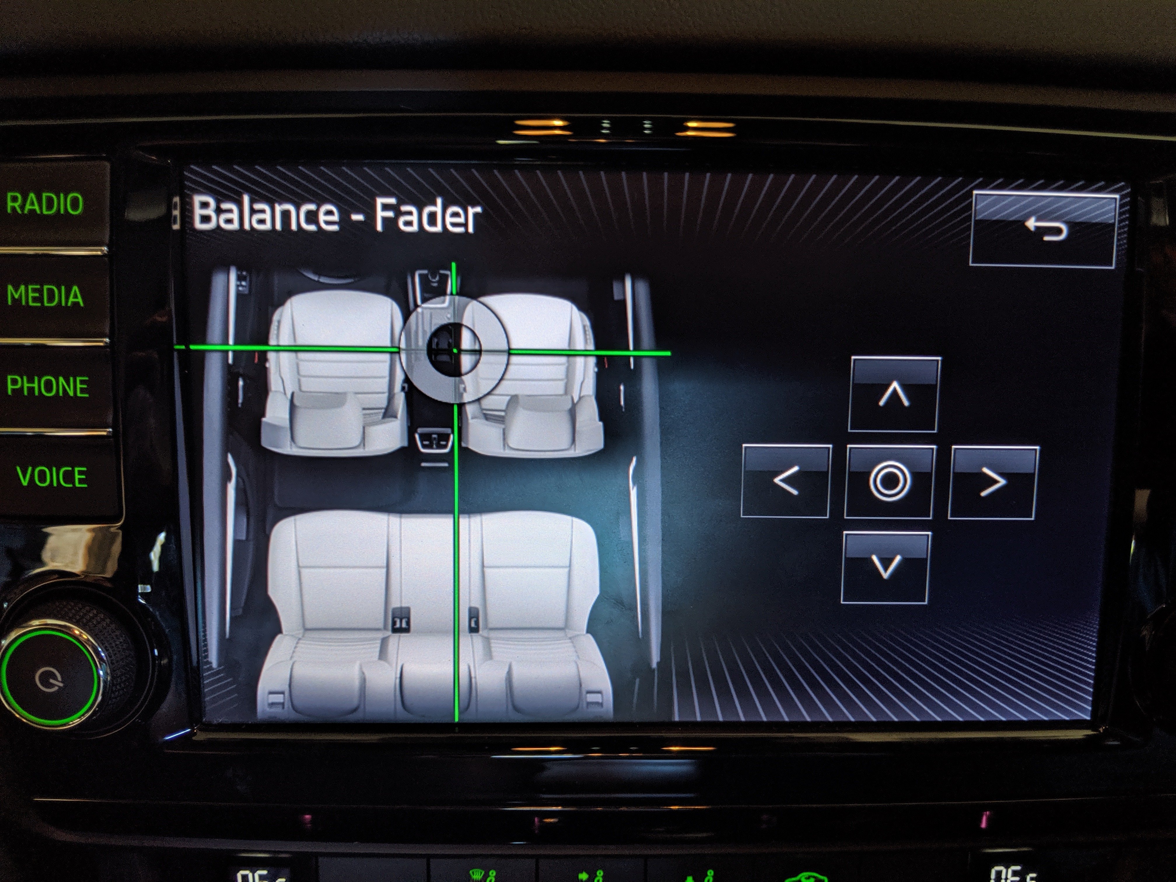

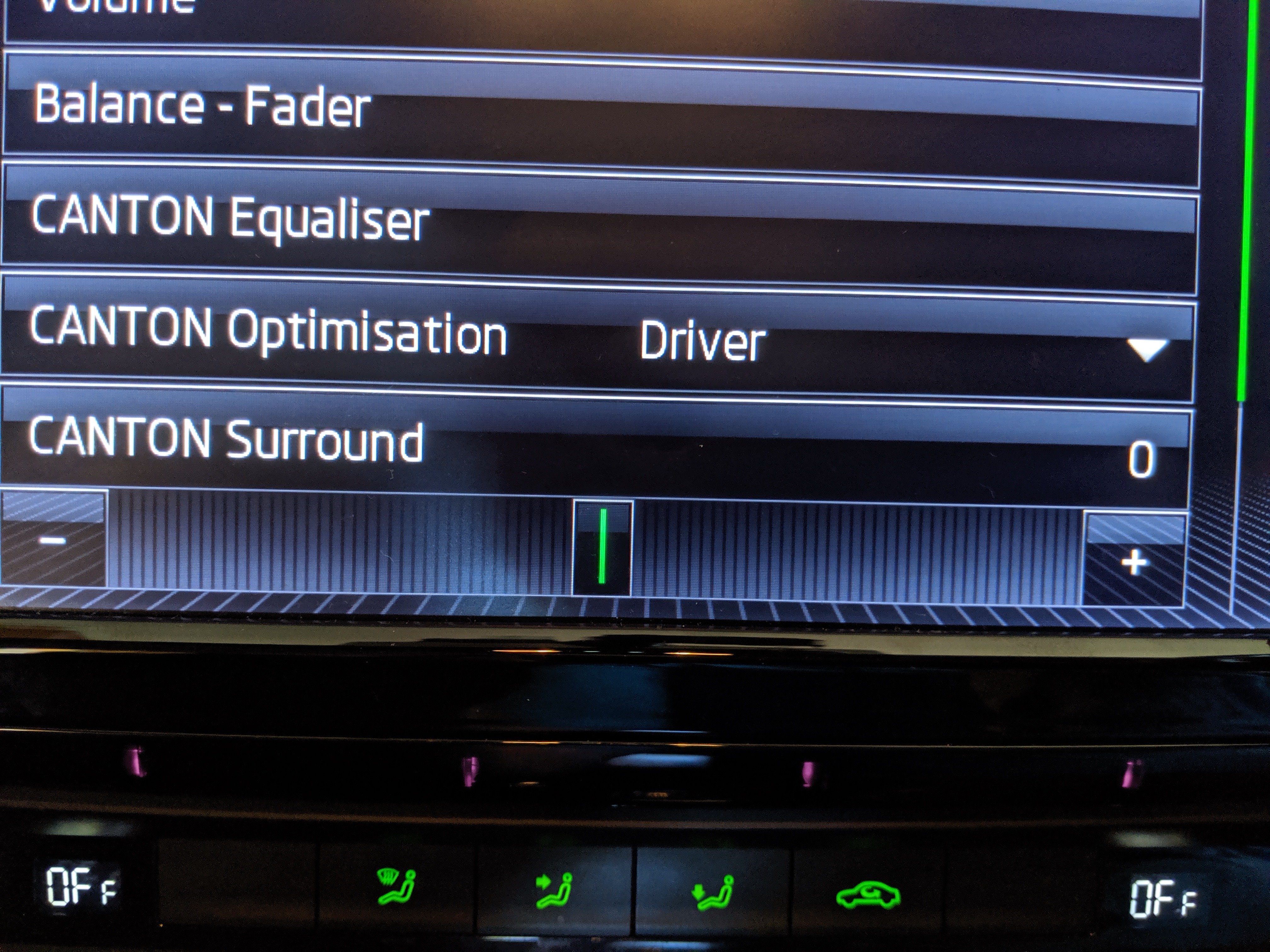

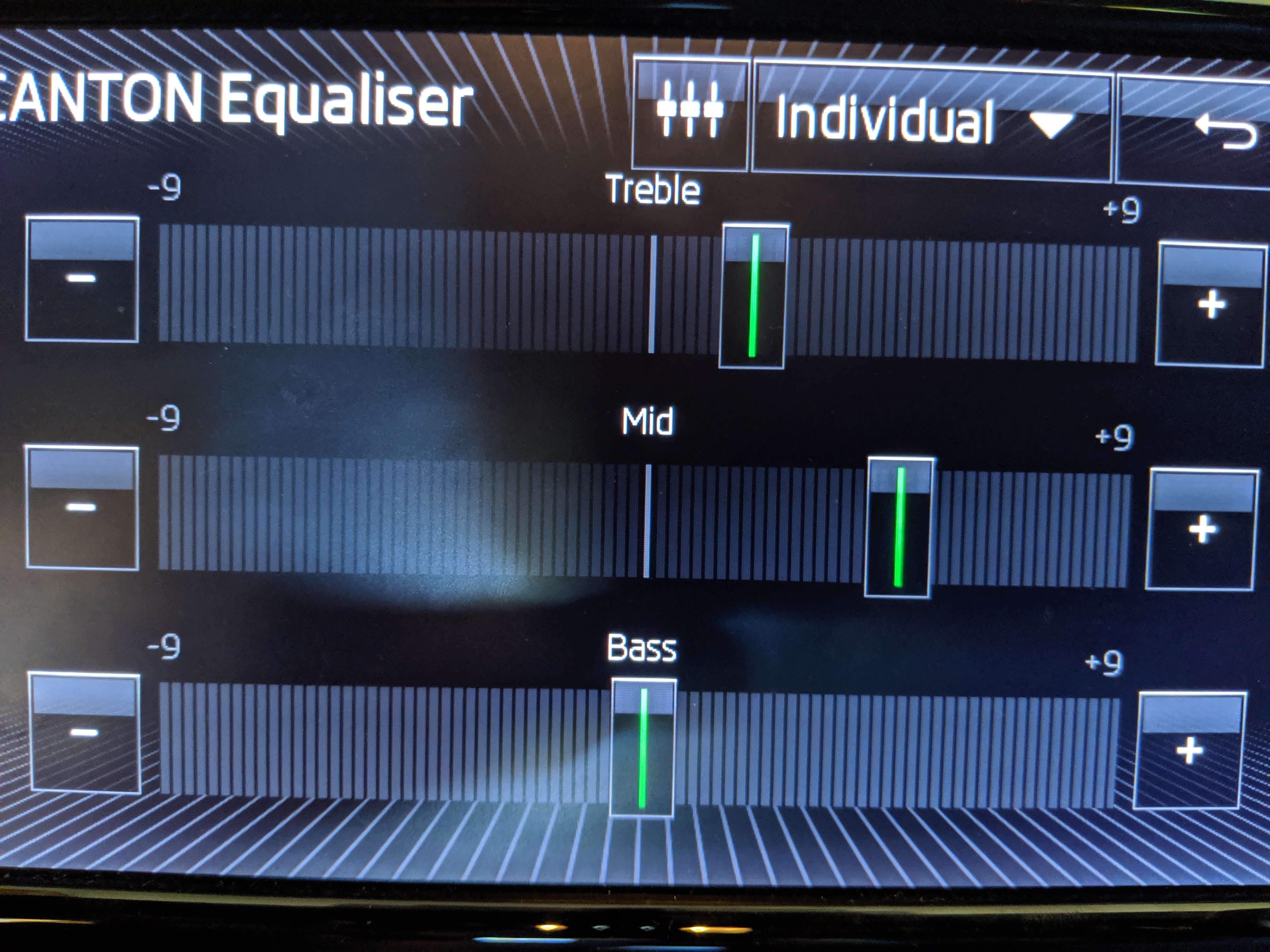

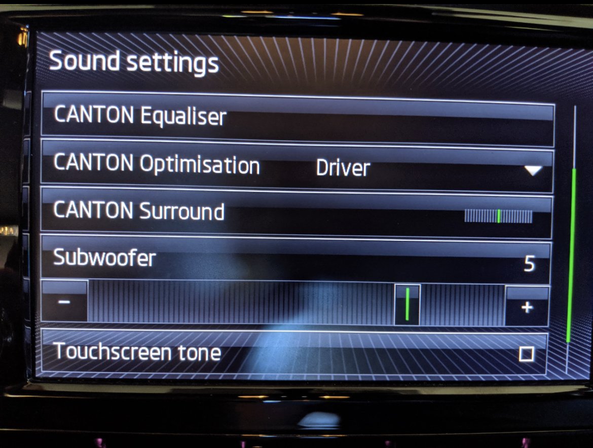

I have the Canton Audio in my Skoda Mk4 VRS and yea sound was very much to be desired out of the box. I got my previous Mk3 Octavia VRS Canton system sound tuned by a Audio installer and it sounded way better. I put the same settings into the new Octavia (most of the settings were the same between the two)  and it made a big improvement. Obviously not going to stand up to a aftermarket professional setup but in Australia the Canton upgrade comes in one big pack (called Premium pack) and wanted the other options in there… plus it sounds better than without it so I’m happy.
Would you be okay to share the settings that you used?
Again a few steps further, ****load of work. Now amplifier allignement and graphics work. Lots of sanding of plexi edges and mount programmable leds. Than time for the cover panel.
head unit is in the glove box, amplifier is under the driver seat (left in Romania)
Here you go mate. The Mk4 Canton has more equaliser levels so I just made them the same for those that had more. Everything else is the same and transfers over. Sounds much better with them. I found if you want more punchier bass just increase the subwoofer level rather than the bass otherwise it’s too boomy (like in the photos)
