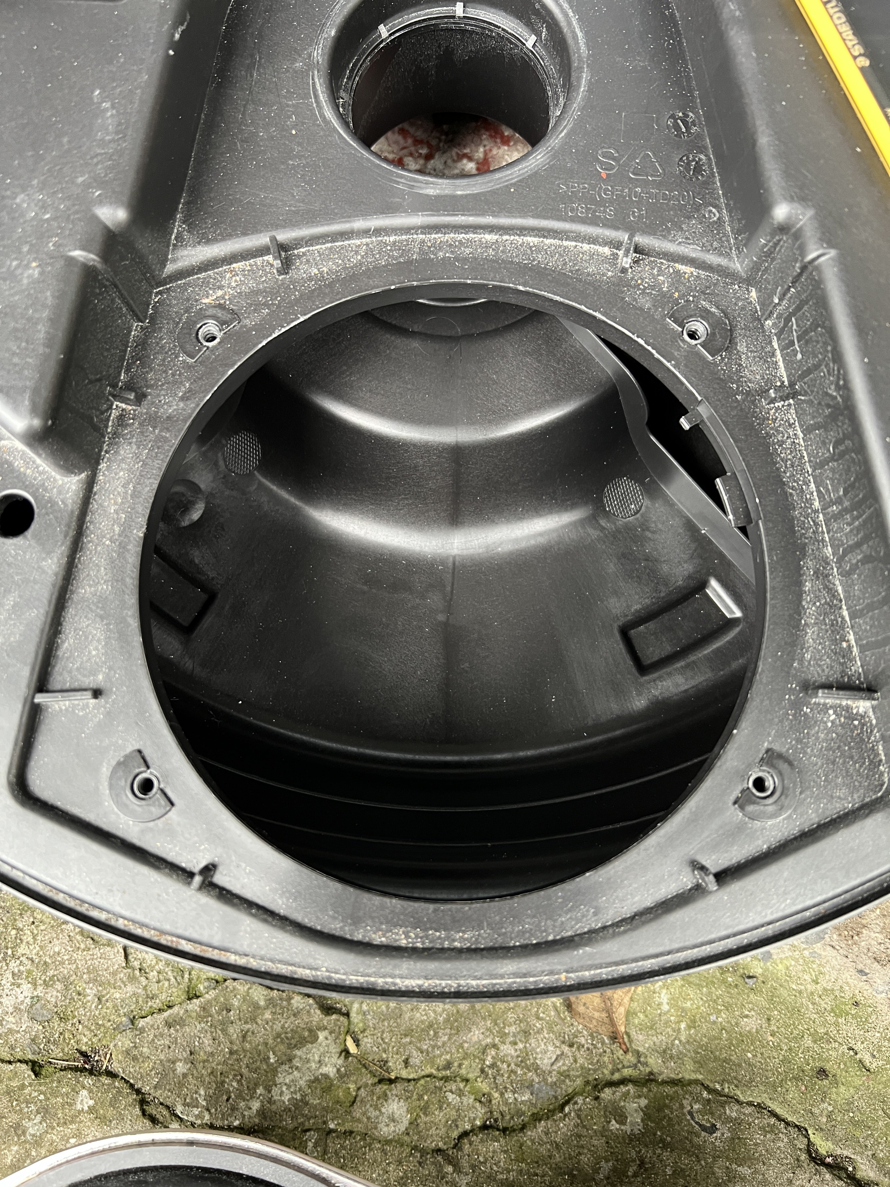

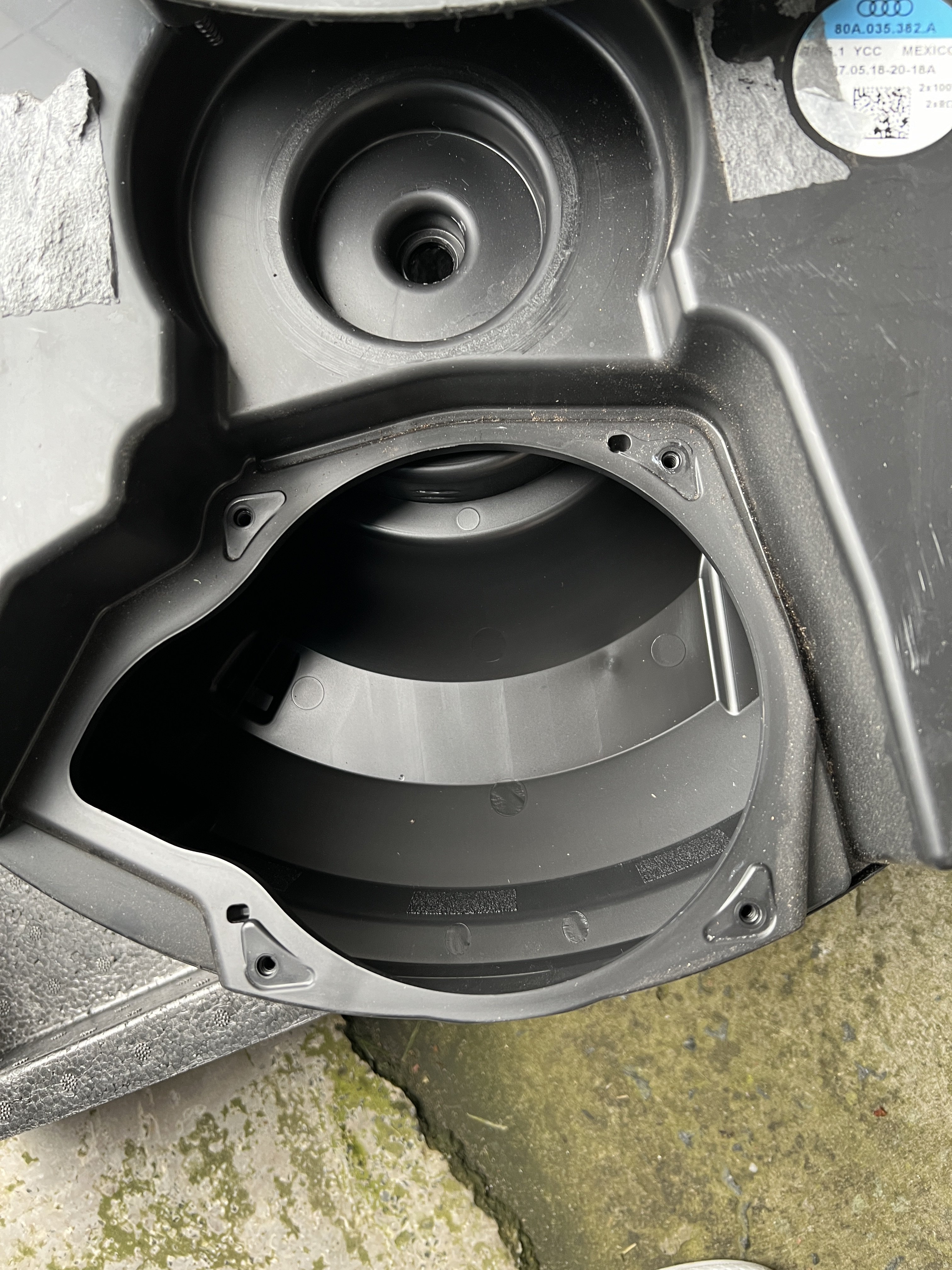

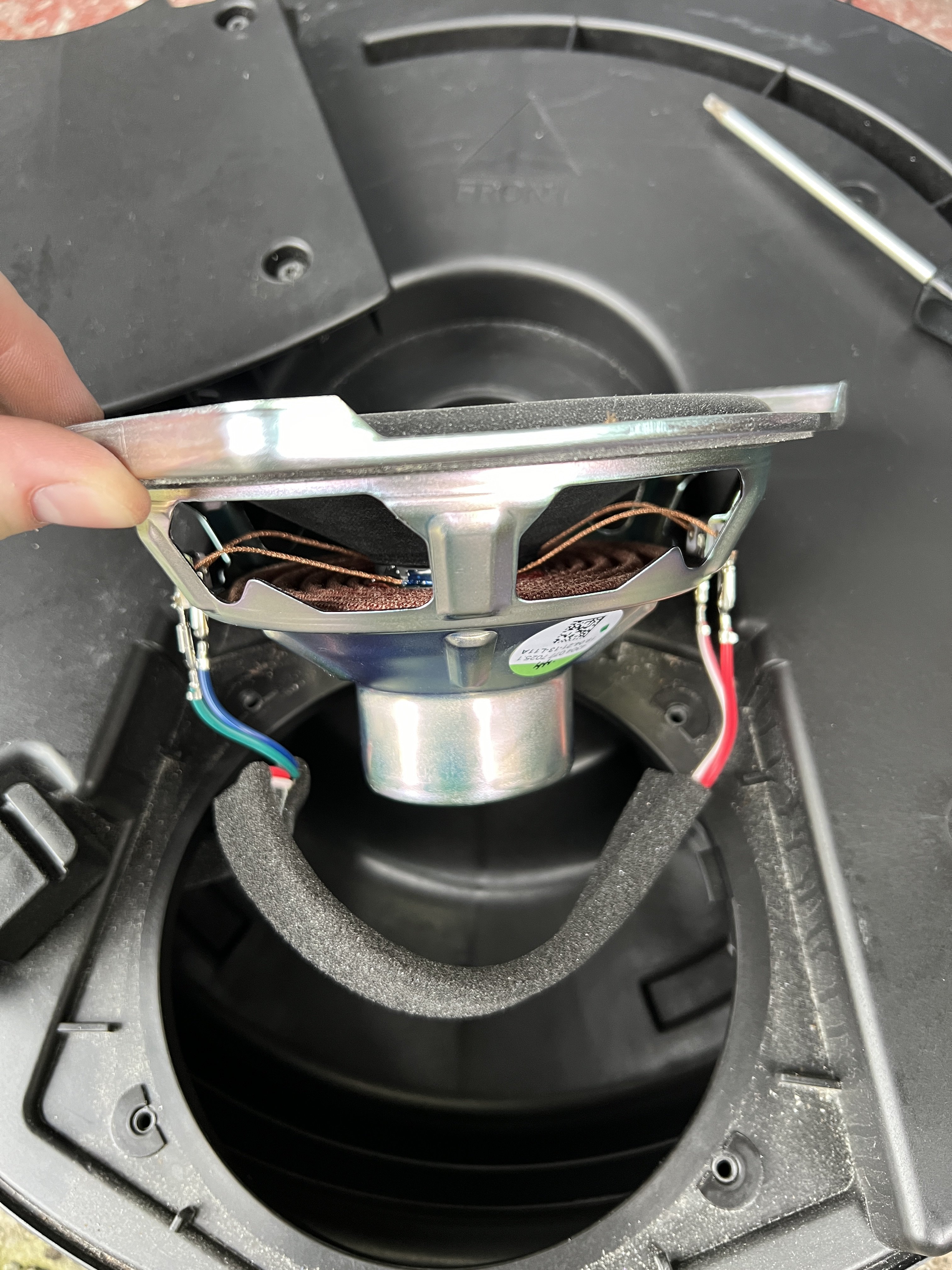

So my Audi sub finally arrived. I have a standard boot floor in my Estate. The only thing I had to do to fit the Audi sub was use a bit of threaded bar to replace the plastic spare wheel holder as it won’t fit through the Audi sub. I’ll also have to get some foam to pack above the Audi sub, as it’s slightly taller than the Canton the Jack holder doesn’t sit flush with the boot floor anymore and holder the carpet up slightly. You can’t fit the Audi sub into the canton without butchering it (see photos)
Sound wise there is a noticable difference. You can feel the bass in your chest now. Not the same as for example a proper 10 inch , but it’s louder than the Canton for sure.
I paid £65 for my Audi sub and I’m happy with the results for that outlay. I don’t think I’d pay full RRP for a new Audi sub though.

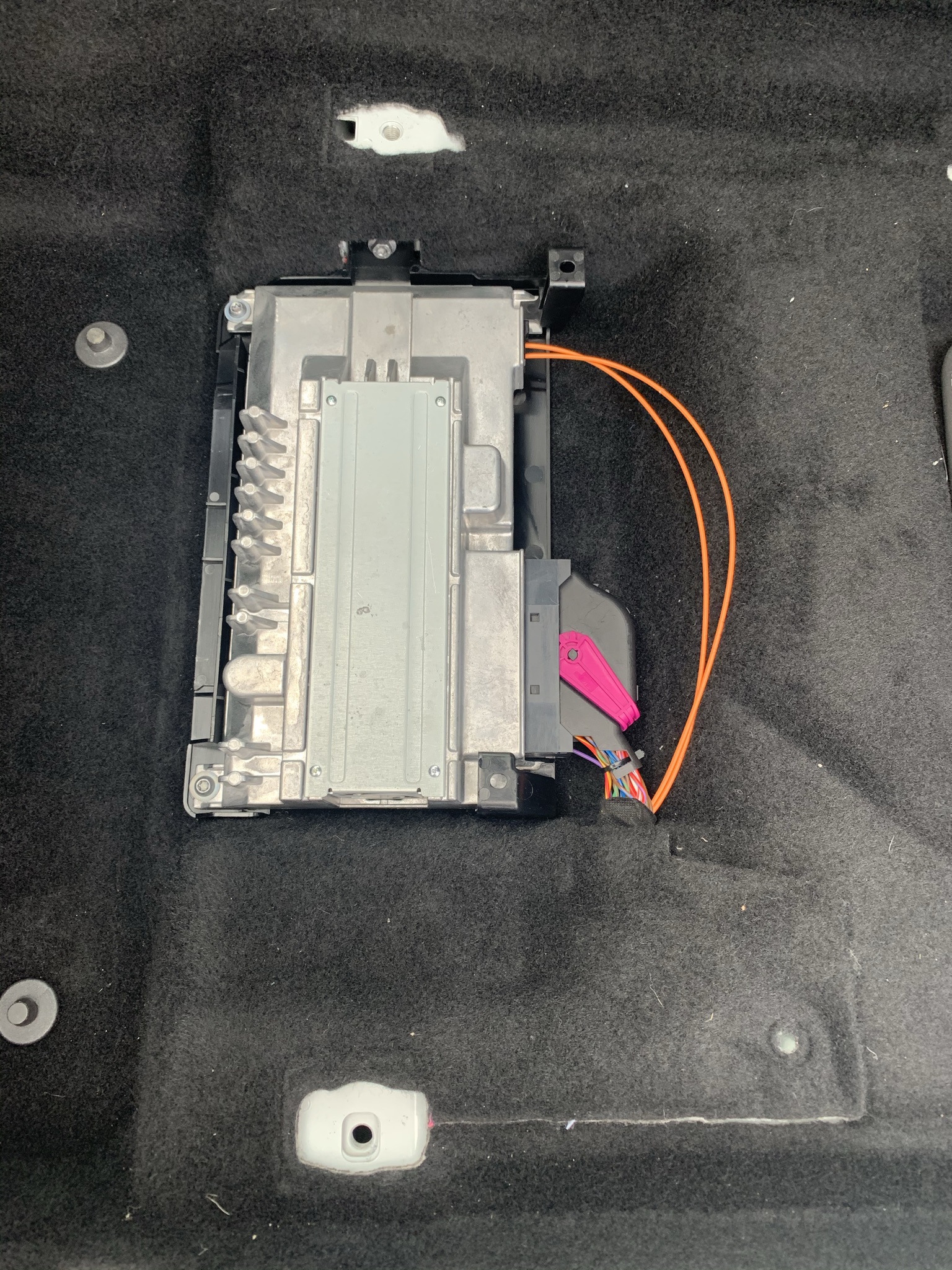

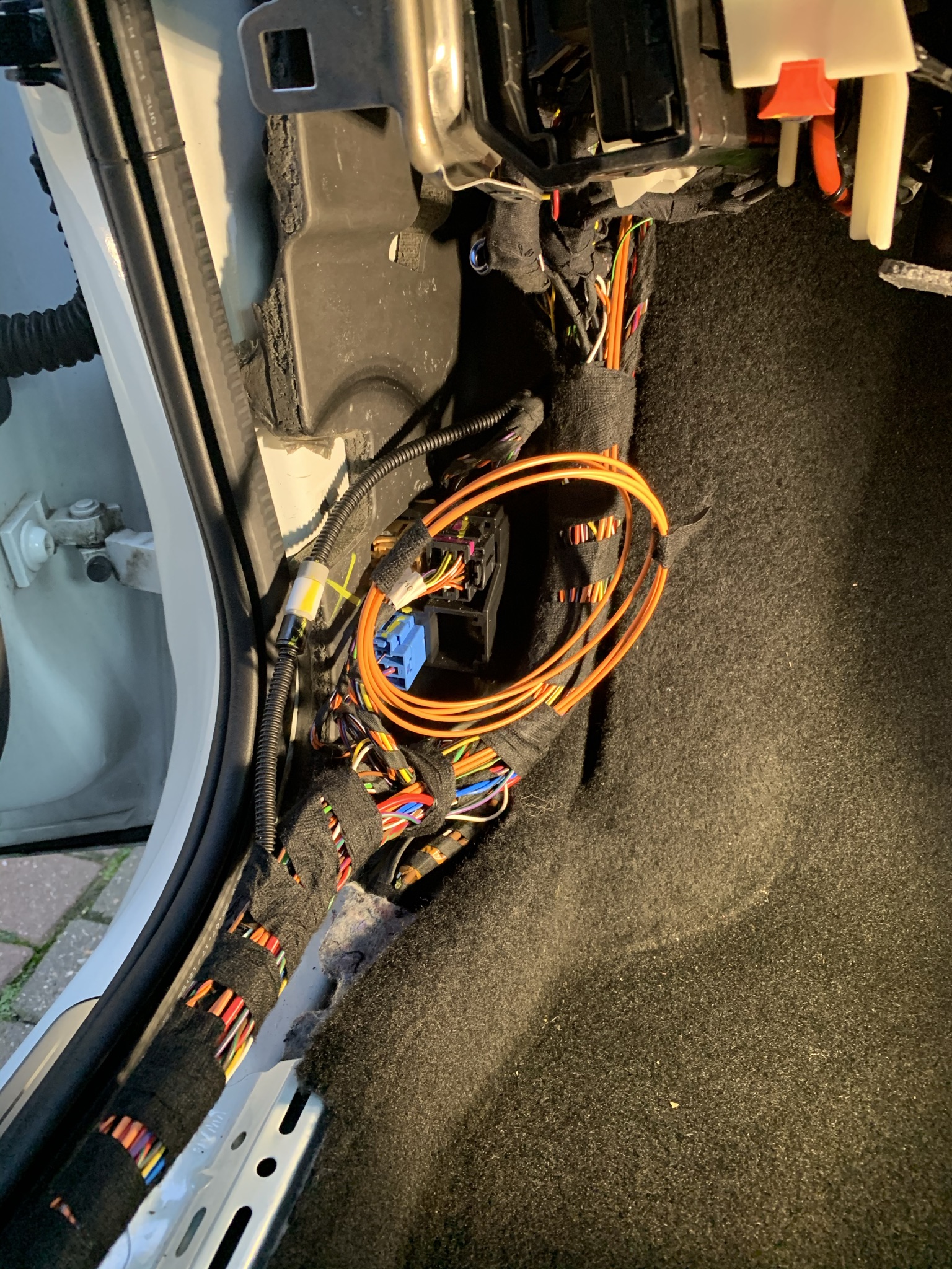

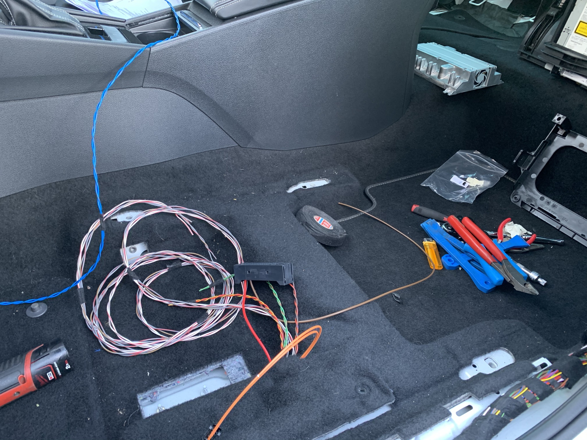

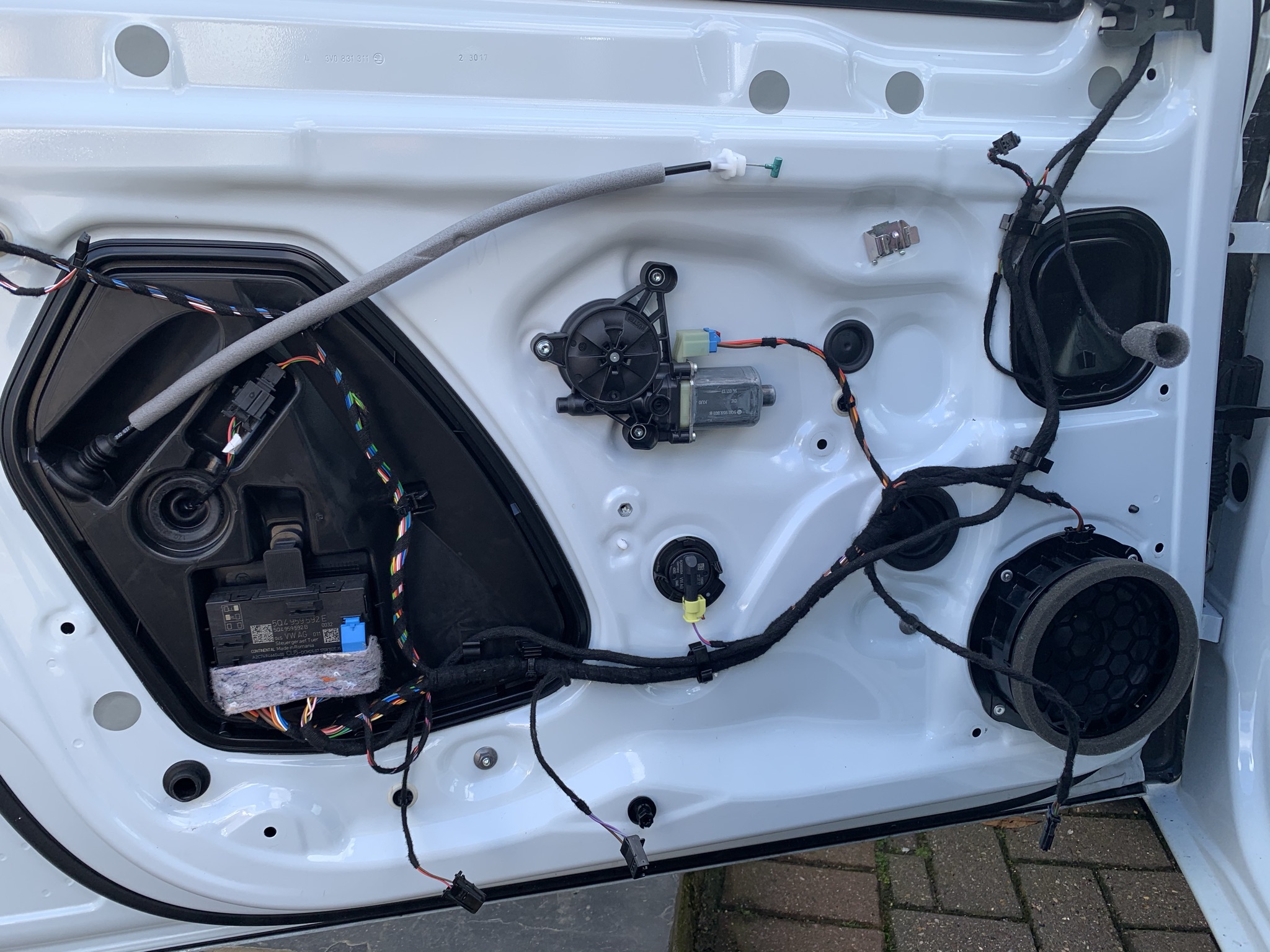

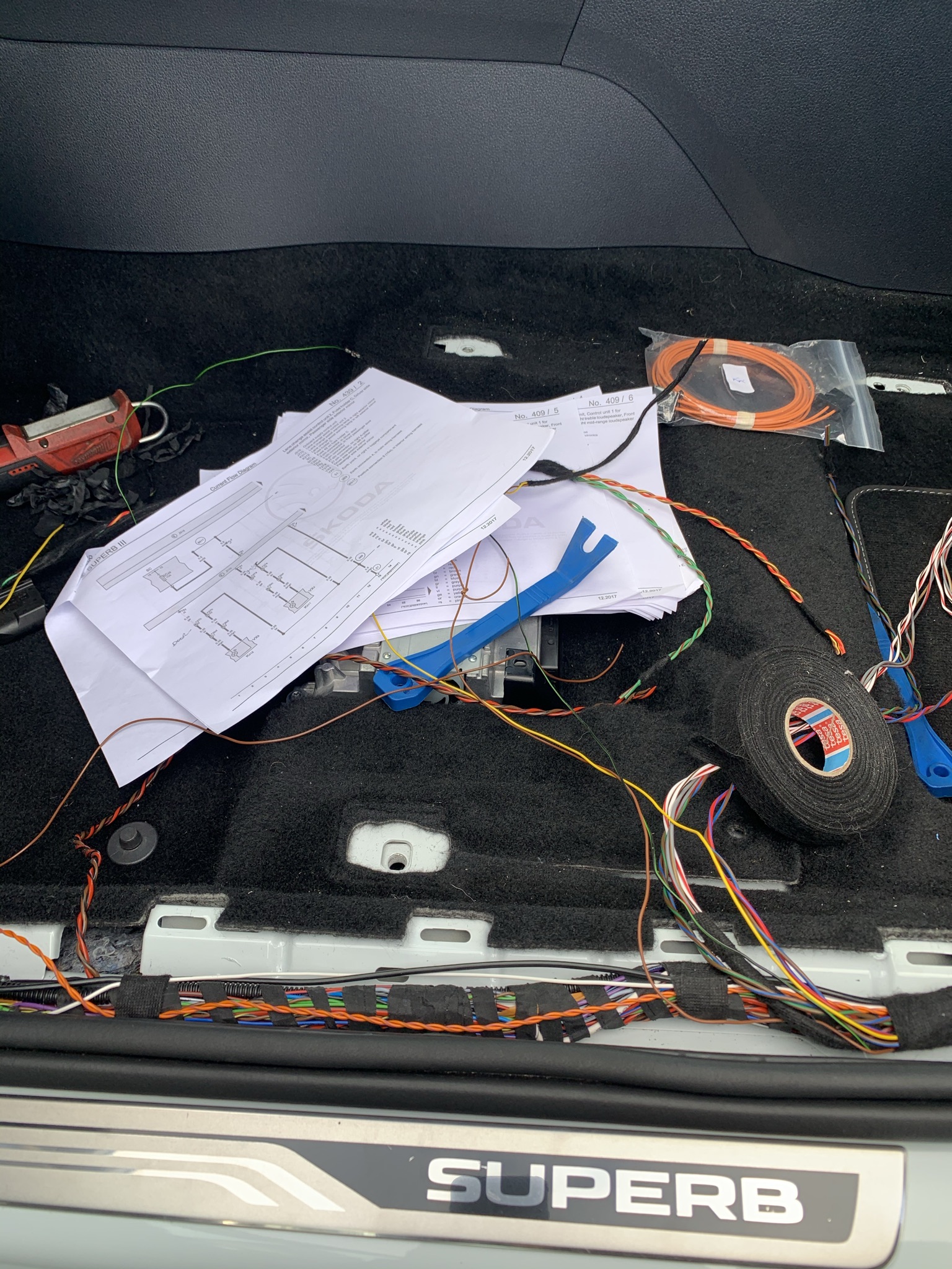

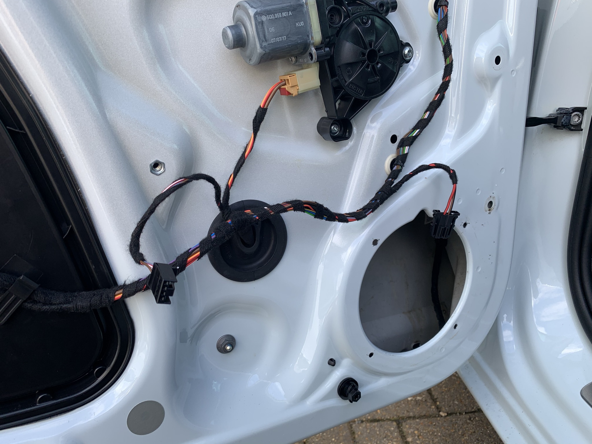

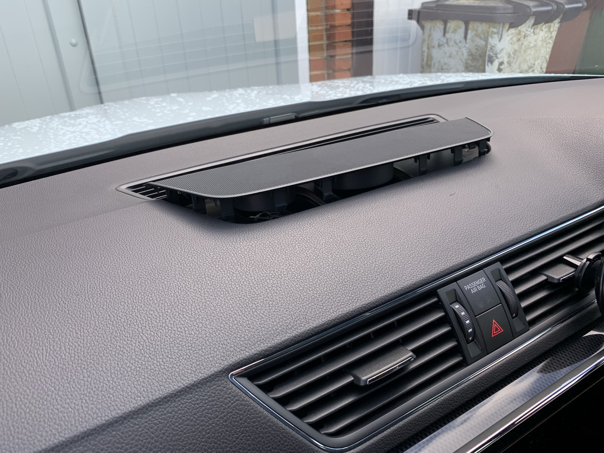

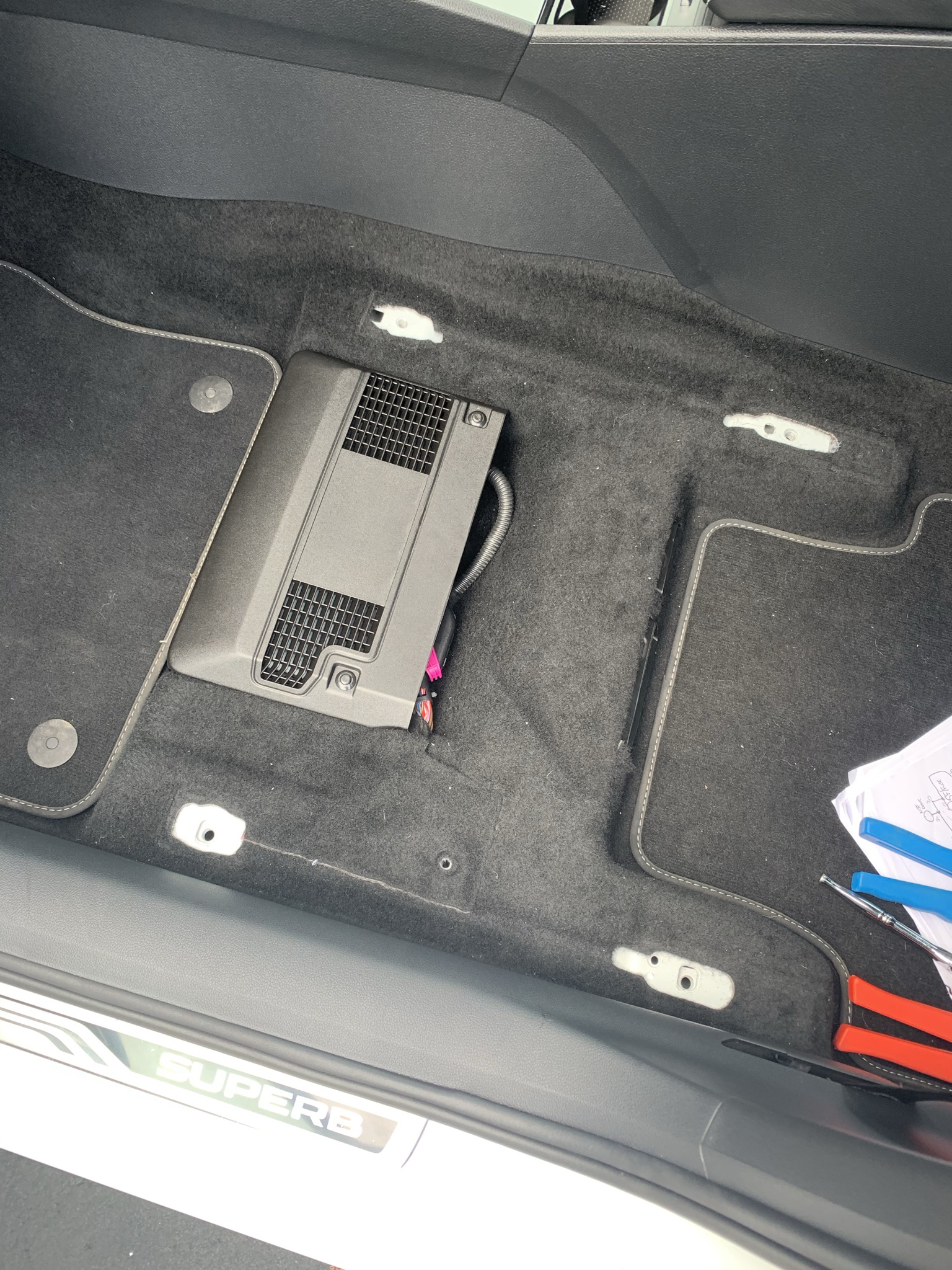

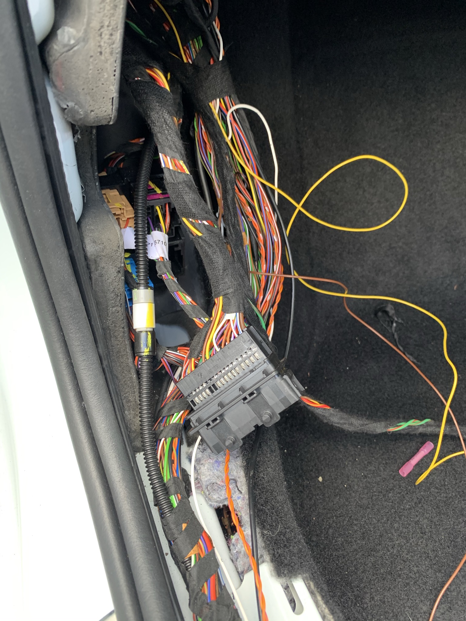

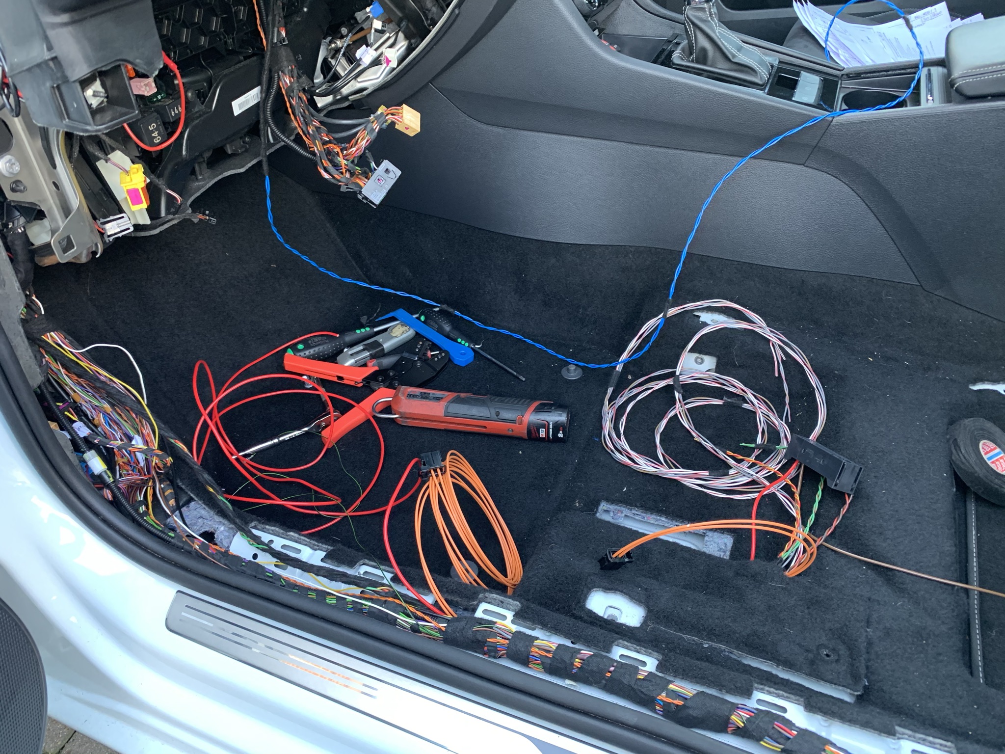

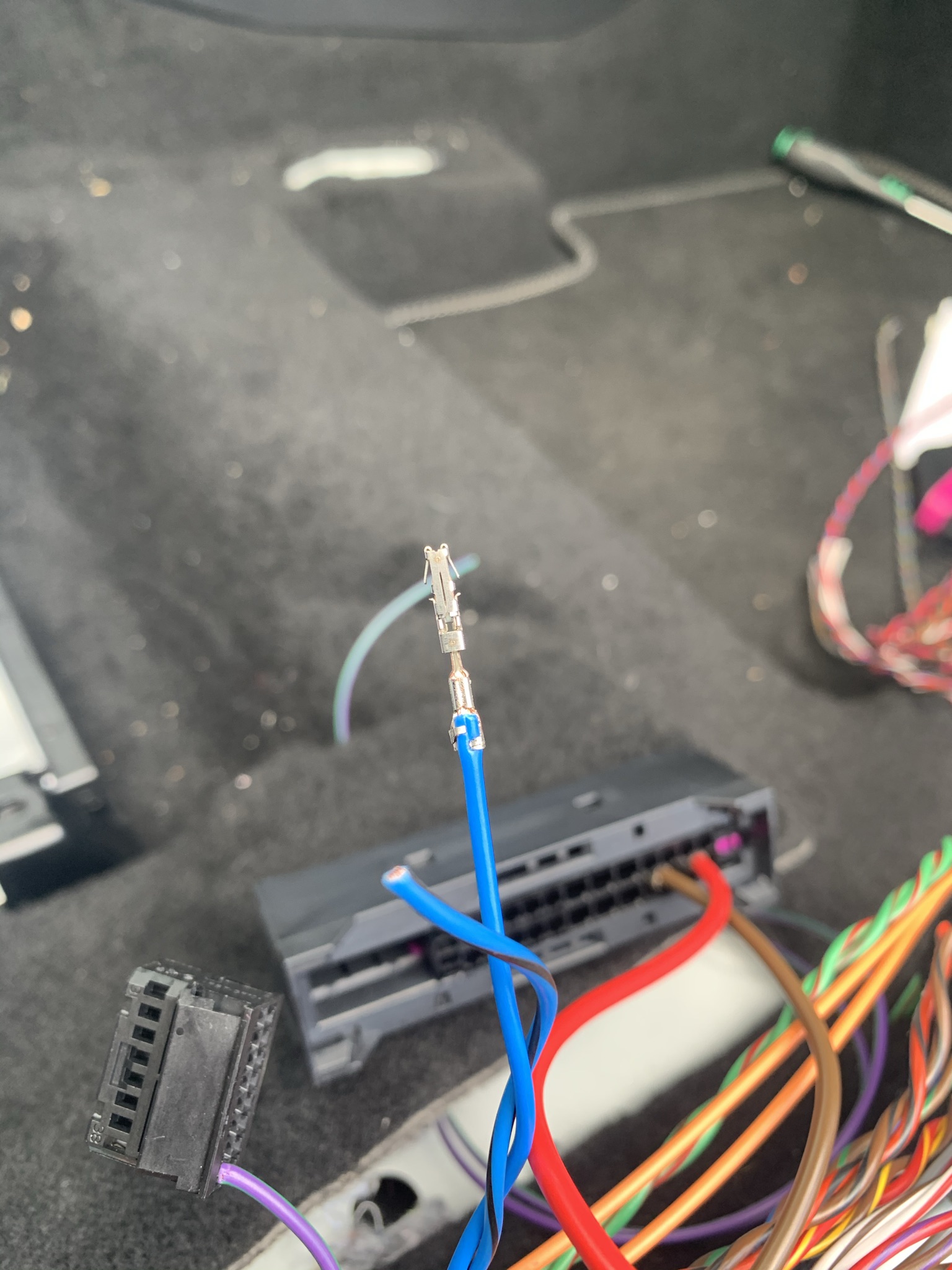

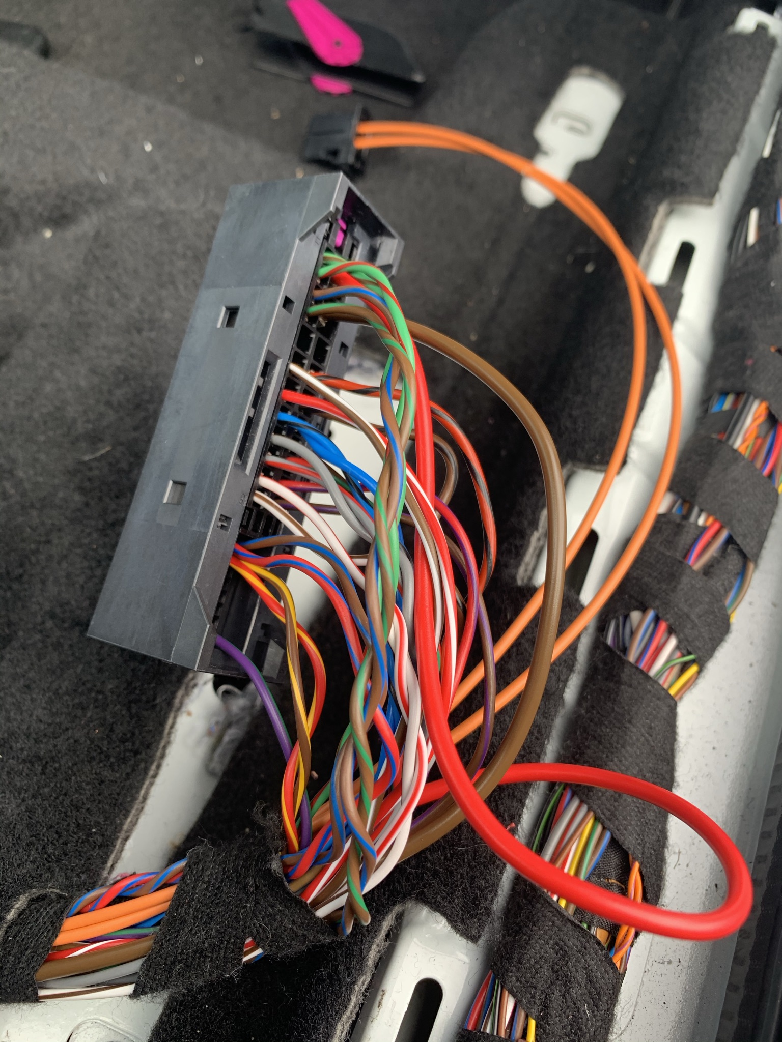

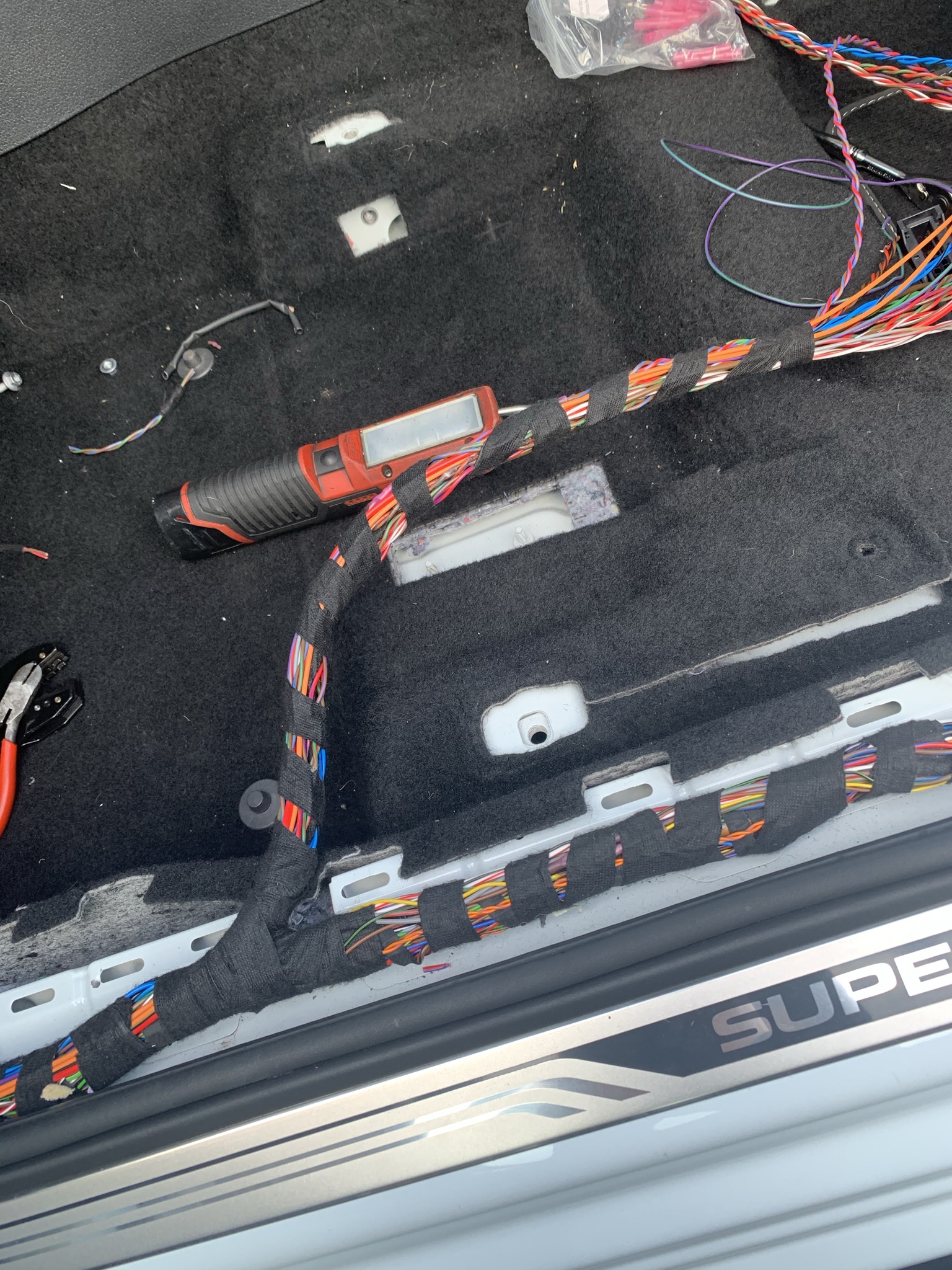

If its of any use to anyone.
Ive fitted the full canton system is a 2018 skoda superb.
Required roughly an additional 140 METERS of new wiring in mostly twisted pairs.
Heres some photos for all interested.
IMG_3703.thumb.JPEG.10220c3cfe50cc77e56a3e947515f246.JPEGIMG_3702.thumb.JPEG.08a9066e7cb1291875ddda6bc56a4c98.JPEGIMG_3697.thumb.JPEG.7ee05a387f2f33b6c49c4ffa2138f4cc.JPEGIMG_3694.thumb.JPEG.34624920a98ee6cbd004ca3066c6a586.JPEGIMG_3691.thumb.JPEG.c4928a875ab07e8b2dc5795605516625.JPEGIMG_3688.thumb.JPEG.8d5ddff8cde53c6611c19ab6993ac531.JPEGIMG_3686.thumb.JPEG.9e4eaf63504a3ecef6772c37675c64cd.JPEGIMG_3685.thumb.JPEG.854e44b065cb4e5f8e2d550281ade8b7.JPEGIMG_3681.thumb.JPEG.dd70aee662d8df8eab8675cf8fcf635c.JPEGIMG_3678.thumb.JPEG.0aa49f9ea3e6913cb41fb42c78793b76.JPEG4.thumb.JPEG.ce172ab7d57f1850e8233033750d89f2.JPEG3.thumb.JPEG.01d9569ff3020f73b5d2e420bb637ed6.JPEG2.thumb.JPEG.8a6e928c9f033251fff2acf63bf94fb5.JPEG1.thumb.JPEG.8e7a63b6def2c0f23e75a7dc1455e806.JPEGIMG_3709.thumb.JPEG.931df21b8645cc61b4040b424c4513bc.JPEG
