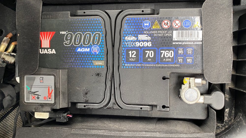

Which battery do these cars come with as standard?
I've only had my VRS 230 a week now, and was surprised to see a Yuasa 9000 in the engine bay: https://www.yuasa.co.uk/ybx9096.html
Considering the car is only 4 years old, I'm equally surprised that the battery has needed replacing.
I'm sure it would have come with a battery made for 'start-stop', as this one is, but possibly a Varta, or something similar?
Is it common for the battery to be replaced within 4 years?
Yes batteries do die and skoda fitted moll efb batteries which are no where near as good as the agm thats been fitted to yours .
There was also a reportedly duff batch of Moll batteries too, which might coincide with the year of your vRS.
Gaz
I have a 2018 Octavia Scout which had its battery replaced under warranty during its 2 year service. I hadn’t experienced  any problems with the battery so I guess they replaced it knowing that it was going to be problematic.
It's a good battery by all accounts, might be worth checking it's been coded in correctly if you don't who and why they changed it.
