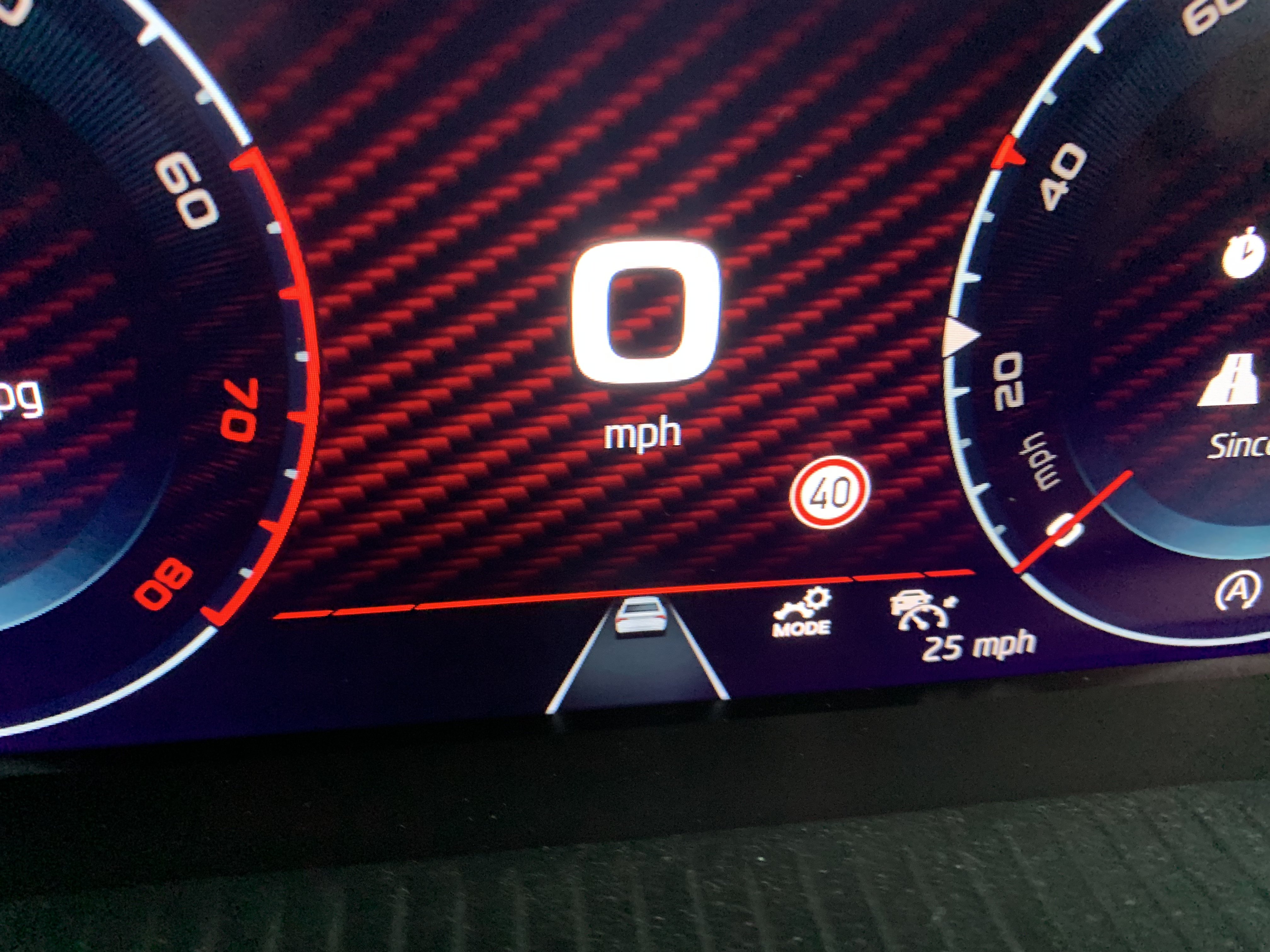

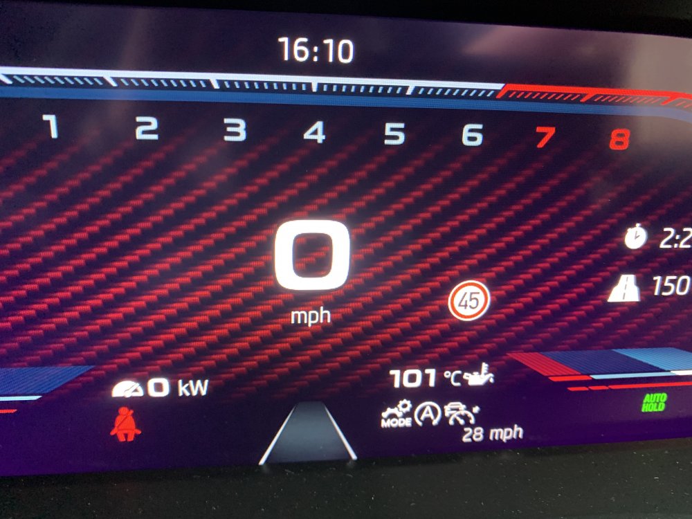

Here we see 45kph instead of 30mph
I've been getting this fault intermittently in my Karoq, sometimes coupled with a message that the headlights have been set for driving on the right! It seems to be linked to particular roads and I was thinking it was due to a bug in the mapping software, but Skoda UK say not.

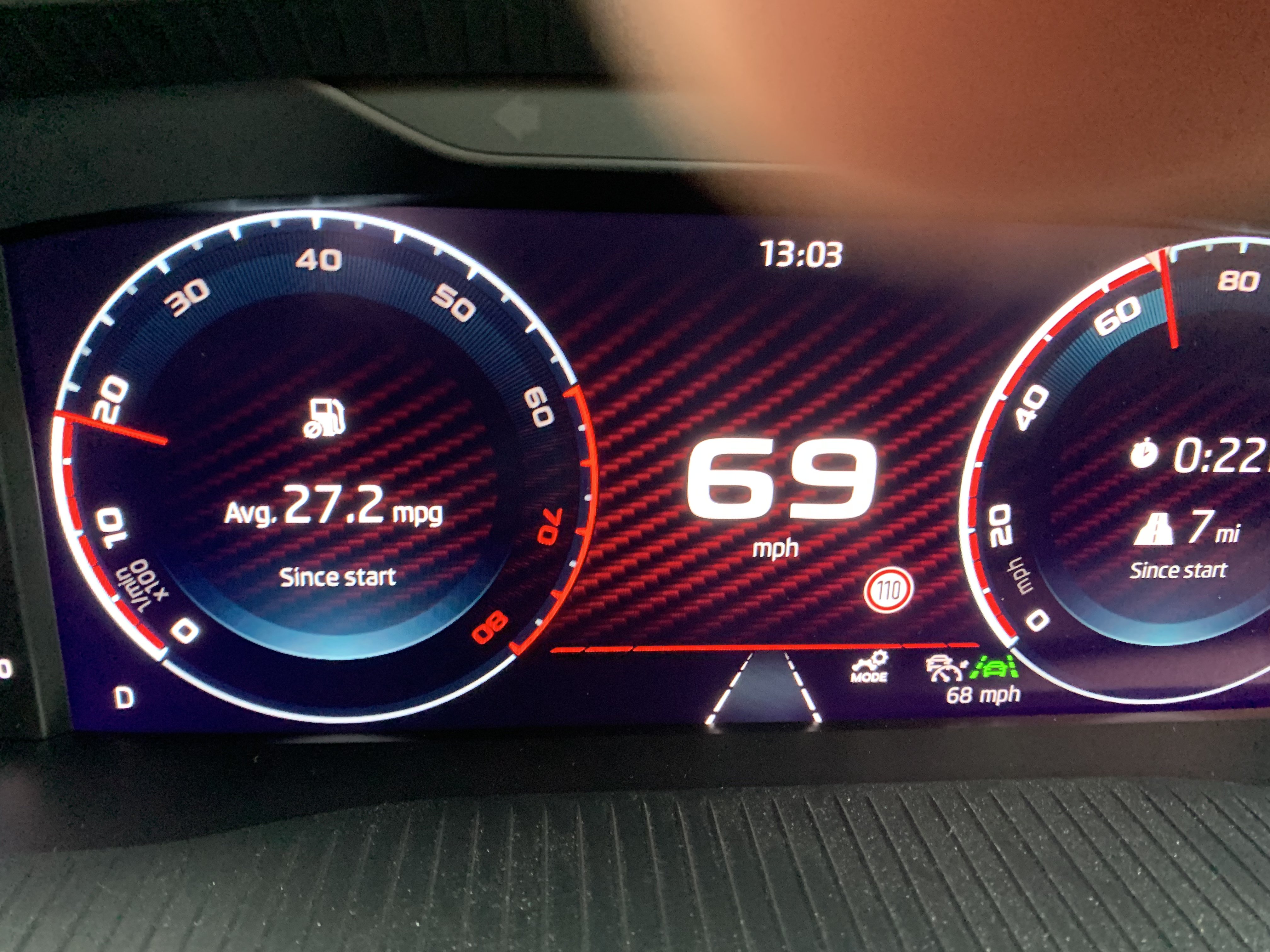

Edit: Scratch that out completely.   Time has revealed today that this has NOT fixed my issues with kph/mph.  It’s exactly the same as it always was!   Still incorrectly reading road signs in kph and adjusting my speed accordingly.  Some roads seems more prone than others, where it tends to always happen, but not always and at times it seems random. Noted that headlight adjustment settings are still automatically reverting back to driving on the right.  Also, ACC automatically tries to stop you from overtaking still, thinking you are undertaking.   So this proposed fix is pants if you travel assist as an option.
Here is a picture from today.
