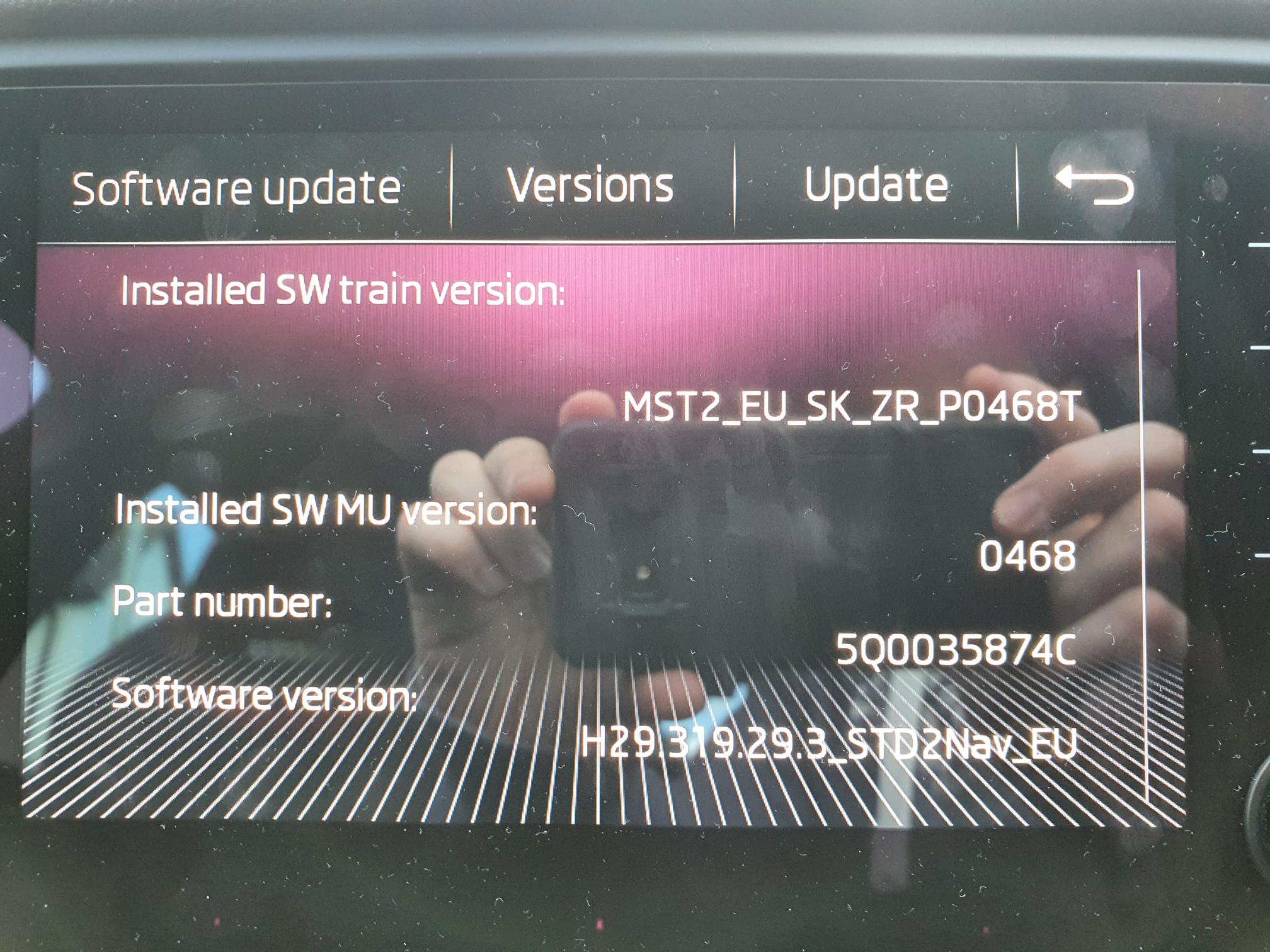

Might I suggest that if you press and hold MENU, then go into the Version information, take a photo of the information presented on the screen - there maybe a fix to the slightly dull sound by a firmware update.  There are lots of options to enable - including enabling Skoda Surround.
Is this what you mean?
Okay. You need 0478 and I will.tag @pab567
who will hopefully be able to send you the appropriate file.
Link sent via PM
So @Al123
are you happy with what to do with your firmware file. I have written a guide on how to apply it if you need assistance.
