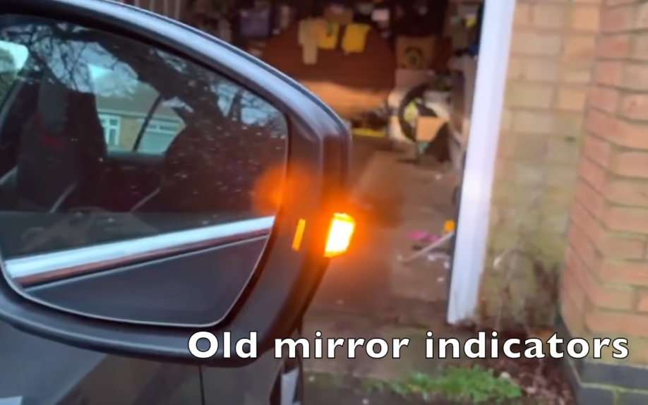

Has anyone fitted any of these "Dynamic" indicators - ie Audi-style that fade in? If you have, does the lens inside the mirror frame illuminate? I got some and fitted them, but as you can see from this video, the lens inside the frame doesn't illuminate and neither does the lens at the outmost tip of the mirror. Only the strip in front of the mirror does.
This would be an MOT fail (and be illegal) because the side indicator repeaters have to be visible from all sides of the car including the rear and just having the LED on the front of the mirror illuminating means they aren't visible from even the side of the car unless you are in front of the mirror. I'm sending mine back, but they were much brighter at the front so if you have any suggestions or links for better ones, let me know...

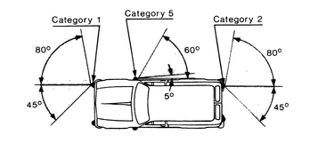

I don't think they need to be visible from the cabin, if I recall correctly, they should be visible from a 5 degree angle from the rear? You'll have a better idea than I do if they actually are?
Anyway, I expect most aftermarket dynamic indicators will be pretty similar. Even the expensive superskoda variant which is allegedly 'e-marked' may not show to the rear - at least based on this video as there appears to be a dark segment at the rear:

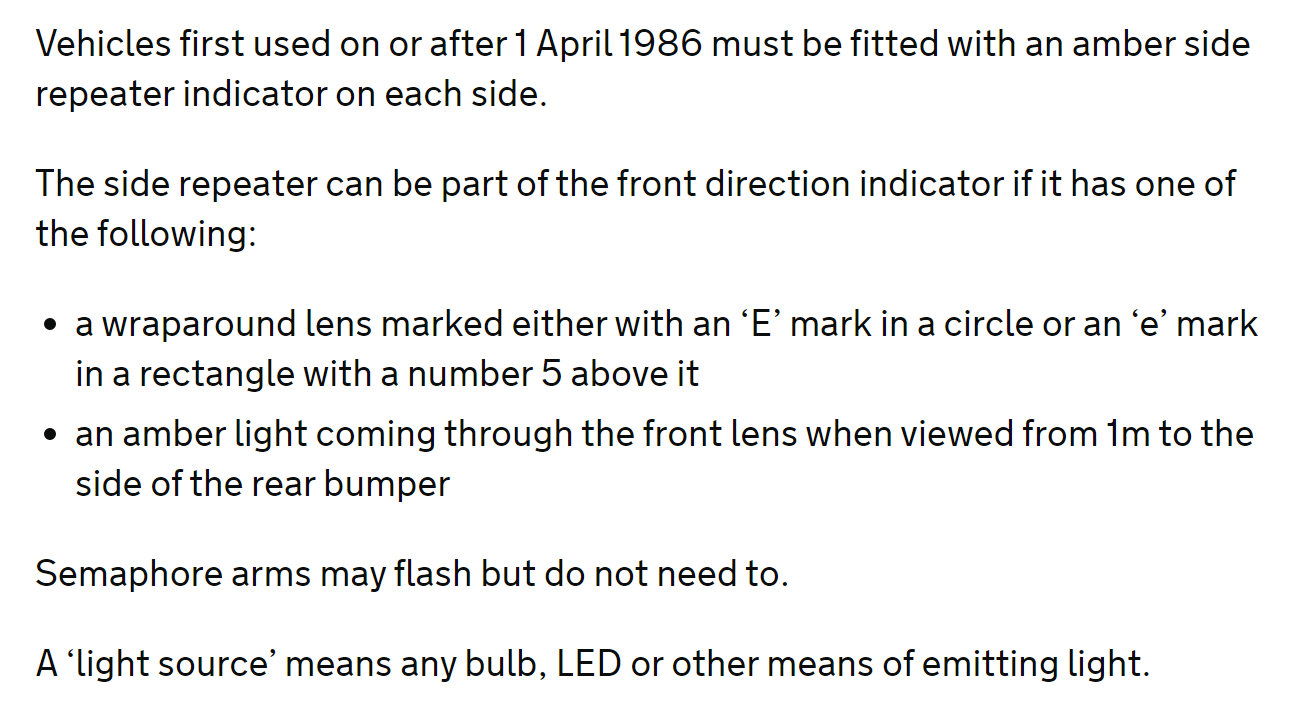

Are you sure?
Double checked the government and mot tester sites .....
https://www.gov.uk/guidance/mot-inspection-manual-for-private-passenger-and-light-commercial-vehicles/4-lamps-reflectors-and-electrical-equipment#section-4-4-1

No, they don't need to be visible from the cabin (thats what the dashboard one is for), but they do need to be visible from behind - which is what the tip of the mirror illuminating does.

Yes, it's this bit that juts out that needs to be visible from the rear
It looks like other ones work properly, so I must have just bought cheap as mine don't illuminate at the ends like others do...

https://www.legislation.gov.uk/uksi/1989/1796/schedule/7/made
But also, it is an MOT fail to not have a side repeater on a vehicle made after 1986. If the side repeater isn't visible from the entire side of the car, including the rear, then it should be failed as not present. But no idea if a tester would go in to that much detail when checking.

In your world maybe, in the real world MOT testers are not obliged to test the regulatory compliance of items on the vehicle, just their presence and in some but not all cases that they function.
A type approval application would do, an SVA test also but to a lesser degree, often the presence of a CE mark or an E number on headlights etc suffices.
I'm afraid in this modern world most things are a self certification paper chase and Certificates of Conformity even if they are fantasy are the King, I have serious doubts that the tiny clear lensed LED indicators hidden amongst the garish Christmas Tree rear light clusters on many modern vehicles meet the construction and use legislation, they may do in isolation but surrounded by the glaring red Blackpool illuminations its impossible for me to see them operating.
The MOT manual only imposes specific constraints using the front indicator as a side repeater. There is nothing specific about the visibility of a separate side repeater.

My Aliexprees ones do !
Same here, I can see the indicator flash in the little window beside the mirror.
This is the link I have bookmarked from when I ordered but that was over a year ago, I see now they even provide a tool to open the torx screws.
https://www.aliexpress.com/item/32912405005.html?spm=2114.search0104.3.2.123319b1BwXbdn
