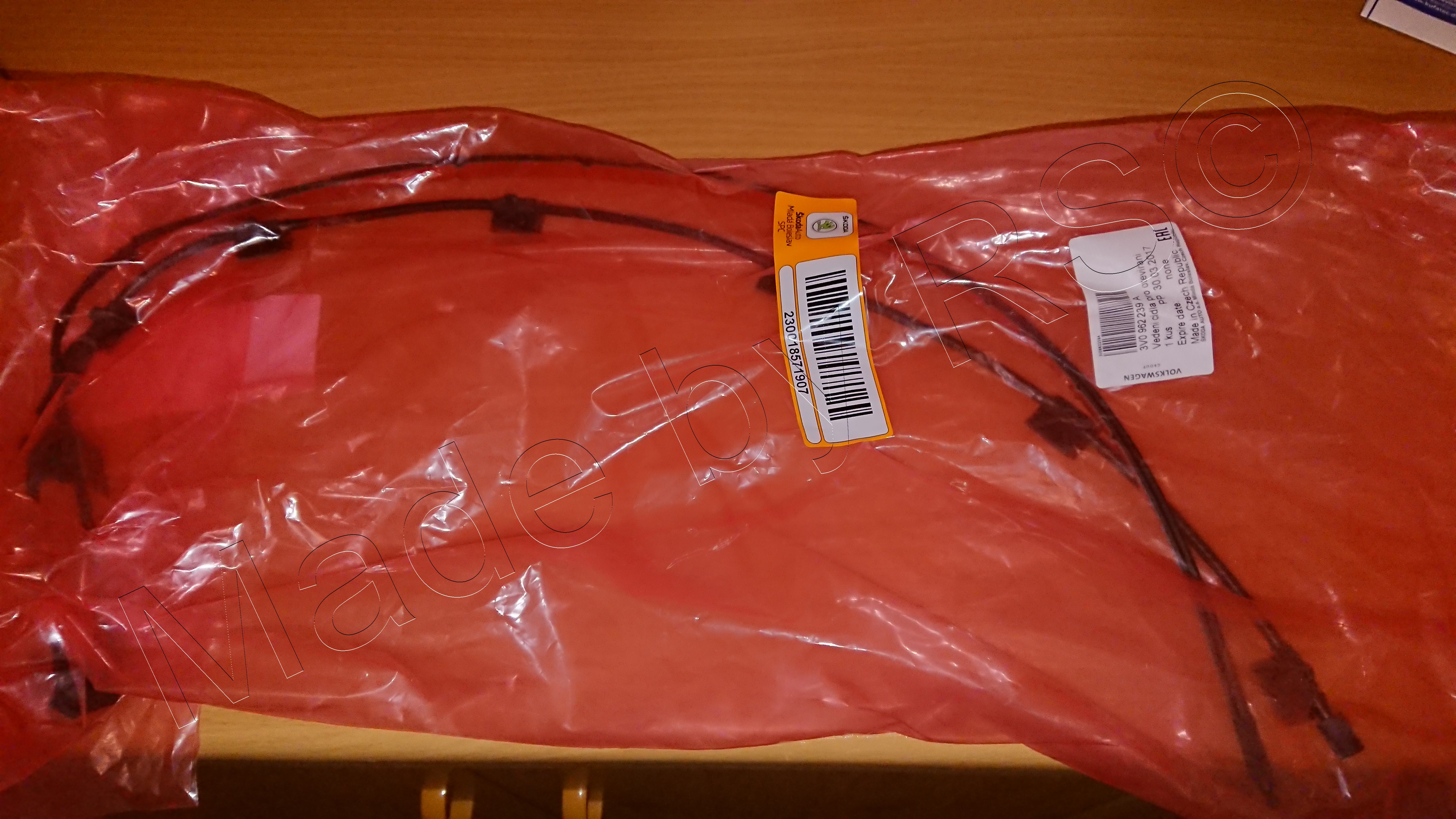

What are you looking for exactly? The part number for the sensor (encoder cable) is 3V0962239 this line is glued directly in the diffuser.
There are two sensor lines, one uses 7x adhesive-backed little square clips with zip ties to secure it, and according to the diagram (see etka 8.3 illustration above, the part  labelled "22"
5K0 962 283 Retainer for aerial Sensor line for tailgate
It seems to look like some long strip of plastic to hold the second sensor in, as the name also suggests. But the part number is def wrong for that, as you can see from the image of what the dealer provided when I ordered it. I can find that part number on other diagrams showing its true purpouse (mounting bracket to hold a kessy aerial)

For me it was the case that one line had the clips and the other line had double-sided 3M adhesive tape. There is no need for a bracket. Both lines are laid parallel to each other and glued.
As in my picture, I ordered the line and installed it. Without additional brackets.
Sure, well if skoda can't figure out the extra support piece, I'll just stick the 2x lines on, but it seems someone went to the trouble of designing the extra retainer, so if it exists, I'll get it!

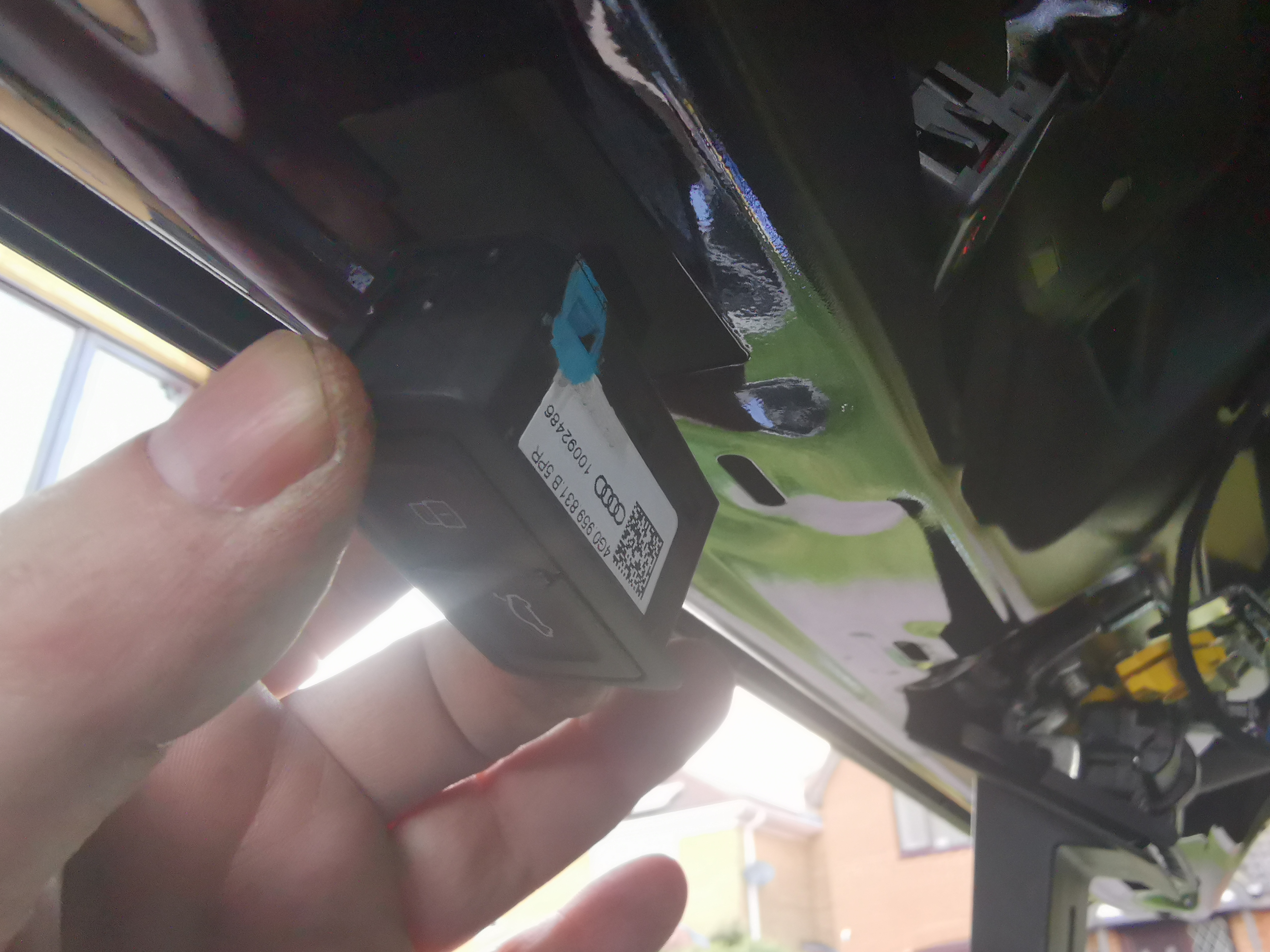

@SashaGrace I can't for the life of me find a part number for the bootlid close button that has a double button for auto close. I know it exists, but etka doesn't want to play ball and give out the part number. Going to trawl vw next to see if I can take it from a tiguan or something *edit found it by installing VW etka, it's available as 3G0 959 832A, wonder if the skoda bootlid controller will know how to handle the auto close functionality. Also has a different connector on the back with rounded edges so will need a part number for that connector, as well as to figure out which pins on the bootlid controller the "auto close" button should connect to. I guess I need to dive into the vw current flow diagrams to figure that out...

The picture with the number 22 does not belong to the EasyOpen, even if it is shown there. As you found out, the part is unusable. The part is just painted wrong. Take a look at the repair manual, they only say that the lines are glued in. There is no question of a holder. There just isn't any !!! Of course you can search if you want. But it won't lead to anything.
Vor 1 Stunde sagte AlVal:
Ich kann für mein ganzes Leben keine Teilenummer für die Schaltfläche zum Schließen des Bootlids finden
Counter: 4G0959831B
Plug: 8K0973754A

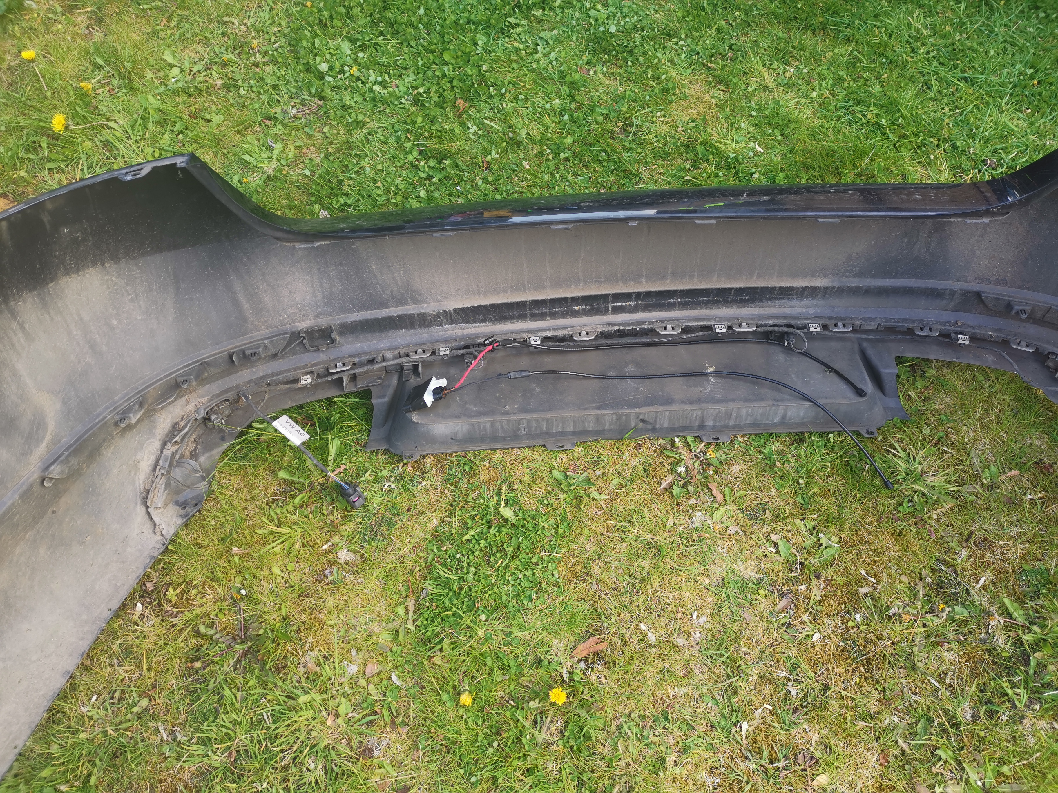

Silly question, do the sensor lines work through the plastic bumper, or are the wires fully exposed underneath the bumper? I'm expecting to mount them on the inside of the bumper here
Ja, geht durch den Kunststoff durch.

Well that was a waste of money, not good part numbers - doesn't fit

So with the Octavia it fits and since the plastic lining is the same on the Superb, it should also fit there. If necessary, adjust the cutout with a file. In your picture, you want to mount the button in the sheet metal, that can't work either.
Inside, on top of the diffuser.
The pic below shows the placement, but of course it's mounted inside.
Edited by JR RS

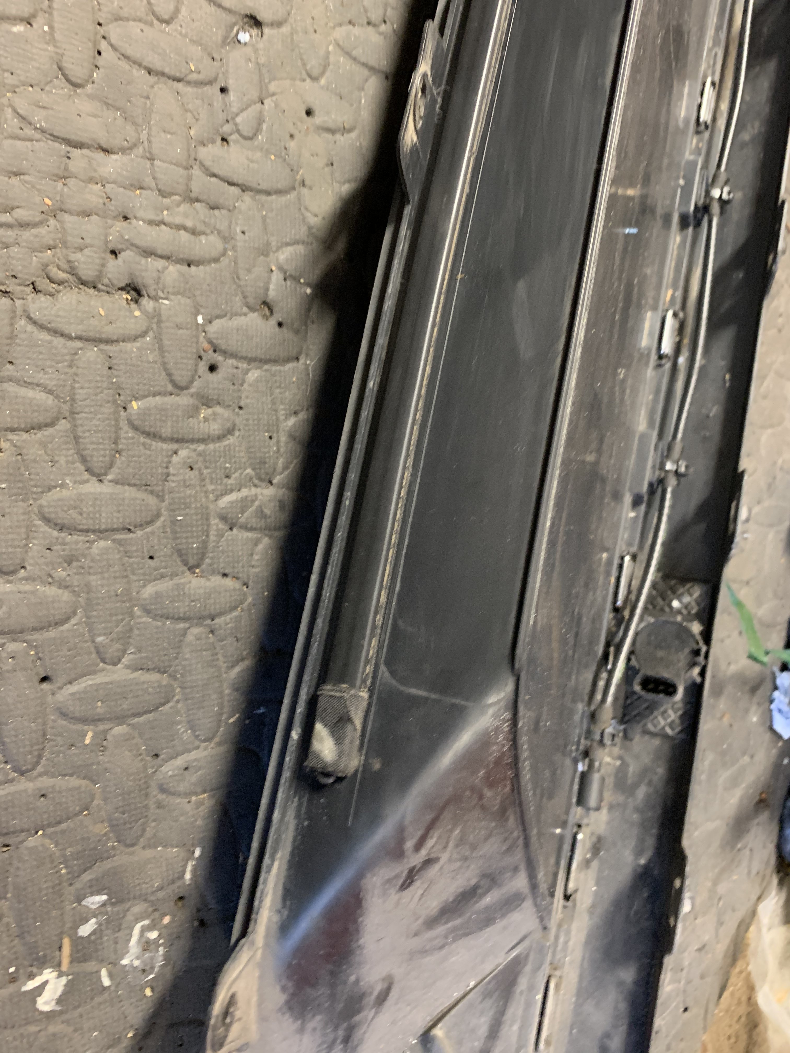

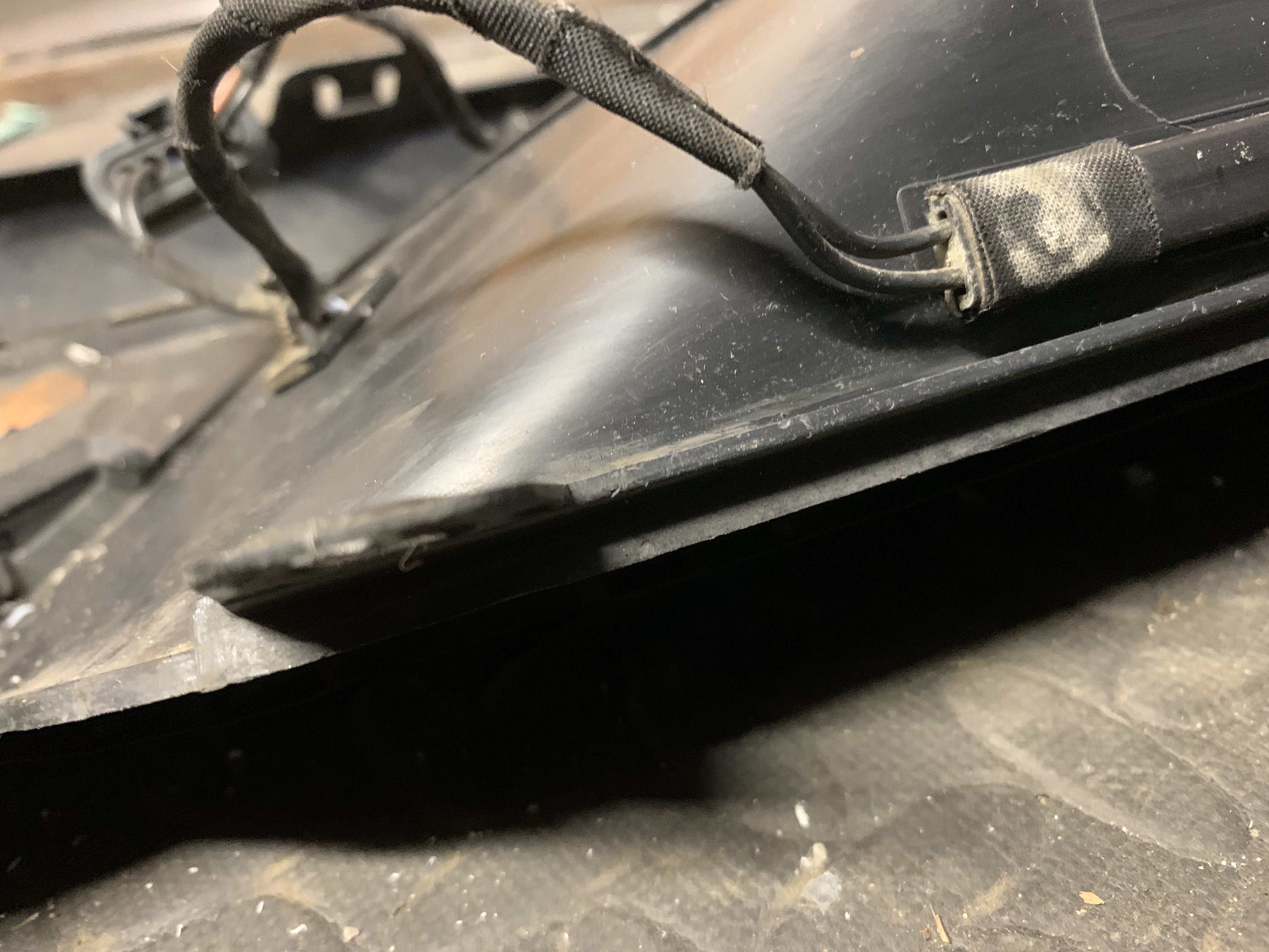

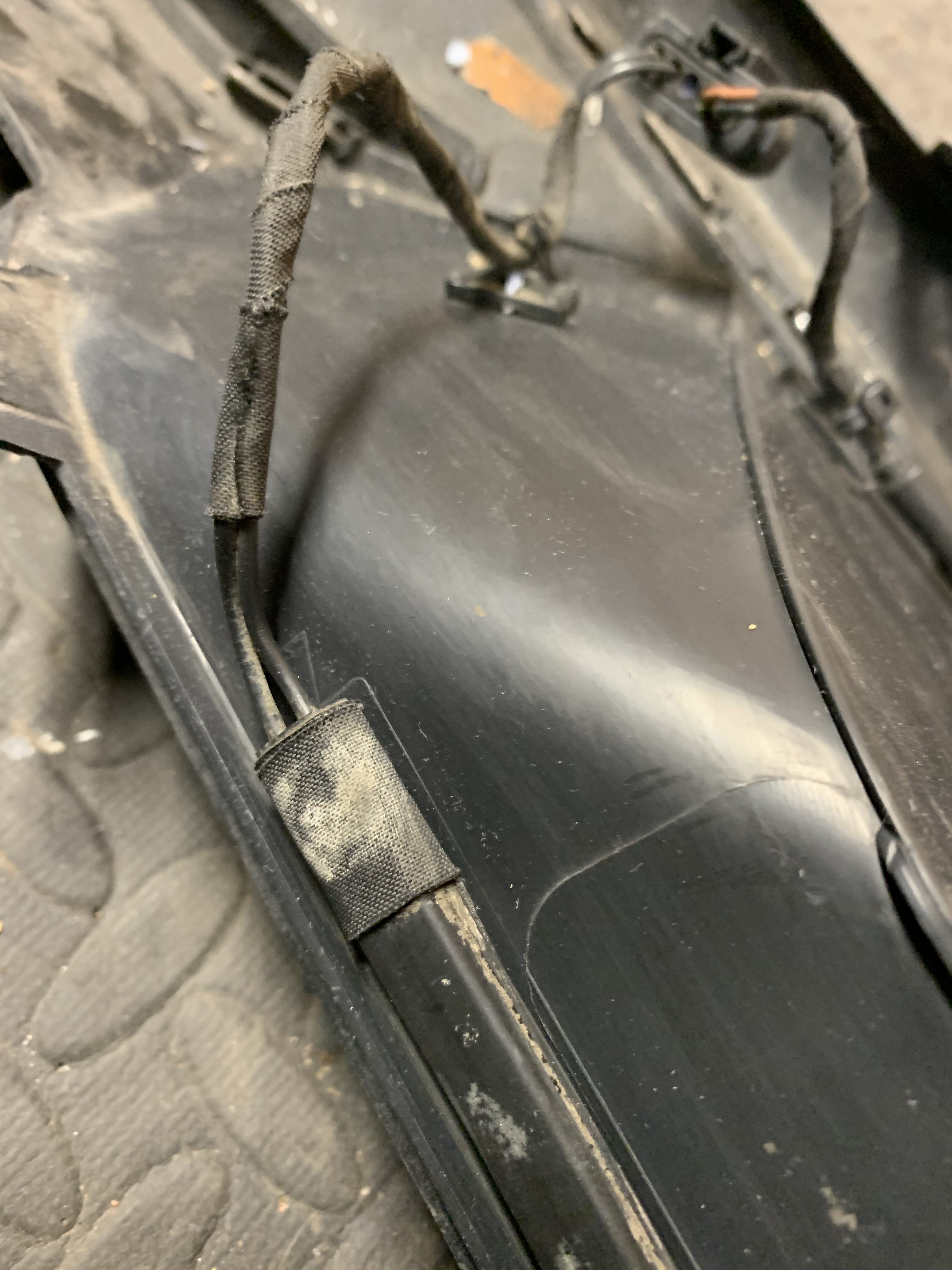

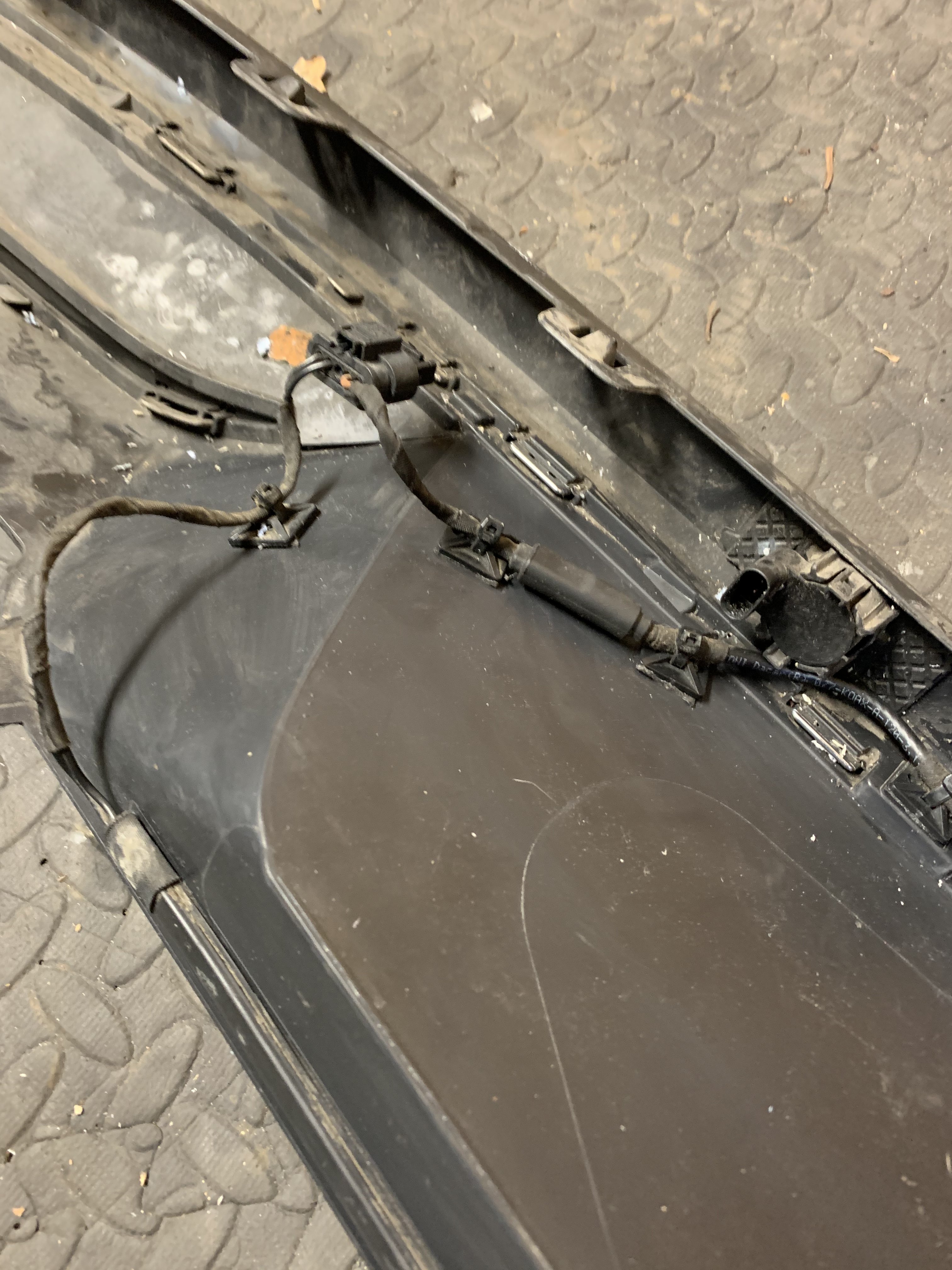

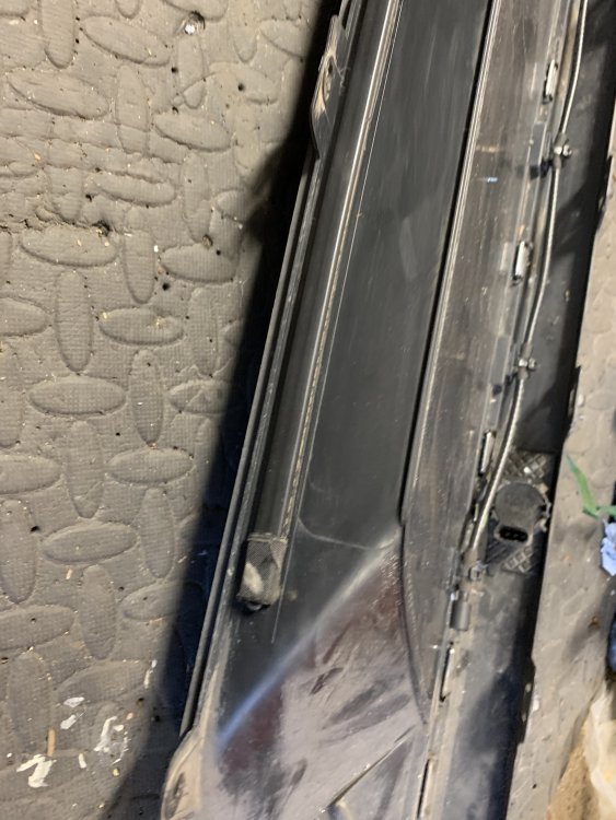

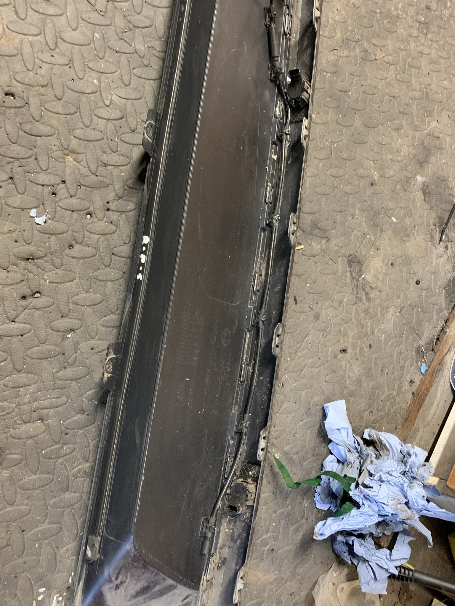

All working, here’s the photos for anyone else interested in specific fitting locations.
Turns out I fitted the old one completely wrong
