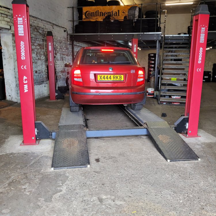

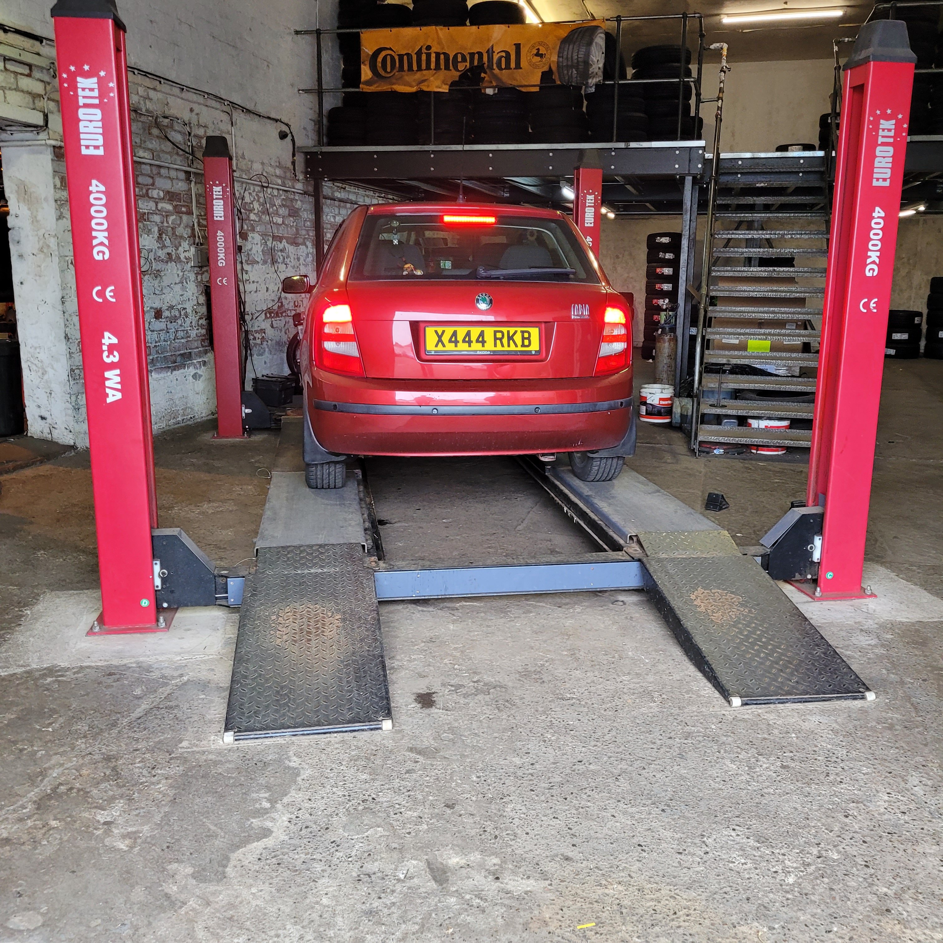

    Aaaaaaaand it's back. £131 later for a track rod and tracking. Now goes in a straight line, bonus.   Thank **** for that.

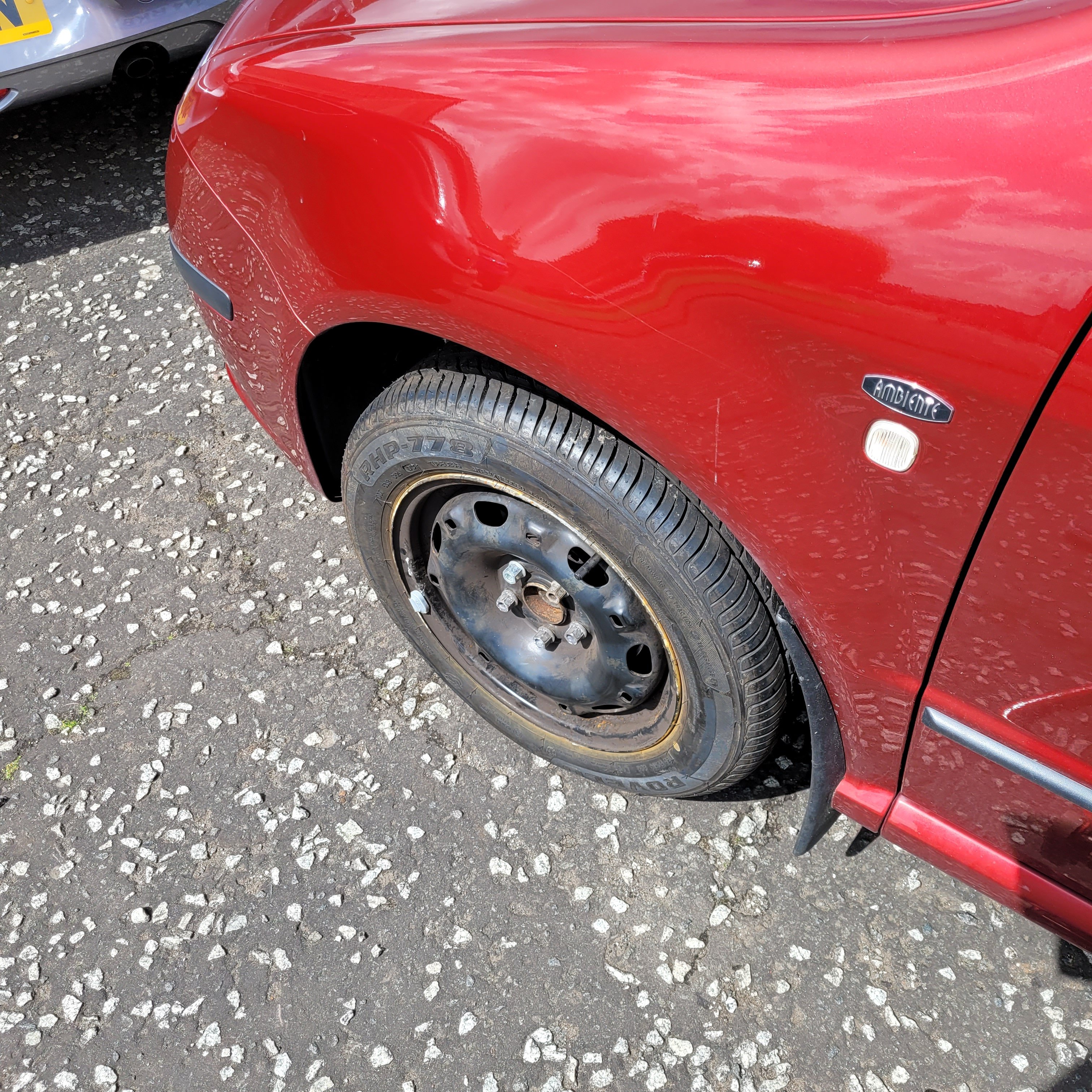

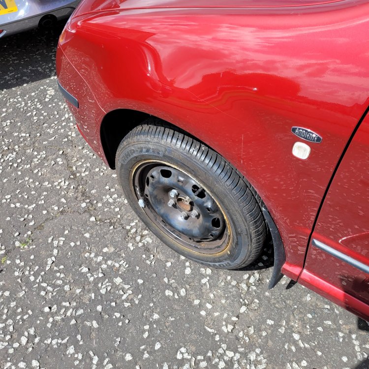

First things first, the alloy I replaced with another one came with a tyre on it, which unfortunately had a fair gash in the sidewall it turns out. So that's off and replaced with the spare from the boot. I'll have to get the tyre swapped between the FUBAR-ed alloy and the "better" one so that I'm not on the steelie for another eternity. :D

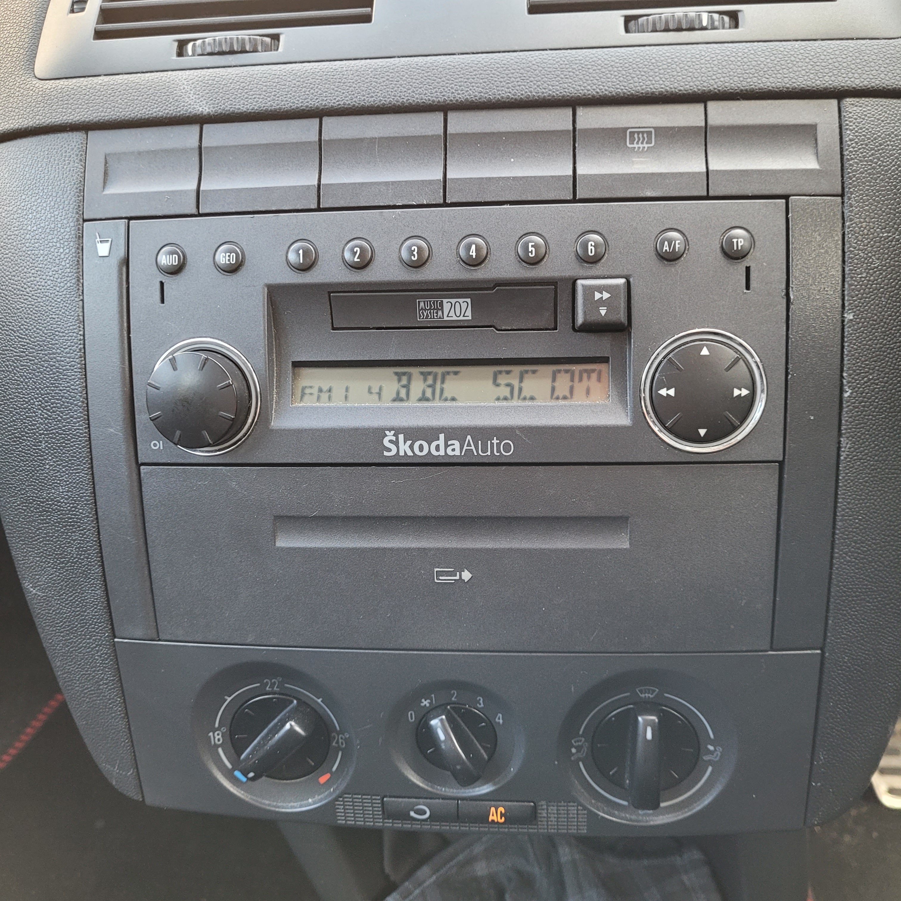

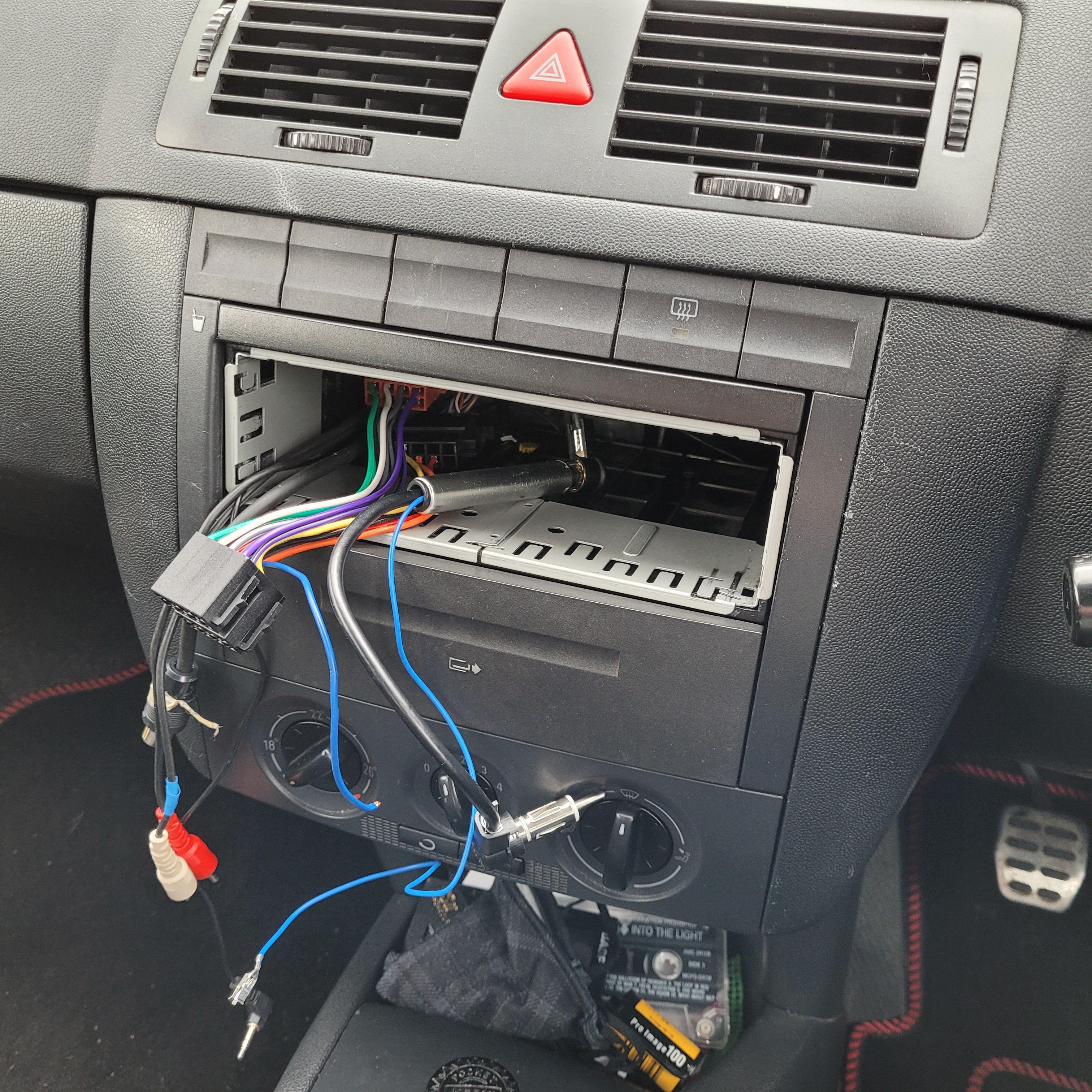

Secondly, I missed having AM radio in my car so that I could listen to a local station which doesn't broadcast on FM. So after being scalped by Halfords, I have an antenna amp thing for the car. Fitting this required having the stereo out, which then wouldn't stay in the dash. This was fixed today. Wiring for the antenna amp was done using the blue wire on the ISO loom and the wire from the amp and a crimp. Now works like a wee champ. Today was also when the fitting of a part I ordered was done... I finally managed to source a DIN drawer from an Elegance.
Job's a good 'un. :):thumbup:

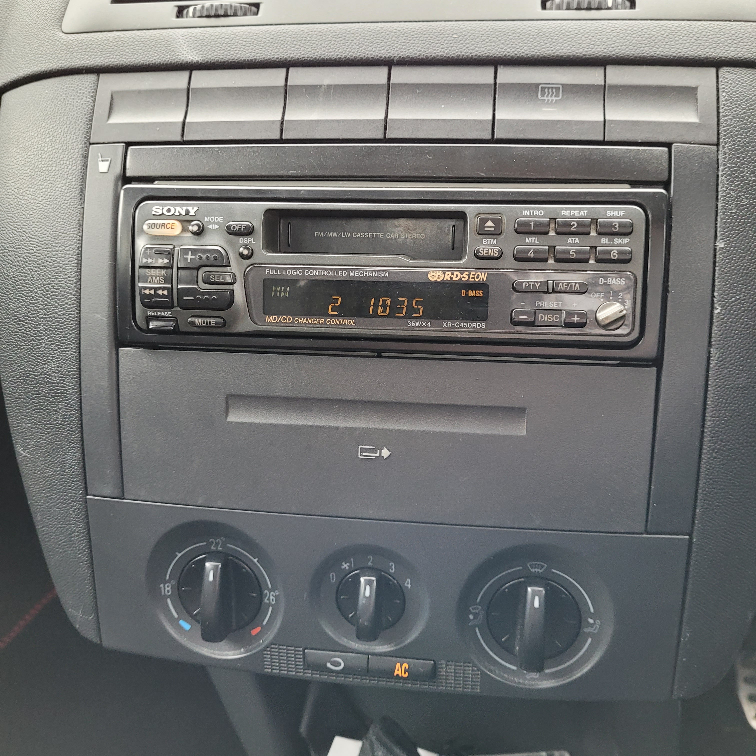

That bloody Sony barsteward. It never stays in the dash.
I may have fallen out with it... just a little and bought an MS202 off eBay. I'm losing the CD changer at the moment but I've still got the cassette. Been looking for an MS502 but those are scarcer than gnashers in your typical farmyard fowl that were subject to a stop-motion movie about flying, an MS402 would even do right now, but it's a wait and see thing really. In the meantime, here's what I've rammed into the dash. It didn't even want a code, which was bizarre, but I'm not complaining. For a basic wee unit, it sounds rather good too and I have interference-free AM radio! :)

Aye, it's a bit basic though, no use of the rear speakers and no CD changer capability but it glows green when I ask the whole interior to, it gets me AM radio for the one local station I like, and I've still got the cassette. :)
Thank you, it hasn't been easy at times. I always consider that this is OEM+, as if it's kitted out the way it should have been, not to the spec of the skinflint owner who specced it lol. :D

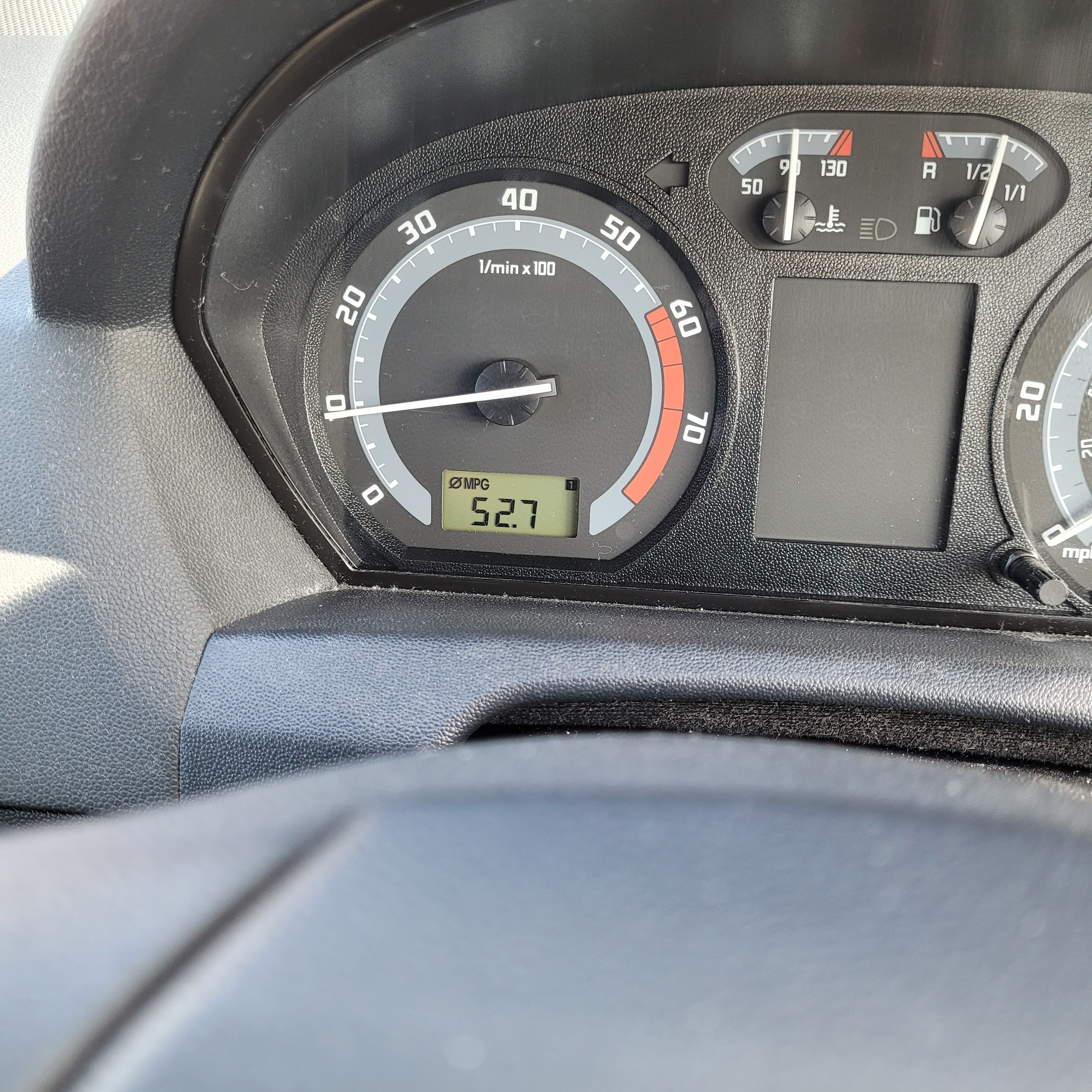

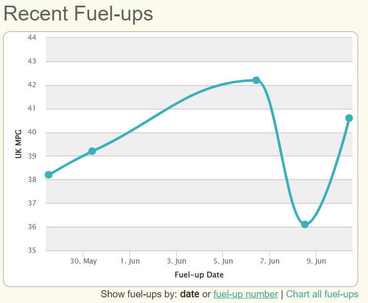

As yous will know having read this thread, I've got some sort of unknown issue that keeps coming and going (as my Fuelly will show you as well)...
When the car isn't too great, it's seeing about 36mpg at best, but when I'm lighter on the throttle I can make some bizarre numbers pop up on the screen... I can average 42-44 when it's okay anyway.

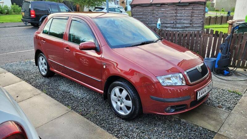

Anyway, I've also given the car a fairly substantial wash as it was absolutely ****ing filthy...
Now a little more fresh though... :)

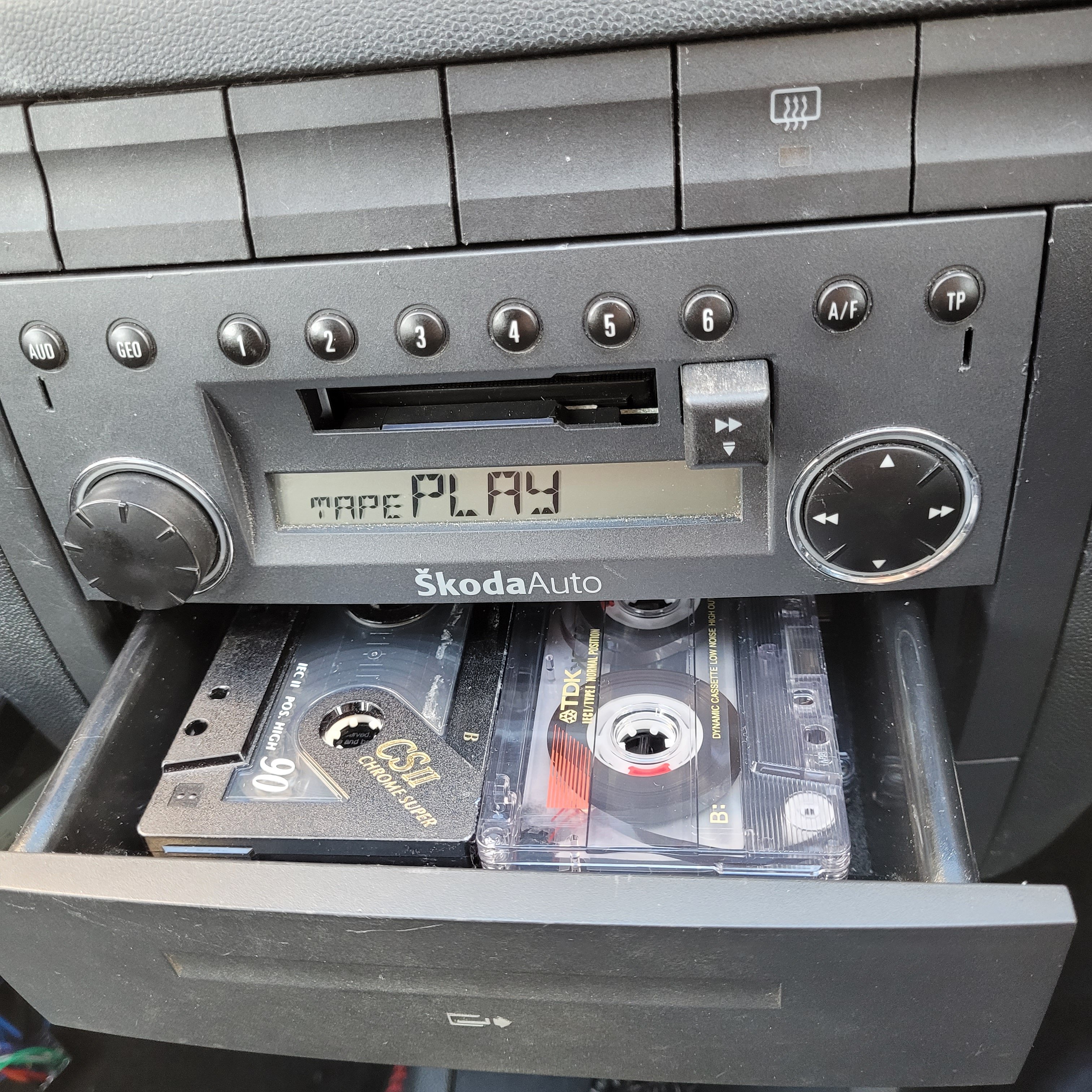

Did you decide you didn't like the standard Skoda stereo you bought, Ryan?
The lack of rear cabin filler as a result of the MS202 wasn't working for me, since it doesn't output to the rear speakers at all. The Symphony went back in this evening as well. The Alpine's blue display is too glaring sadly... the Sony I had been using may have blown up when a wire broke free from the aerial antenna crimp and shorted in the back of the stereo... so I'm hunting another one of those down for mucho cheapness now. :crying:

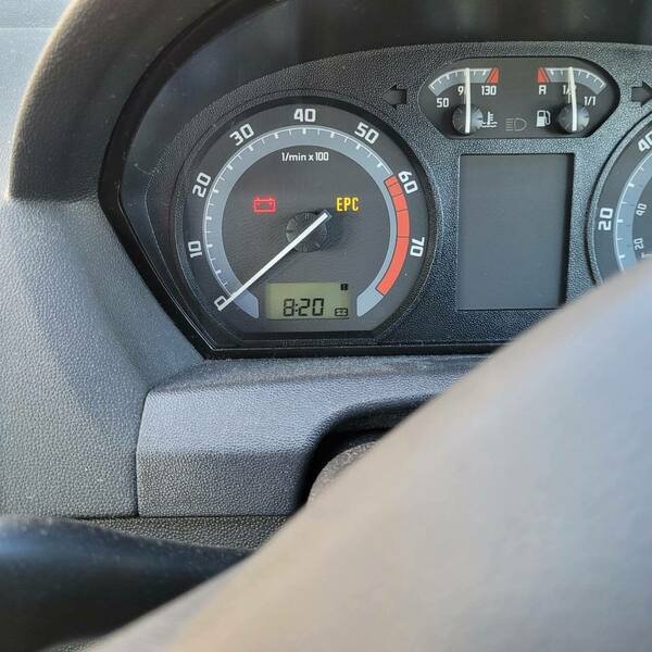

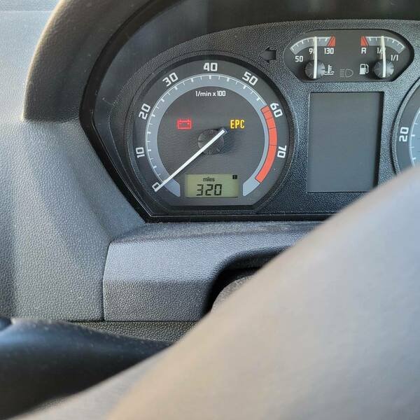

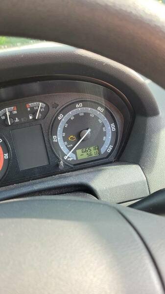

  • Broke down. P0171, running lean. It's been away since I cleared it. Thanks to @Breezy_Pete for delivering over the phone tech advice when I was having a meltdown in the Tesco car park in Carlisle. :D

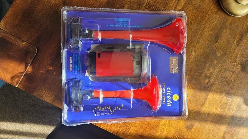

  • Horns, ****ing air horns.
20220902_101810.thumb.jpg.fecaefcff29b4d18f1c7b3890197ca90.jpg.4229ee193ec38db0bb692c9b1d453602.jpg
20220905_144551.thumb.jpg.a91248aa9f72a993ec0b8f9887df9599.jpg.5b7bfd9c51afb7a67237711276f0389a.jpg
(They're not actually musical)

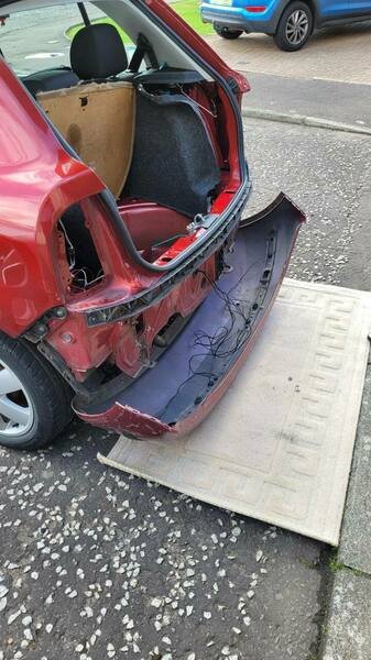

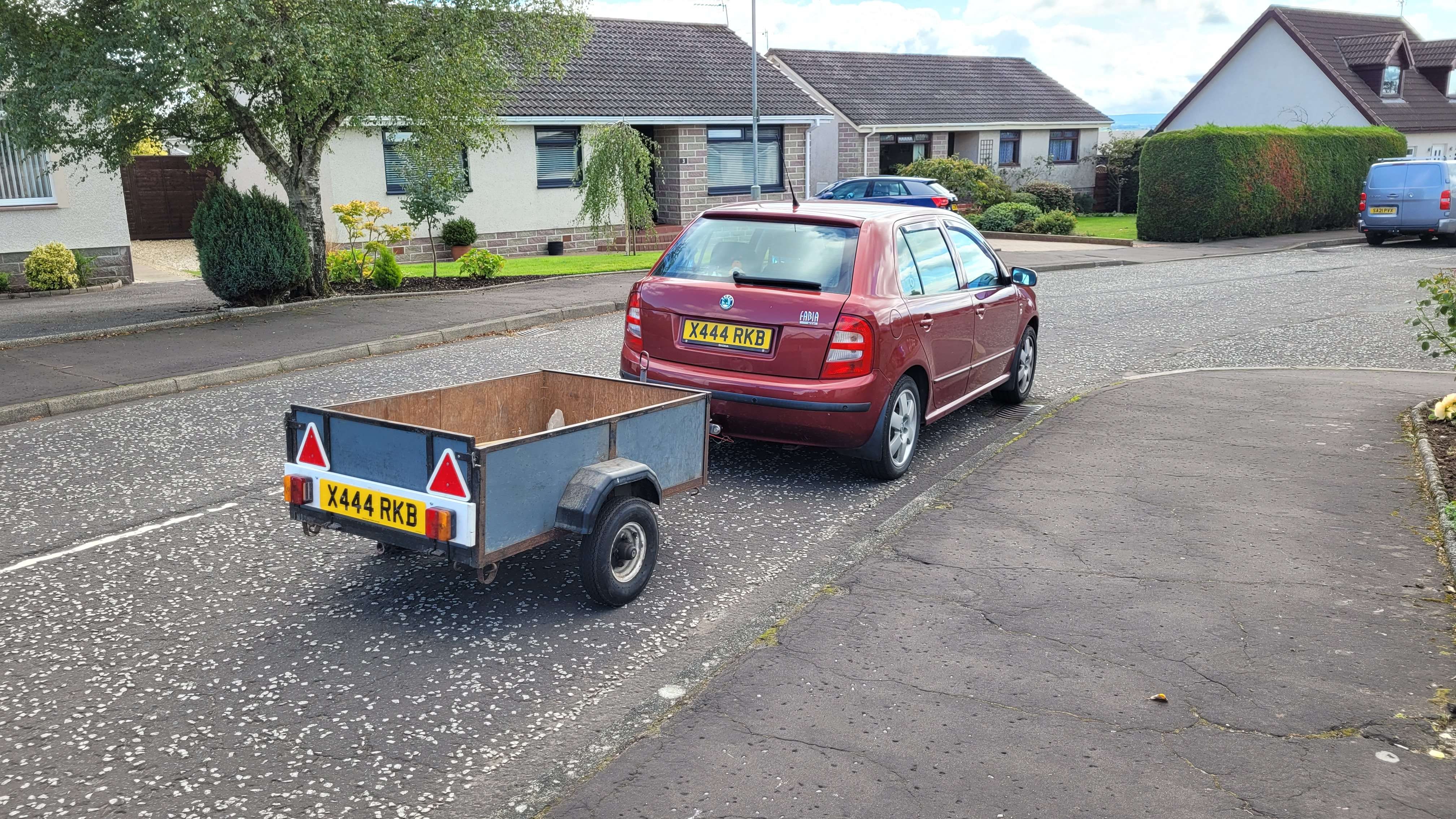

How did the towbar get wired in? Have you got the towing indicator light confirmation on the dash going?
Just tapped into the wiring loom for the taillights. Runs absolutely fine. :)
The what?!
  • Sponsor
Perfect. If you look in the owners manual you'll see there's a second warning light that should work when you have a tow connected, giving a visual confirmation that the trailer indicators are working (when they are).
Should be a dead easy VCDS recode of the onboard supply control unit to enable it. You just add 1 to the existing coding.
Cheers, Pete. May have to see to going about doing that at some point. :)
  • Sponsor
It's a requirement in theory, either an auditory or visual confirmation, so you can tell if one's failed.
In practice, I don't think they test towing electrics of the 7-pin variety at MOT IIRC.
Won't work if it's an LED lightboard btw, unless you add some resistors in parallel to make them look to the control unit like proper bulbs.
Edited by Breezy_Pete
I wasn't sure if the bulb would do like the rest and flash double-time when one goes duff.
It's not an LED lightboard, just a basic old school set up that my Grampa threw together in the 90s when him and my father built the trailer. :)
