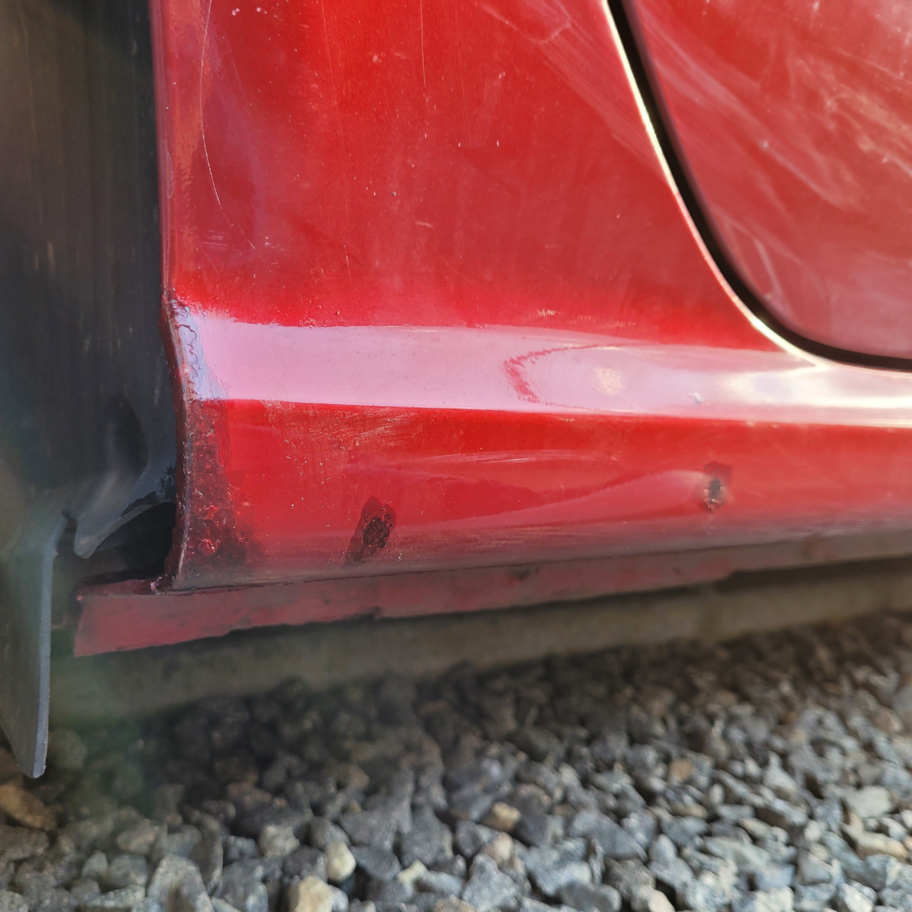

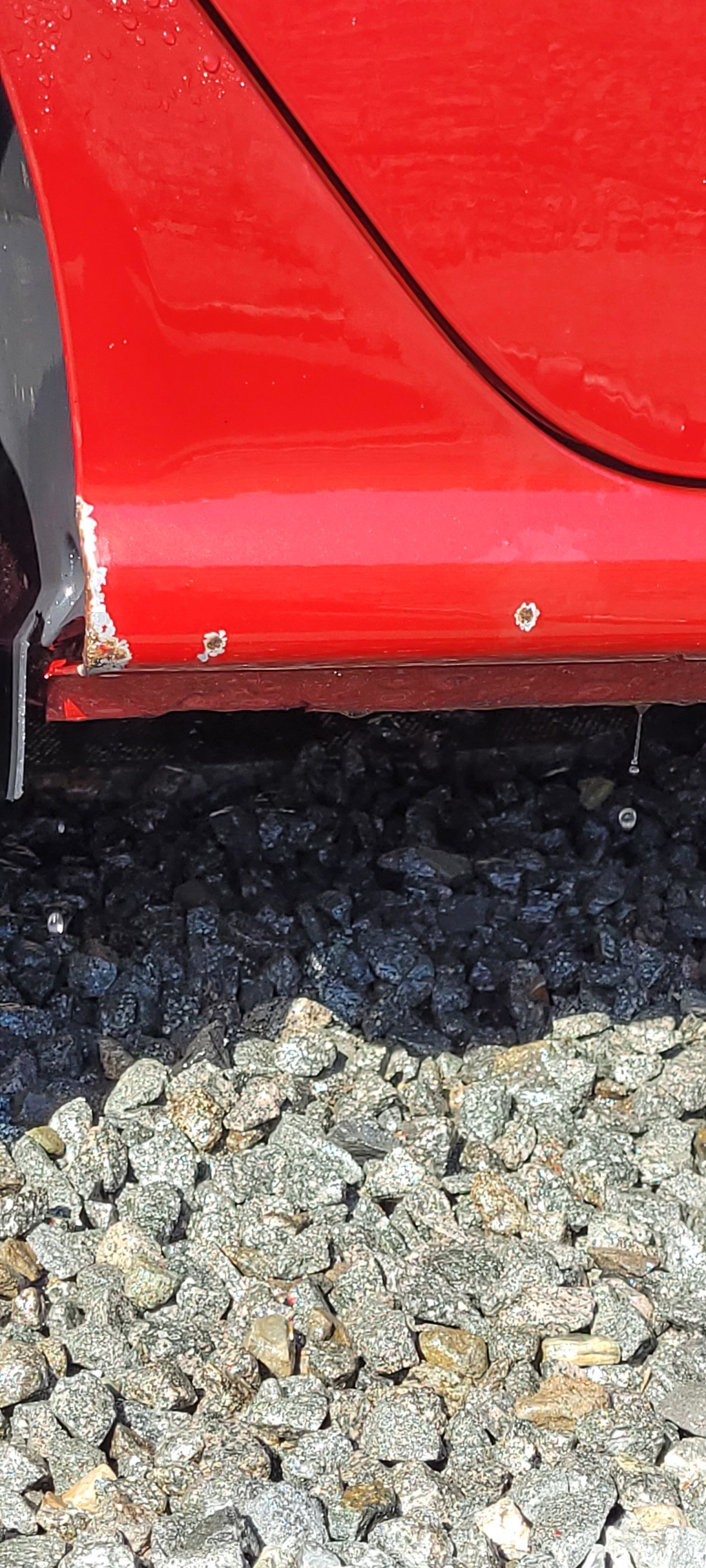

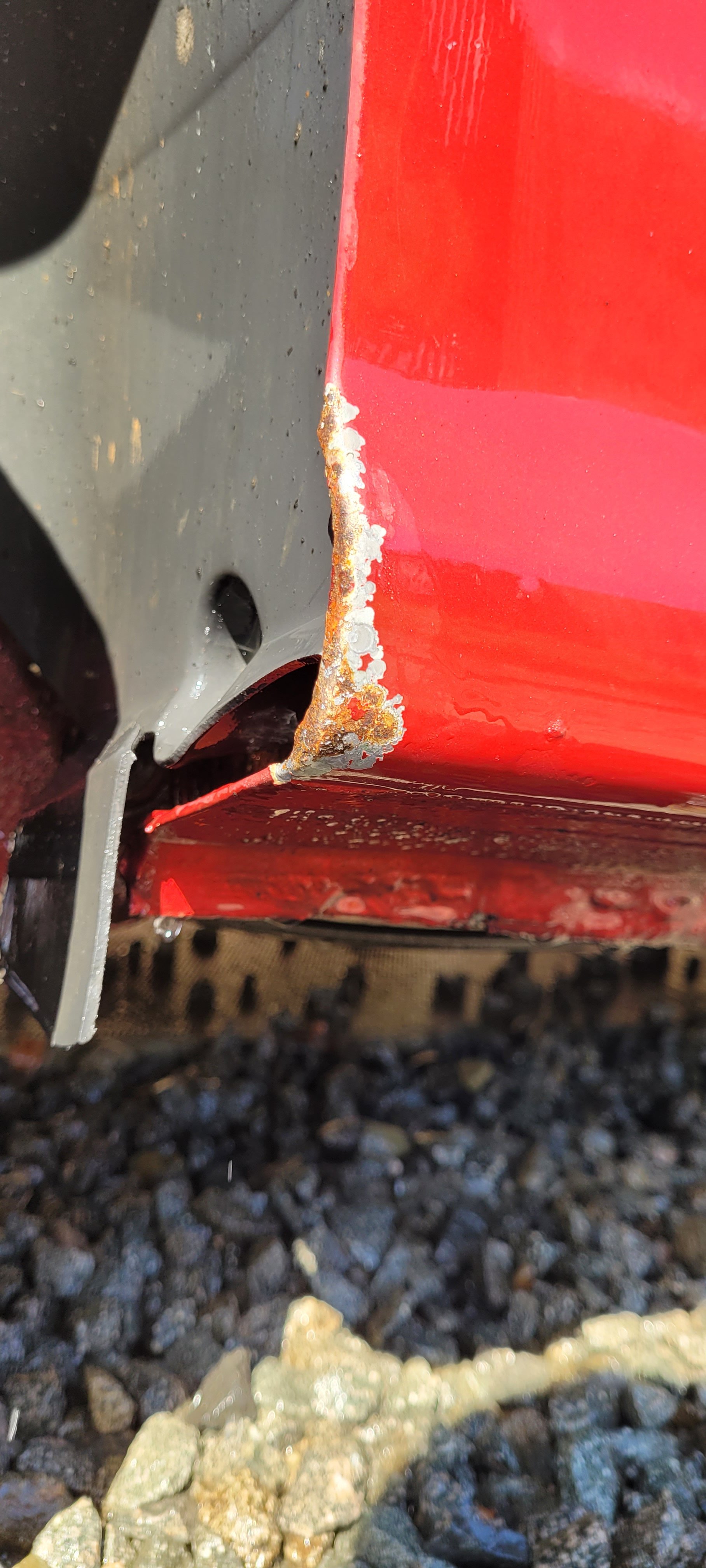

First on the list... rust... I was pressure washing the car, went to do the sill and all the paint came off at a million miles an hour. I was gutted at first.
I do see a benefit here as it allowed me to drown that area in Hammerite's Kurust and then slap a dollop of Flamenco Red touch-up pen paint on it. In terms of s***e paintwork, I've also developed another bout of lacquer peel under the other headlight. Again, could get it done properly, or I'll wait till the bumper is really bad then swap it for another one.
Aye, it's effing hideous, but it should keep that little bit at bay, or make me feel better about it. I've said that if it gets to 20 years old then I'll look at getting it sorted professionally since it'll be a "classic" by then, allegedly. That's quite a daunting thought... :whew: It definitely deserves a bit more love as I'd hate to see it turn into a right rotten banger, so more on that much, much later.

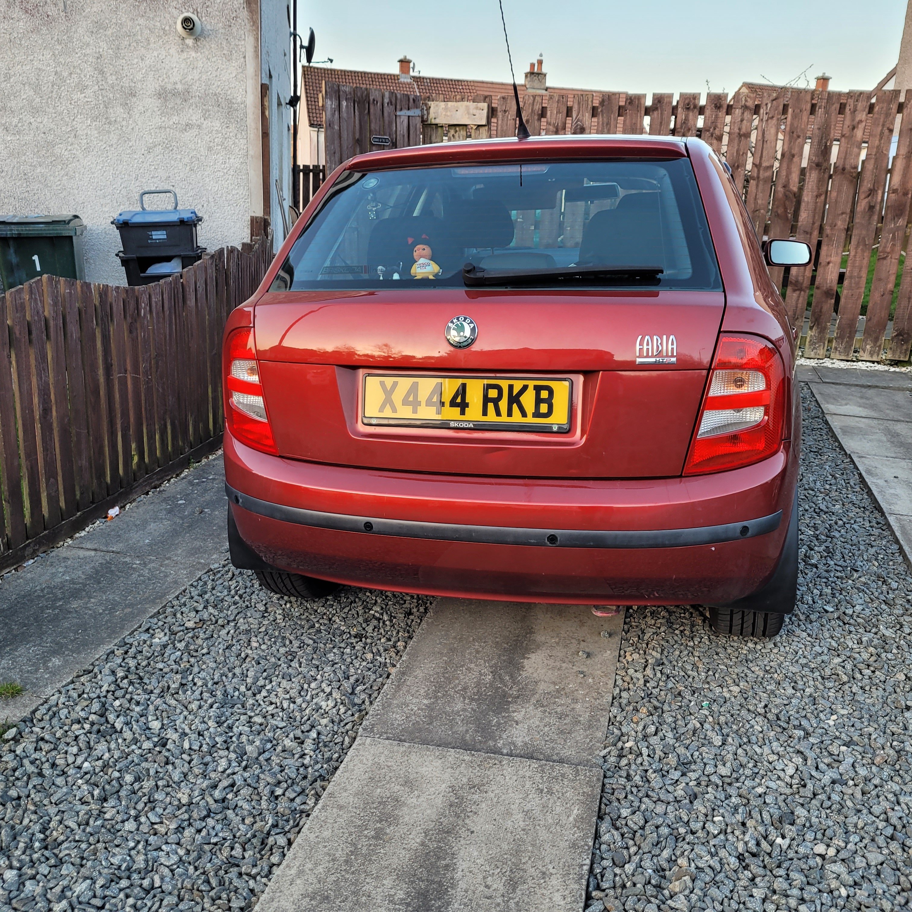

Finally, I'll bring this post to a close with another modification that I've completed, as what else could I be doing at 19:30 at night?! I've always preferred the pre-facelift rear lights for the Fabia and ever since one of my rear lights got a right nasty scratch then I thought it was worth my while to swap both lights for some pre-facelift lights in a decent condition. So I present to you all, the car as it is now, with the pre-facelift lights.

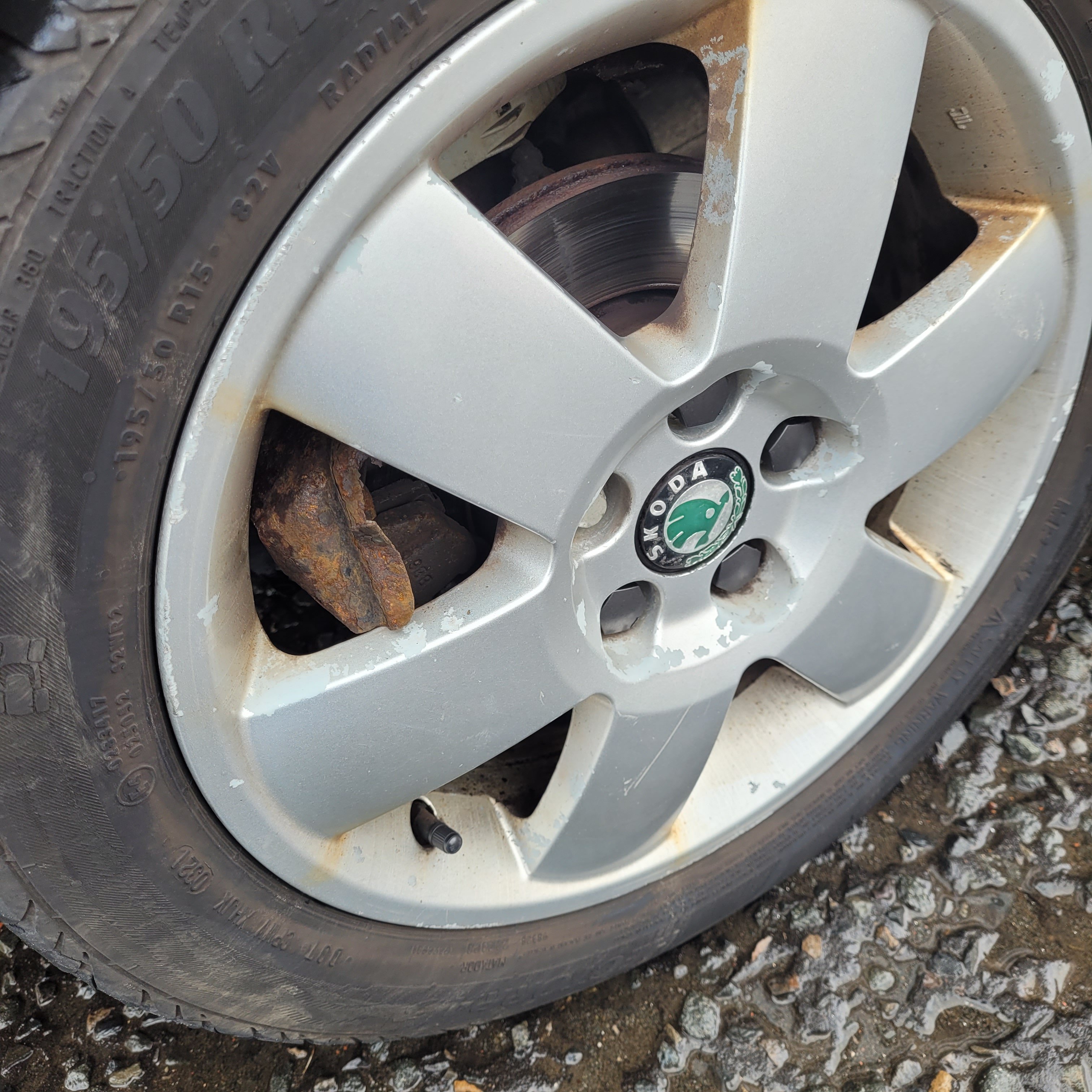

3 minutes ago, Pete_Ex-Wino said:
Is that the stoneguard come away completely and made its way there? Item 6?
floating caliper brake; brake caliper housing; bra... - Fabia(FAB) [EUROPA 2006 year] (7zap.com)
It is indeed. I heard a crunch and then a hell of a clatter as it bounced it's way off the alloy at 60mph. That photo and video was taken when I'd stopped.
I limped it round to the garage and it came free very easily when pulled slightly.
Edited by AnnoyingPentium
  • Sponsor
I bet!
The screws may be fun to remove, as at least one of them is quite hidden behind the drive flange/hub ISTR. Hard to get tools on.
The screw heads have typically corroded to unrecognisable shapes.
  • Sponsor
Maybe just leave it off rather than replace?  That way it's already fixed. :)
Oh true! Might whip the other one off as well to save this aggro another time over.
I knew they were in a bad way when I replaced the discs and pads last year but I wasn't expecting it to fall off. :D
I think it's damaged my alloy (on the inside, mind you) but it's the scabby one anyway which is getting whipped off soon since I've ordered a replacement online.
Lasted a long time that heatshield! The ones on my monte were hanging when they were changed. Atleast the damage isnt too bad!
Yep! Reckon it's been on there since new. It was a bit badger's arse when I changed the discs but that was still a shock. 😂

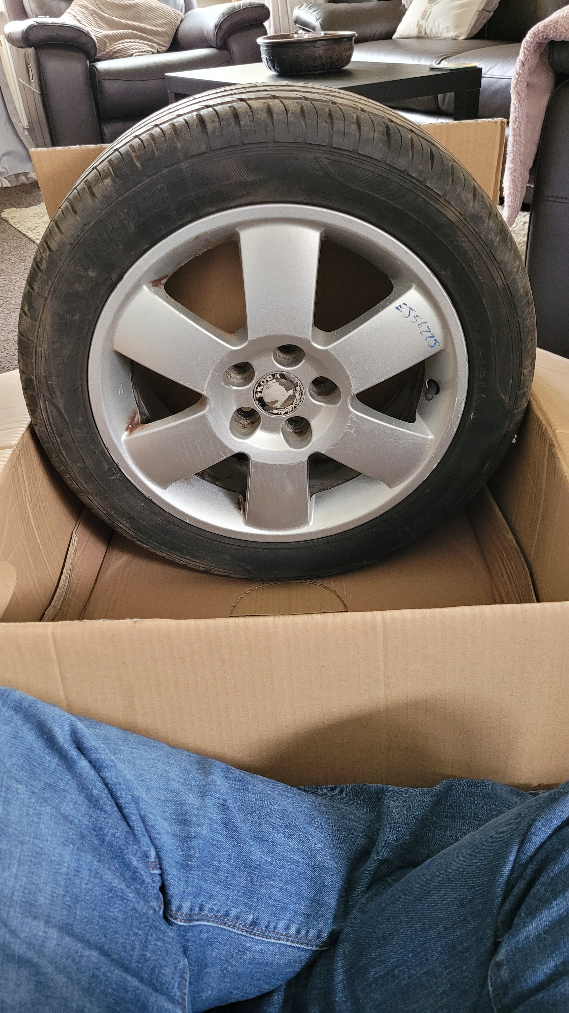

Front alloy was getting a bit scabby on the side of the now-missing heatshield, plus it's pretty wobbly, thinking it's buckled. But £50 later... plus this let's me have an alloy spare.

Oh yes. I've always preferred the older style lights so I swapped a pair on. Had to buy them separately though since I couldn't get a pair without spending more than I did separately. :)
Squeaky clean. :)

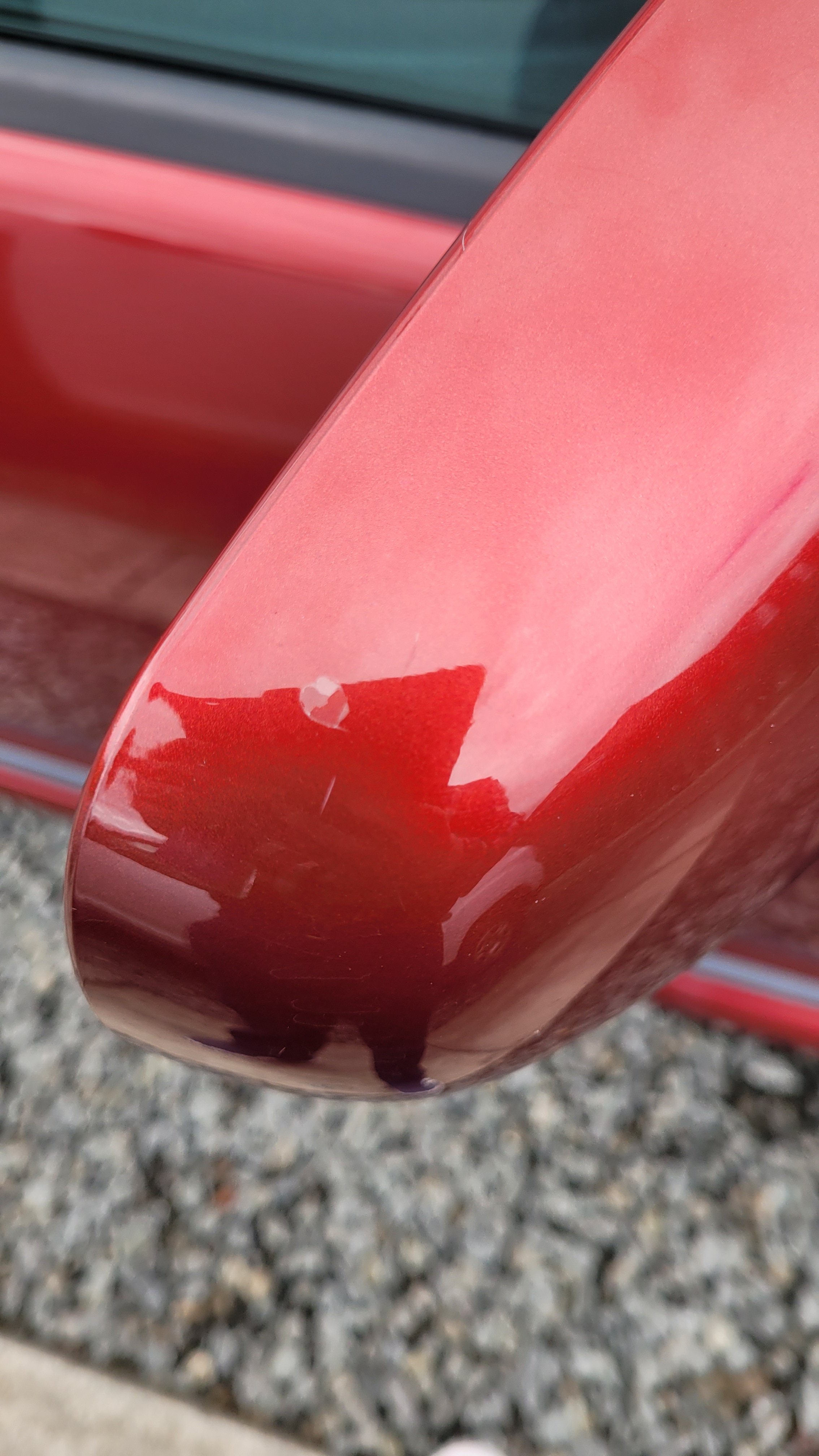

I have also had a little more lacquer peel appear on the mirror that didn't get repaired. I might give Sharpie a ring and see if he'd be willing to do the driver's side mirror, but I'll wait till its worse I reckon, to get my moneys worth. :D

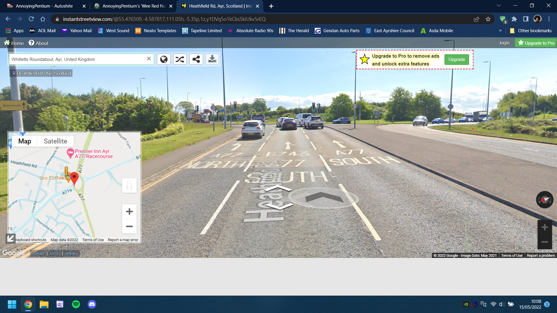

I still think it's a bit gutless compared to normal and it's still clinging onto the revs below 2k. Howandever, it doesn't become an inconvenience when caught at the lights at the Whitletts Roundabout where there's a hill start with anti-slip that is the deciding factor as to whether you'll get through the lights or not, and trying to accelerate with a switched off engine is quite a task, you know. :D

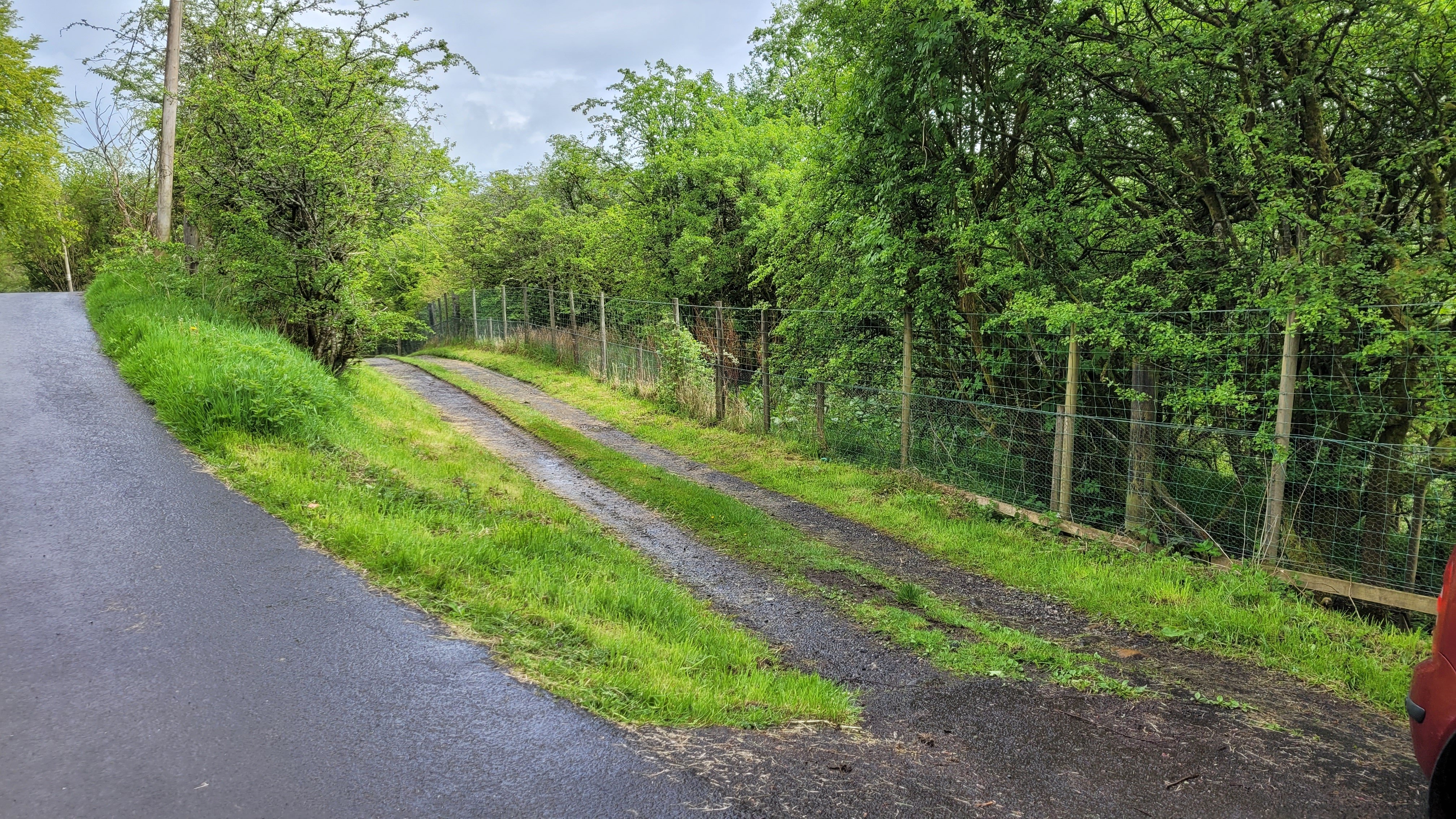

Also, it's story time on how my Fabia has now done more "off-roading" than most people with crossovers have. :D
Some lambs had escaped from a field along a farm road I was walking down, and the farmer (who I know) is based down the even smaller road in the first photograph...
It gets very bumpy further on but the car handled it great. Here it is afterwards as well, t'is a wee champ. :)
Can you not just press the ASR button and turn it off?
The car doesn't have ASR, that was an option IIRC. The road surface itself has that anti-slip/skid stuff on it. Just got some blank dash switches.
Basically, if you're coming out of Ayr past Arnold Clark Toyota and Peugeot then if you're not on this anti-skid stuff then you're not getting through the lights as they change very quickly.

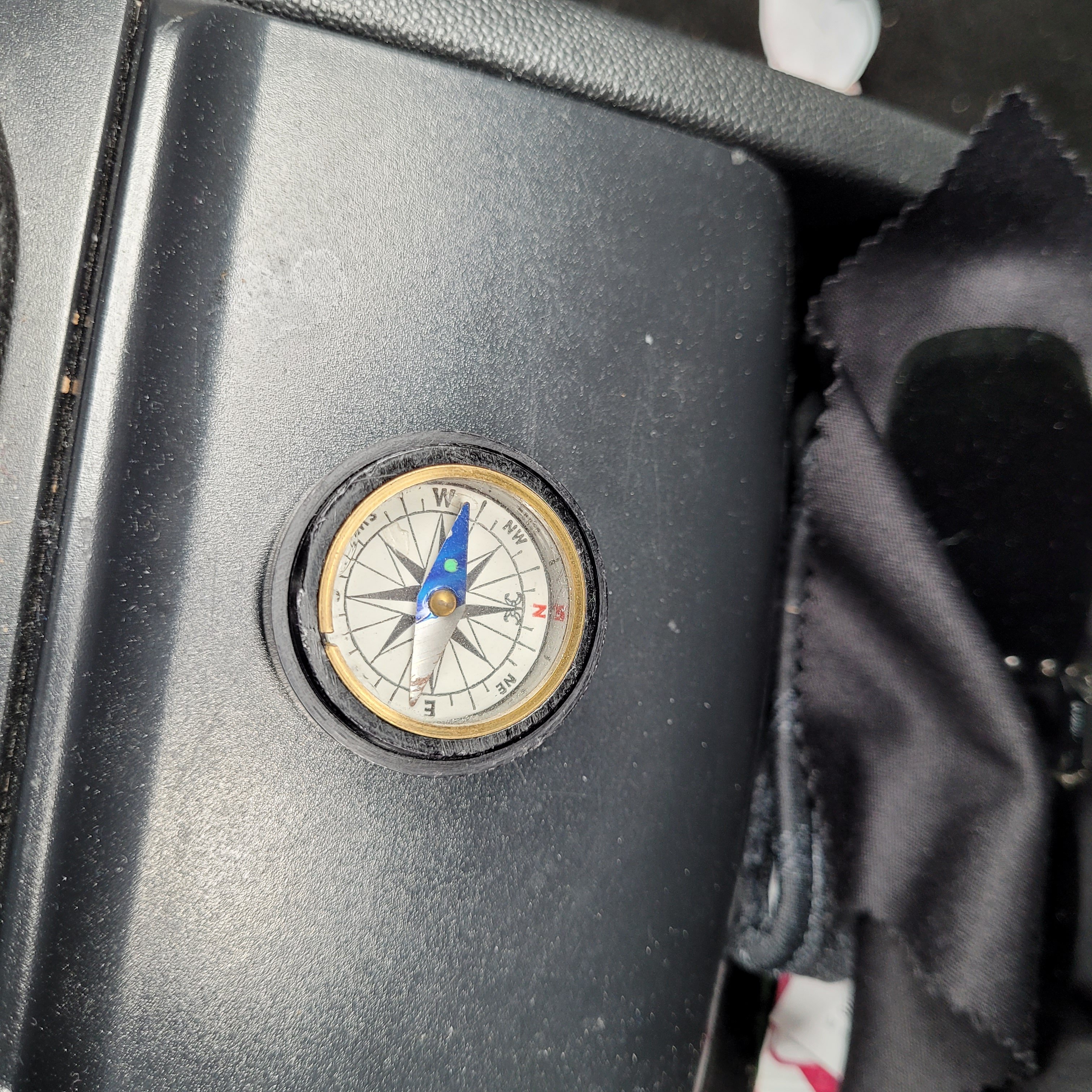

Fed up of having to update your car's navigation unit, or run out of signal? Behold, the solution to all your problems...
A Bakelite compass and a dod of blue-tack. :giggle:
You need to get onto JML with that idea. I can just see it now ''Introducing the new JML Wayfinder, works without that bothersome electricity!'' :D
