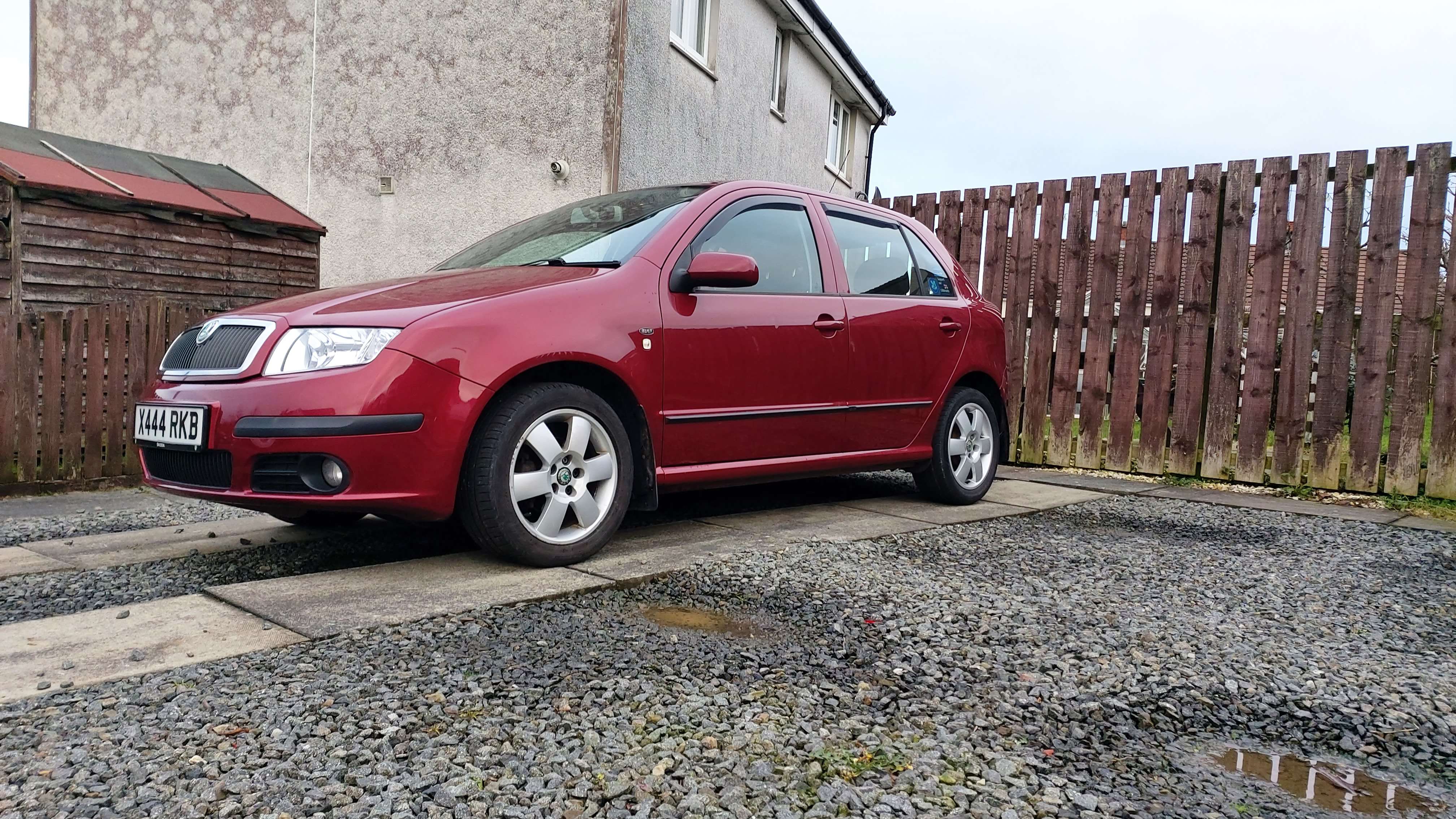

    Aaaaaaaand it's back. £131 later for a track rod and tracking. Now goes in a straight line, bonus.   Thank **** for that.

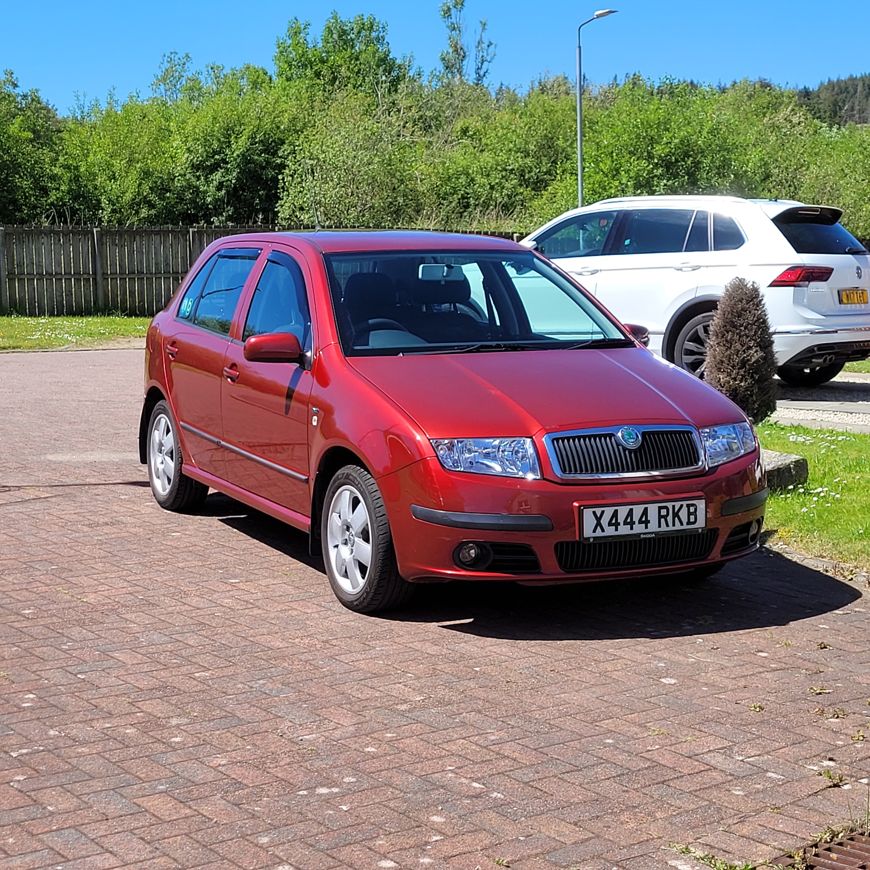

    Tidied the Fab up in prep for going away a few trips over the coming weeks. It's looking quite good for a nearly 17 year old car.           Oh, an

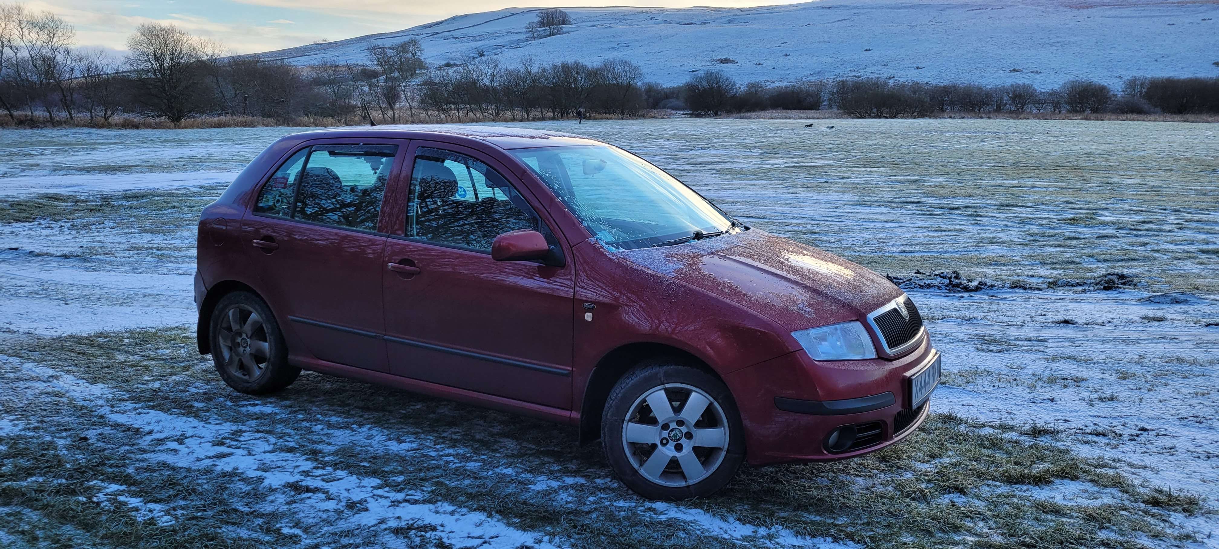

Nothing new to report really, just been plodding along. Now not far from 71,000 miles, which seems scary to me considering it was on 52,000 when I brought it home. Here it is, after a little fun in the snow, since I haven't really been out with it recently, mainly just staying in the village. For summer tyres, these aren't too bad, as long as you take it easy. As I said in the 'weather' thread, it's like a little mountain goat, as I drove it across this field which isn't smooth in the slightest... I'm just glad it isn't lowered. :D
Got some plans for this, going forward. It's a perfect car for the winter since it's light and grippy. As such, plan is to put winter tyres (or all-seasons) on it, set of halogen spotlights down beside the foglights but wired into the main beams, and treat any rust then cover it in underseal of some sort. I've got a stupid thing incoming, eventually, more on that in potentially a separate thread.

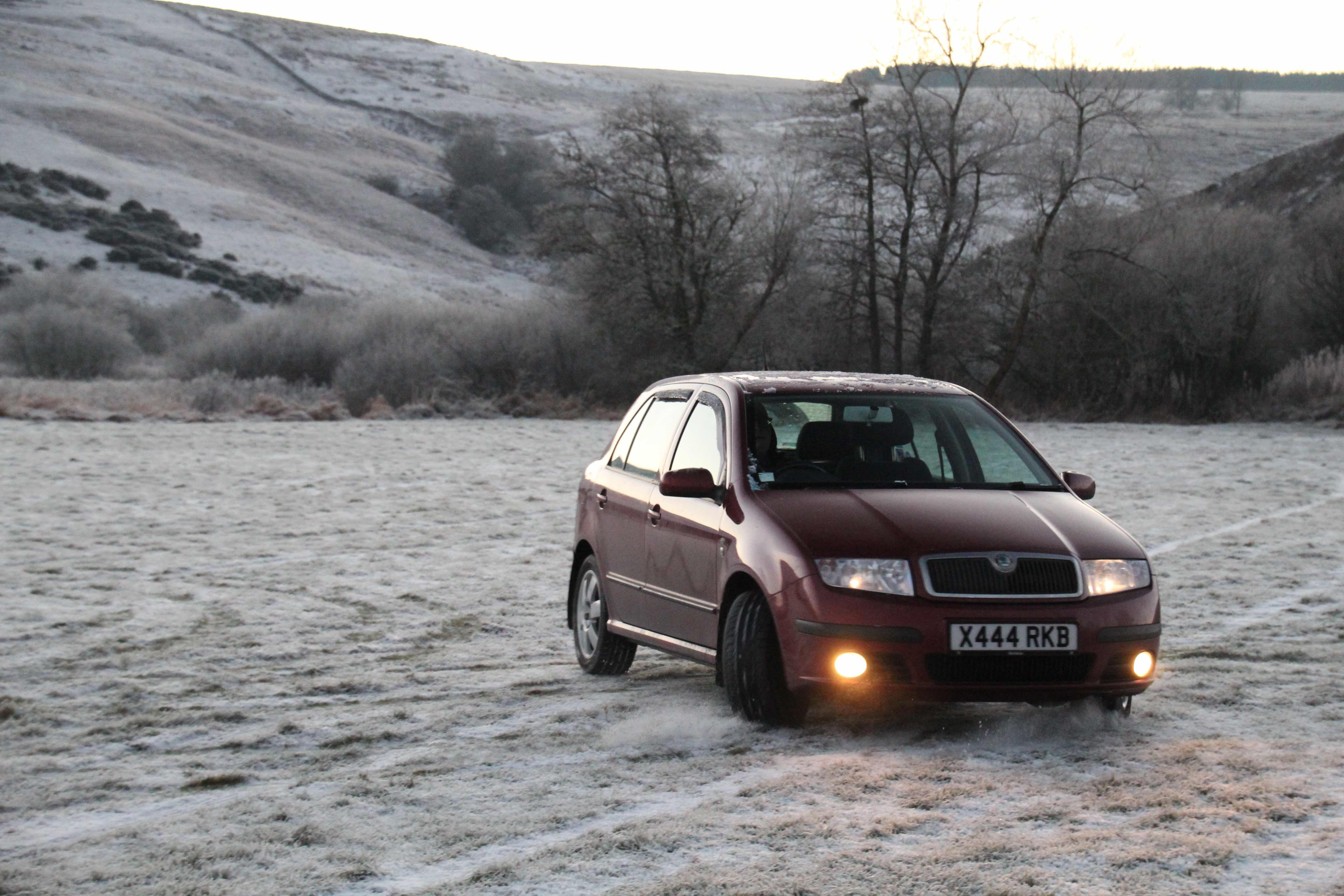

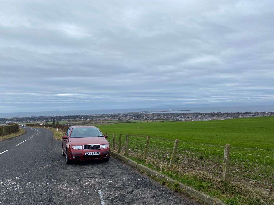

And, a wonderful photo taken by the co-pilot of today's adventures...

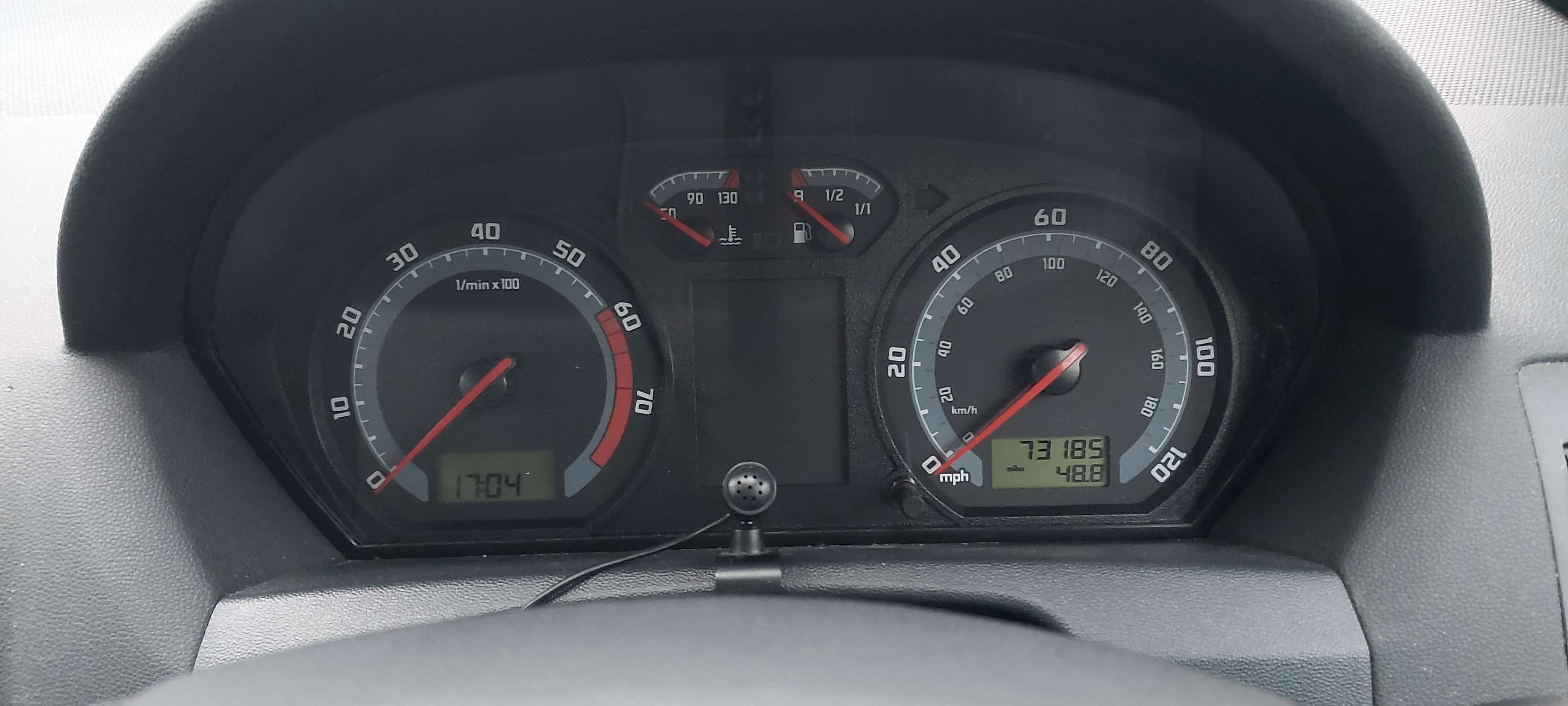

Went and visited the same lad who gave me the seats for the car, and we swapped some Fabia bits so I can sort some of the niggles my car has got. But also fitted these snazzy vRS needles... playing the fiddle while Rome is burning. Still need to adjust the one for the temp gauge as it sits just below the halfway point, but that's due to alignment when fitting them. I quite like it though, matches the paint. :D
Same with mine, which is bog stock; reads 88C all tank long once it's at temperature.
Aye I've seen them like that too. Mine did sit at 90C before, or an indicated 90 rather, but I reckon I can align the wee gauge better. Will require a bit of fettling later. MOT is the first order of business. :)

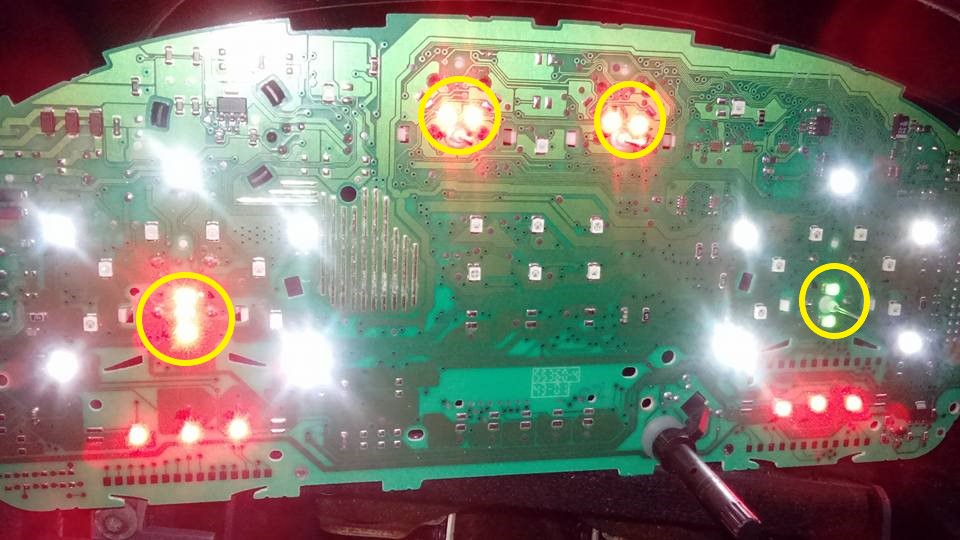

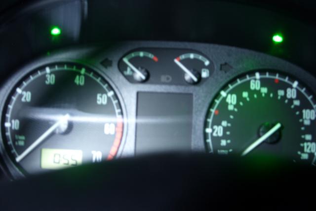

The only problem with swapping to red needles is that the two LEDs beneath each needle that illuminate them are green, but on the vRS they are red. The red needles might look a bit dull & an odd colour at night with the green LEDs on your car.
I made a right pig's ear of mine & knackered my circuit board tracks trying to change the tiny SMD LEDs and ended up going back to white needles and mounting a green LED in the cluster cowl above each needle, which, admittedly, works marvelously, much to my huge relief because without the SMDs working you can't see the needles at night if it's really dark.
Aye they look a wee bit dull but it's not too bad IMO. Ryan does the LED replacements at times, so I may ask him nicely. :biggrin:

I had trouble with the temp needle alignment too. What I eventually did was to temporarliy plug the cluster in without its cover & with the temp needle loosely pushed on.  I then got the engine up to normal temp and gently aligned the needle bang on 90 and pushed it in place. Been bang on ever since.
Aye that's what I'm thinking too, was trying to work it out in my head yesterday. Will give it a fettle over the coming days. :)

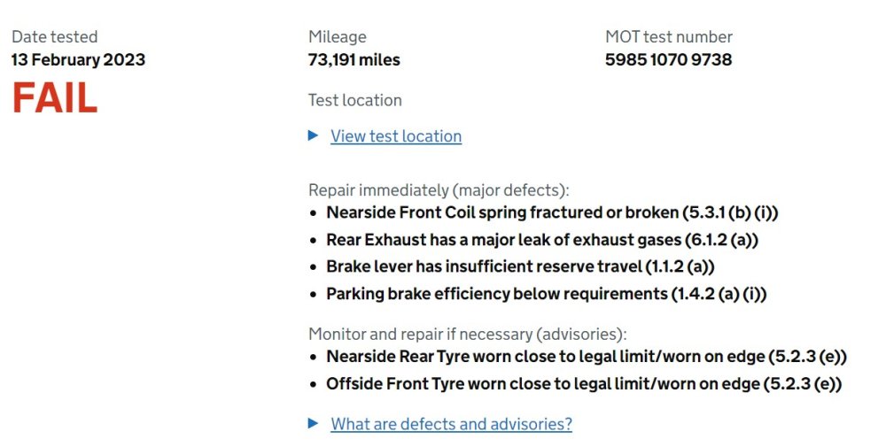

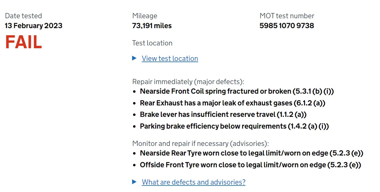

Not ideal, but not the worst.
No corrosion, so it's justifiable to put this one right. :)
oops - looks like new spring /  exhaust needed and a bit of adjustment on the handbrake cable to take up some slack?
Not ideal but could've been much worse!
