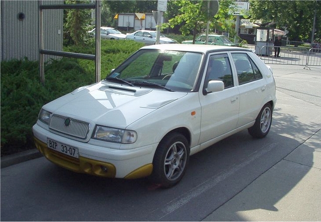

Many times i have seen in video or photos of modified Felicia a hood scoop, i like especially this kind:
Has everyone has the thought to install one in his Felicia?
Which are the advantages and disadvantages (pros and cons) of that style of hood scoop?
Installing that scoop the factory goes away or stays as additional?

  • In my opinion this hood scoop will not give you any advantage. It won't bring air to the engine to cool it, it will just bring air to the filter box which I find useless. In other words I think it is
  • Agreed.   Also @D.FYLAKTOS I strongly suspect that if you want a duct that far back on the bonnet to reduce underbonnet temperature, it would need to point the other way and extract air from
  • Please let me know what I have to do to get a pension from Greece because neither the French nor UK government will be doing so.   Re "knock yourself out" I used it in the sense of saying "
In my opinion this hood scoop will not give you any advantage. It won't bring air to the engine to cool it, it will just bring air to the filter box which I find useless. In other words I think it is made just to contribute to the look of the car.

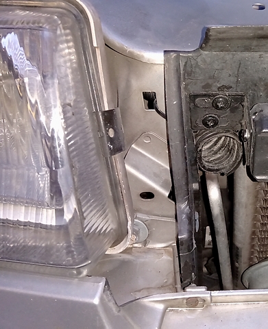

I thought that could be a way to do that for example with a small auxiliary fan.
From the left fog light there is already a pipe which droves air into filter box but still there is a gap between radiator and the frame
A pipe fits in there but while moving on a highway the air that passes from that hole is significant?
