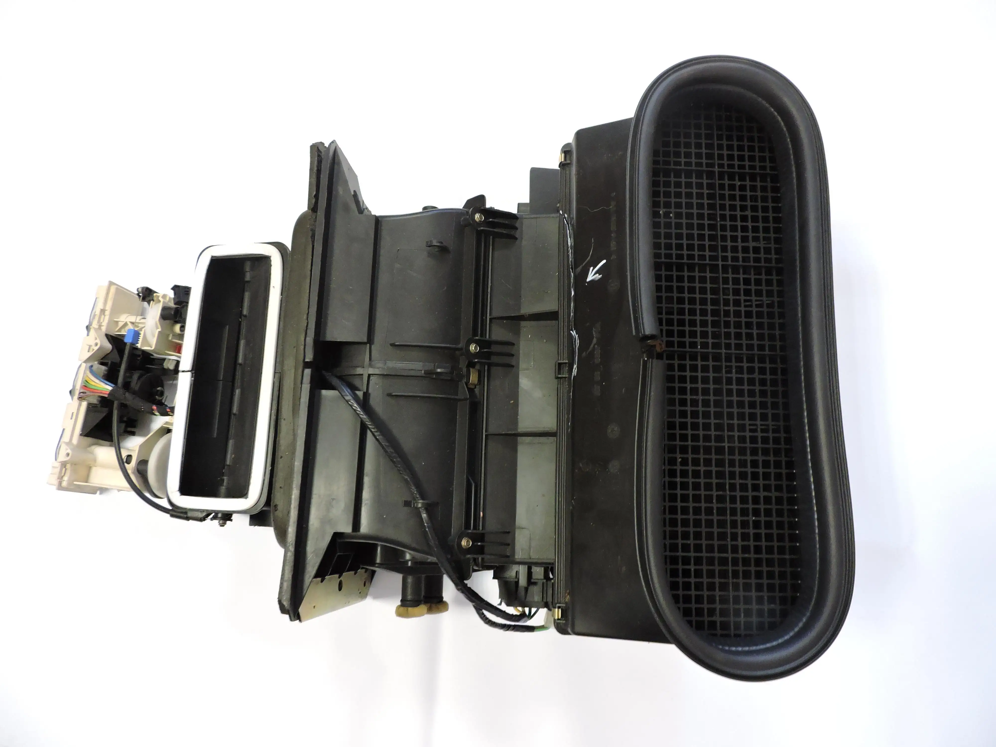

It is sealed with a door type seal
I don't know how good it does it but the metallic lip not only does not touches the sponge (no marks on it) but does not touch even the metal mesh that i put to stop leaves-bugs etc.
As you can see the mesh is untouchable.
Which means if there is a space between the hood and the seal (of the cabin filter) then dirty air comes through inside the cabin.
The seal should be on the heater box and seals against the bonnet around the lip.
It's not clear whether it's present on your car, from the photo you rovided.
I have post them in the past, here is mine:
I always wondering why the metallic lip (that brings the air inside) is much smaller that the size of the sponge.
If i make it wider wouldn't be good or this will change the pressure of the incoming air? The blower inside would be ''happy'' with more quantity of air?

Yesterday i made a ''sealing'' test, i put a piece of cardboard standing upright and i closed the hood, here is what happened.
It didn't went all the way down, a part of it protrudes upwards so i done another one test, i lay down the piece of cardboard
and i closed the hood, the result must be one: the rubber seal reaches the oval area of the hood
sealing everything and the cardboard must be crumpled up.
Theoretically Yes but here is the result, the cardboard is untouched !
As i expected by instinct, there is a gap between the hood and the rubber seal (no crash accident, the hood is the original) and dirty air from the engine bay passes to the sponge filter and then inside the cabin.
I thought you had already checked this and knew there was a gap hence the suggestions of changing or further sealing.
But you can se quite clearly that the seal was doing its job, as evidenced by its outline on the bonnet.
So either the heater box somehow shifted downwards or the seal got squished and you need a new seal. Or maybe pull it upwards a bit, if there's a space.
For sure, the marks show contact but the latest years things changed.
If i can i will lift the seal and make it more soft with products for this cause or apply a thin layer of rubber foam at the oval marks of the hood to make the contact with the seal more efficient.
I don't think that i can find a new seal.
You might find a seal with a better profile for your current installation, have a look at places that do seals, I'd have a quick look at "classic" car trim suppliers, car builders' suppliers sites, kit-car builders' sites, custom/modified suppliers sites, eBay seal suppliers, for whatever profile you think will suit your needs.
Surely it can only be that the bonnet is now higher, or the heater box lower or the seal has squished but as I put earlier it is what it is so if nothing else is wrong then a seal that fits the current situation should resolve the issue.
