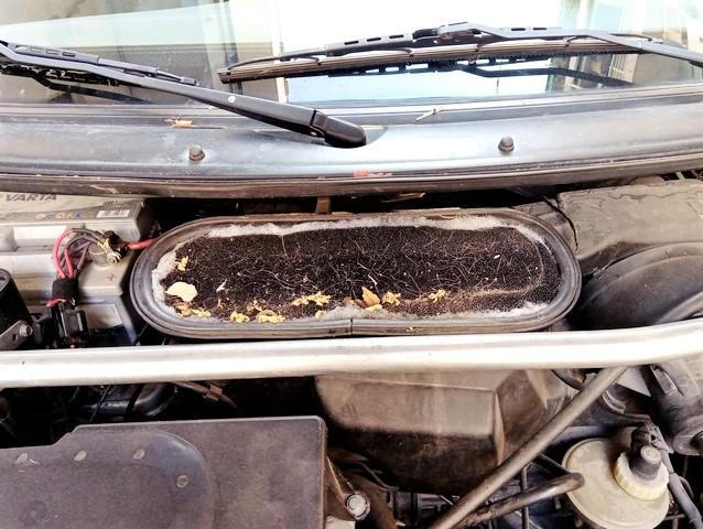

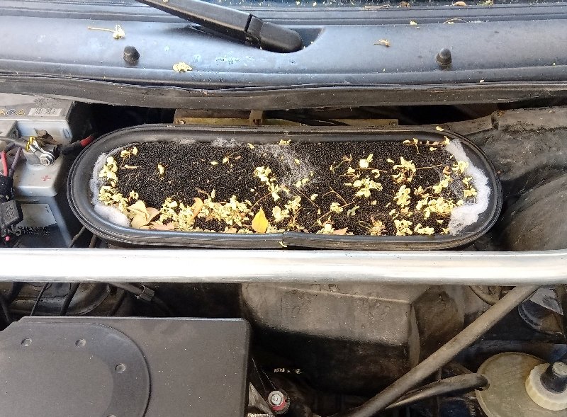

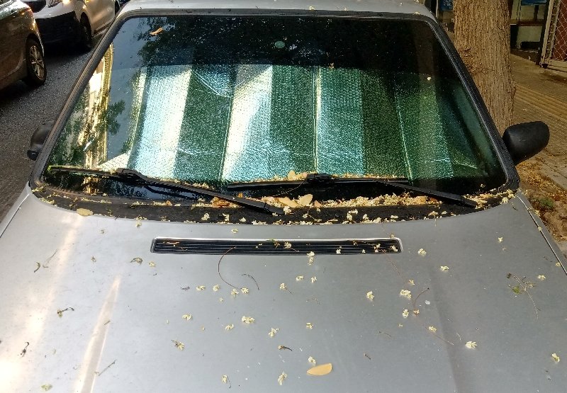

Here is another example of why i want a small hood scoop in my car.
Every few weeks the sponge filter is full or leafs, small branshes, dog bristles etc that pass easily from thet black grill on the hood.
What are you fitting, a scoop with a grill and a filter behind?

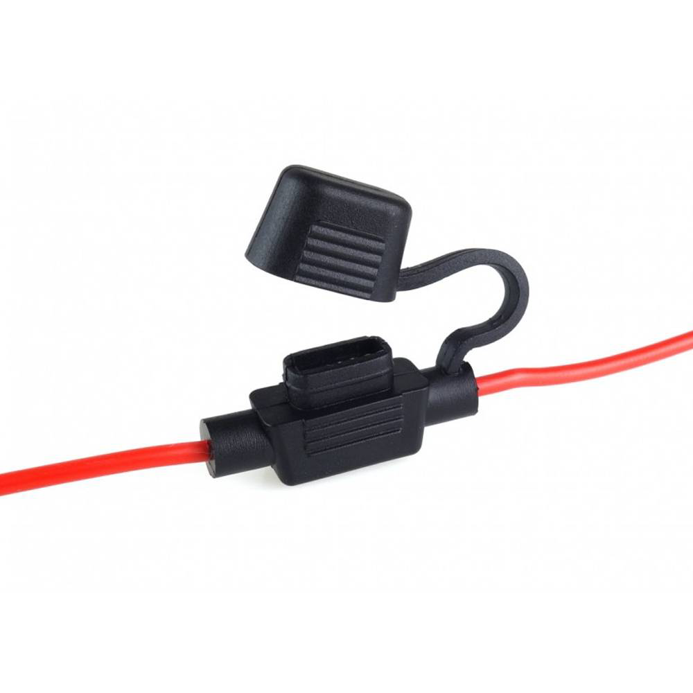

wrong cable routing btw
18 minutes ago, Thefeliciahacker said:
JESUS, it looks hideous
Are the cables for extra Led lights with their own waterproof fuse holder.

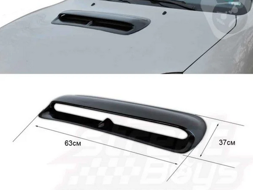

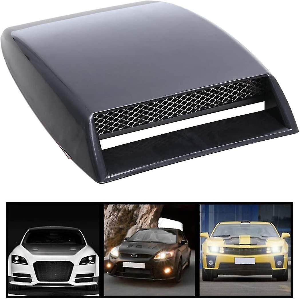

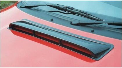

Take a look at this today:
I think that the solution is something like this:
But it's too big in 37cm, the factory grill is 6 cm height.
Edited by D.FYLAKTOS
  • 4 months later...

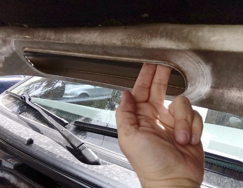

I wonder why they do the dimensions so different?
It's supposed to be for Felicia.
12,5 cm Height - 15 cm Depth x 66 cm Length
In the hood the dimensions of the factory grille are 66 cm and 5 cm, what's the reason to be 12,5 height? The depth also is huge, why 15?

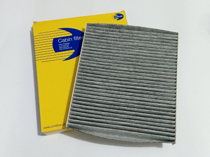

I bought a activated carbon cabin filter from Comline (UK product)
to replace the factory sponge filter that i have.
My main problem is that in case of getting wet takes long time to get dry and i have bad smell inside the cabin plus the windshield gets foggy.
For sure that solution isn't like a factory cabin filter that other cars have but it's better than the one that i have although some drivers here have have removed the sponge completely and have it ''free''.
This is unacceptable for me because i have issues here with tree leaves, dog-cat bristles etc as i have shown in previous pictures.

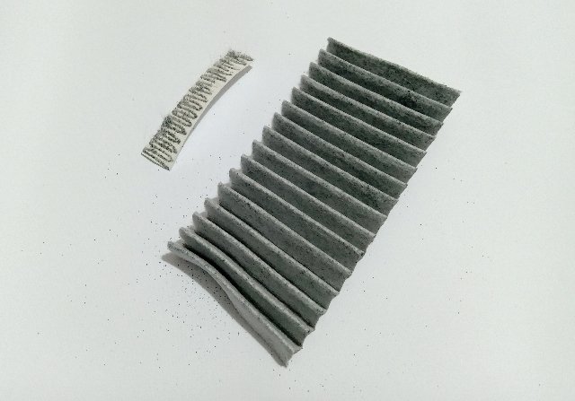

I took that activated carbon cabin filter and disassembled it, measure and cut it.
creating a ''sheet'' which i put it via adhesive tape beneath the factory hood oval shape hole thus ''filtering'' the incoming air before goes to the cabin.
For sure this patent can not compared with a factory cabin filter but it's better than nothing and far better than the sponge-solution that i had.
A new company to me so just had a quick look, their HQ is the next county to me Bedford(shire). Their site marketing blurb has me a little itchy - "Not a budget brand but a value brand." - "As a genuine alternative to higher-priced OE brands,".
But as they only distribute the filters and other(s) manufacture them they may well be as good as others. - "Comline has forged links with some of the world’s foremost filter production facilities."
A quick look at their catalogue and their products seem like they could be good. - https://www.comline.uk.com/
The owners look like they would know others in the UK car parts and consumables businesses and they also hold another formerly well known old established company name/brand of MOTAQUIP whose product (distributor cap) I believe I might have used in the last 10 years and it was good IIRC. - https://motaquip.com/about-version-2/
Edited by nta16
spelling
For 15 euro per unit i can make at least 8 "sheets" so this filter will last 4 years if i use 2 of them per year.

I put a piece of electrical tape (upside down) to see if i close the hood then the activated carbon cabin filter will contact firmly with the oval shape rubber seal?
The yellow mark shows the exactly point that i put that tape, i close the hood and
yes, the tape stuck to the sheet so no gap, things are OK. 👍
