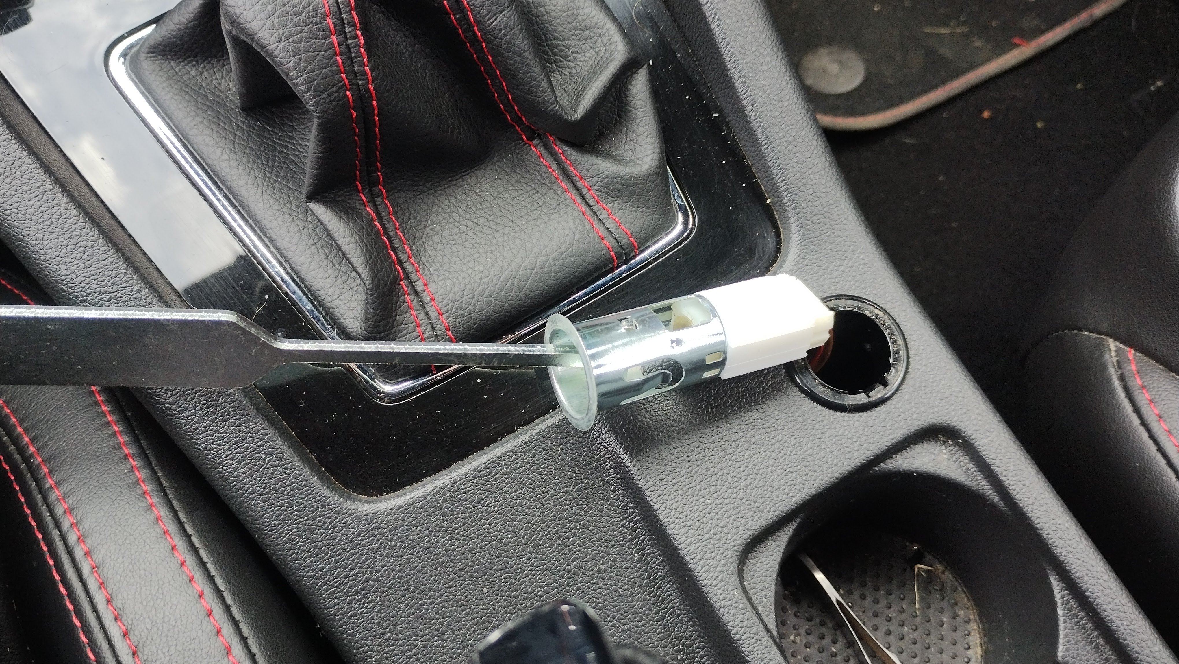

Just wanted to add my thanks to the OP for this guide, fitted mine yesterday using the complete kit ordered from Aliexpress. I did have one failed attempt a week or so ago where I just could not get the 12v socket out, I ended up ordering one of these T-bar removal tools (https://www.ebay.co.uk/itm/404734386802), which worked a treat, though did still require an uncomfortable amount of force to remove.
Couldn't be bothered to remove the glove box to get to the fuse panel so just disconnected the battery -ve to do the job.
Thanks to the OP and those who've contributed pics. This is a great guide. Just did this with the aliexpress kit in about half an hour on my pre-facelidt Mk3. Just ahead of a holiday to France so the kids will be delighted!
As most have commented, the hardest part is removing the cigarette lighter. Couldn't source the tool easily or cheaply so managed it with a couple of phase test screwdrivers.

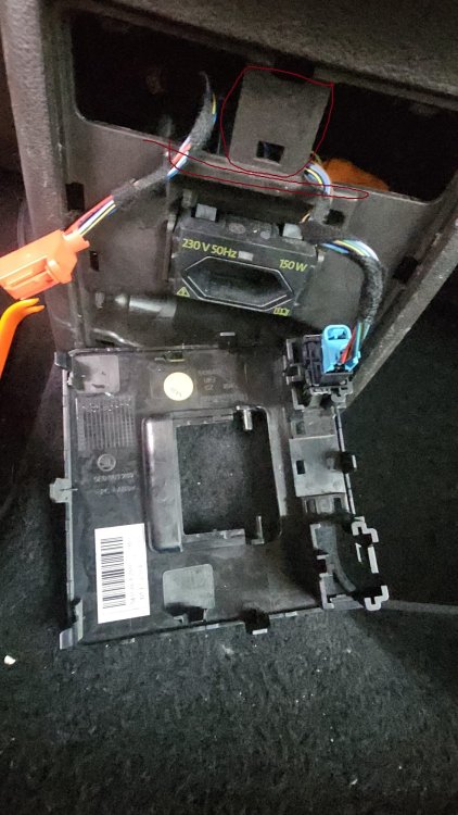

Well... I failed miserably. But it's my fault because I bought the wrong kit for my car.
This is the one I bought https://a.aliexpress.com/_mKH4bQL ... could someone help me out figuring what parts I need to buy to use this plugs? I alreadyd did the hard part of wiring the cables.
Cheers!

Well I fitted this over the weekend and what a faf it was without the 12v socket removal tool . The whole install is very easy once the 12v socket is out.
