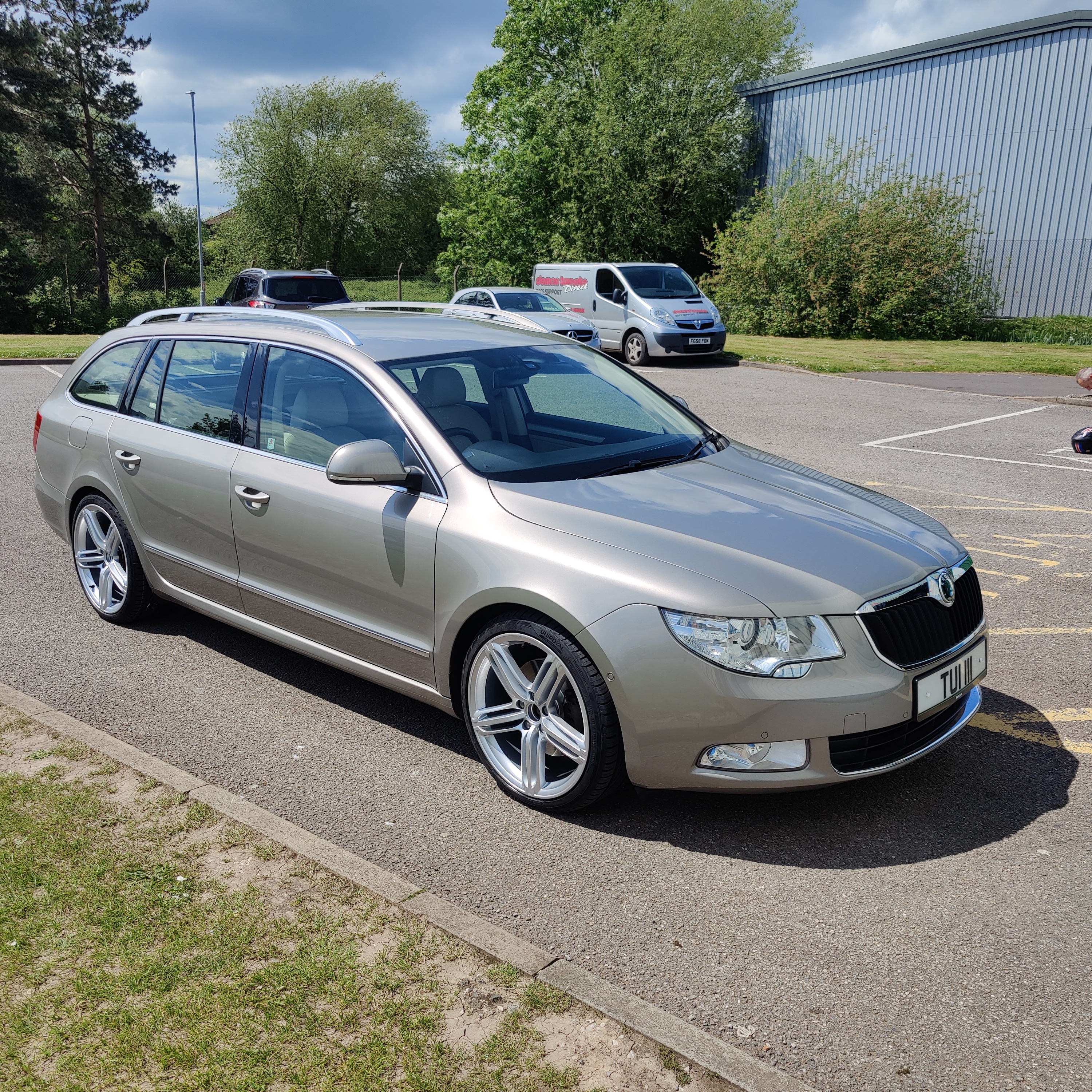

Ok Guys, here is the finished thing - Genuine Audi Alloys, 8.5j x 19" with an ET48. Tyres are Uniroyal Rainsport 5 at 235/35/19 91Y XL, and the car has been lowered 35mm all round using the Bilstein B14 Coilover kit. All fitted by Demon Tweeks, who said that the fronts were very tight, but clear everything and are safe, and the rears had to have 5mm spacers and longer bolts. A 4 wheel alignment finished a 4hr job off. The ride is firmer, with none of the previous wallow, the car is smooth, planted and precise, the ride is no where near as hard as my Golf GTi. I'm delighted. I just need some centre caps!
I would avoid using wheel spacers that aren't hub centric, and you can't get hub centric wheel spacers that are less than 10mm. So the 5mm wheel spacers aren't hub centric.
Hub centric wheel spacers have a spigot to centre the wheels exactly on the hubs. By using wheel spacers that aren't hub centric you risk the wheel not being exactly centred on the hub, which will cause vibration.
Maybe consider 10mm hub centric wheel spacers front and rear. This will have the effect of changing the rim offset from the current ET48 to ET38.
I would want my wheel bolts to have between 6 and 10 turns. If it's more or less than this, look at buying longer or shorter wheel bolts. They are usually available in 5mm increments, such as lengths of 25mm, 30mm, 35mm, etc.
Eibach Pair of 10mm Pro-Spacer Wheel Spacers
https://www.demon-tweeks.com/eibach-pair-of-10mm-pro-spacer-wheel-spacers-kit-eibes90-2-10-027/?istCompanyId=a2904180-3a7d-4e56-b876-cf81c9512180&istFeedId=0f6db192-3a9a-4369-b1f8-79615c622f96&istItemId=wptpwmmll&istBid=t&awaid=6538&utm_source=redbrain&utm_medium=shopping&utm_campaign=css&gclid=EAIaIQobChMIsNnCndOB8QIVsuHmCh1TGwcYEAYYBCABEgK2pPD_BwE
Edited by Carlston
Thanks, we spoke about these whilst we there, the technician showed us the hubcentric spacers fitted to the front and rear but the wheel poked out too far from the arches and it looked ridiculous so we didn't fit them, the technician wasn't comfortable sending the car out with them fitted. 5mm spacers are absolutely the maximum I'd want to go and only on the rear. These rims are really on the absolute ragged edge of fitting whilst still looking factory.  I'm confident that the current set up is best and that the Garage knows which set up is right.
