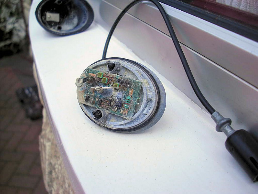

Inside the original Fabia aerial is a small printed circuit with various components to amplify the signal.The power for this amplifier is supplied from the radio up the same inner cable that carries the signal from the amplifier to the radio. The voltage is not measurable,but can be seen on a oscilloscope as a trace. My car  is also 20 years old.  When faulty the radio  becomes less sensitive to find stations,and a lot of noise when the engine is running. Moisture gets onto the printed circuit shorting out the signal etc.I estimate I have changed the aerial base 5 times !. My setup is an original fabia radio,and original cable and aerial. If you have a booster fitted  and different radio  your  problems are not the same. A booster has a 12 volt +ve supply normally on a blue cable. I am not sure if you are using the original Fabia aerial or not? Be careful buying replacement aerial bases,some do not have an amplifier fitted.I have attached a photo of the inside a faulty aerial base showing corrosion.Hope this helps you
