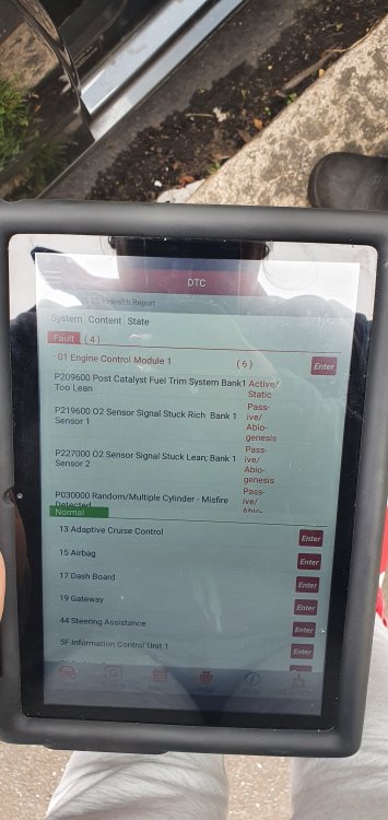

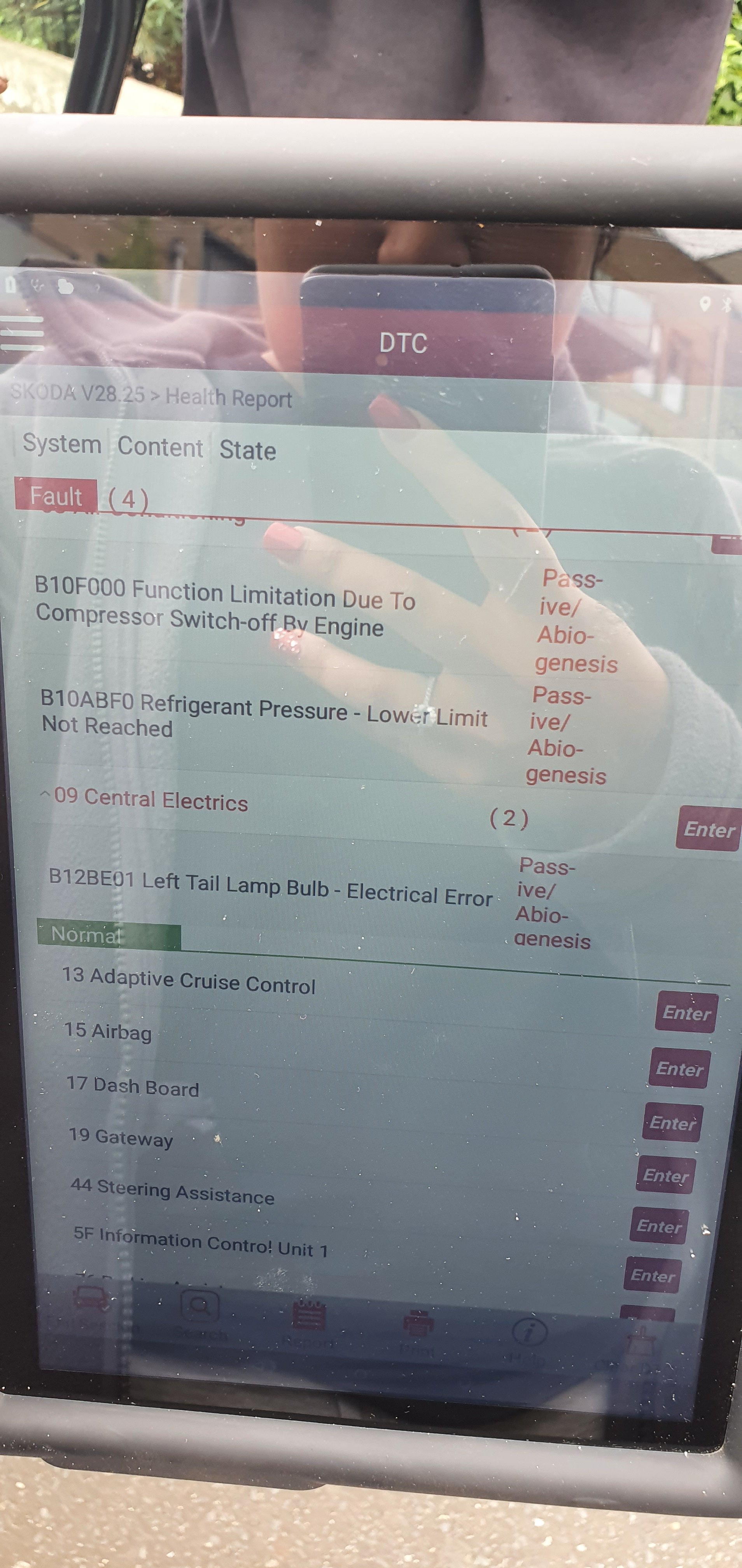

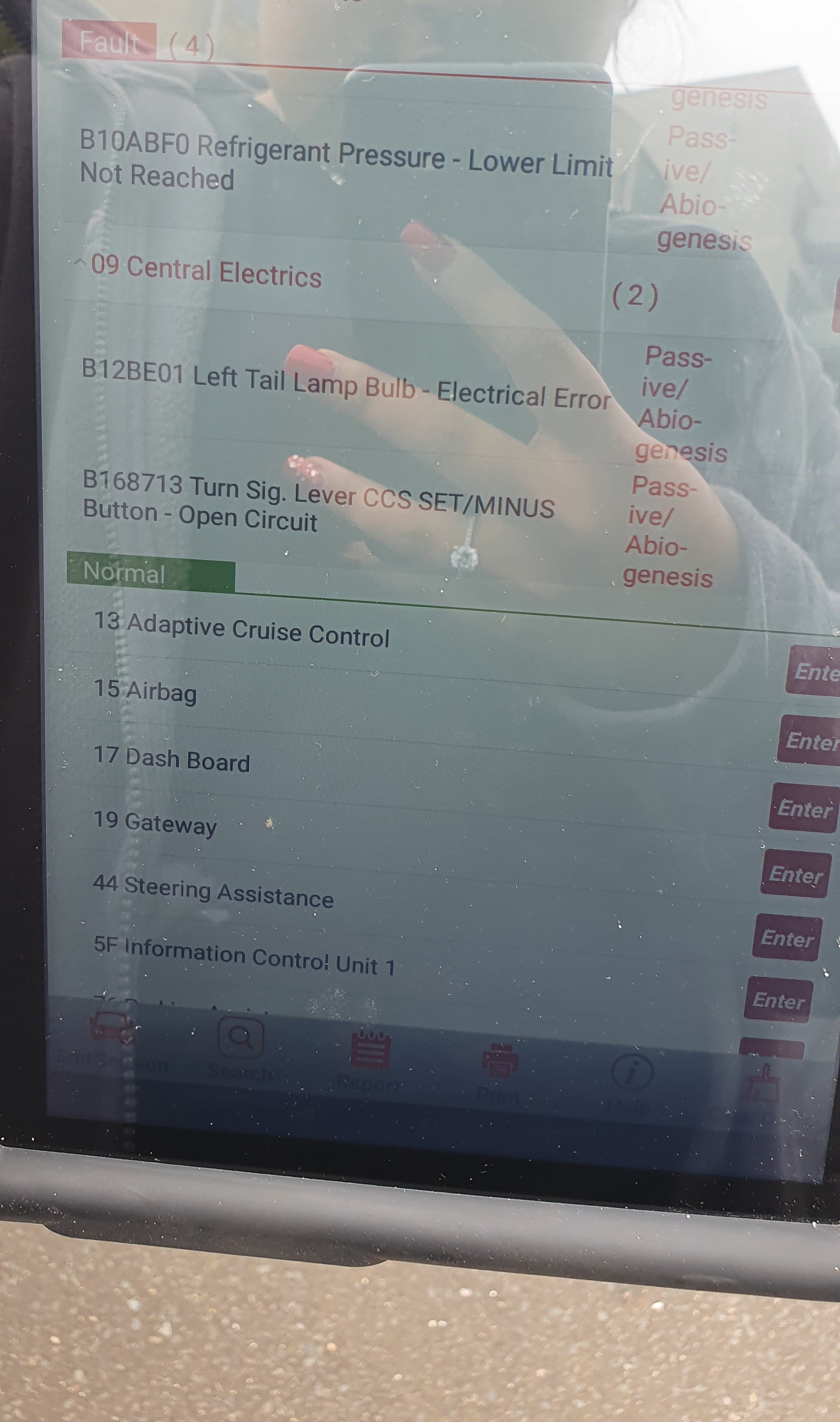

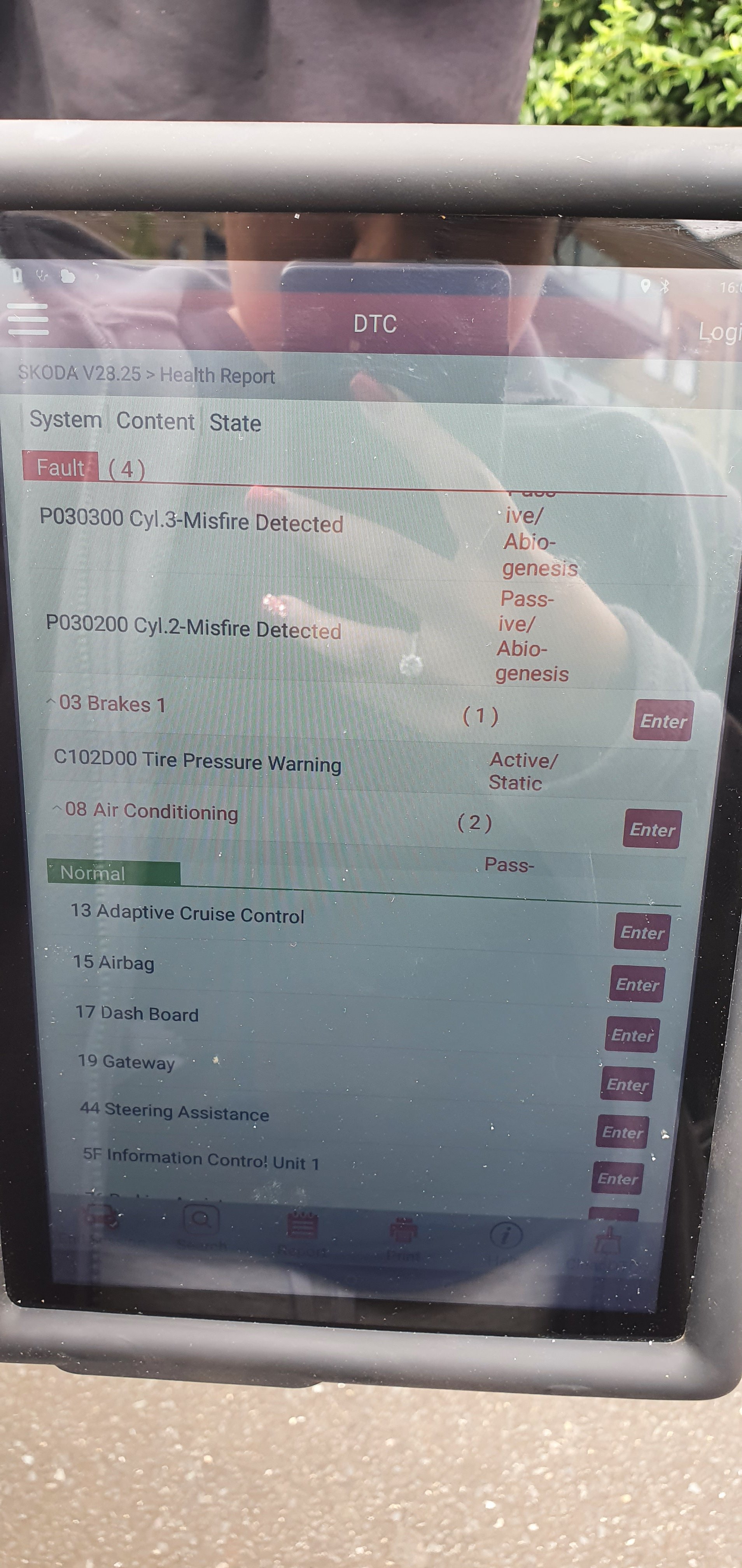

Hi everyone,
I have 2016 skoda fabia which has had everything go wrong with it recently. The engine light came on, it keeps thinking my tail light isn't working, needs new tyres all around, and the catalytic converter failed at the last mot at 1 garage. And the scroll wheel on the right side of the steering doesn't work.
It's only done 42k miles 😑 and had regular services and everything.
I had a friend of mine use his obd2 reader to show me the codes but I don't know what they mean. Can you guys explain to me what the problems are and how much they'll cost to fix? And are they even worth fixing?
Thanks in advance 😊

Fully charge the car battery with smart charger, connecting it up the correct way.
Clear all the fault codes then drive the car and see what happens.
Thanks, AG Falco
All the catalyst/"O2 sensor" faults could be down to one of the 2 lambda sensors being faulty. A competent mechanic can find which one in 5 minutes with a multimeter.

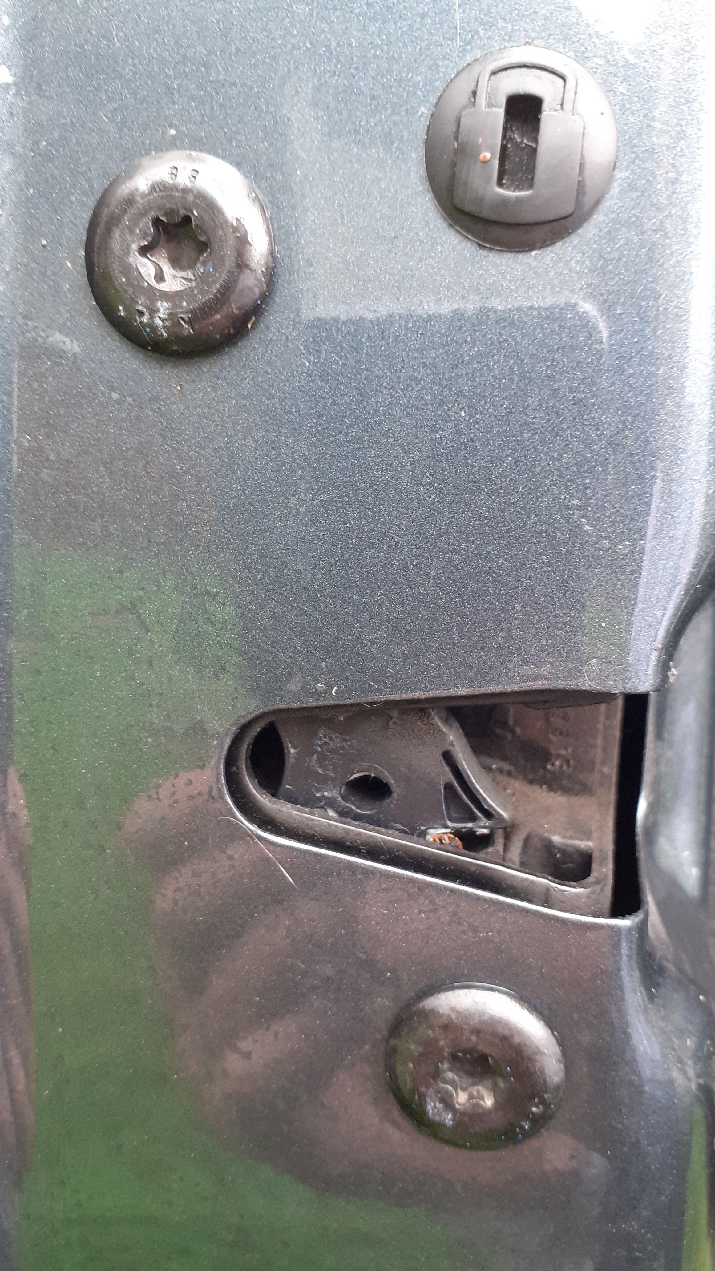

You should be able to fully lock up any car that has remote or even only central locking when no battery is fitted.
At least on Audis, VWs and SEATs, every side door without a key locking barrel, has a small rubber bung on the "rear" face of the door frame, not small rubber bung probably had a padlock outline on it and maybe a rectangular indent.  The plan for when there is no battery power on the car is:- open each side door, remove that bung, fit the end of the ignition key into the manual locking part that gets exposed when you remove the bung, then give it a 1/4 or 1/2 turn one way - it will only go one way, do this gently as very little force is needed, refit the bung and close that door - it should now be locked and can be reopened from the inside in the usual way as dead locking has not been used. Repeat that for the other 2 doors if it a 5 door, then use the key to lock the driver's door.  The rear hatch probably like other cars of this age, can not be opened from the outside so that end is secure and if you need to open it when the battery is out, there is usually a slot on the hatch's inner trim panel to slide a key in and release that opening.
I had never noticed this before, but had a look this morning and sure enough:
Me neither, every day is a learning day, thanks to Rum40 for that, it will be very useful in the future.

When I went to show my wife how to use the key blade in the hidden driver's door lock I first checked by myself that the cover came off with the key easily and then cleaned the cover and around the lock and gave the clip part a little squirt of GT85 to ease its removal.  Sod's Law I start my demonstration to show how easy it is to do and I struggle to get the cover off and then struggled to get the cover back on correctly.  I got a 'look' and a rather sarcastic "Oh, it's that easy is it.":blush:  :sadsmile:  :rofl:
Owner's manuals are boring or badly written normally, I think that after finding that I re-read that car's owner's manual and it was in it, same for 2002 VW Polo and my car.

I'm sure you'll be delighted to know, after checking, I demonstrated my new found knowledge to my wife, first door I open and I can't get the grommet out (I bite my nails) but success with second door.  My wife asks about the hatch and I said I thought not but we could have a look, at this point she lost interest and walked off!
