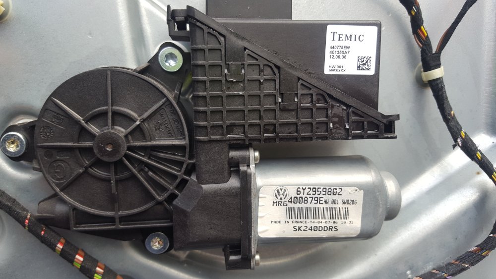

The windows played up the weekend removing fuses and the connectors by door made no difference.
But soon as I unplugged from the module several times it re started so this module has a problem somewhere.

If both of the windows don't open when the key is held in the unlock position (with door previously shut and locked) I'd say you may well need a repair to the driver's side motor module. Pop round with door card off and try a known good one 🙂

Power windows stopped working on my Skoda fabia MK1 2005 months ago and finally getting fed up, I've replaced drivers motor and window switch already with no joy, the windows work for 10-15mins when I disconnect battery or connector to the motor, also works if I unlock the car with the key in the door yet doesn't work if I just unlock with the button on the key (odd as hell) I've also checked between the door and a frame all seems ok.
Looking some advance on what to check next as I've had a look at CCU etc but no visible issues and the fact it works when reset shows me the motors work fine aswell as the window guides etc, it just stops working after a short drive which means I have to reset it to put the windows up.
Ive read probably every forum I could find and have check anything I've been told to so this is the first time I've ever posted to forums. Appreciate any advice.
Hi Hardcore! Did you solve the problem? Facing same 10min issue in the passenger windows when driver windows is disconnected.  If I connect the driver windows motor 6Q to the cable, passenger window motor stop working suddenly! It seems the problem is in the driver windows motor... I changed the confort module 6Q2937049F (Siemens 5WK4 8218) but no improvement...

My concern is solved, found one of the control unit on door was found faulty.
