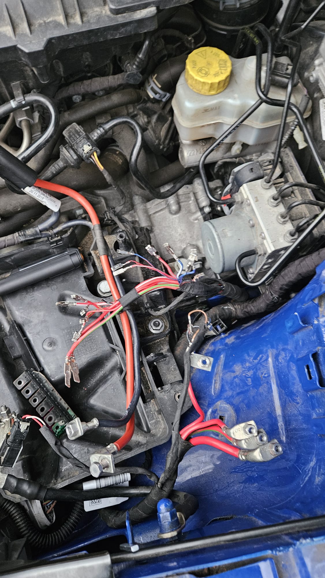

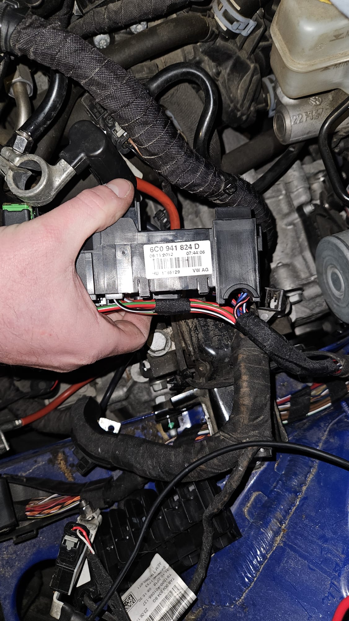

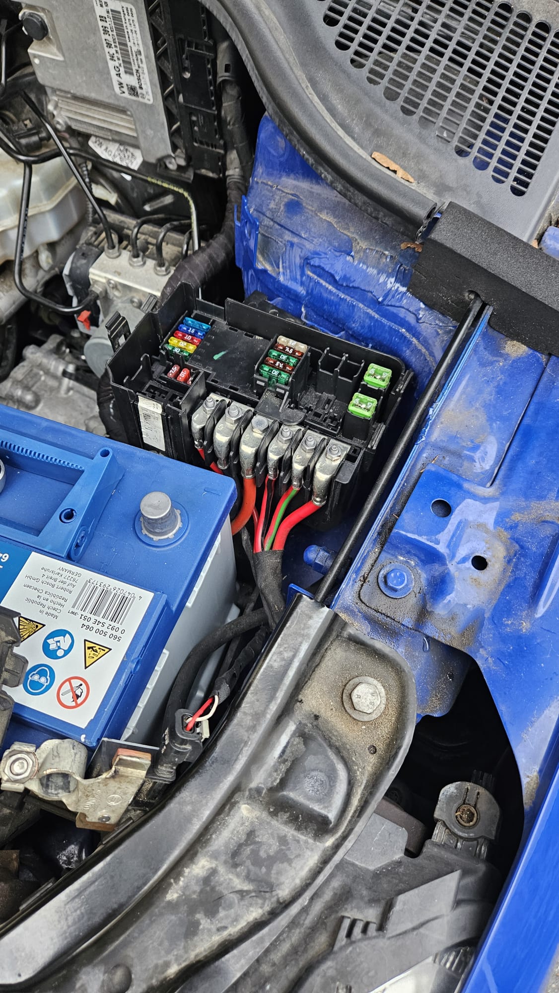

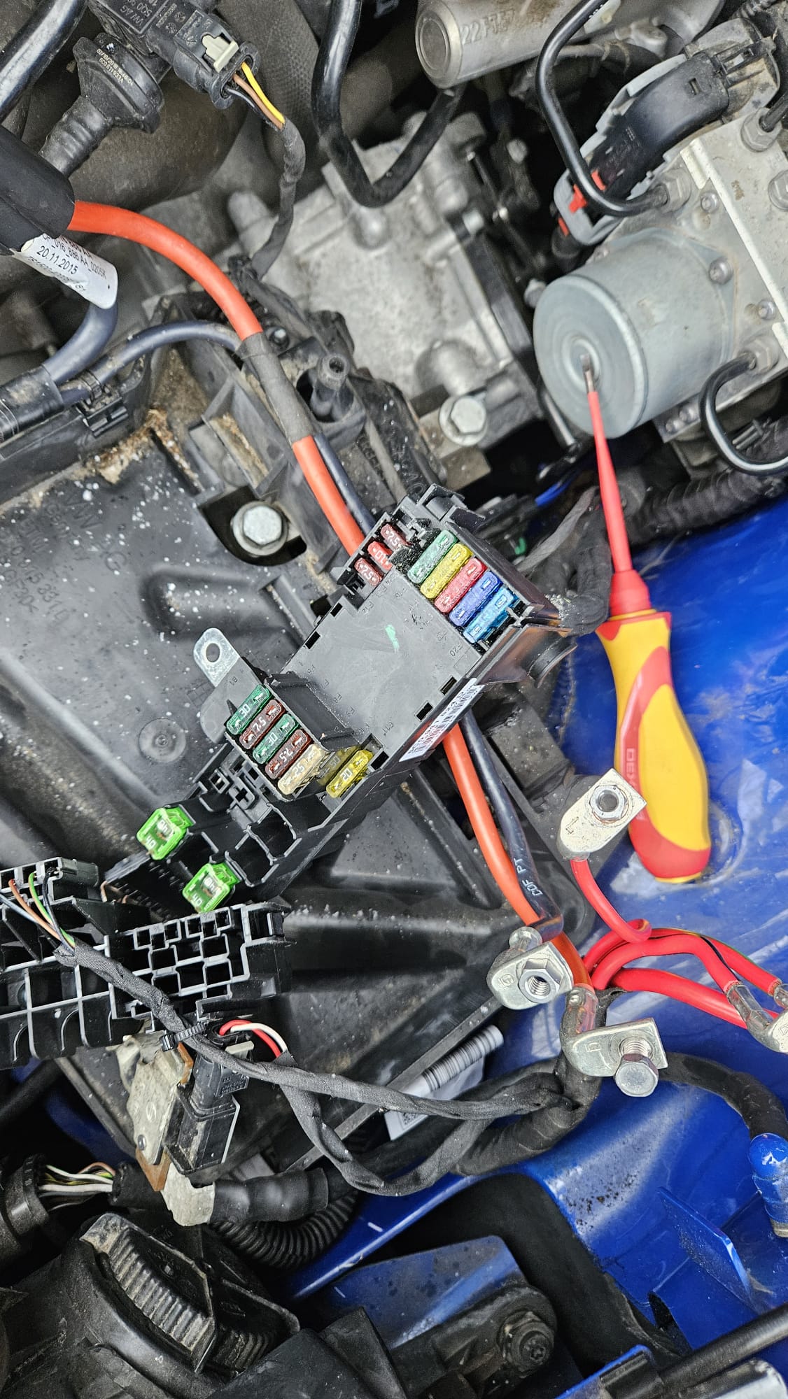

The car wouldn't start, and I discovered that tapping the fuse box next to the battery temporarily resolved the issue, pointing to a problem with the fuse box.
I couldnot talk with engine ecu too using vcds

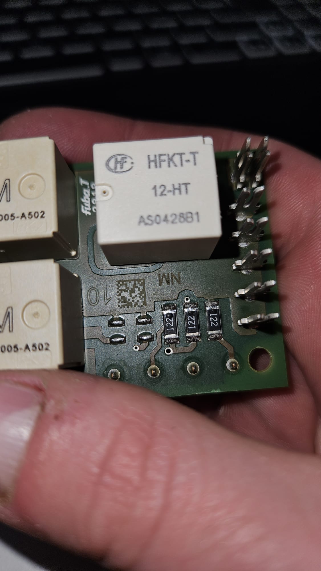

Before focusing on the fuse box, I checked each cable and pin connected to it and found everything to be in order. I also inspected each fuse to see if any were defective, but they all seemed fine. During this inspection, I discovered a PCB inside the fuse box, something that isn't widely mentioned online. Despite testing the relays and small resistors on the PCB with my limited knowledge and finding no clear issues, the intermittent starting problem persisted. Ultimately, I decided to replace the entire fusebox with a used one, and this completely resolved all the problems!
I'm sharing this because there's scarce information about faulty PCBs in fuse boxes, and I believe this discovery could help others facing similar challenges.
